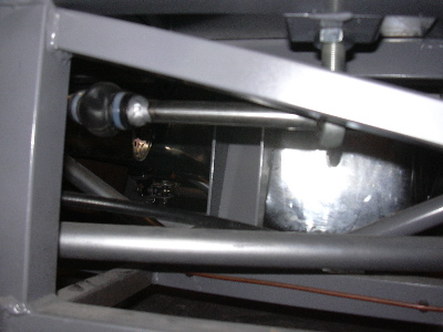

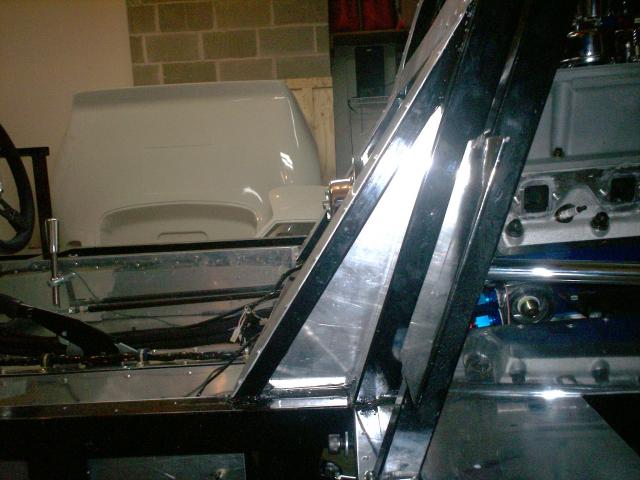

currently doing the same thing. However, I'm running the UN1 inverted, which happily arrives with the gearbox lever on the RHS of the box.
I have a single rod system which works, but I'm less than happy. Currently remaking the gear lever system to hopefully reduce the slop. I will come back with photos once I've got it sorted.

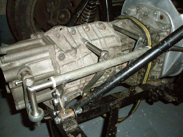

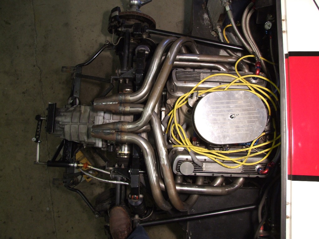

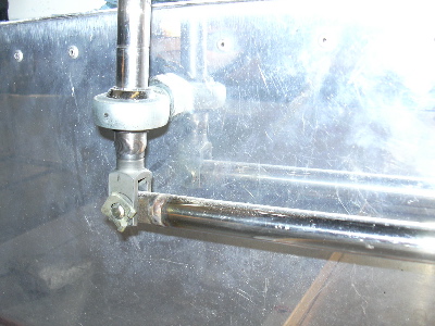

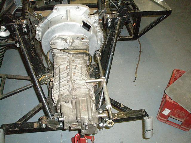

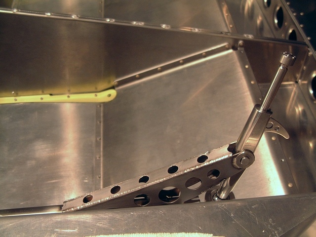

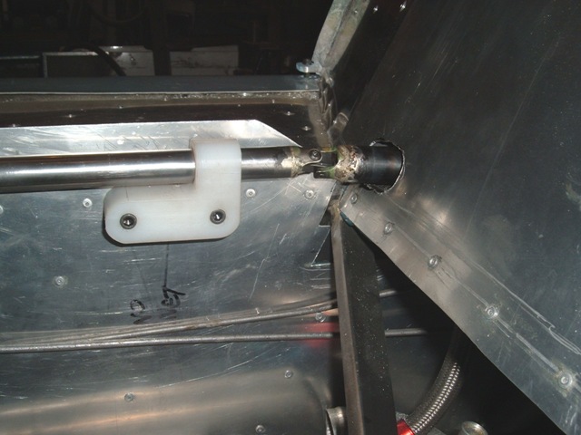

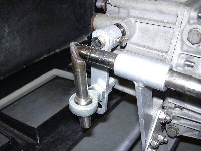

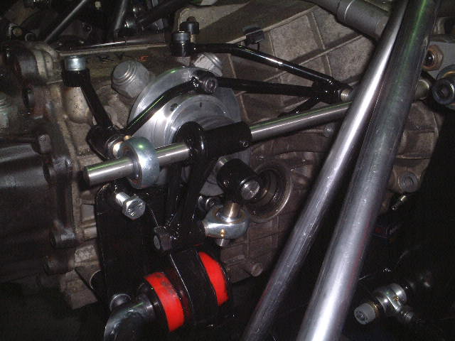

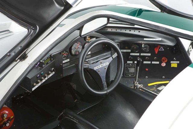

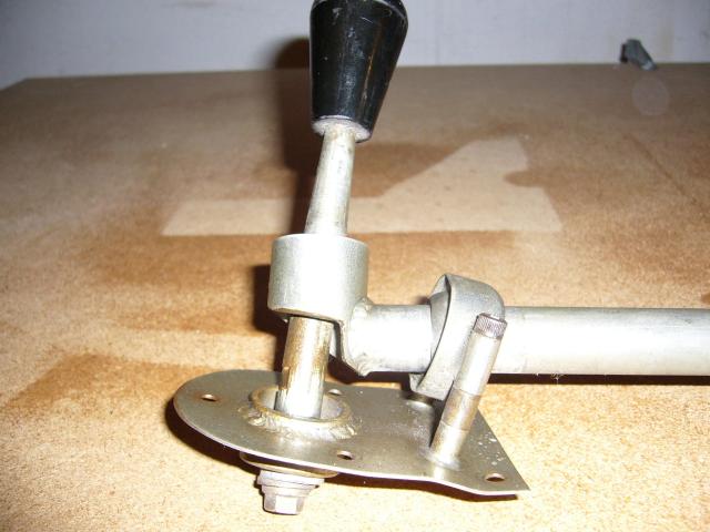

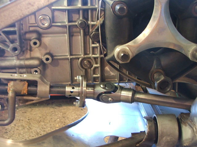

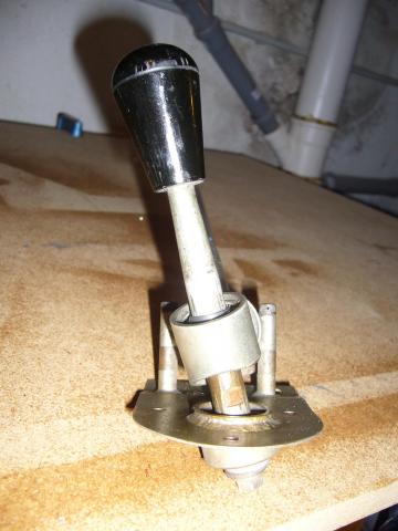

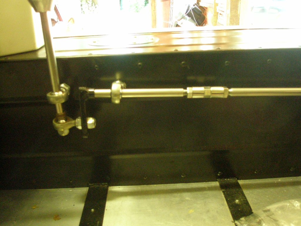

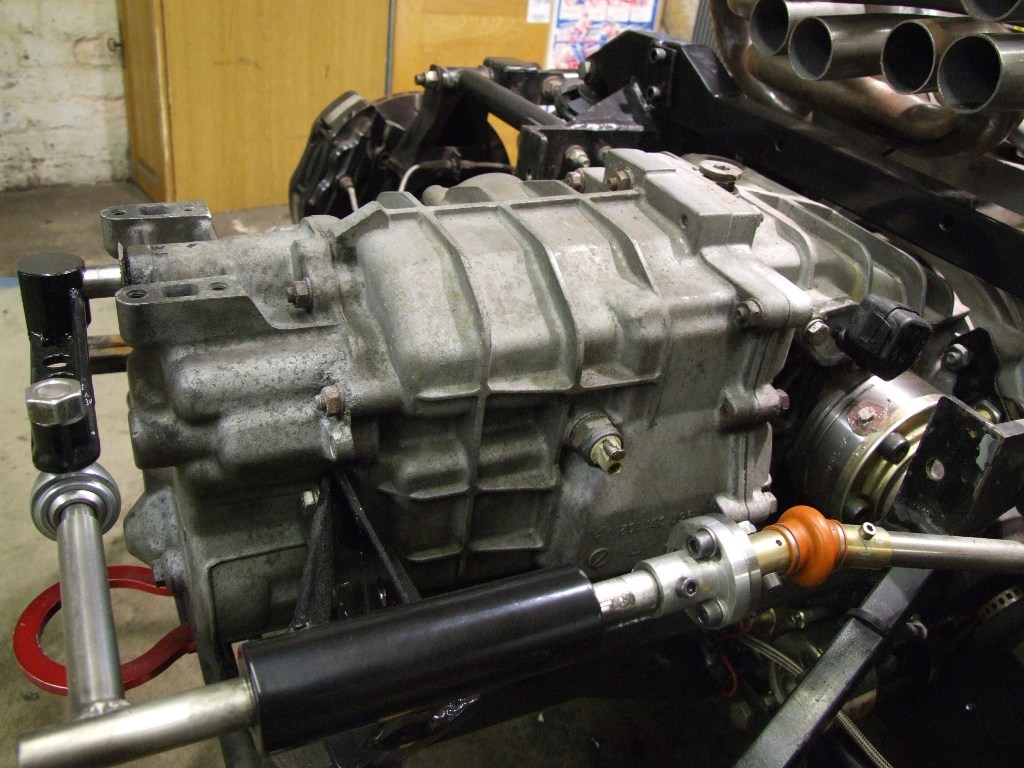

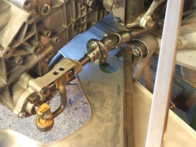

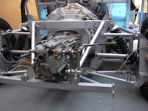

Martin,

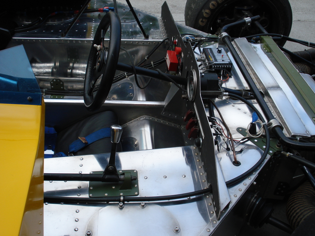

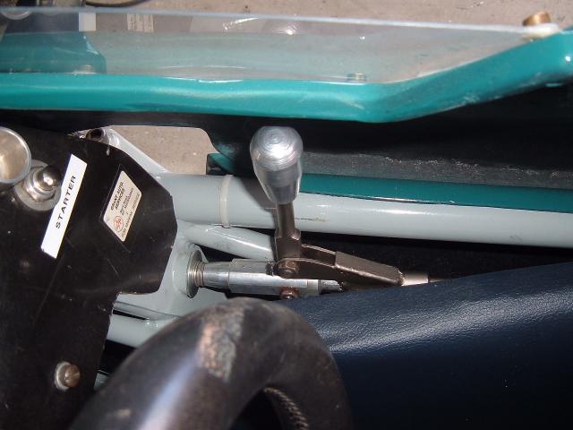

I have loads of pics of gearchanges that I have collected from this site. If you look in the build log threads you will find some..Here are some of the pics I have colleted

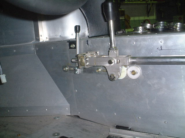

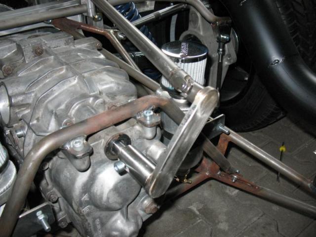

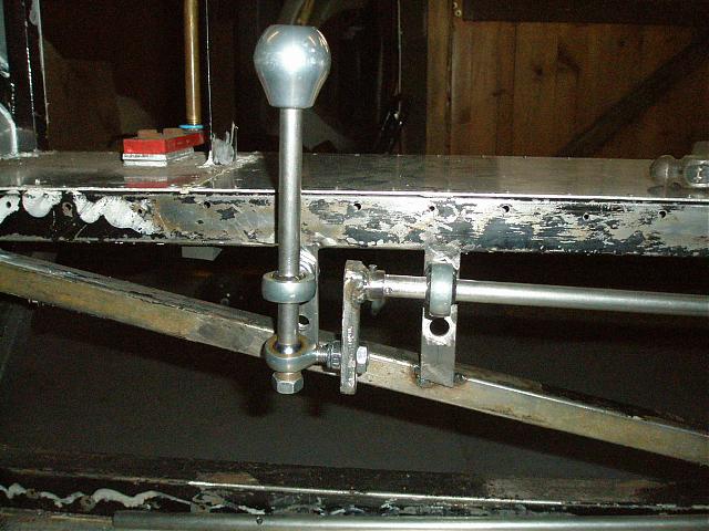

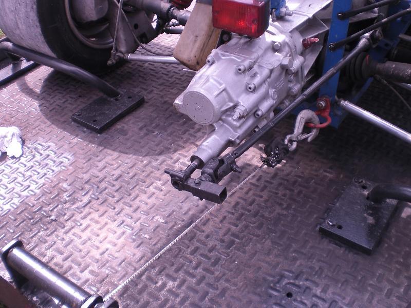

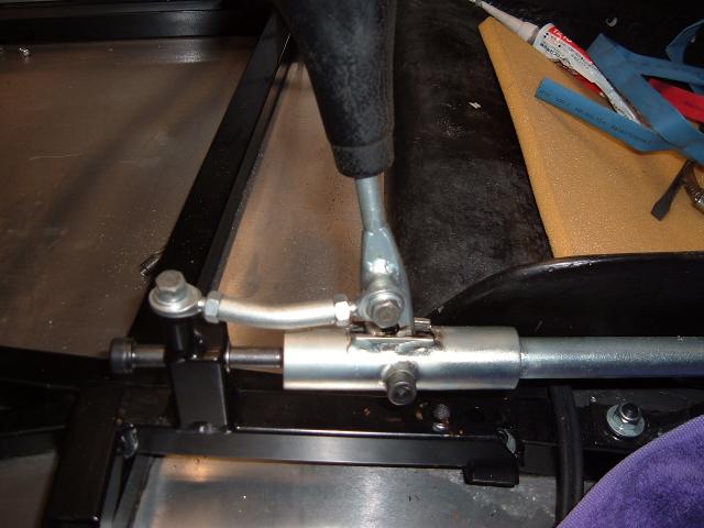

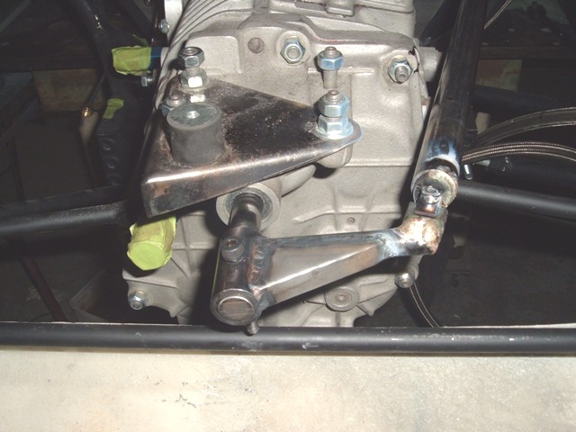

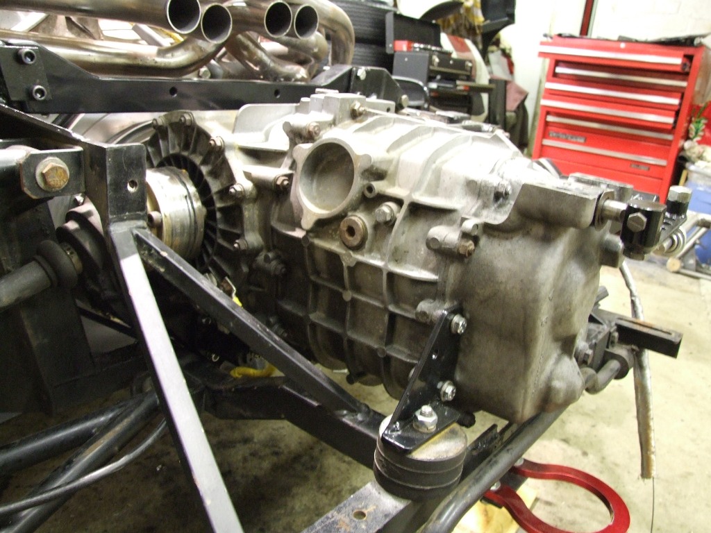

Martin, this is how I reconfigured the shifter on the 5000 to put the gears where they should be, instead of back to front,
cheers John

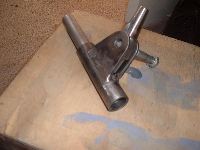

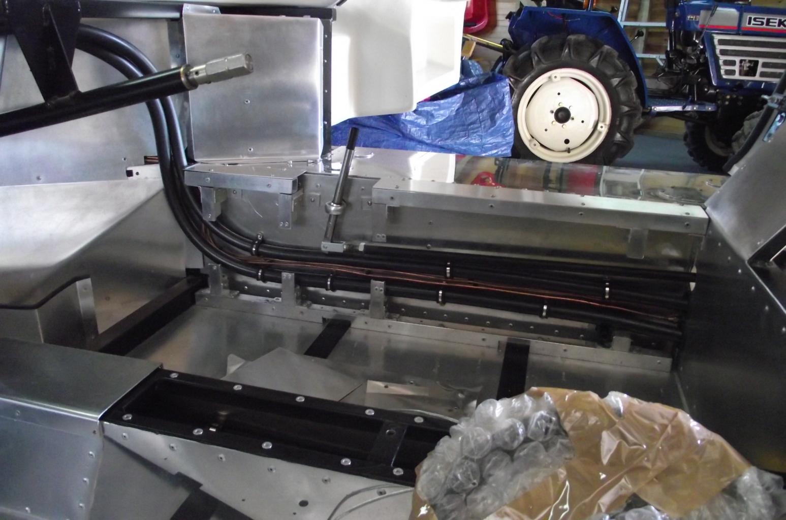

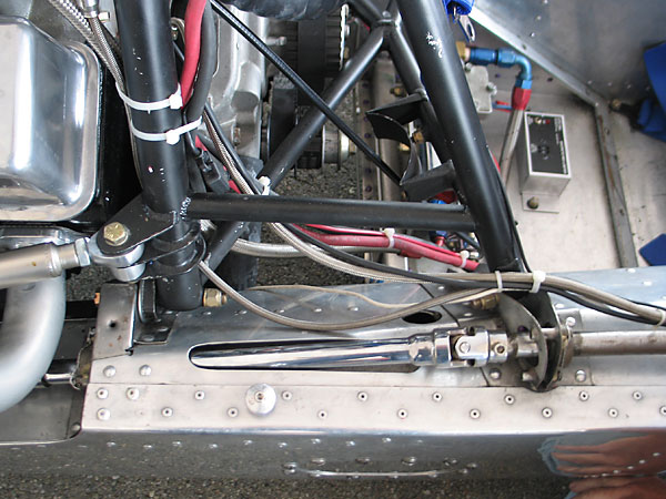

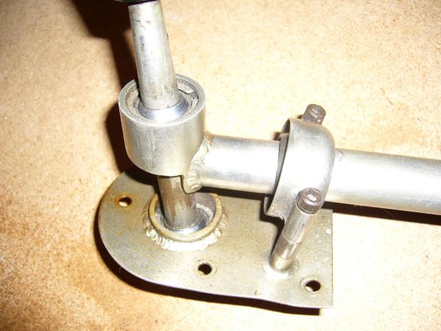

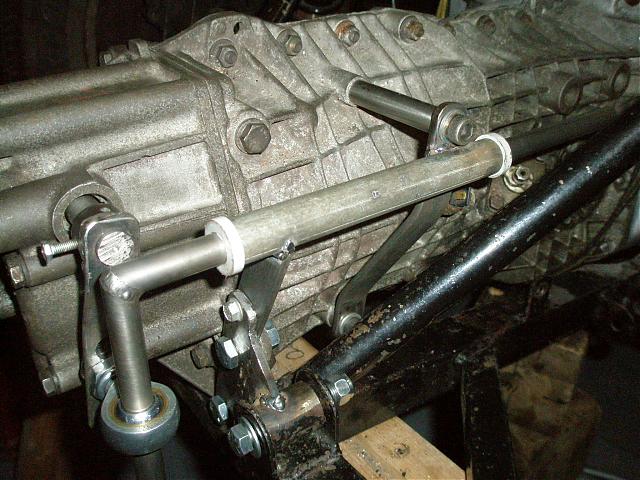

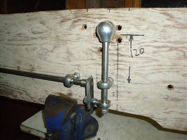

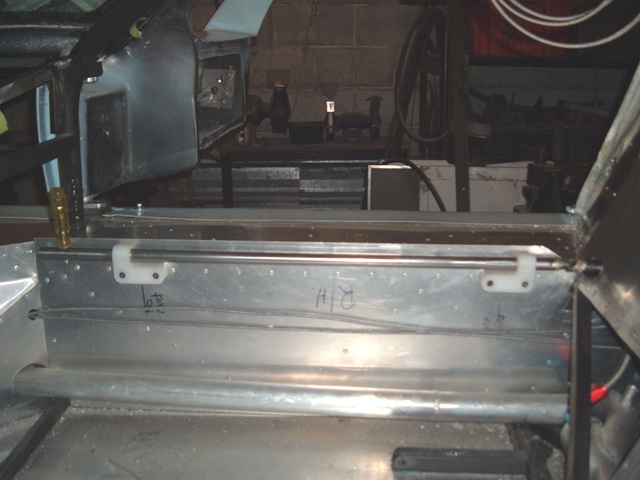

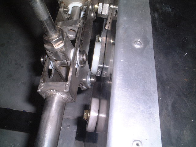

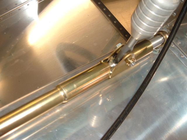

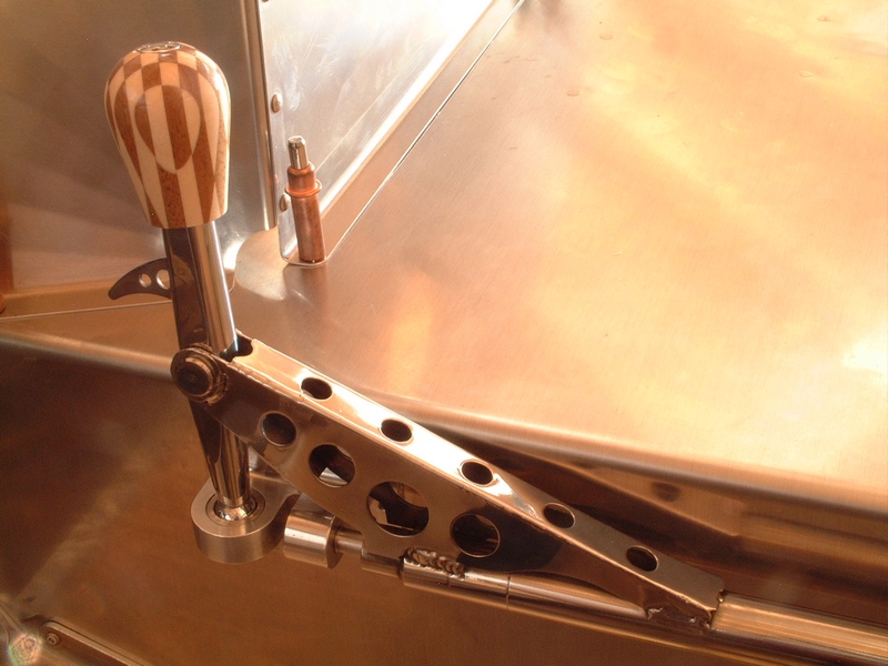

I made this for my 40.
The way it actions, when you push forward the rod moves rearward.
It rotates through the front rose joint.
