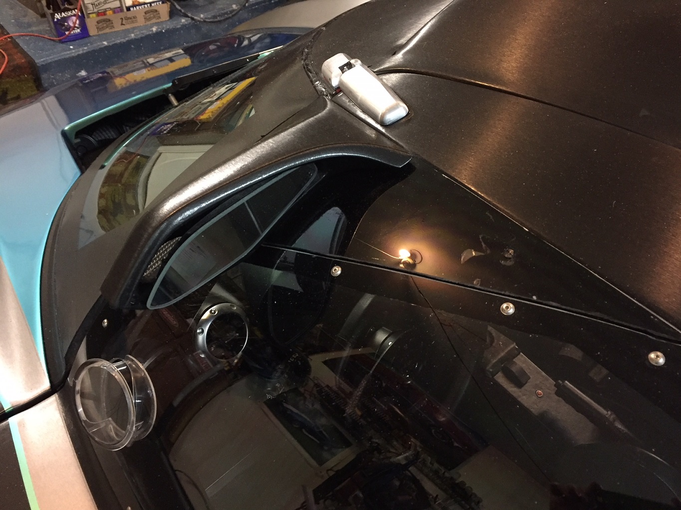

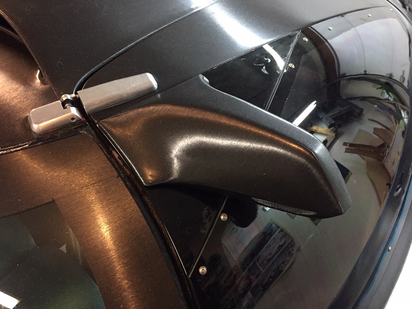

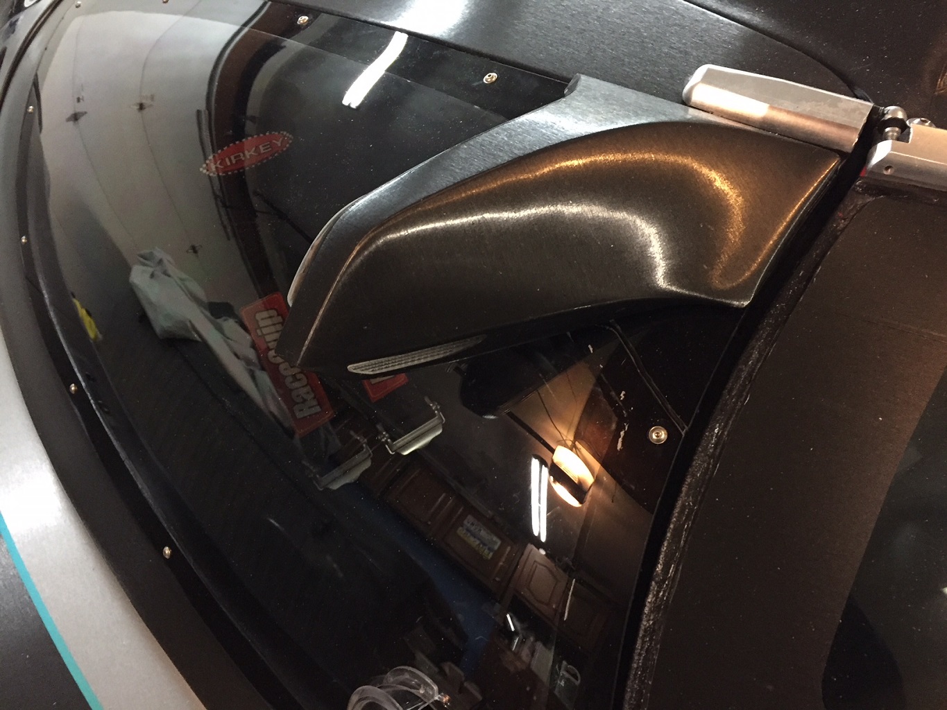

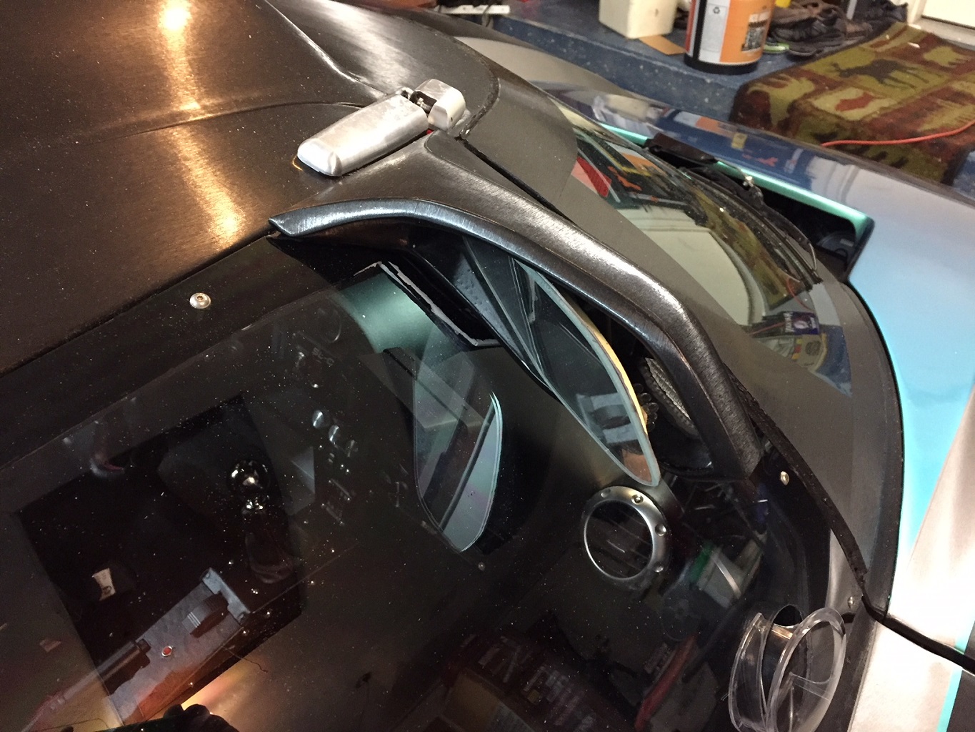

Not really sure what you're asking, so here's some pics of mine.
Most builders mount them on top of the window, like Pete above (and me). Usually, the leading edge of the mirror is lined up with the edge of the window.
Mounting them this way make it more difficult to remove the window from the outside, which is arguably a security bonus.

Thanks. Answers the question and didn’t cross my mind as an option to cut the window like Pete’s. Got to think about that, but it works for Pete
