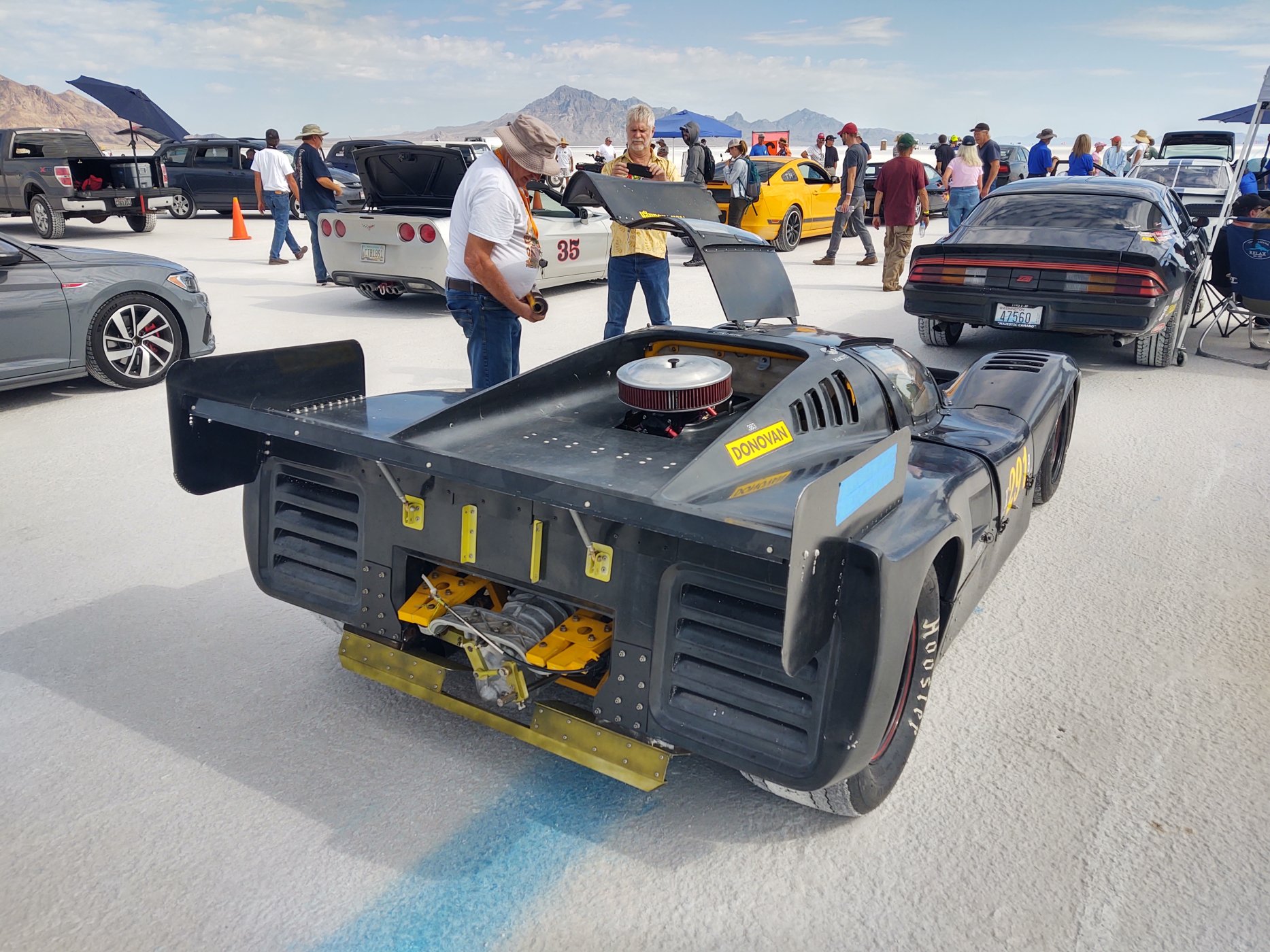

Hey Niel, I was wondering what the clean-the-car process was both during the event and upon returning home. That has to be the majority of the time spent at the track on maintenance unless something breaks. And once home The tow truck and trailer need to be cleaned up also I would think. Pretty big undertaking that is in addition to all the other racecar stuff. I'm not sure I would have it in me to do all that cleaning, my hats off to you.
Howard, the salt is a PITA as those who live in the Northern Climes will attest. I usually wait to get home to hose everything down but some years there is a Boy Scout fundraiser in Wendover that washes down a vehicle for a few dollars. Of course a more detailed wash is necessary at home. Generally it takes three separate wash downs to remove most of the salt. One can never get a vehicle or trailer 100% salt-free so we need to accept the fact that salt racing is a somewhat sacrificial activity.
Some years the salt is hard and dry like concrete but other times it may be damp and sticky. Conditions can vary day to day and even hour to hour. Put Bonneville on your bucket list, especially Speed Week in August. It is a totally unique experience, even for just a spectator!

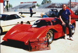

This is an original 35mm color slide from Manta Cars back in the late 1970s. Tim LoVette is standing by their second Mirage prototype on the Pebble Beach Golf Course in Monterrey, CA. Tim was a co-owner of the company with his brother Brad LoVette, who was killed driving his race car at Continental Divide Raceway in CO. This was the company's factory demonstrator and it was featured in their advertising and magazine articles of the period.

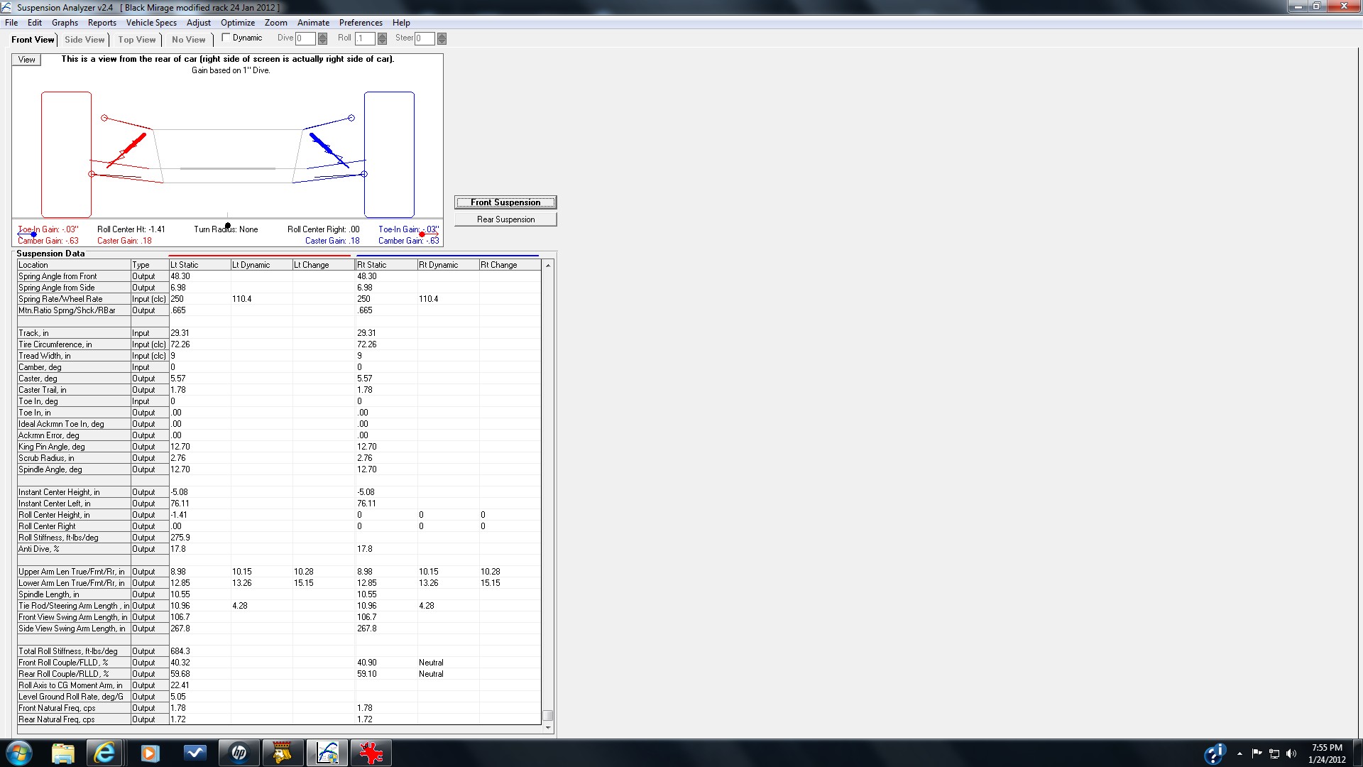

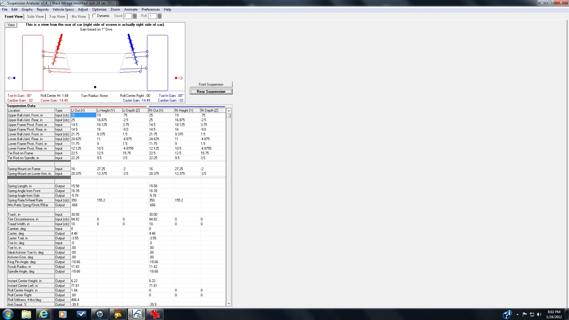

While looking through my computer files, I found the computer data that I used to build the suspension on my black Mirage. The front is based on the popular Mustang II geometry and the rear uses a slightly modified Porsche 996 5-link uprights and geometry. Chassis pick- up points are specified in this data so it should be possible to duplicate this F & R suspension without too much trouble. If anyone is interested I can also post the curves showing camber gain, bump steer, etc, etc.

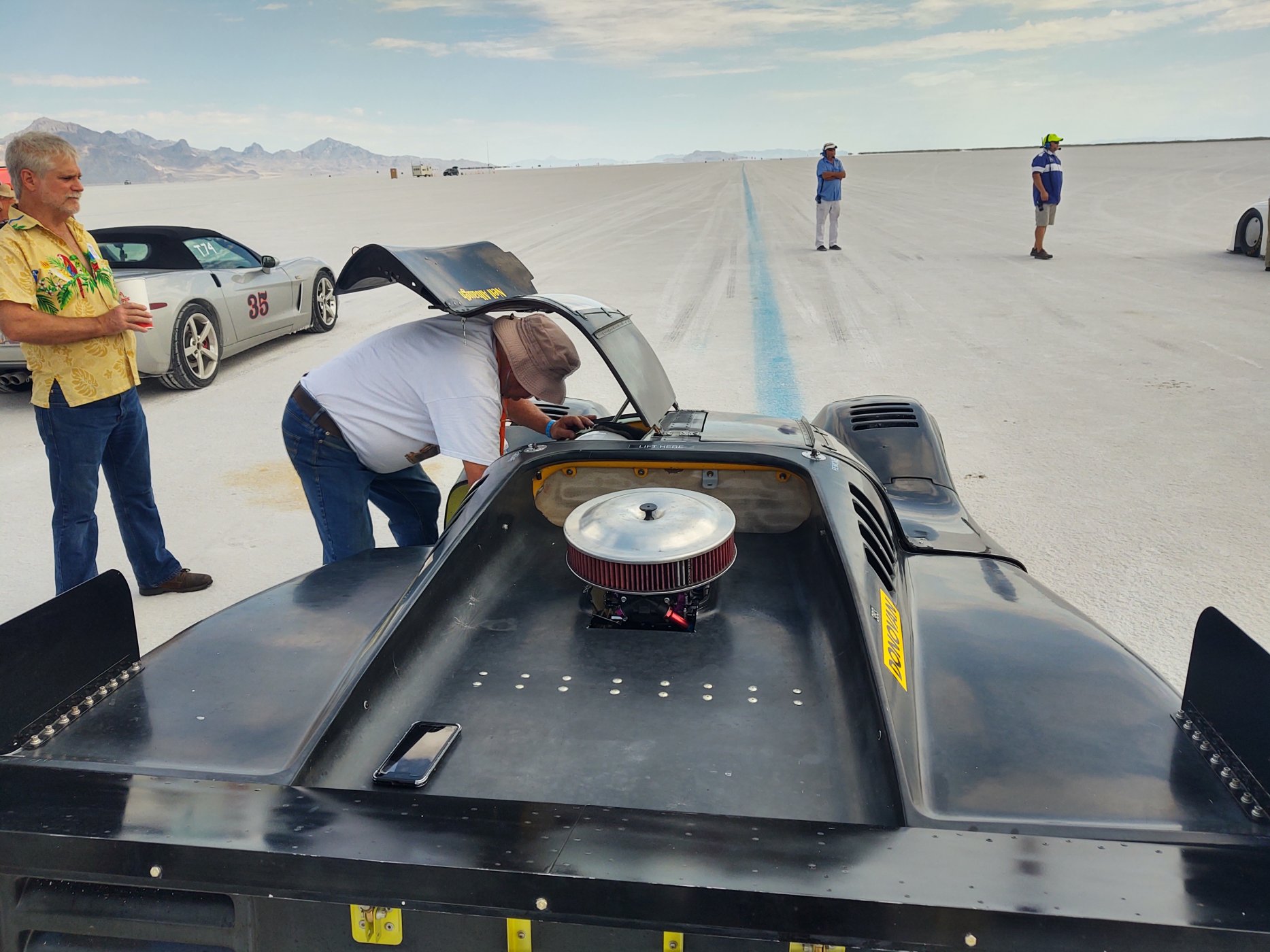

I just looked back at this post and realized that I never updated the results of my trip to Bonneville. The 2019 trip was a fiasco. The engine was running very poorly and it didn't even finish the run. On tear down I found a bad Holley 4 BBL and a missing cam button. I rebuilt the engine with a Proform Racing carb, new rings & bearings and ran it again in 2021. This time I turned 157.458 mph on the "short course". In the 150 Class, the goal is to do 150 mph but not exceed 159.999 mph or you will be disqualified. Not too bad- I started in 1st, shifted to 2nd, and then to 5th. and took it very easy. Obviously the car has far greater potential. Here are a series of videos that show the 2021 trip.

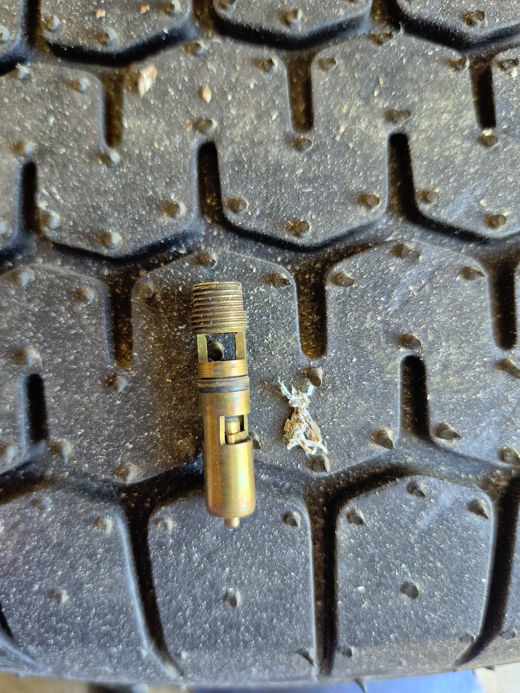

I've been doing a bit of work on my Manta Mirage, the original "MANTA 2" from The Manta Cars showroom in Santa Ana, CA. Its Holley 650 cfm Spread bore needed to be rebuilt so I've taken it off to rebuild with new gaskets, etc. Wedged in the secondary float level valve was this...a tiny piece of Teflon tape! Where did this come from? I must have read a hundred warnings about Teflon tape getting into a fuel or hydraulic systems and I don't think I've ever used it on a fitting. ???? That tiny o-ring was hard as a rock, too.

Possibly from the original tank install at the factory? Thinking NPT fitting screwed into the tank. NPT threads is the only place I use that stuff..

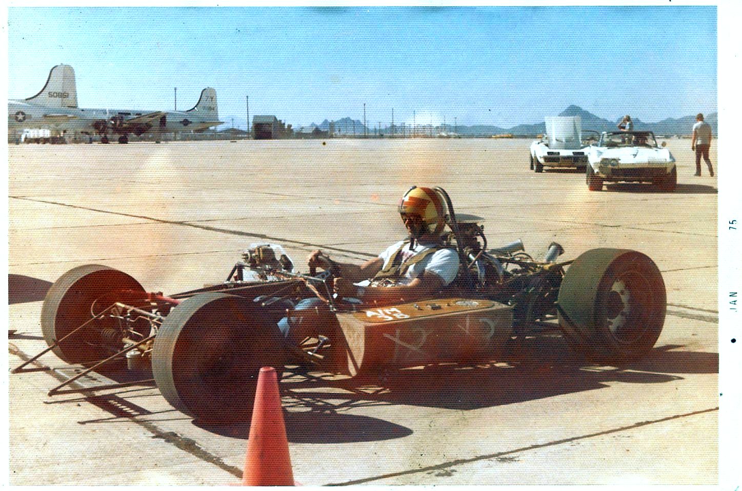

Back in the mod 1960s I jumped (with both feet!) into building a car. A man in Rockville, MD, John Sabel. was offering copies of his mid-engine race car fiberglass body, the Sabel Mk III, for a decent price do I drove over to north of DC to visit John at his shop. His design was very attractive and the fiberglass quality was outstanding. I took lots of photos and measurements of his tube chassis and other details so that I could build a similar chassis. I paid John for a body and I picked it up a few weeks later to carry home in a trailer.
The design was very advanced for those days- a mid-engine configuration using a Porsche engine and a beefed- up VW transaxle. Using down time on the Observatory's IBM 360 Mod 50 main frame computer I ran a stress/strain analysis on all the chassis members using a computer program called "STRUDL". I built a chassis from thin-wall mild steel tubing of various sizes using a hacksaw and a gas welder. I changed the engine to be a 140 HP Chevrolet Corvair and a Porsche 901 transaxle from a 914. In addition, a double a- arm rear suspension was designed to replace its original swing axle.
After finishing the chassis and and installing the trans and running gear, I found that it was quite a bit faster than I had anticipated. In fact, I competed in local autocross events and it was so much fun that I never got around to mounting its beautiful fiberglass body.
The bottom photo was taken at an autocross in Davis- Monthan Air Force Base in Tucson, AZ.
Be warned!!! Building cars can become an addiction! :)
