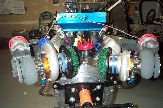

Gordon has not fitted a TT engine to a GT40. I think there would be room for the turbos, if you used small, efficient turbos like Garrett GT35s and had the manifolds and dumps custom made from 321 stainless. The problem would be finding a place to fit suitably sized intercoolers. Twin intercoolers could be fit up against the side scoops but they couldn't be too large.
Do a search on this tpic and you'll find pics of Tony Marsh's TT Rover VE setup. Tony was helped by his smaller engine and his use of the slightly larger Mk II rear clip. I'm also told there's a TT (GTD maybe?) running around somewhere in Australia.

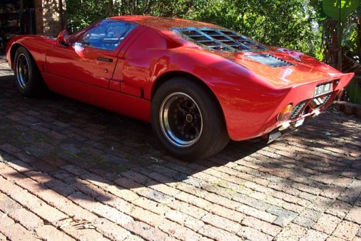

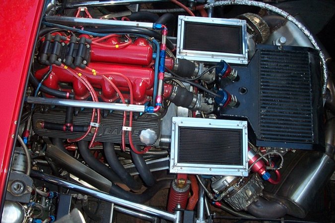

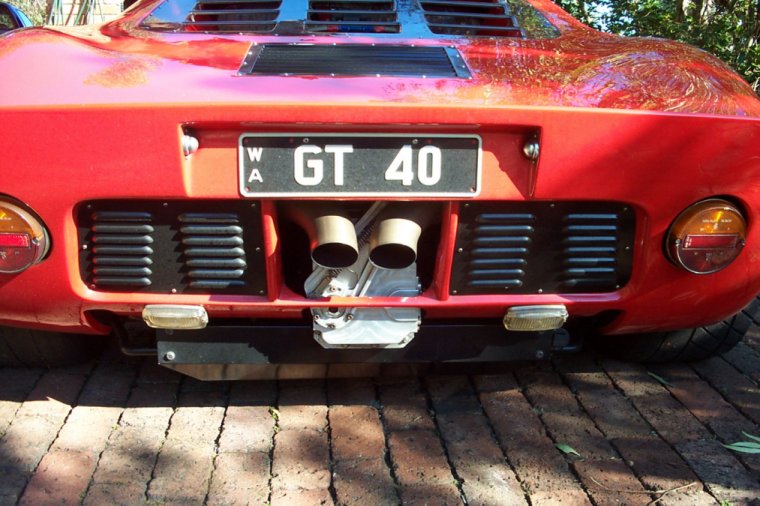

Cos, that is a sweet setup. Congratulations on an extremely well-done GTD. Care to tell us about your gearbox? Where do the intercoolers draw fressh air? How much horsepower does your engine make?
Nice to see you post here...I've heard about your car and have wanted to see it.
