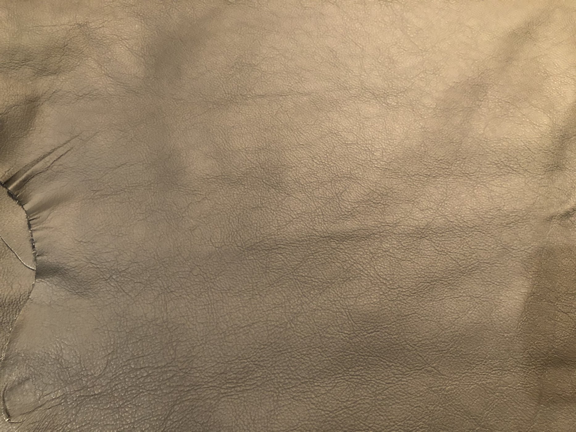

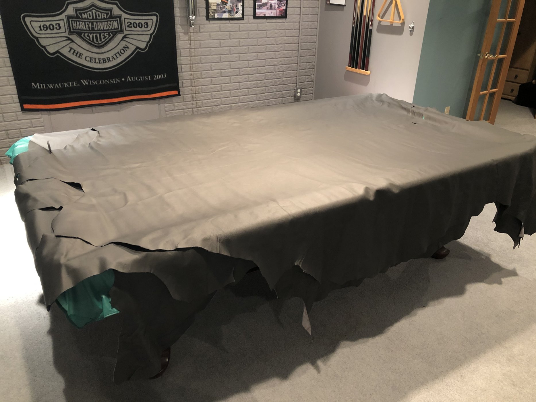

My hides showed up today. Charcoal grey. They are very high quality (ordered them from leatherhidestore.com) and I will have no problem get more yield out of them than what the supplier will guarantee so I'm certain four hides will be enough (hope I didn't just jinx myself :rolleyes:). My basement is going to smell very good until I get around to working on the interior!
