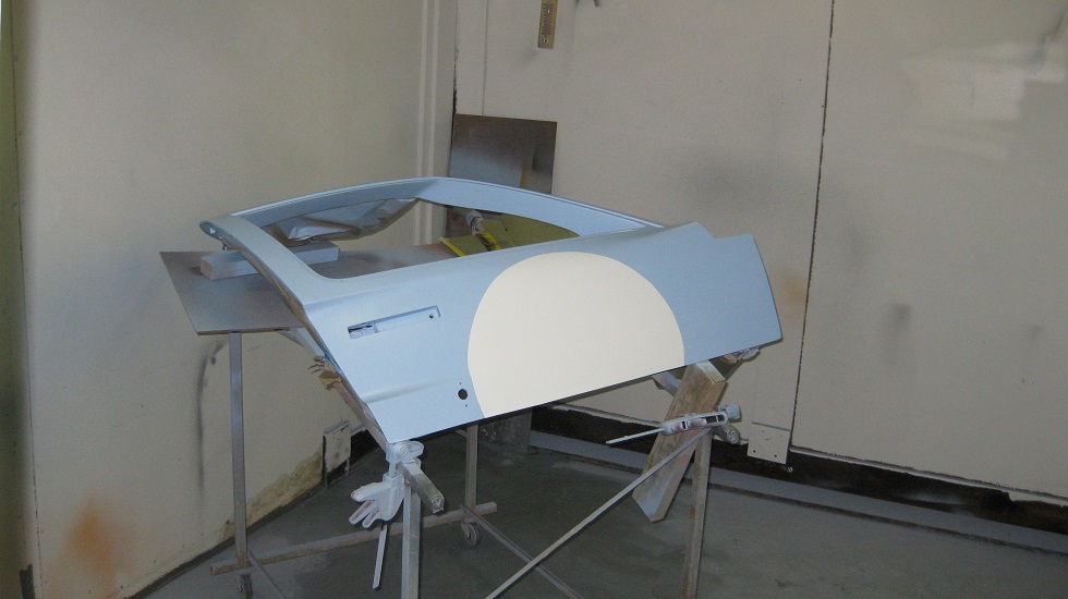

The painting: Since I am rookie painter, I sprayed non metallic paints, this allowed me to paint individual panels one at a time. This also allowed me to keep the paint booth relatively small (11feet X 8.5feet), I still had room left in my garage to do other work.
It was a long job, of which I had no idea how long it would take me. :huh:
Would I paint another car, yup, I must be sick!

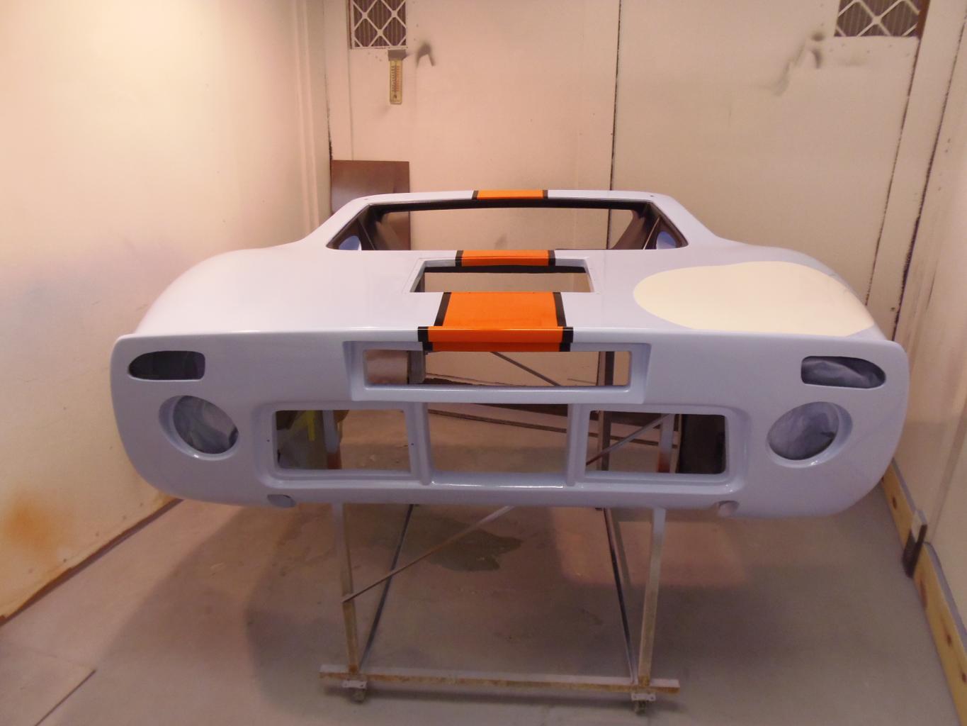

Here is a picture of the rear clip in the booth and one door.

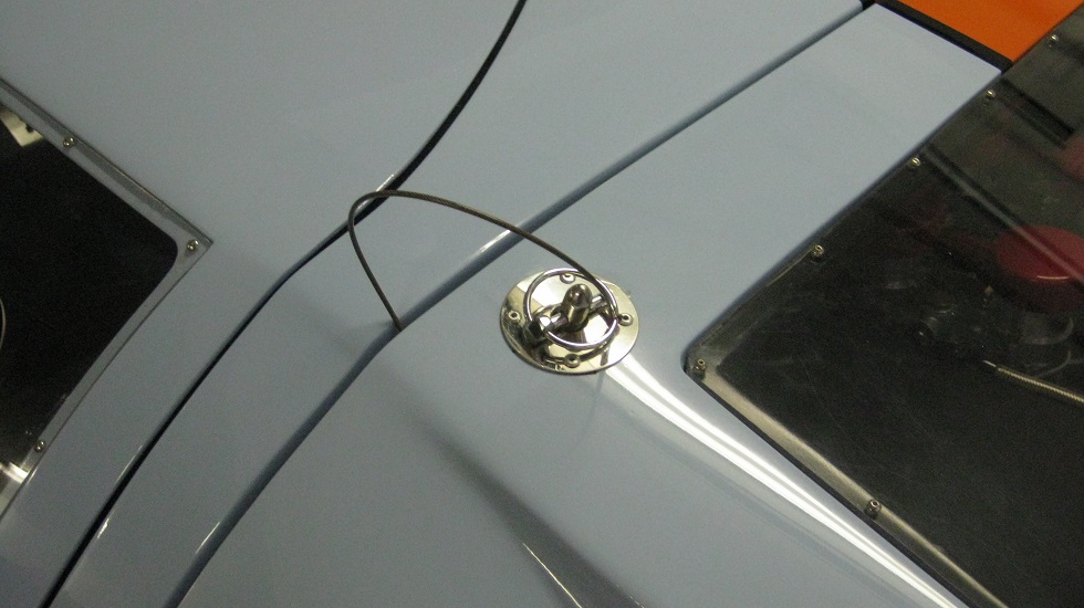

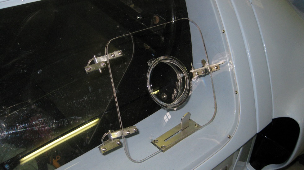

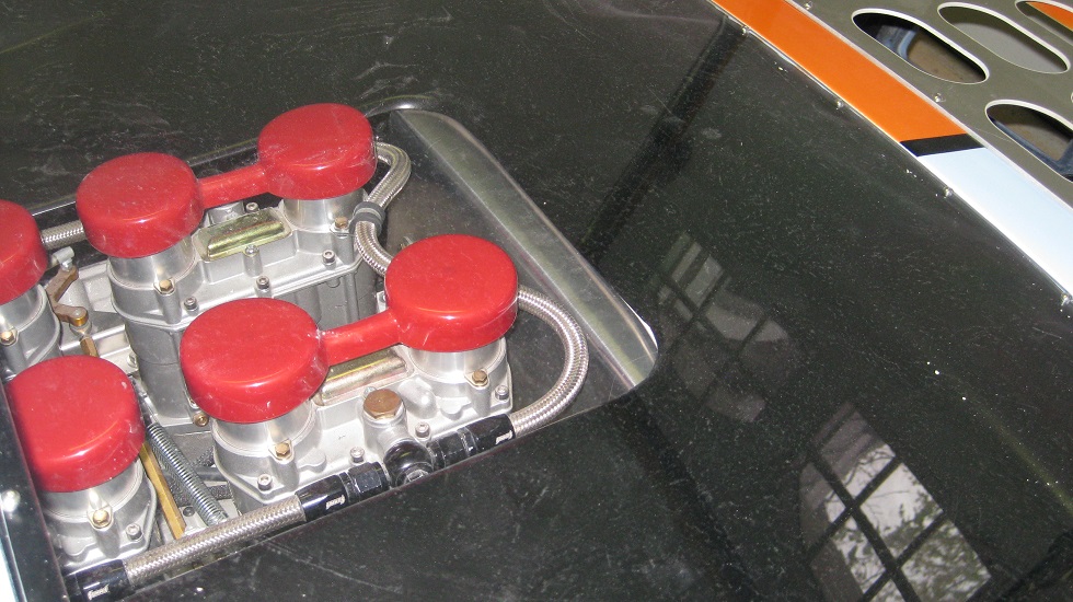

A couple of days ago I installed the vent windows and the aircraft vents.
I also mounted a pair of heat shields to combat screwing up the paint and body. I used the Click Bond studs and Fiberfrax, (ala Chuck and Ryan)along with some aluminum to act as a shield behind the fuel lines on the EFI from the exhaust. I also attached the cables for the hood pins on the rear clip.
Three things off the list. :thumbsup:
A couple of picks:

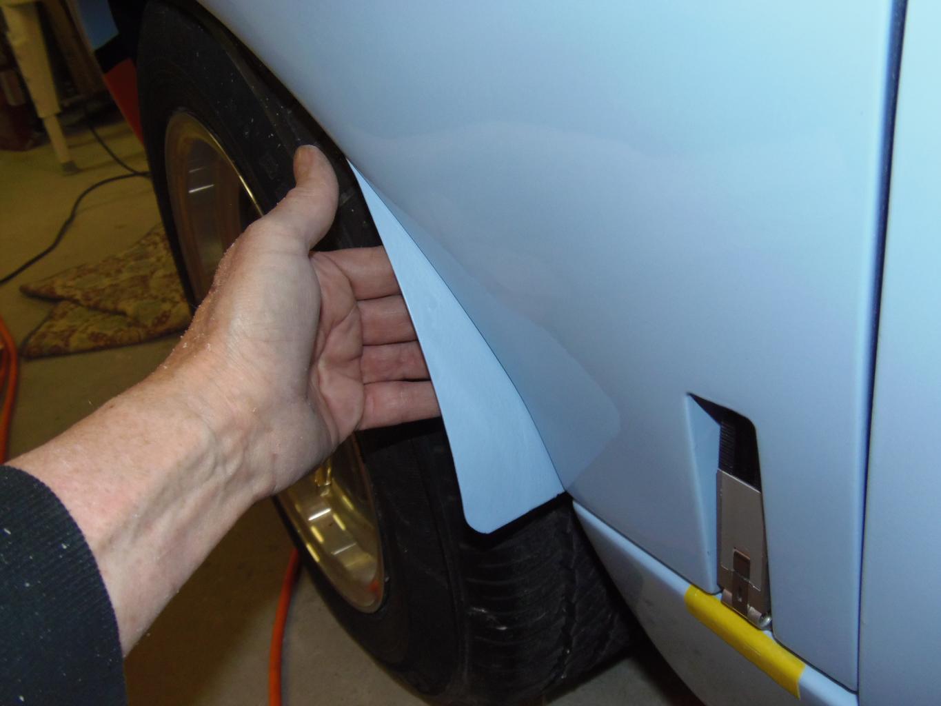

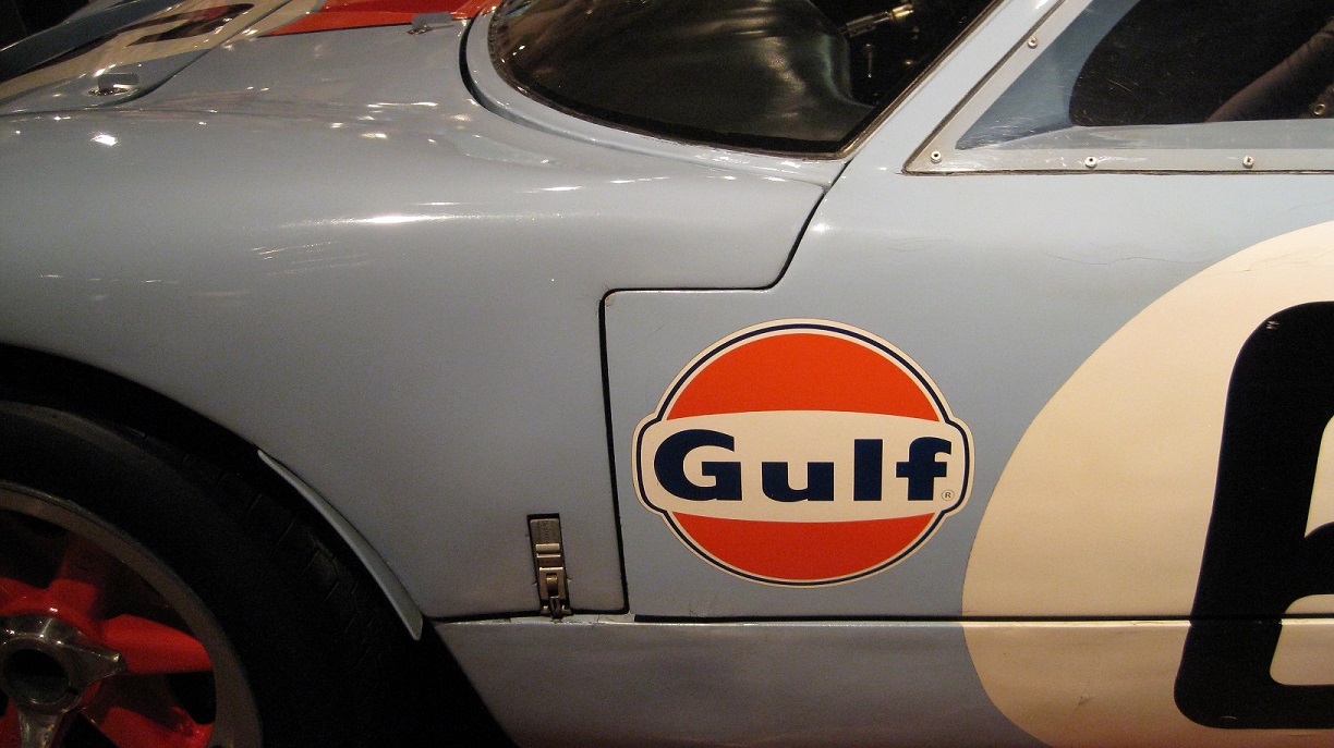

While working in Michigan in the last couple of months I stopped by the Ford Museum for the third time. I was expecting to see the '67 MKIV in it's usual place. However I had a pleasant surprise the 67 MKIV was on a road trip and had been replaced by the 1075 Gulf car on loan. This gave me a great opportunity to take some detail pictures (just a few 140, :thumbsup:).

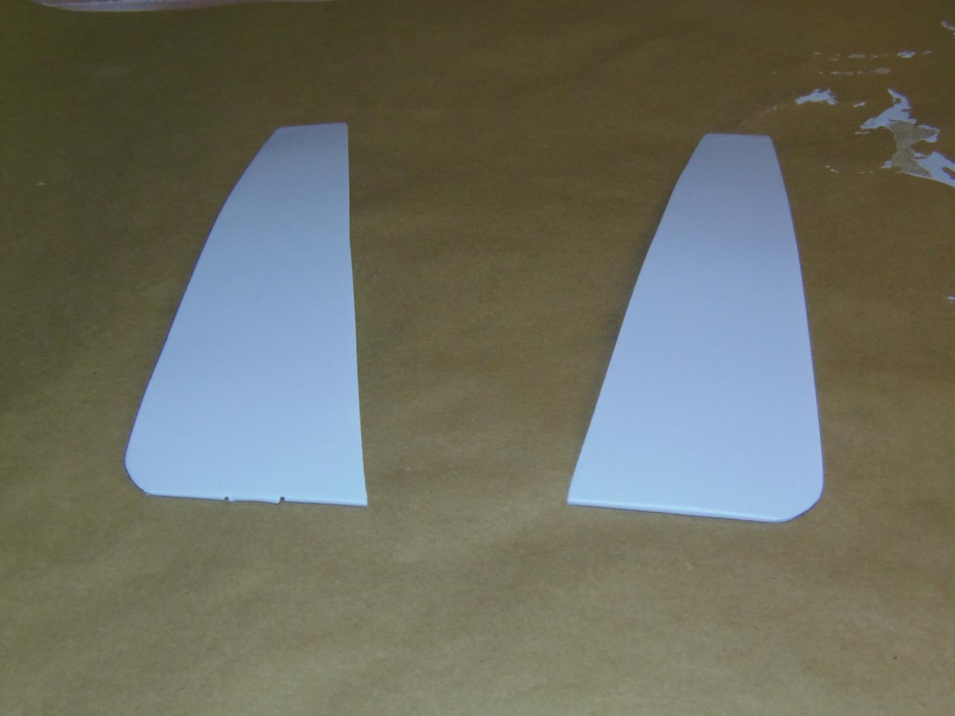

Even though the paint job is not the paint job of the '69 Le Mans race there were features I could look at close up. One was the small splash guards on the wheel wells of the front tires. With that information I made my own guards and will be mounting them soon.

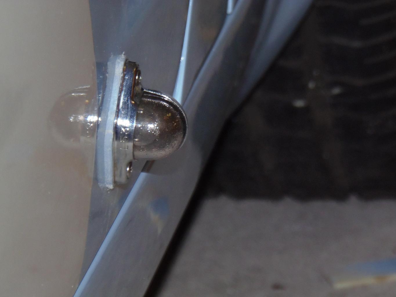

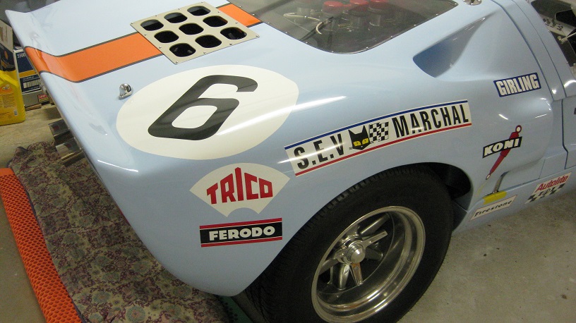

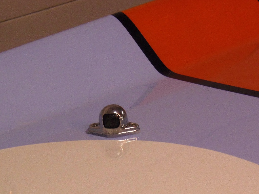

I was also able to mount the roundel marker lights. See pics.

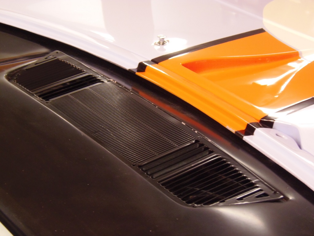

I spent the afternoon yesterday shaping the louvers in the demister grill Fran had so kindly given to me when I visited his RCR shop while in working in the Detroit area. Thanks Fran, it worked out just fine.
I did need to size the grill to fit the opening in the dash first. I then sanded and cleaned it for paint. I next took my needle nose pliers and coaxed the louvers into shape. I used a flat paddle sheet metal pliers to straighten all of the louvers and align them. I cleaned the grill again, hung it in the paint booth, mixed a couple ounces of primer and shot the primer.
After allowing the paint to cure, I shot it with mat black.
It was a pretty easy job, that just took some time and patience, oh yeah, just like everything else. :laugh:

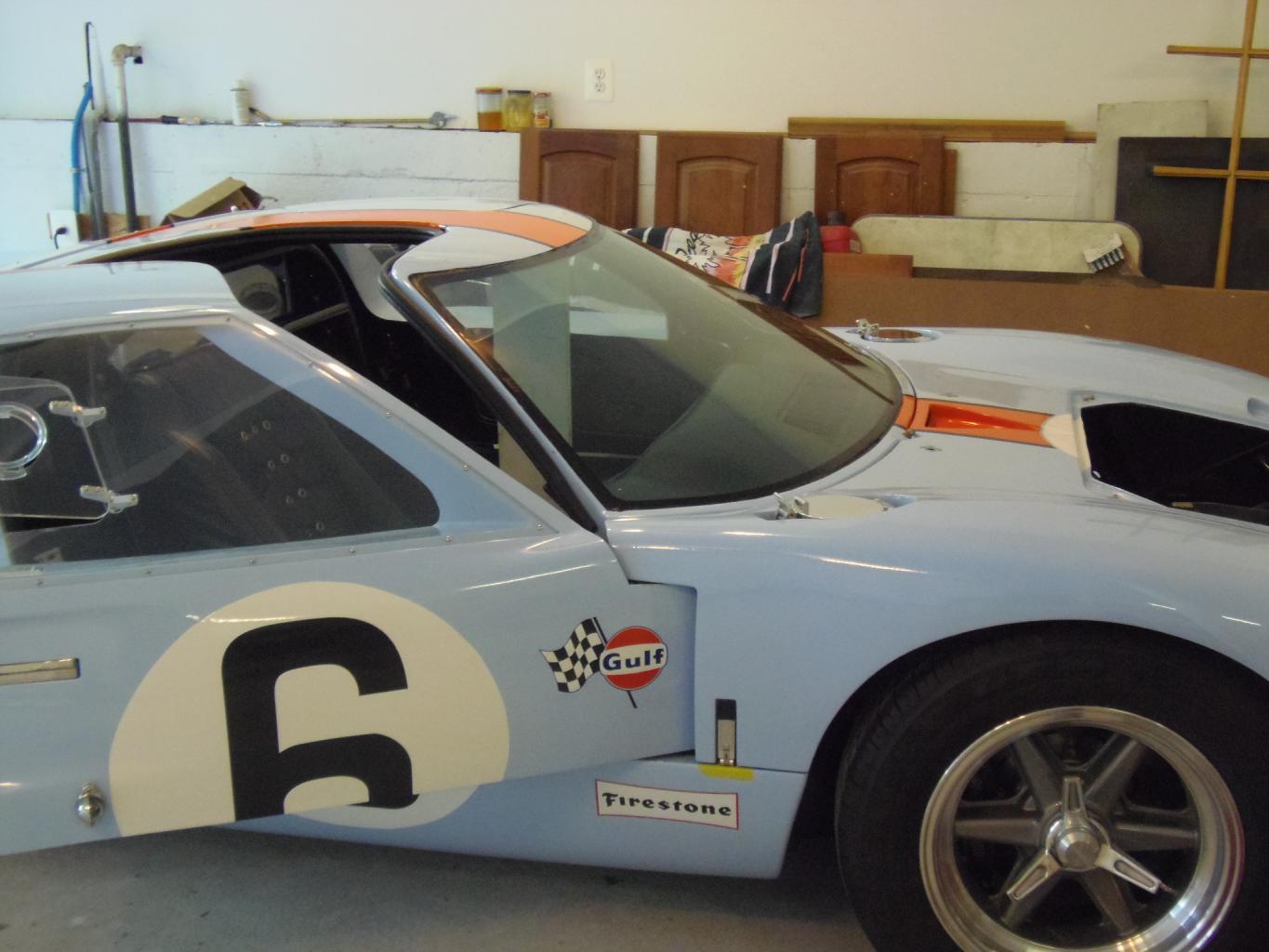

Time to check in after all, I last posted here in November. I need to get my build closer to the front so I can find it easier! :shocked:
I finally have this puppy coming to completion, hallelujah!
Some of you will like it, some of you won't, just another Gulf car to some, the best color combo for others.
Personally , I smile every time I am near it! :thumbsup:

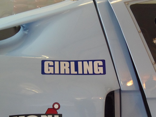

The reason my girl friend left me...
She saw this and asked if this was why I was building the car...:laugh:
Damn, she figured that out pretty quick!

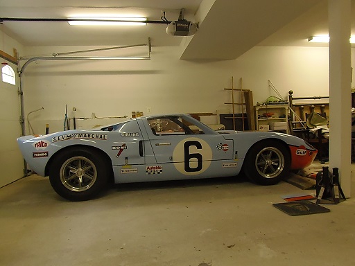

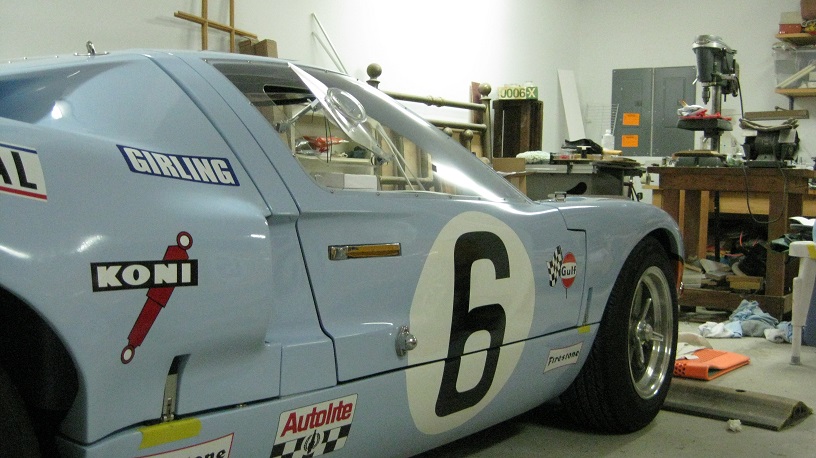

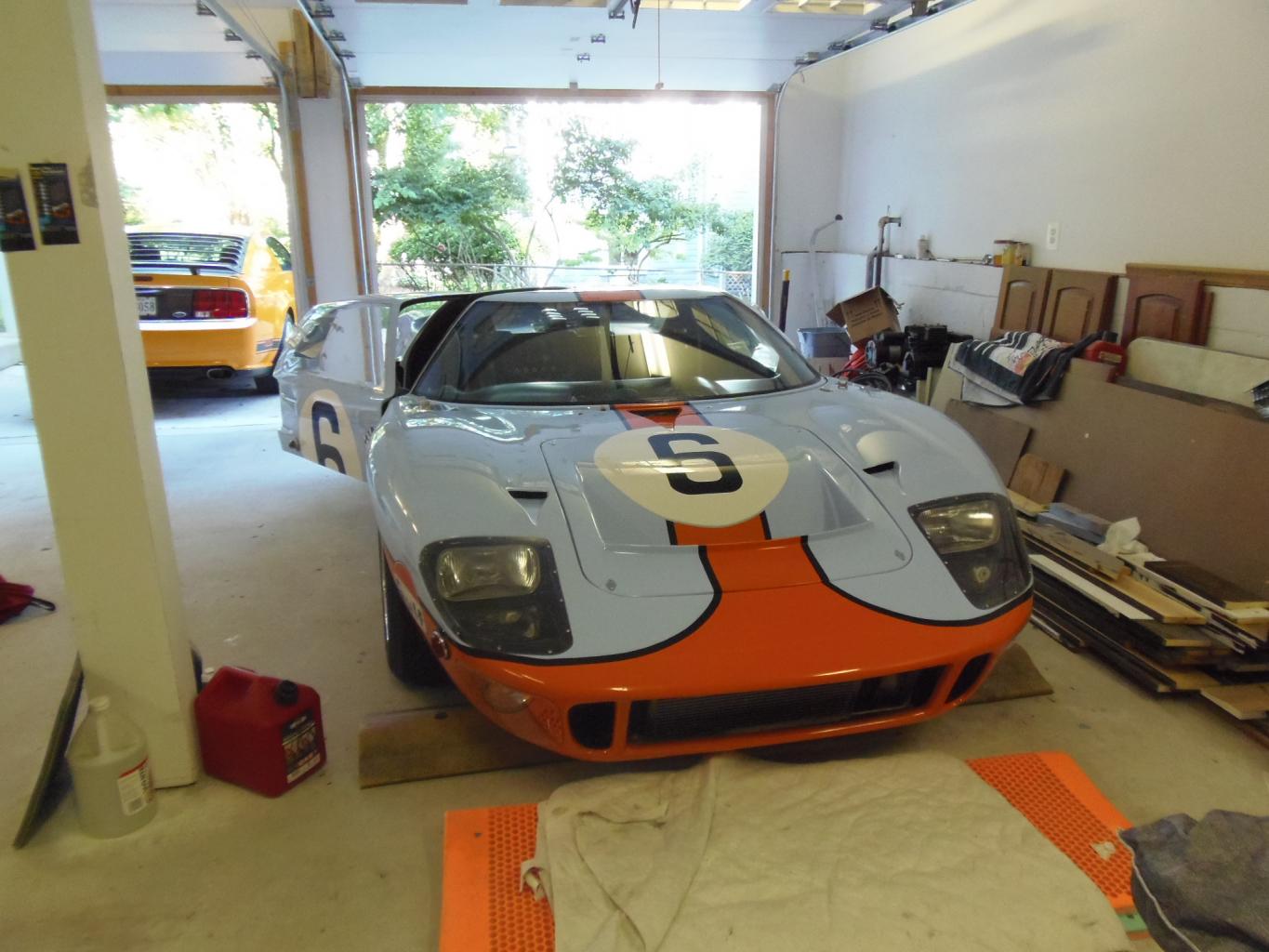

I have more pics to post and I have had a couple of short drives in for sorting.
I built a pair of ramps to get it out of the steep drive way I own. It's a drag if you don't us them.

I thought I would have gotten comments on the Girling joke. You guys are so "car guys"! :laugh: You just missed it I guess. :laugh:
