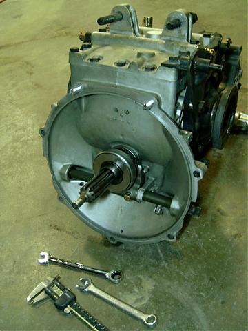

Hi Bill,
You may be missing a couple of needle bearings too. In the picture you can see the white plastic bushings, they sit on pads right beside the throw out bearing and protect the cross shaft from bending forces during clutch disengagement. The cross shaft rides in needle roller bearings that are pressed into the transaxle case. One end of the shaft stops within the bearing, the other end protrudes to attach the lever arm.
The plastic bushing are not used to support the shaft at the case. I'd find the needle bearings and confirm your plastic parts fit the location shown. Sorry, I don't have a part number or source for the bearings on hand. They will be metric parts by the way. Hope that helps.

Bill,
You are missing 2 needle roller bearings that should have come with the cross shaft TOB kit...RBT should be able to supply...Also I believe the white nylon bushes go in close to the fork arms to prevent wear of the fork arms against the stand offs...Make sense?

Yes, it all makes sense now. I was hoping to install the engine and transaxle this weekend, but it appears I'll have to take the transaxle BACK to RBT for the needle bearings.
I would check with the others on here that may have a stash of those bearings. Ron McCall? Ford? or just ask Lloyd to drop them in the mail to you (fat chance - I know)... You should also be able to source those bearings from a local Bearing Vendor as well..
I just talked to Lloyd at RBT. He is shipping me the bearings, a freeze plug, a seal, and a picture how all of this goes together. He said it's relatively easy to install at home (HA!)
Steve C
Steve
Bill,
Good!...That's the way to do it...Freeze plug for far side bearing, seal to protect shaft side bearing ect...How about posting the picture Lloyd sends for all to see (I can't take pics of mine as it's all assembled) but, sure pic would be usefull to all.
