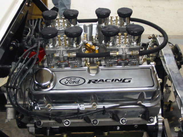

That is a clever solution which appears to work well. Either that approach or the spacers both look like good options. One less issue to sort out later . . . .
Chuck
Chuck
Dave:
You noted: I wonder if steel rocker covers would be better as they are thinner walled than the alloy ones?? or does it travel that much that relief ports are a must??
With the steel "Ford Racing" style covers I had no clearance issues.
Chuck

Hey Chuck any chance of a Total height measurement from base of manifold to to top of ram tubes?
Oh and how do you Guys adjust your mixtures?? Looks like grip with your fingers and turn job??
Adjusting can be done with "finger/thumb" or the "Two index finger method." Either way, theres not really any problem doing it.
I use medical clamp thingy's to get at the acc pump nut.
Don't waste your money on filter screens. They choke the carbs beyond adjustability.
