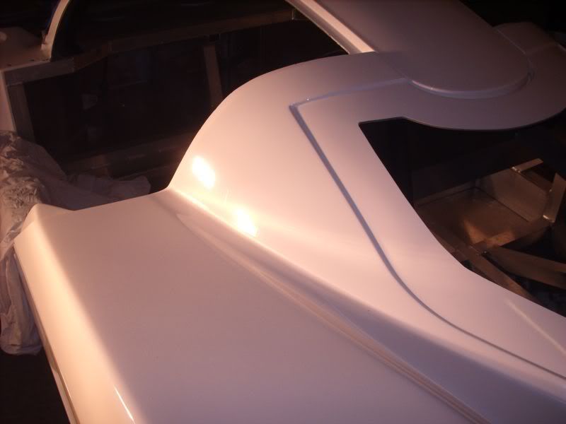

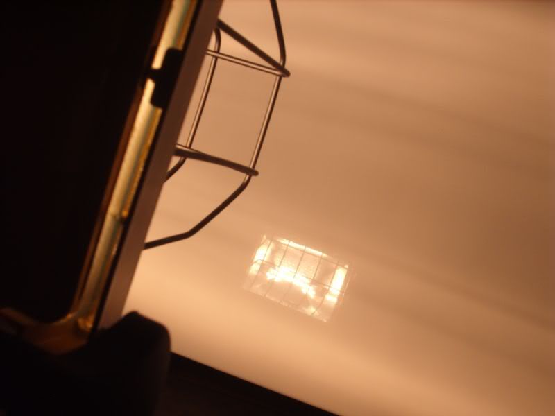

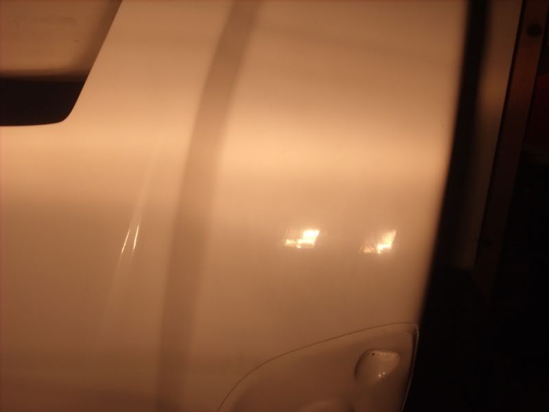

unpolished gelcoat - note the dull reflection of the hallogen light and micro-marring in surrounding areas (it's white, so you arn't going to see micromarring well in photos, esp. with a cheap camera)

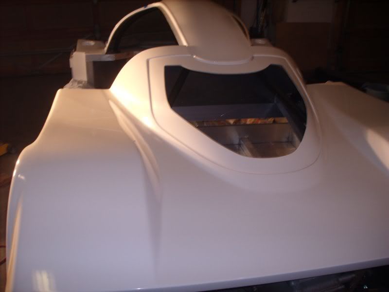

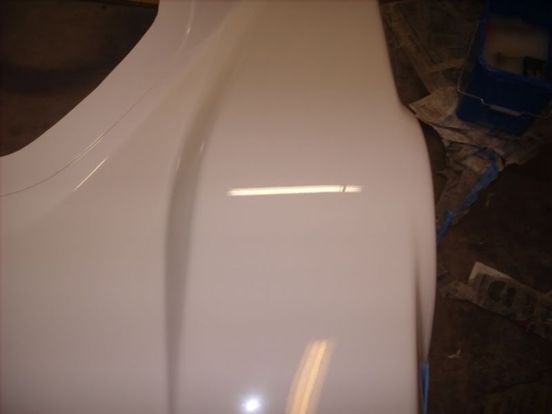

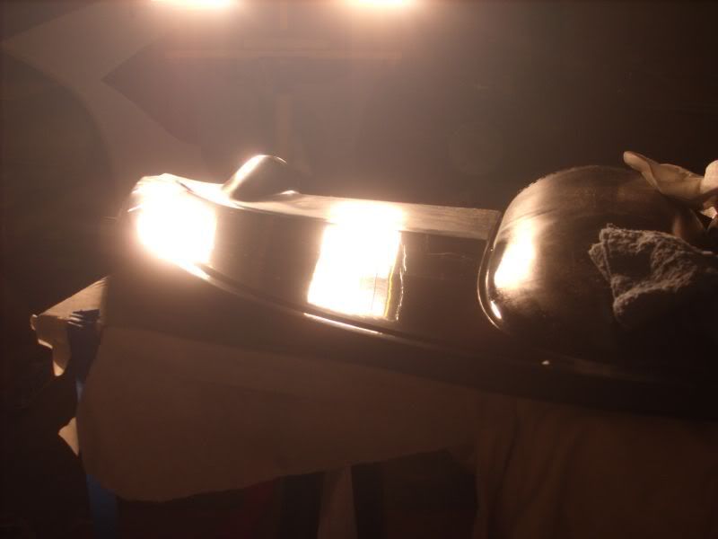

mmmmm, polished gelcoat. Note that distinct lack of micromarring in the first picture at the camera flash, as well as the depth/clarity of the 1000watt hallogen reflections. I meant to take some pictures with it on the car to show the night/day difference, but I forget until after I had stuff off. Oh well, there's always later.
The micromarring is easy to see in person; in photos, the best way to tell is just from the reflection of the hallogens - 1st picture you can see them, but kind of fuzzy (not perfect clarity); perfect clarity in the last pictures though.

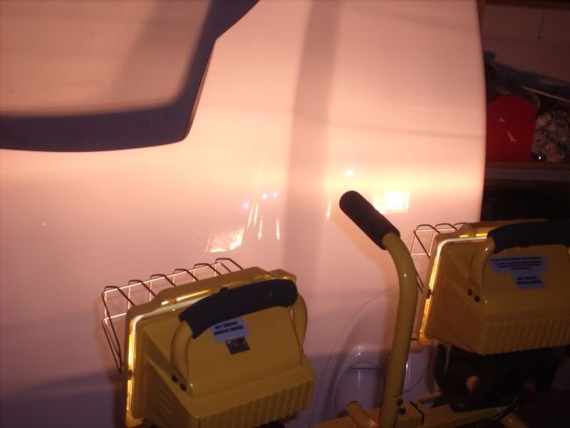

Alrighty; a week laterish and I finally wetsanded and polished the entire body. Came out great.
Blah, white is too hard to photograph well to show the difference, especially with a crappy camera.

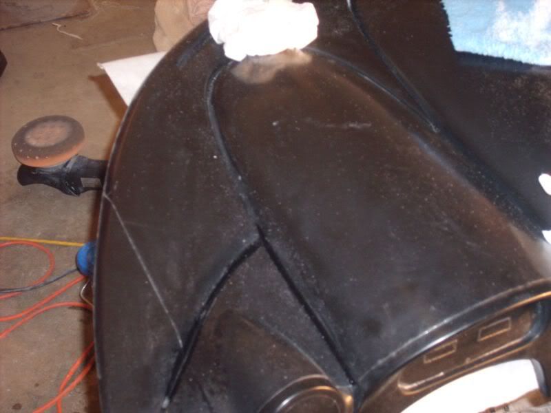

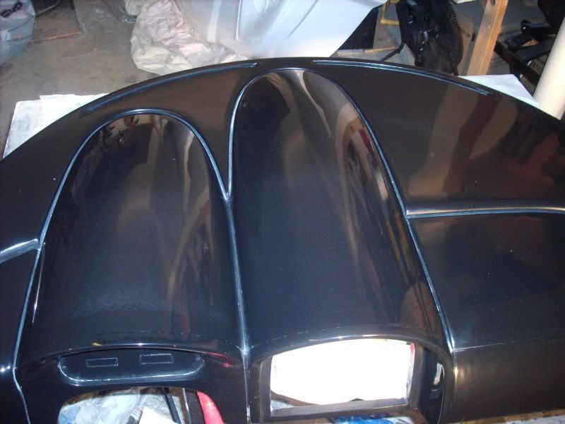

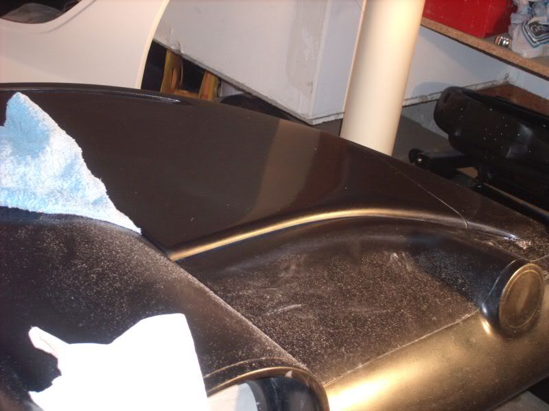

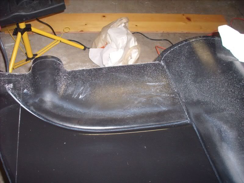

because I'm a sucker for punishment I started polishing the dash. The first person to point out that I'm going to spend 12+hrs wetsanding and polishign the dash, only to cover it with leather when I'm finished, is going to get a swift kick in the groin :lipsrsealed:
Unpolished
Mmmm, polished piece

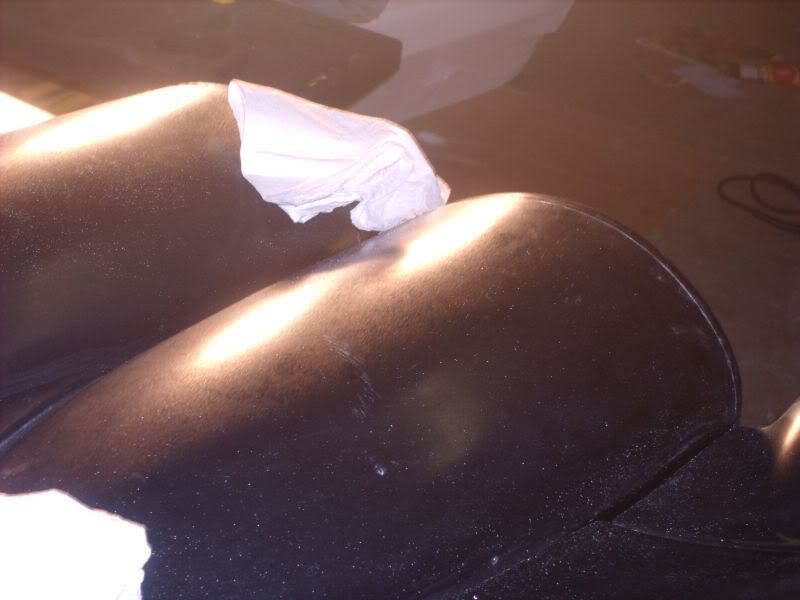

I never want to see this dash again, lol. All finished. I hate being obsessive compulsive :laugh:
nb: on the digidash barnacle, that isn't burnthrough; that's something trapped in the gelcoat itself. I swacked it with 600 and it didn't budge, so I figured rather than obsess over it, who cares, the dash will be covered in the end.
