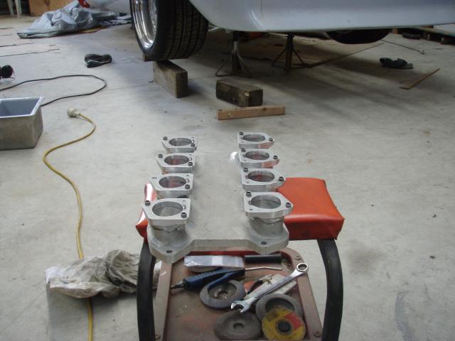

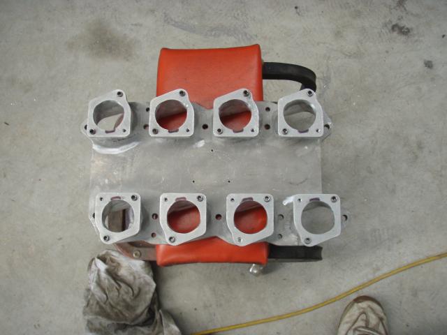

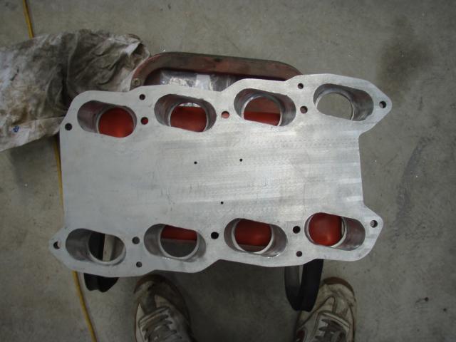

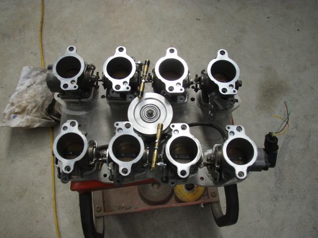

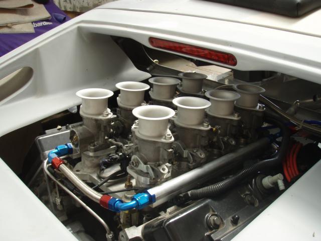

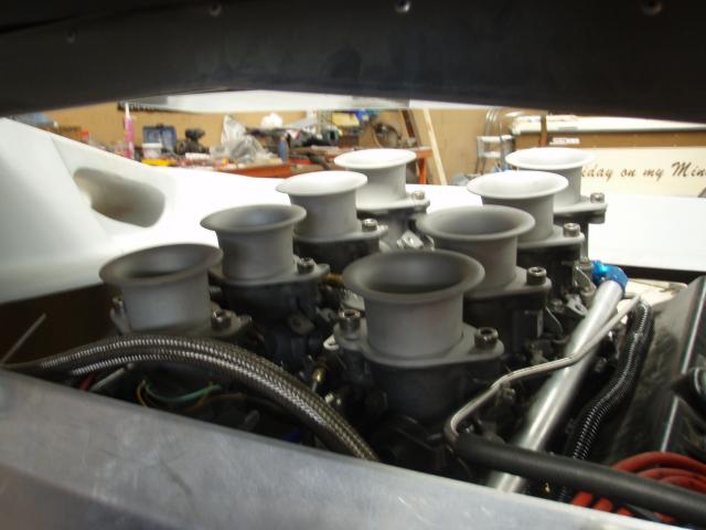

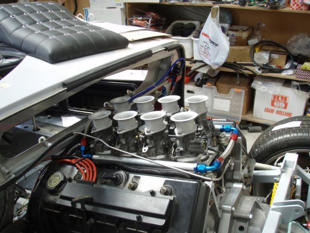

induction manifold with throttle bodies
i made this up for my 96-98 quad cam 4.6 , the throttle bodies are from a 2.0 toyota engine.i have not run the engine yet so not sure wether it works .

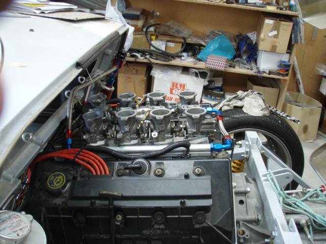

at this stage i plan on ram tubes/trumpets and filter socks.i like the old school look in the back window.
cheers Ali
A very nice bit of engineering. No doubt a lot cheaper than a set of Webers.
Keep up the good work :thumbsup:
Regards
Andy
by the time i put some trumpets on and not counting my time this setup should owe me around nzd 1750.i could not buy a manifold to suit my engine anyway and im pleased with the end result.
cheers Ali

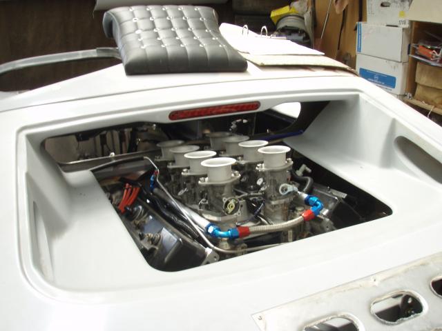

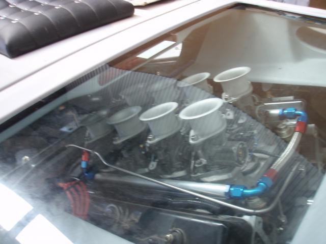

got some trumpets made to top off my induction system,not sure wether to polish or anodise them.

those tb:s look very interesting!!.. I would really like too know wich toyota 2.0l enigne they come from.. seems too be a simple and inexpensive way too get a weber style injection system...
Hi Tobias,
there are two engines you can get them from toyota 4age 101 silvertop and 4age111 blacktop,the blacktop ones are preferable they are 44mm dia instead of 42mm dia.
cheers Ali
