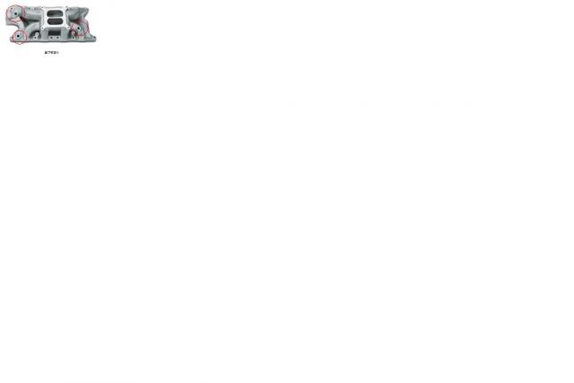

Apologies for the dumb question, but I have lost the manual and need some guidance. What are the three ports highlighted (feintly) for on the RPM Air-Gap manifold

Brett,
i believe top left is for the heater fitting, bottom left is temp sender and on the right is the vacuum port.
Simon, Randy, Anyone
What is the usual size of the heater fitting, as I thought it was that... but it is massive on my manifold i.e. my old 5/8 heater hose fitting is too small!
Brett
Brett I believe that they are drilled and taped for 1/2" NPT. You can get brass reducers at your local home improvement store in the hardware section.
Malcolm
Brett, I have this manifold on my engine. If you want for a picture, ask away. One thing to note that it is a tall manifold compared to some I have had. With my holley on top I do not run an air filter (potential for problems I know) as the filter hits my rear screen. If you are running Roys lowered engine mounts you should not have this problem.
As to fittings I use top left for a air bleed off point. Bottom left is where my temp sender plugs in and I have blanked off the rear one (at least I think I have!) as my vacuum comes from the base of the carb.
