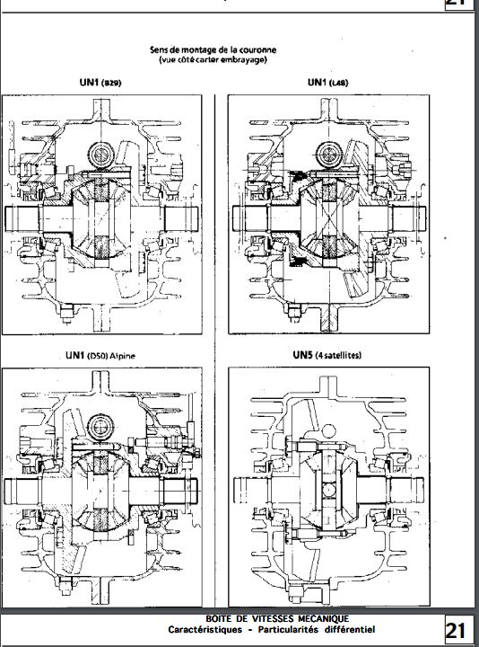

Hello,
Wich gearbox do you use? un1-XX. Let us know the XX value.
Anyway, if your gearbox comes from a renault 25, renault 21, espace V6, it is already in the right position.
If it comes from other donors such as alpine, you need to invert the differential.
If you don't know your donor, the test is simple :
enage first gear on the gearbox. Turn the input shaft clockwise (as per your engine rotation or counter clockwise in case of any boat engine...) and look if the axle shafts turn clockwise or counter clockwise, then you will know if you need to invert the differential or not.
if you need to invert it, you just have to open the gearbox, flip the differential and reclose..very easy to do

Kev Farrington from the North West area has an inverted Renault in his car. Send me a PM and will send you his contact details or you can find him in the club members list that members get each year.
