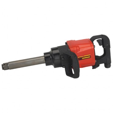

Is 1" too big??
I just bought a (very large) 1" impact wrench from harbor freight. It's supposed to deliver about 1,400 ft/lbs of torque on about 10 CFM at 100psi. I bought it because I occasionally have to do some heavy work (crank pulley bolt on a mercedes V8 takes about 275 ft/lbs, for example...). The latest one is that I would like to remove the CV axles from my CAV to replace/rebuild the CVs...and the outboard nut (hub end) is on hella tight. It looks very dry and a little corroded. I've tried a three foot breaker bar with my full weight (~600 ft/lbs) and no dice. So, I'd like to try the impact wrench on it.
My problem is that I think I must be short on air. The impact wrench has a 1/2 inch NPT inlet which I reduced down to 3/8th with a reducer....then further reduced it down to the regular 1/4 fitting size (what you normally have on say a 1/2 inch impact wrench). I have a newish 5hp Craftsman air compressor with a standard size air hose (1/4 air fittings). With pressure cranked up and full tank of compressed air, the impact wrench barely turns. It certainly doesn't deliver any meaningful impact torque.
Do I need to re-plumb from the tank out with a larger diameter hose? Get a bigger air compressor?
If nothing else, I'll remove the wheels and the pin drive hub and then use a dremel tool on the nut with a cold chisel to crack it....was just hoping to be able to use my new big toy instead...
Any advice/help is appreciated.

I'm rather sceptical of the 10CFM requirement for that tool. I would imagine a 5hp compressor would deliver twice that anyway.
Your hoses and fittings are too restrictive. Make sure you have big orifices everywhere in your supply line. Remember the cross sectional area of a 1/2 " fitting will be about four times that of a 1/4" . Thus your 1/4" fittings will be hugely restrictive to the necessary airflow. With air tool lines big is always better!
The other thing, have you lubed the vanes in the gun? If they are dry they may not be sealing and much of the air could be getting past them. They will hardly turn when this happens.
Thank you Russ, that's good advice. Thinking about it last night after I posted I realized I hadn't put any oil into the thing to get the vanes lubed - will do that now. I'll also up-size the line as you suggest. I think the outlet on the compressor is 3/8th if not 1/2 so shouldn't be too tough.

An honest steady-state 5HP compressor will deliver about 15 cfm. I takes 7.5 HP to get to 20. BUT.... Sears (and others) play games with HP ratings such that what they call a 5HP compressor is very likely good for 12 cfm at best.
Also, don't forget that with the tank full, until the motor kicks in, the energy provided by the compressor is unaffected by motor size and determined only by these things:
  1. The instantaneous pressure in the tank (starting out at whatever the blowoff valve or regulator is set to; obviously you want this as high as possible consistent with the rating of the tool and the tank).
  2. The air flow restriction of the downstream hoses, etc.
So, after the motor has shut down, if you're not getting what you want when you first hit the trigger, look at pressure and air flow. Also, keep the hoses as short as possible. With all that optimized, for a short burst the tank can provide way more than the steady-state rating of the compressor as a whole which is determined by the motor size.

I up-sized the air lines today and cleared out some accumulated crud in the filters and quick disconnect fittings. Now the impact wrench is working like it should - in other words, it just about twists your arm off when you grab the trigger. As suggested above, I could probably break those nuts free now with a good 1/2 impact. I'll go wrestle with it a bit more. Wait until the kids have gone to sleep and get my helper (my wife) out there to step on the brake pedal....maybe I'll put on some Marvin Gaye on the new garage audio system and see what else she can help with....
