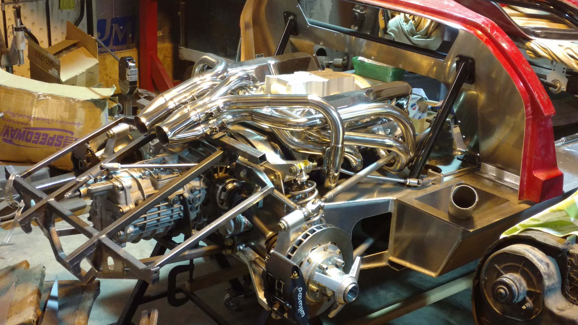

I've installed an FE in my car with the 930 trans-axle. It's a tight fit and the exhaust had to be routed with a bit of imagination but its in. The alternator and the compressor will be tight as well but it looks like it will work without opening up holes in the tub. Fran told me the biggest issue will be the heat and of course it won't be as nimble as a small block. It's going to be a street rod and nimble isn't greatly important. My biggest concern is there being more car than driver. I'll cope somehow....:) I like the way it looks and how it transports me back to when I was a kid and saw a real Mk II in person right after LeMans. That has always been the high water mark for me.
Gale
Major components installed.

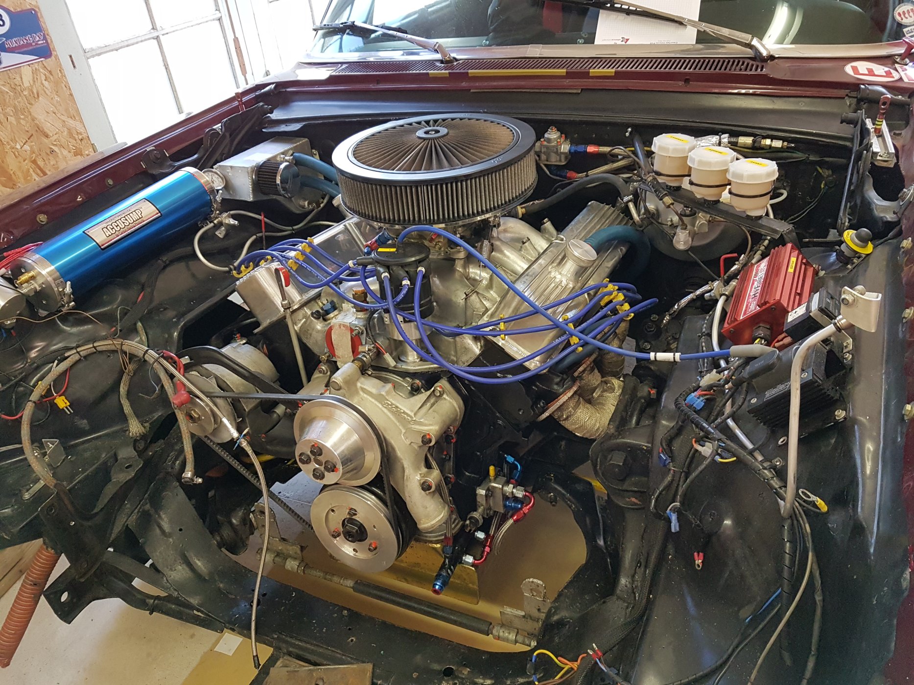

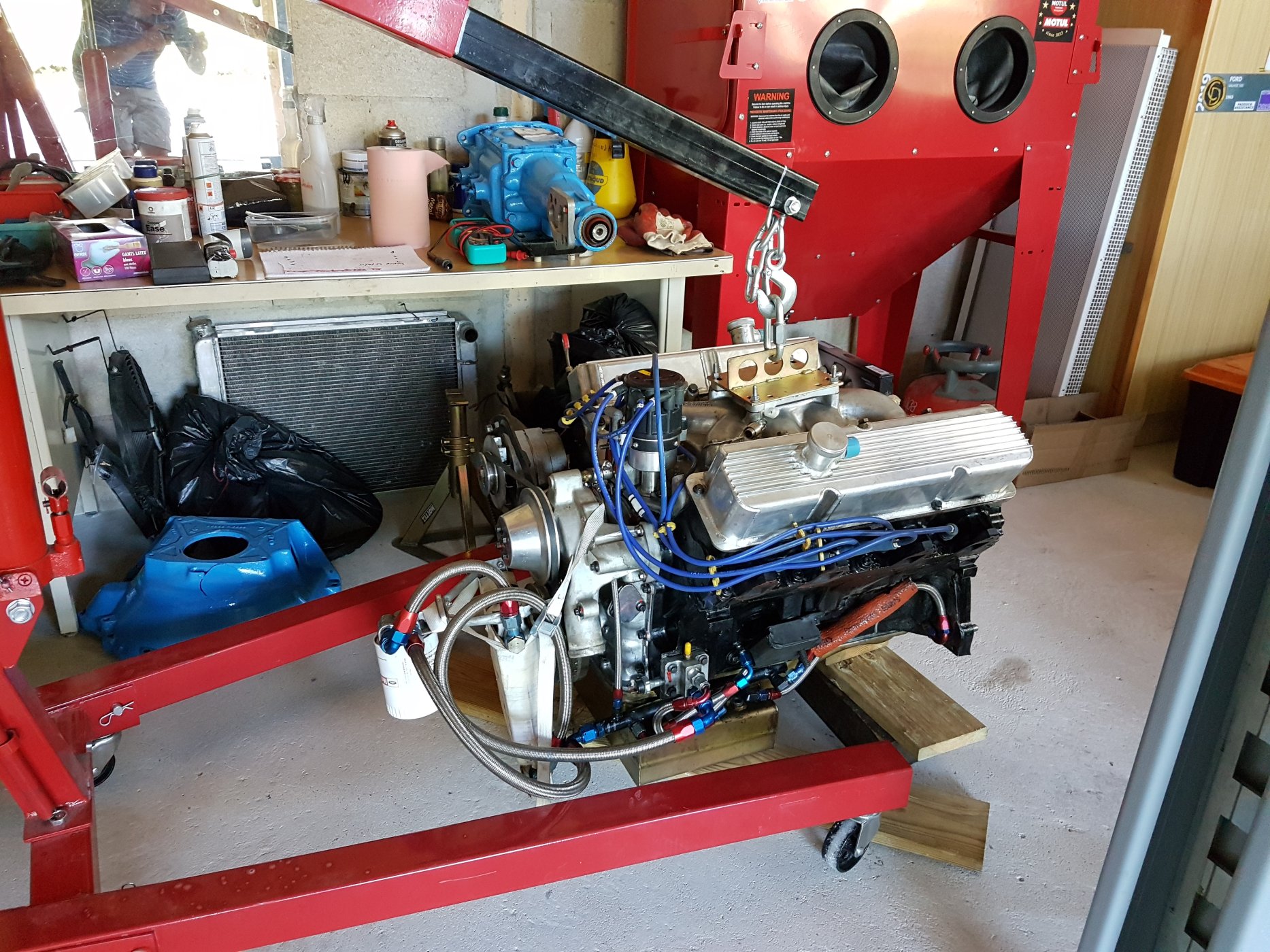

The reason I am anserving is because I know very well the 427. I built a 63 1/2 Galaxie with a 427 big block Tunnel Port (close to the Le Mans version) that I use on track days. My engine has every think inside to make a good engine and is giving about 520 hp at 6000rpm.
Even if you think this will create a version more conformed to the Le Mans car, you have to consider several desavantages, some were already mentionned; like the size. I wish to insist on the heat, this engine is generating a lot of heat, even in a big car like the Galaxie, you feel it, I cannot imagine what will happen in a GT40.
The second problem is the weight ; you will put 300lbs more in your car and may be only 100HP more compare to a small block. Of course the torque is gigantic, but do you need it for a light car like this ? Ford used some GT40 in Le Mans with an automatic transmission and only 2 gears. With the Galaxie on some race track I only use 2 gears on the 4 available because of the torque and the car weight 3700lbs. Your GT40 will loos the vivacity and you will never use the 5 speed. Regarding the gear box I thing the ZF will handle it, I use a standard 4 speeds top loader, but I do not know if the end ratio will handle the torque compare to a 9in with a Detroit Locker on the Galaxie. But you will need a reinforced clutch.
Another problem is the sensitivity to a good lubrification. Oil circuit needs to be optimized, and if you do not use the dry sump, I strongly suggest you put an Accusump because the lateral G obtained with the GT40 will kill the engine quickly.
I hope it helps !
