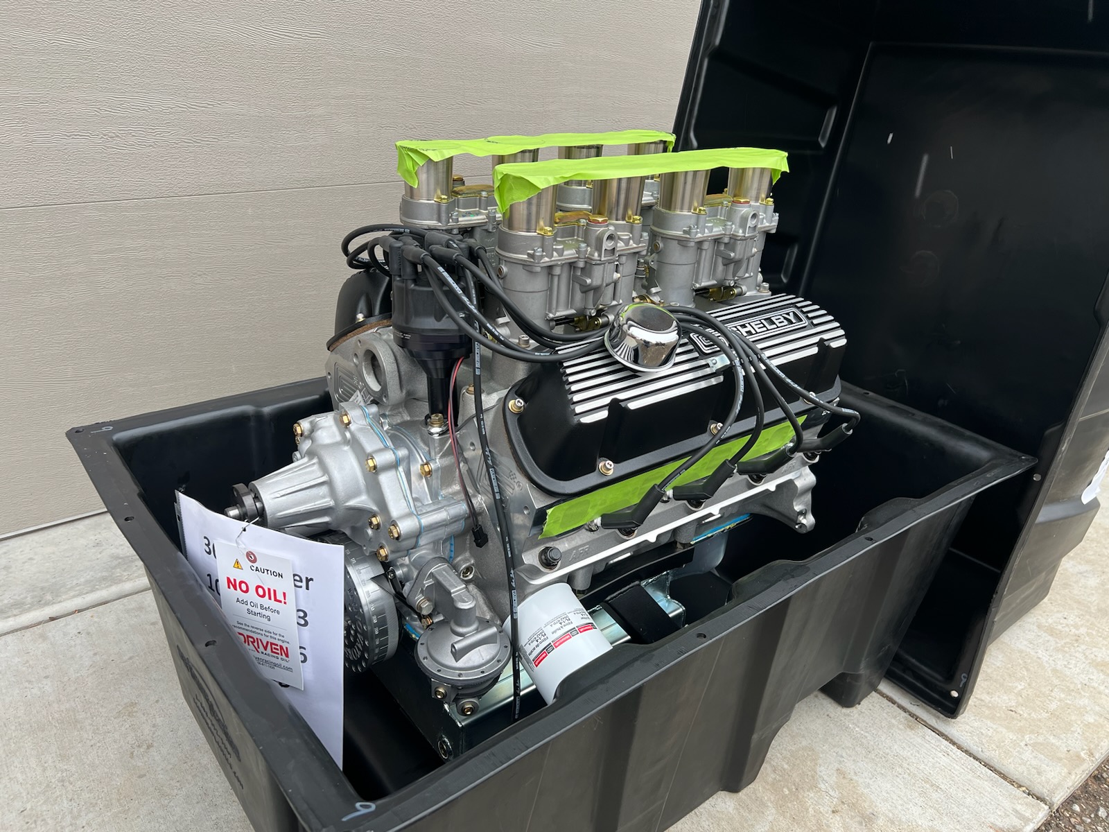

Hey Pat
I have a 302/364 Dan Baste Shelby engine
Alloy Webers 595 HP Brand new engine
That I will sell.. Expensive
Ron
