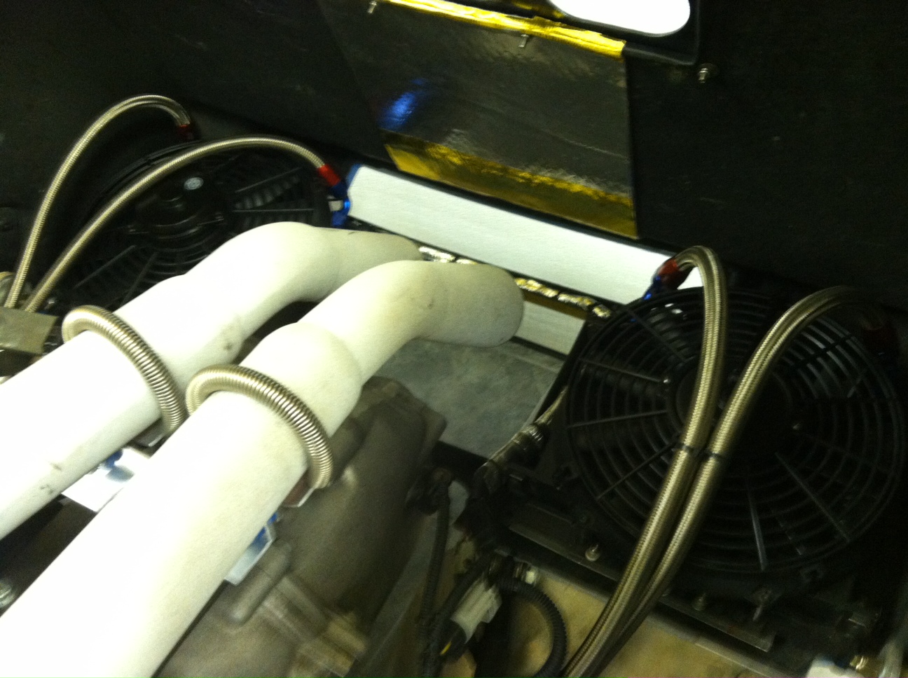

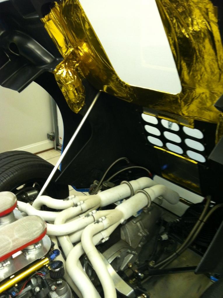

I made a prop. I also finished my rear plumbing and fans. The right is the oil cooler, the left is transaxle cooler. The fans help pull heat from under the rear clip when the car is at rest. I do not have them on a thermostat, I simply have a switch on the dash.

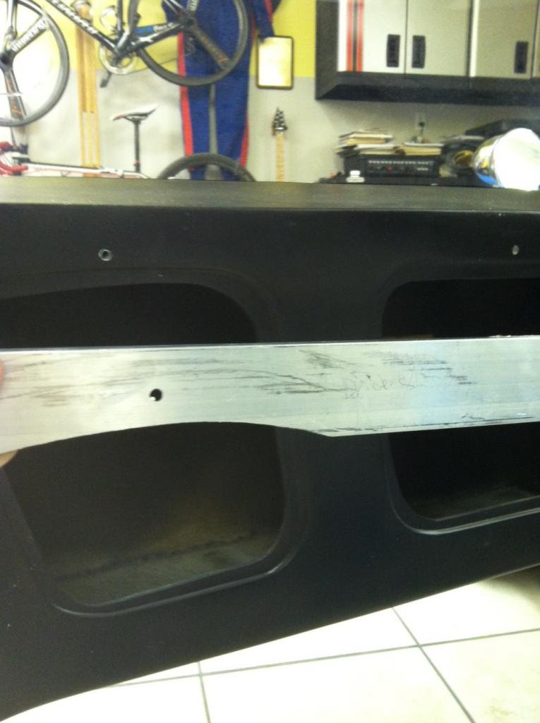

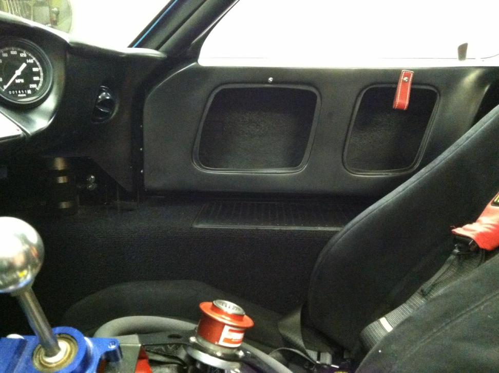

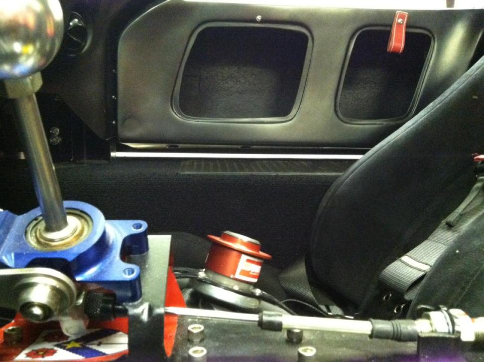

I found out the hard way that the door liners are not particularly robust. I decided to add some door pulls. I reinforced the upper edge of the door with some angle aluminum. I used body filler to bond the aluminum in place and fill the gaps in between the door liner and the aluminum as it is not flat. Once finished, the door has a more solid feel and the pulls are nicely anchored.
I found these red leather pulls. They were crazy expensive, designed as high-end furniture pulls. Luckily I only need two, because I can't imagine spending that much money on every drawer and cabinet in a big kitchen.

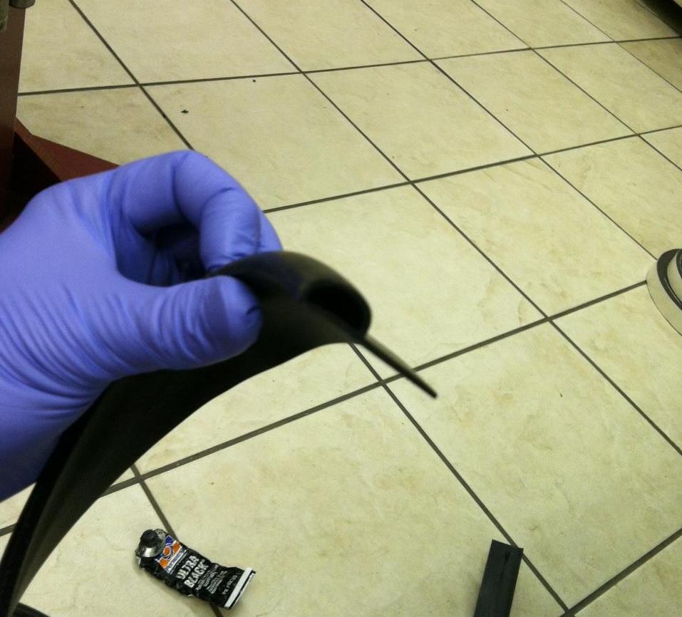

I started with the lower door edge. My gap is about 3/8 inch, which is not too bad from the outside, but there is nothing behind the lower edge, so look at that daylight when the door is closed!
I found a 3/8 inch flat bottomed, beaded weather strip at McMaster-Carr, 1142A15. It is easy to install and seals nicely. I used good old black silicone, figuring it will not last forever so at some point it will need to be removed. Next up will be that pesky front section, and I fear I will have to get creative.

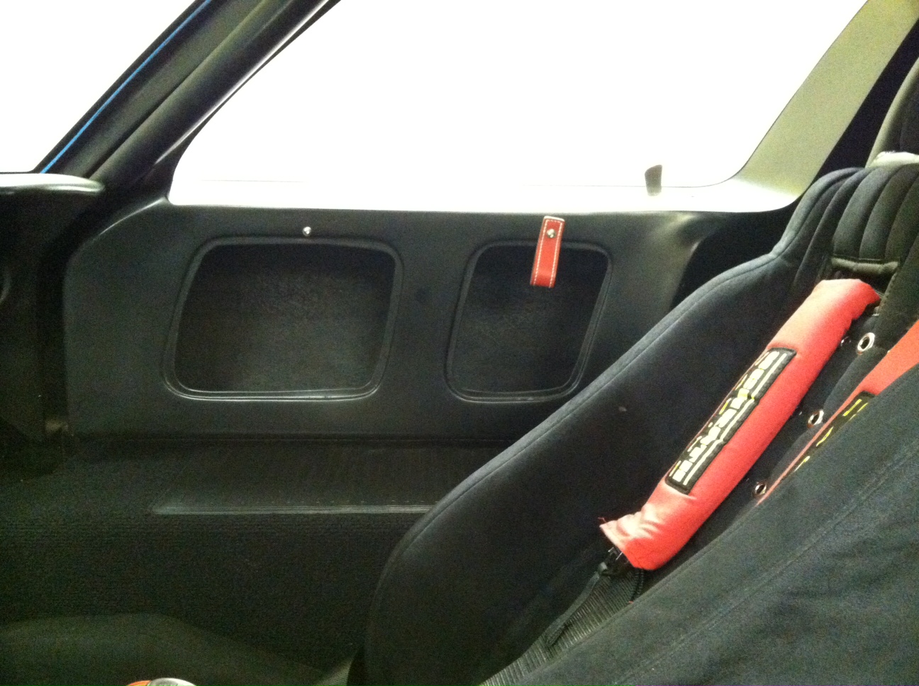

I most recently lined the door pockets with a felt-like carpet that is perfect. Now things don't slide around or rattle.
