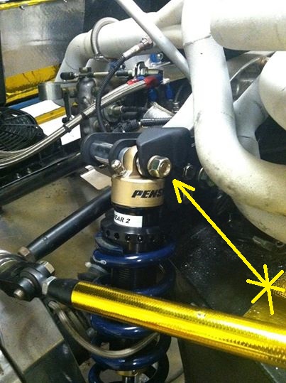

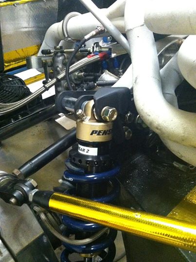

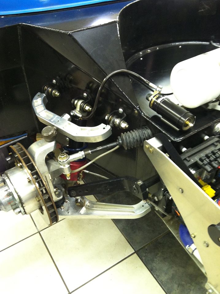

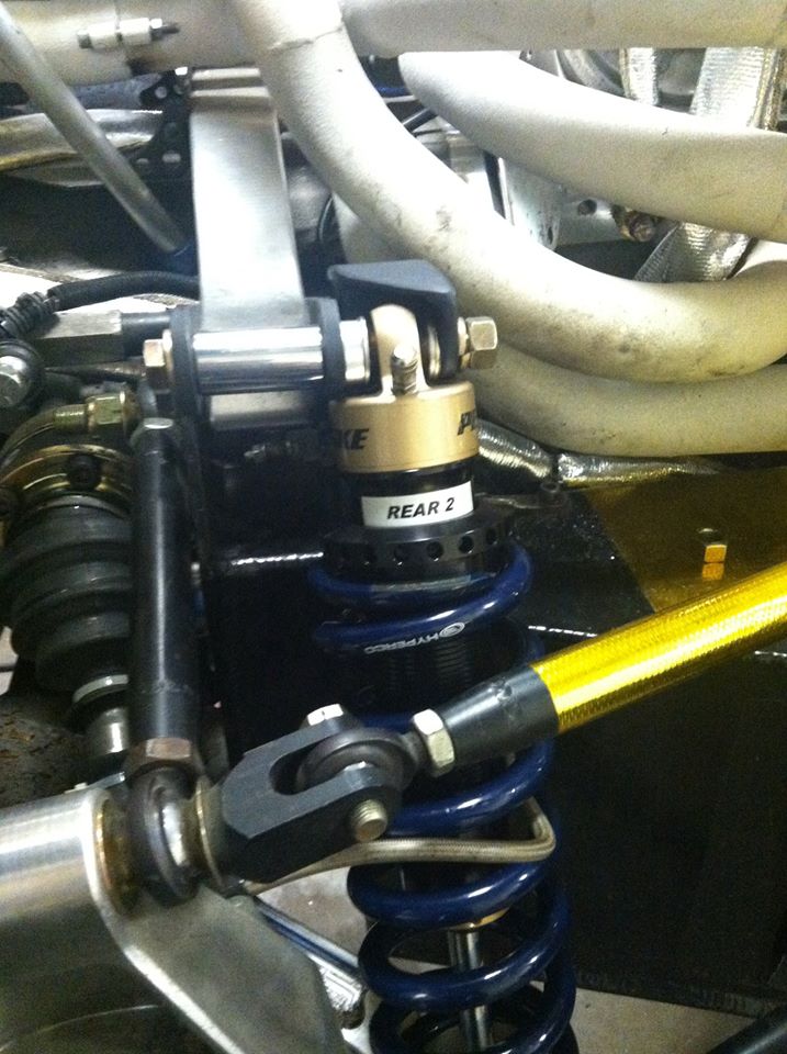

New tires, and installed the Penske shocks. It was a little tricky because the rear shocks would not fit with the rear cant that was present in the stock location. So we had to fabricate new upper shock mounts. The rears are now dead vertical. The fronts bolted right up but the remote reservoirs were necessary with the shorter shock body so they had to be secured. Between fresh rubber and custom valved shocks, I think it is fair to say the car is absolutely transformed!

Nice work as usual Jay..

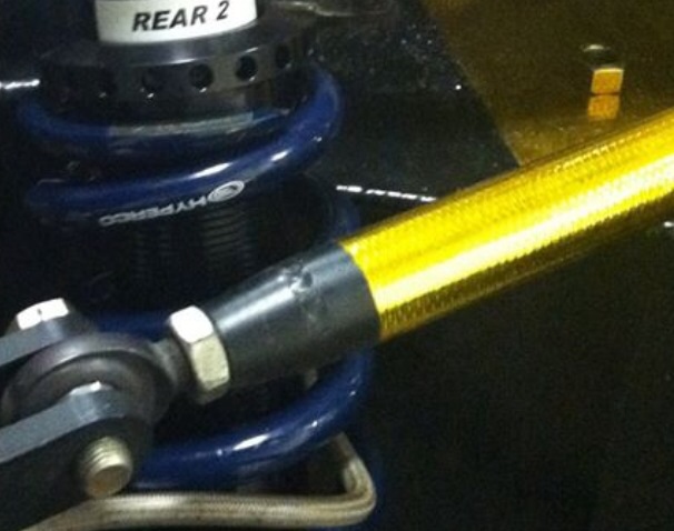

Don't forget to pick up the loose nut on the sill in the upper right of this picture and install it on the upper control arm clevis in the lower left of this picture.. Might not be too pretty if it were to come apart!
That clevis may be threaded now that I think about it.. Can't seem to remember for sure..
Oh well - if nothing else, there's a loose nut for you! :lipsrsealed:
Easy folks... was just a test fit. Notice the rear brake line is about to be crushed in the spring! (did you miss that?) They have been moved, everything redone, tightened and checked. But I do appreciate the eagle eyes here!

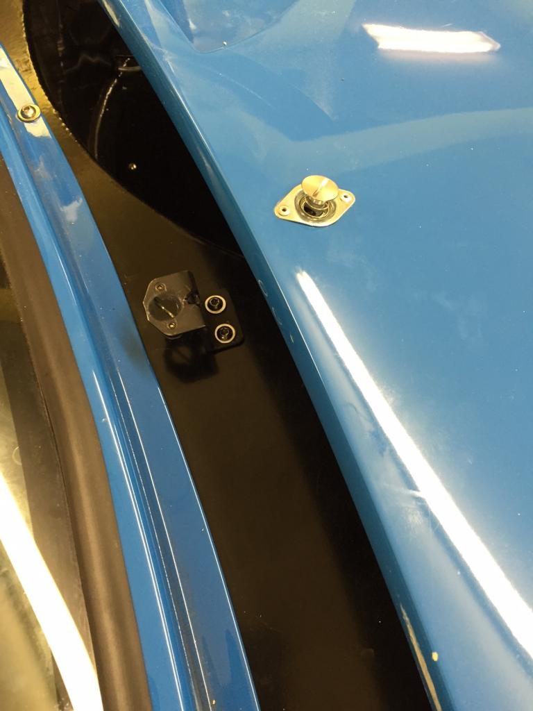

The front clip shakes side to side some. I am going to add a couple of fasteners just ahead of the wind screen to hold it better.
Also, I found the main entrance of air and dirt and leaves...you can see right in to the cabin from the front wheel well. I am going to fix some rubber spats that will seal this and still allow the front clip to be taken on and off as it does now.

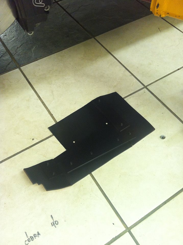

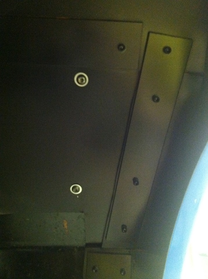

I made spats for the front wheel wells. They are sheet metal with pieces of 1/4" sheet rubber riveted on to seal to the body. Both are held on by two screws and must be removed when pulling the front clip. The AC works much better now, kept the car comfortable mid day 90 degrees.

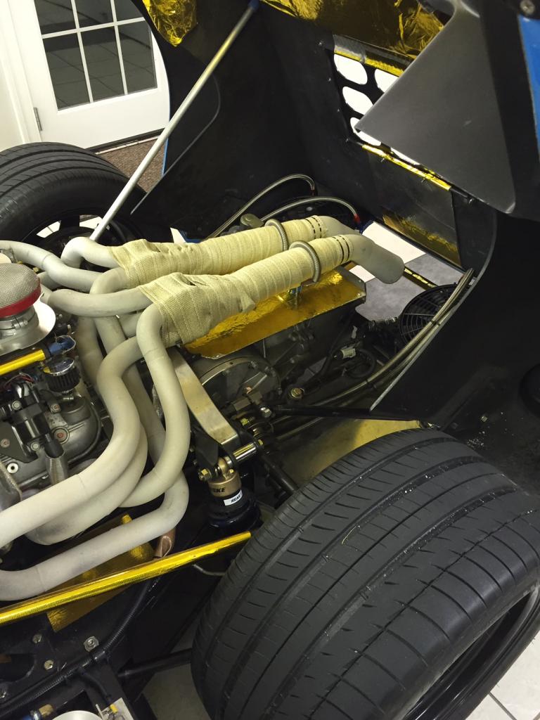

It took a custom heat shield and header wrap, but the transaxle is now happy.
I had no idea how much the front clip moved about until I added some additional fasteners to keep it from wobbling.

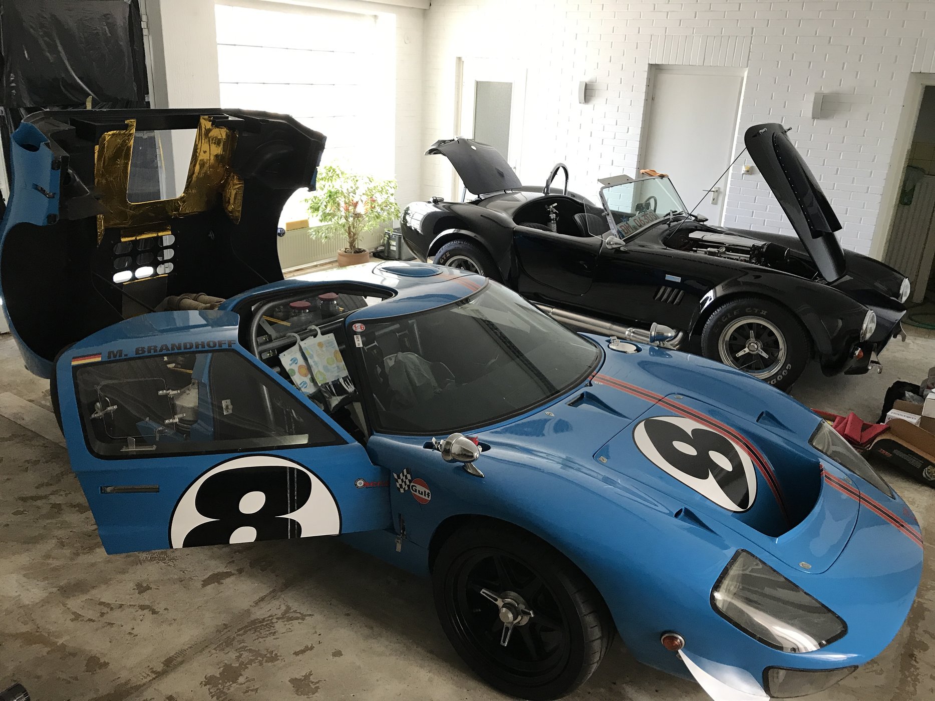

Dear John, dear All,
I would like to introduce myself to this forum and especially to this blog, RCR0046.
In short: I am located in Germany and have become the 4th owner of this incredible car!
Once I get settled in with her, get her cleaned and give her a little service, I will start out with telling the story behind getting her home to me.
Cheers!

So summer break is over and went back to office work. So far I had no chance to take her for a spin... :-(
Got to adjust the pedals to my size 5’6”.... Sportscar size btw!
Then the oil needs an urgent change, it collected moisture during the transport and down time at the harbor...
I will switch back to a 5W30 Mobil1, it’s slightly colder in GY...

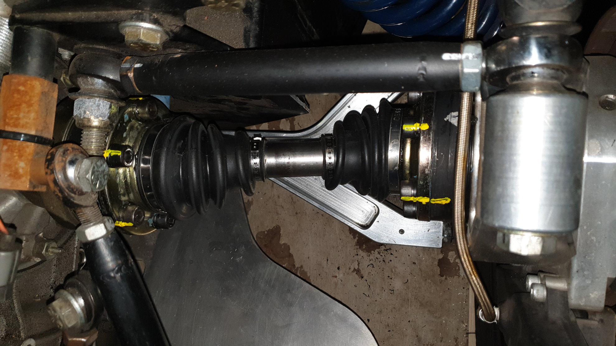

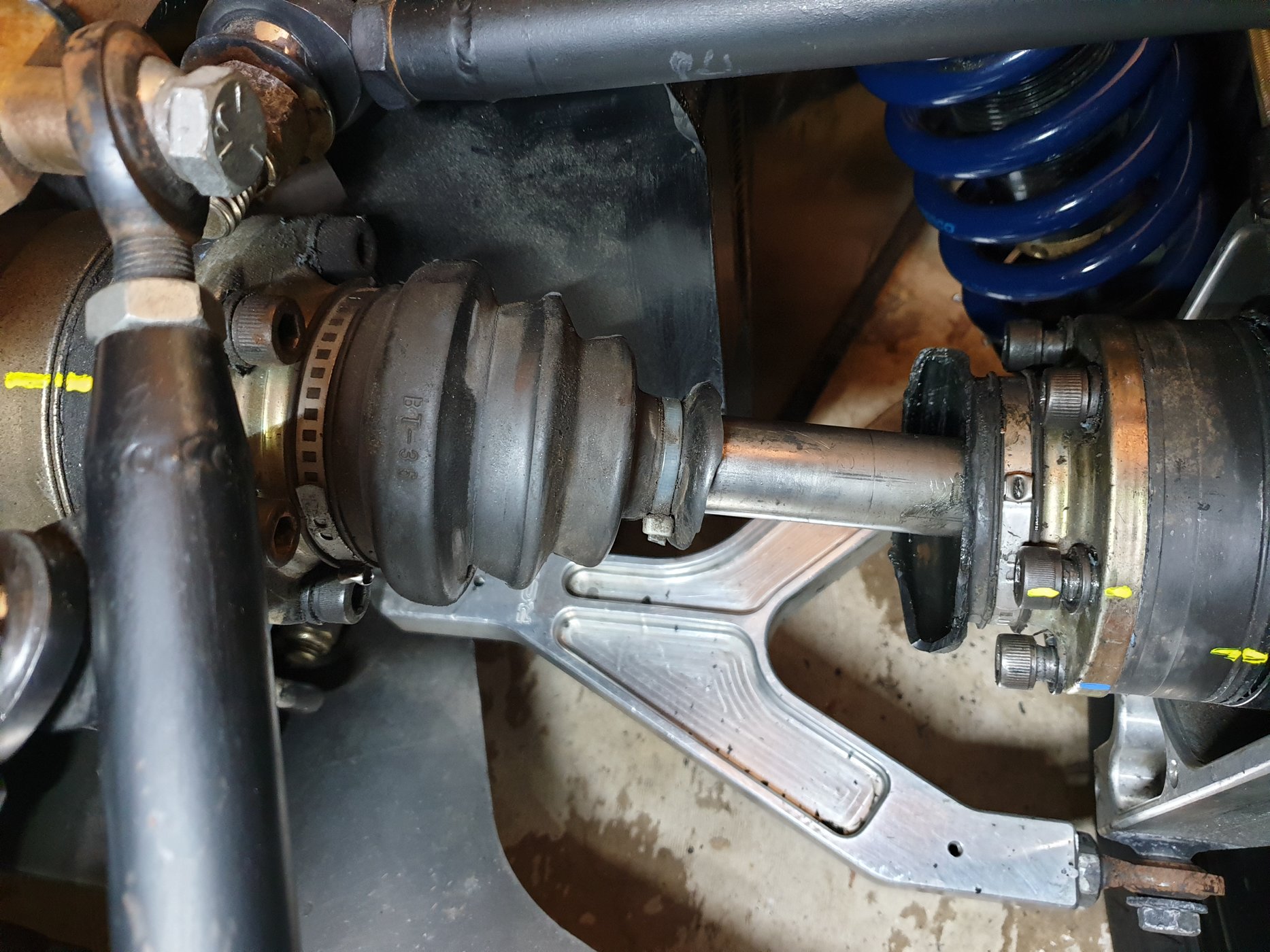

ever since my last post, the drive shaft bellow went bust... what a mess. Had to clean out the engine bay from all that graphite grease.:mad:
Anyhow, got some new bellows and loosened the shafts today. Hope to get all replaced and re-fitted by next week...
So,..., work kept me from tinkering. But now the shafts are cleaned, fitted and marked... The bolts were tightened with 70 Nm, seems to be right. Since they are marked I should be able to detect any loosening right off the bat.
