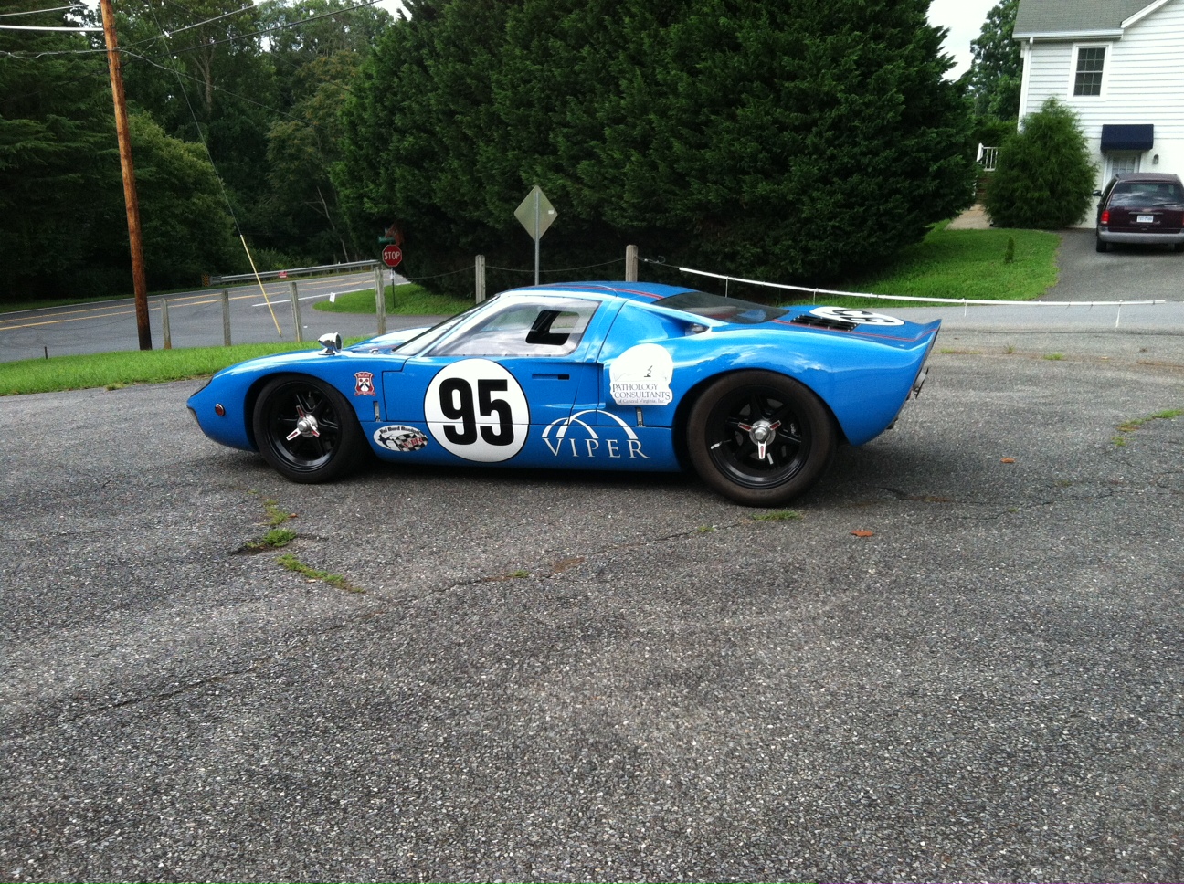

I took the car out Memorial Day weekend for a great drive on the Blue Ridge Parkway near home. Went with a buddy who has a 360. He wanted to go for a ride, so after he signed the waiver he buckled in. The required launch with seemingly endless burnout left him laughing for 30 minutes or so!

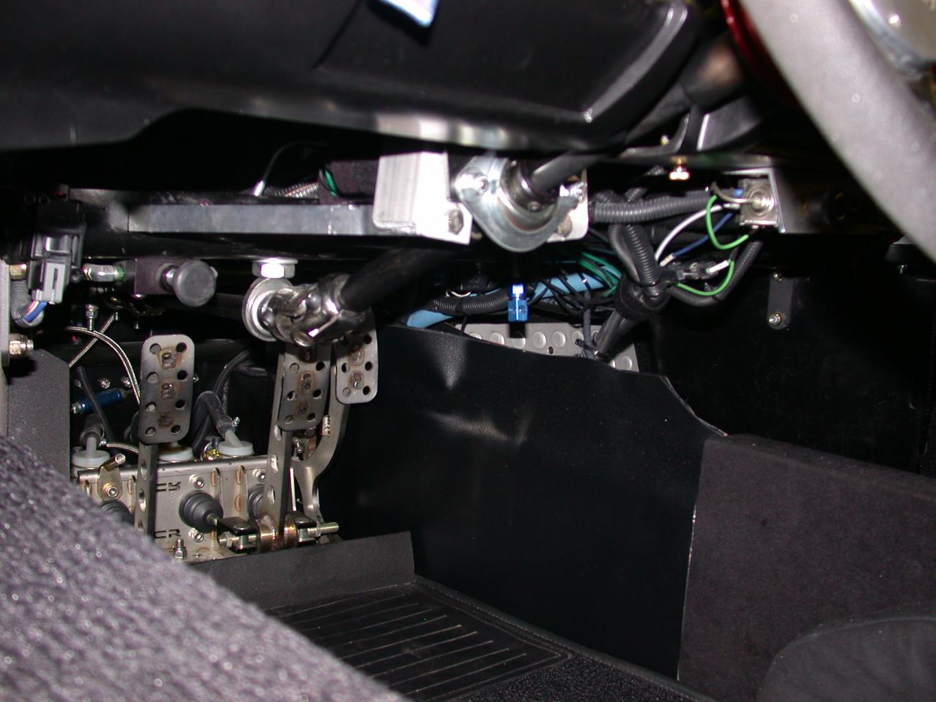

I have my head rests installed, footrest in the passenger compartment, and a heel rest for the pedals. I didn't think this last bit was important but WHAT a difference. I have a dead pedal made and that goes in next. I have the driving position so well dialed in now, it's just fantastic! The car is so much fun, such an experience, it is really out-doing my expectations, and I am just starting to get things sorted. It's going to be simply awesome. Hats off to Fran!

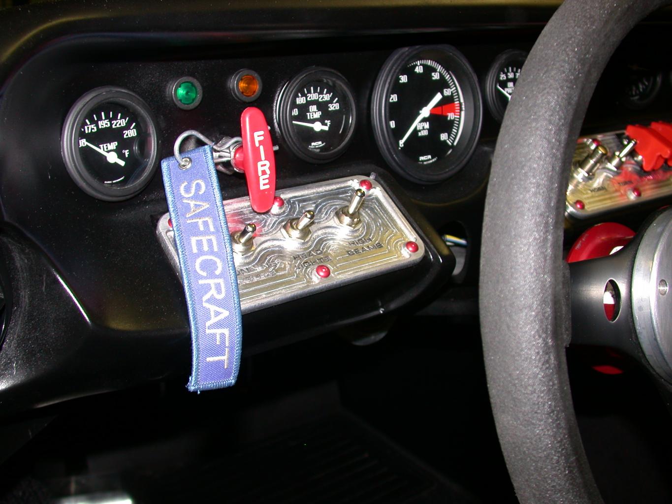

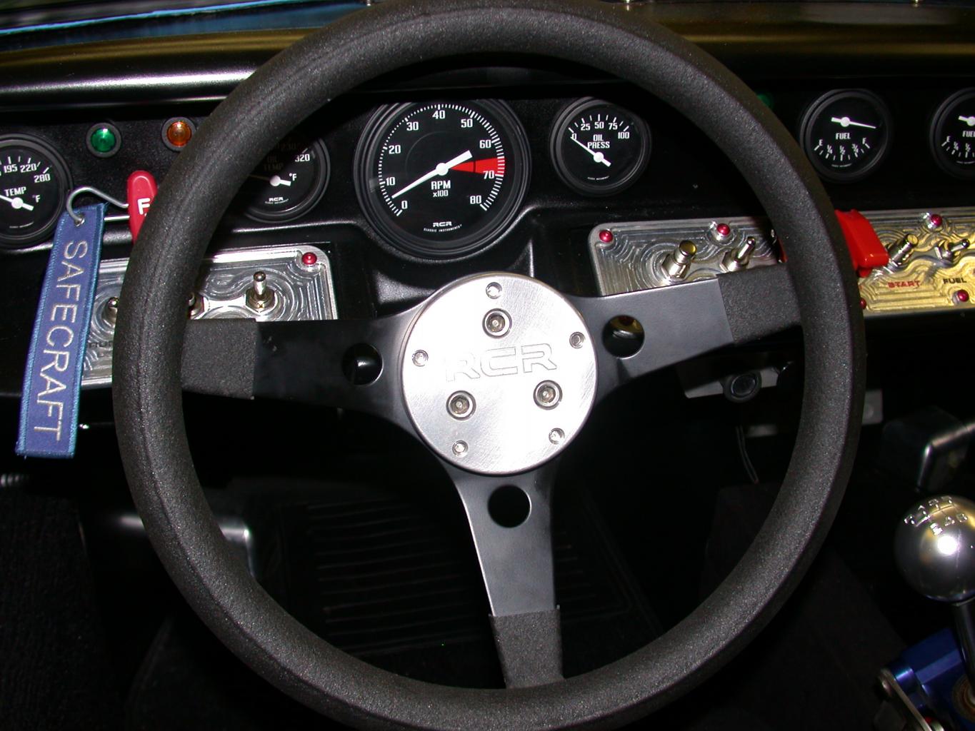

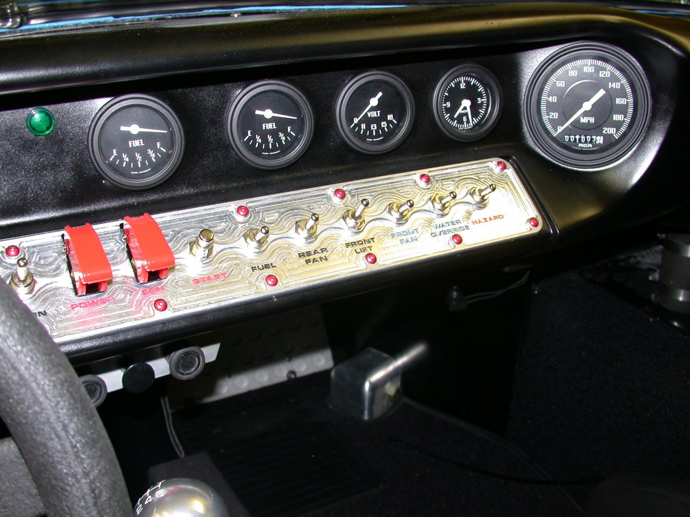

The only niggle from the drive was the dash wiring. In the two years it was at the guy that was supposed to be doing my body work, the dash was almost ruined, inside and out. There are misaligned nutserts with cracked fiberglass, the oil temp gauge no longer works, and the switch wiring is all bungled. The dash is even painted gloss black, when we discussed anything BUT gloss. Word of advice: no matter what you think of your own skills, NO ONE is going to be as obsessive about your car than YOU.
So I have yanked it. Next phase is to re-do the dash and finish the interior.

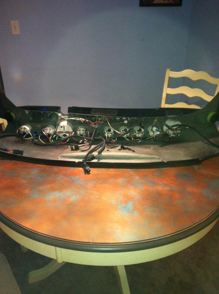

I found the wire from the oil temp sender unit. It was attached to the back of the tach...
Got the dash wiring all sorted, now to pull the seats and center console. Should get some good stuff done in the next couple of days.
Been busy getting things sorted. I took out the dash, rewired it completely, back to the way it was all intended. I found a loose connection, and noticed the oil temp sender had been connected to the 12V of the tach light. The oil temp still doesn't work but I am worried the sender got fried.
I refinished the dash and remounted my switch panels. I used t-nuts which are body-fillered in place. It came out really nice!

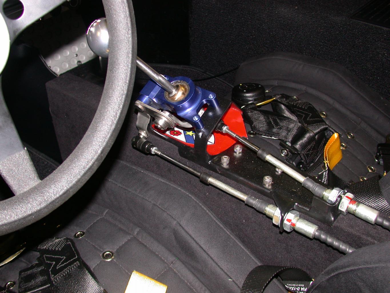

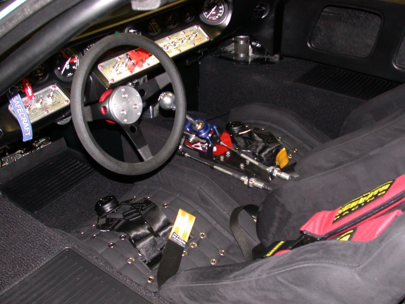

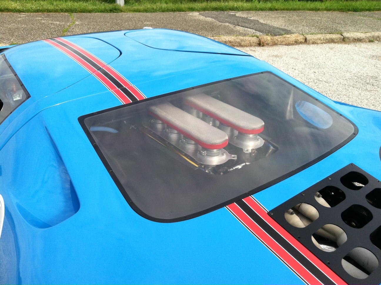

I finished the carpet and insulation. I painted the shifter mount. I covered the center console with an alcantara like fake-suede that matches the seats. I had holes in the seat covers done by a local upholstery shop, and I have my head rests in. I replaced the cracked rear glass with double pane lexan. I also hooked up the AC vents so I can actually get cold air aimed at my body, not my left thigh.

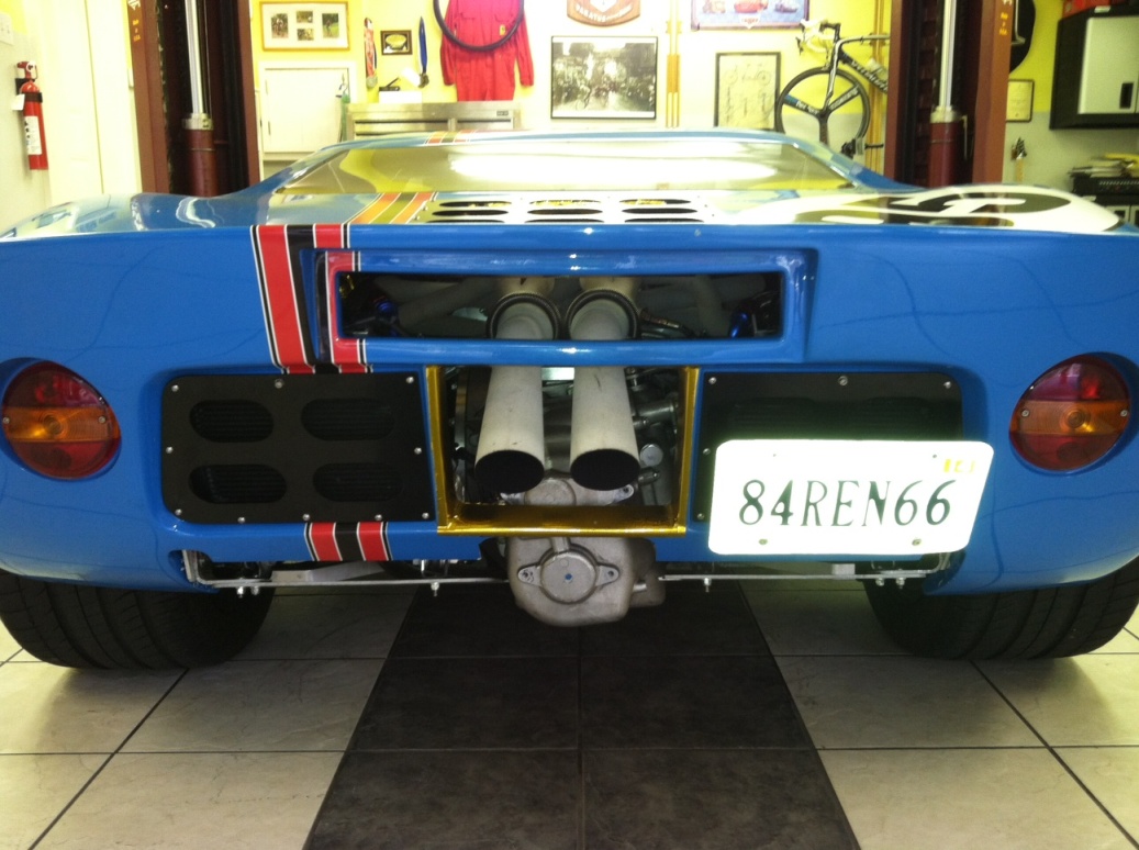

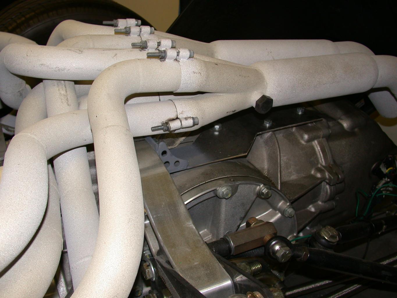

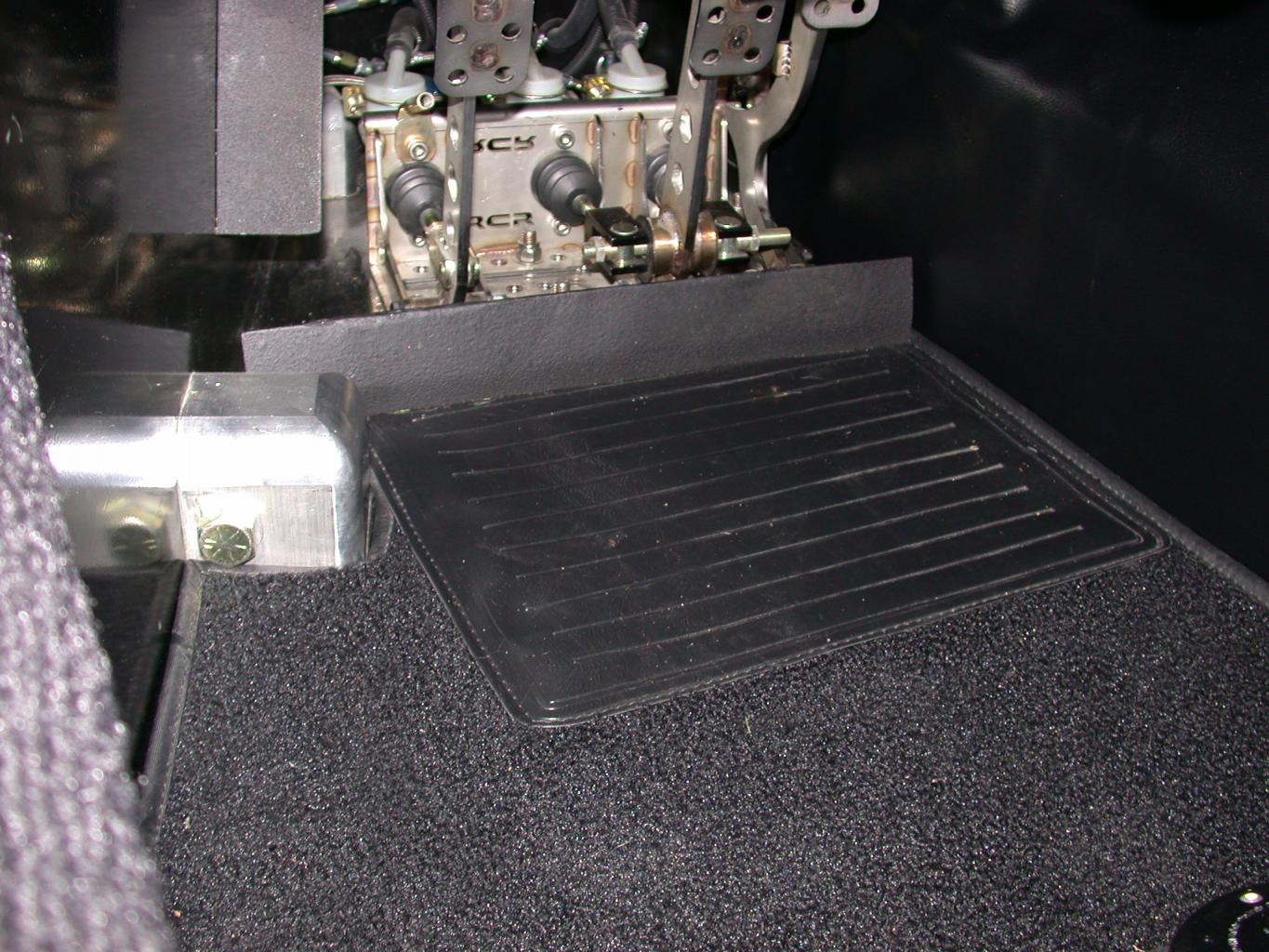

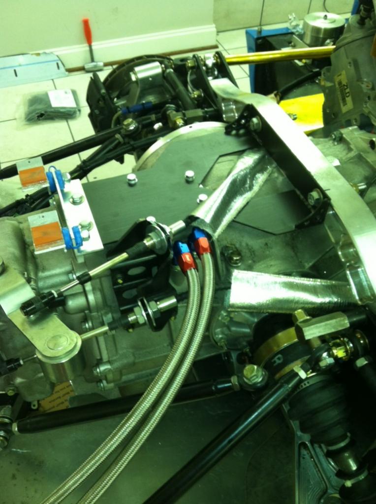

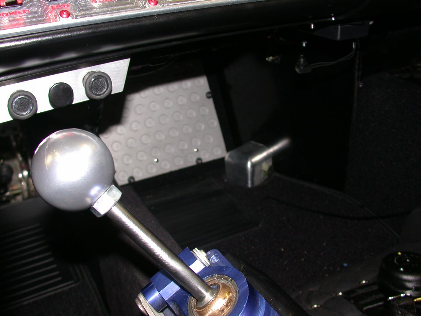

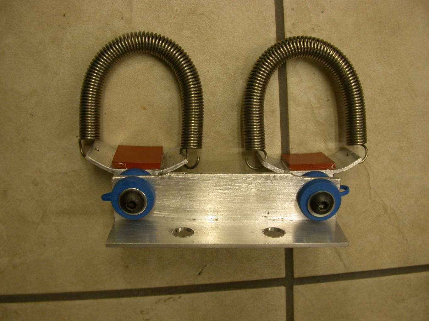

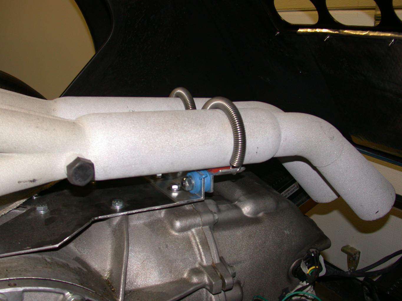

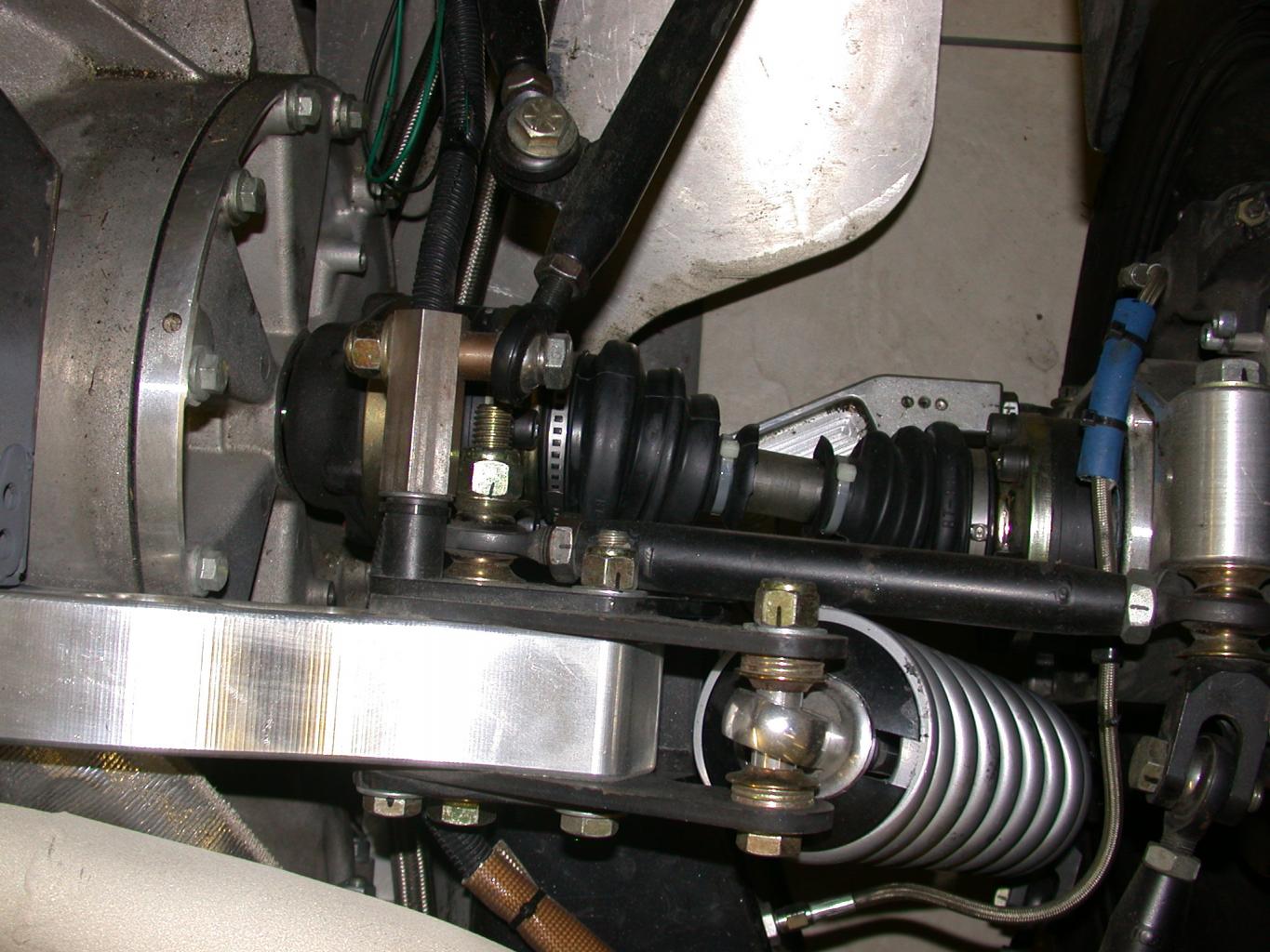

The first picture back there is the exhaust hanger I made this morning. I also added a heel stop and dead pedal. I am going to put more miles on it while I decide about the steering wheel placement, but the driving position is really really good. Here is a snap of the transmission brace they made at VIPER for the big 'ol Ricardo. My axle angle is now manageable and I have not had any additional issues with CV boots. Fingers crossed...

I found on my cv boots, zip ties in the recesses keeps them from billowing and possibly longer life. Also, the small tubes used on aerosol cans to pin point the spray pattern cut to length and placed between the axle and boot and then zip tied allows them to breath, curiously, haven't had any leakage of the lubricant.

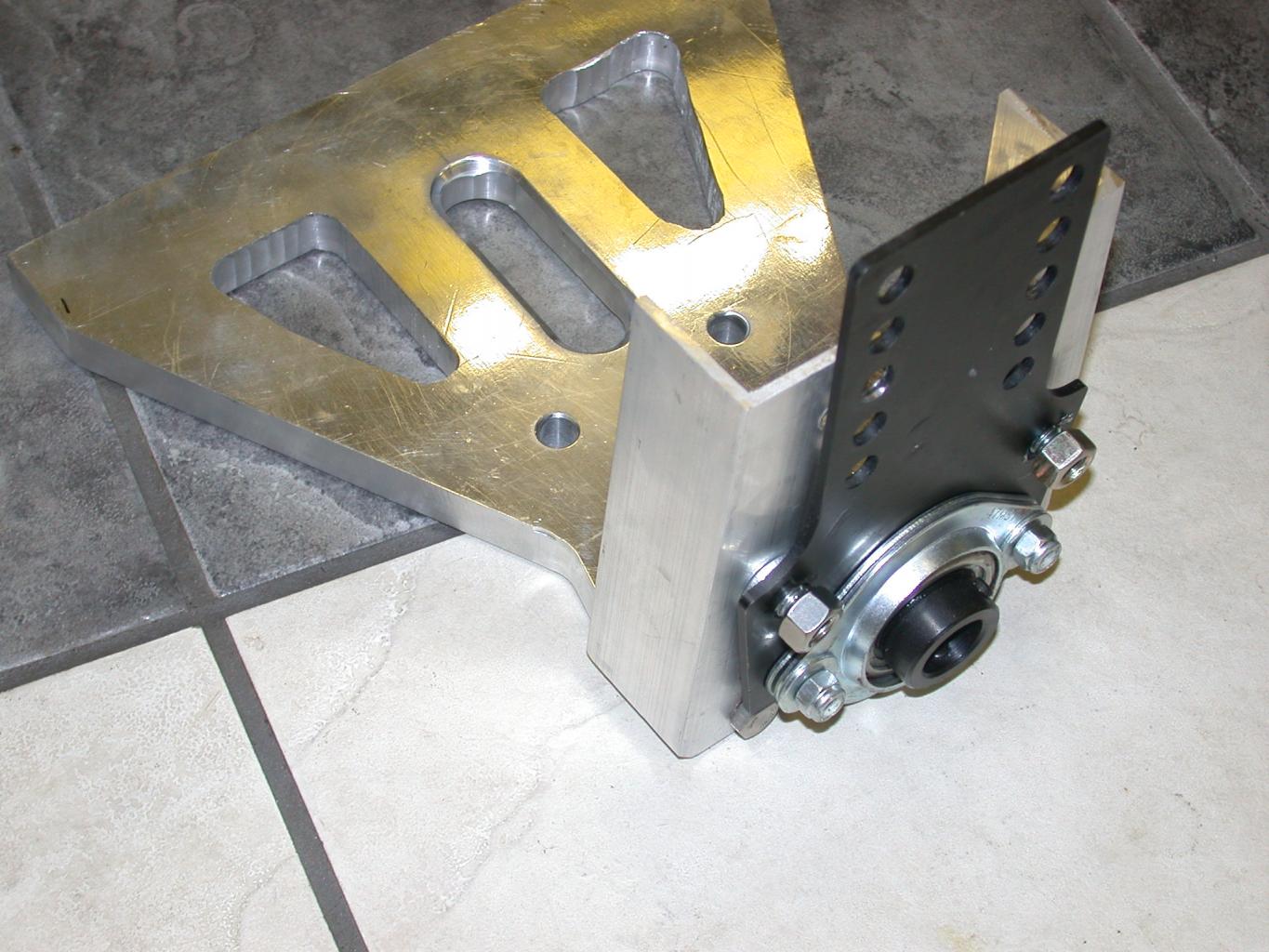

When I put in the steering, I set the wheel fairly low, as that's the way I tend to like it. I also used the Chuck and Ryan threaded rod stabilization method which certainly stiffens the bearing carrier. But this was not still not stiff enough.
So I modified a brace that was originally cut to be a transmission support. It bolts in to the holes I drilled for the threaded rods. And I used a couple of pieces of angle aluminum to further stiffen the steel plate bearing holder.
The bearing itself now is absolutely rock solid. There is still some play in the wheel, but this is completely due to the play between the inner and outer rods in the steering shaft.
On the road, the difference is tremendous. There is still the some play if I look for it. I may go back and tack weld the steering shaft to make it completely rigid, but I think I will give it a few miles.

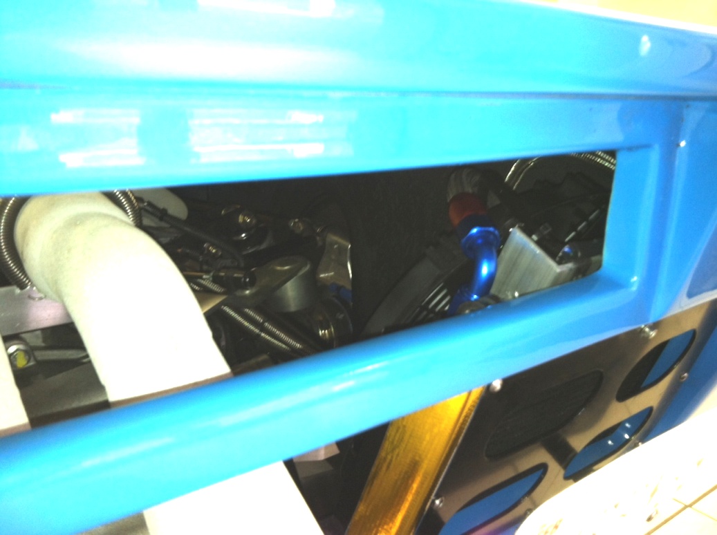

I plumbed the transaxle cooler and mounted fans on both (the driver's side is oil, the passenger side is tranny). They are operated by a manual switch on the dash. On a test drive yesterday the oil temp came down from 230 to 215 with the fans kicked on.
The coolers had originally been mounted to three holes in the fiberglass. I thought that was crap, so I reinstalled the metal grills and that reinforces the entire assembly.
