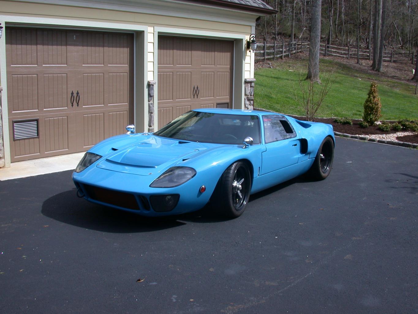

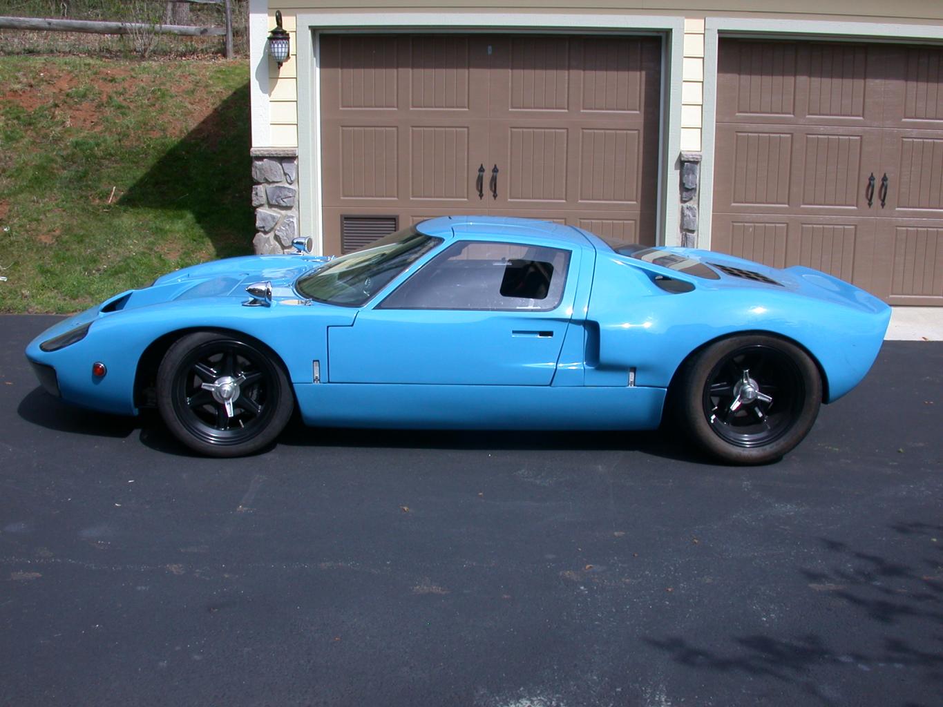

We are driving! We are ready for inspection!
We still have much to do... but mechanically we are there!
Using the new steering arms, the suspension set up is pretty much amazing. The car rides, handles, steers, and performs better than I thought would be possible. I am finally able to have answers to my own FAQ:
1. Is it loud? I just took a flight in a commertial turbo prop which was significantly louder. I wore ear plugs on the 1.5 hour drive home from VIR but I have been out for decently long drives and don't think they are needed. And I don't even have the carpet in yet.
2. Is it hot? No AC yet, I don't think the car is any hotter than other sports cars. With AC it will be pleasant in all temps. I was worried about the center console but I cannot detect ANY additional heat from it. I think the Swain Tech coating oin the headers may be a genuine help.
3. Can you see out of it? Forward: brilliant. Side mirrors, OK. Rear... not too much, with a little mirror I bought at O'Reilly's I can see the flashing lights but not much else. I will say this, if you pull up to make a turn and are 45 degrees to the road, you cannot see ANYTHING 45 degrees towards the back of the car.
4. How about the seats? I think they are comfy. I need a headrest, and that is my next project.
5. Roll cage? It think my car will end up being primarily a road car. I am seriously considering removing the cage. I just padded the bars to the front; even when strapped in tight I can extend my scrawny neck enough to tough the bar with my head. Which means I will definitely smack it in an impact.
6. Is it fast? It's crazy fast. Stupid-nothing-else-quite-like-it fast. Despite being geared so that first is good to 60, first is useless. It will spin the tires at any speed in first. And second. And it will spin third at about 4000 rpm....
So what needs to be done? A LOT. Including headrests, calibrating the speedo, state inspection, gearbox cooler plumbing, carpets, clutch stop, etc. I will try to post info as I go along.

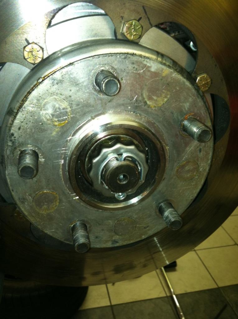

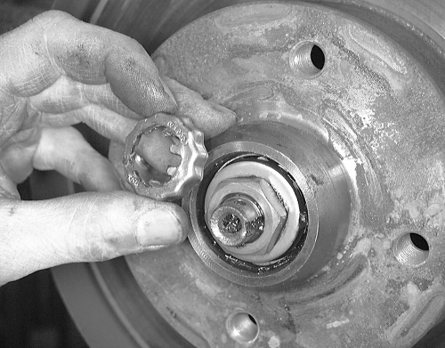

I had a stub axle nut work loose. Anyone know where to find some of these locking caps?
... well I found some Jeep ones that I think are 36mm and they are on the way. I'll post pics if they fit.

Those little locking caps are very popular on single and two axle utility trailers. If you have a trailer sales place near you I would bet they have them.

on my car the stubaxle is locked with two nuts per side(one of it for counteracting). Also use the torque recommanded on the buildmanual(118 lbs/ft =160 Nm) . I have mine additionaly locktied.
Should be solved than.
TOM
This locking caps usually are majorly used on wheelbearings on which you adjust the preload with the means of the axlenut. This than is usually not very tight, therefore the support of this locking caps to keep the nut in position. As mentioned before just make shure to use the recommanded torque.
Also please recheck your wheelbearing. There is the risk with a loose stub axle that wheel bearing is not hold together properly and get damaged.
TOM

Thanks, and I plan to pull all four corners apart and check the bearings. No room for error here.
-J.
Been hard at work. Got everything mechanical done which included replacing the CV boots (again), re-torquing the rear stub axle nuts and adding the castle-style cap nuts with cotter pins, padding a number of lines in various places just to be extra sure, and replacing some squeaking bearings in the idler pulleys for the AC compressor. I also discovered that the folks who worked on the body fitting decided to thread the rear clip latch bolts into the fiberglass only. I decided this was unacceptable. I was able to feed angle aluminum between the tanks and the rocker panels to drill and tap them and now the latches are nice and secure.
