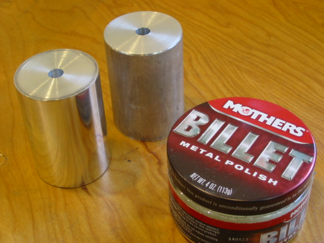

Rebuilding is a time consuming project that should not be undertaken by amateurs. Nonetheless we wanted to give it a try. So we set about gathering the parts and components necessary for the build. Our goal was good quality components that would hold up well for years to come, without going crazy about horsepower and torque.

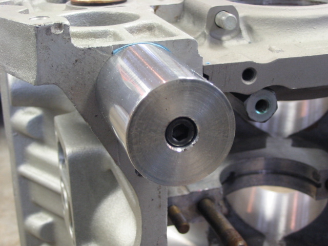

A length of 1 ½ aluminum rod was acquired. Four lengths each 2 ½ inches long and four lengths each 1” long were cut. Each was center drilled for a 5/16” bolt. The longer were drilled so the bolt could be counter sunk. These eight pieces were then polished to an amazing level of shine using fine sand paper followed by billet polish. The longer sections were then bolted to the bottom of the block.

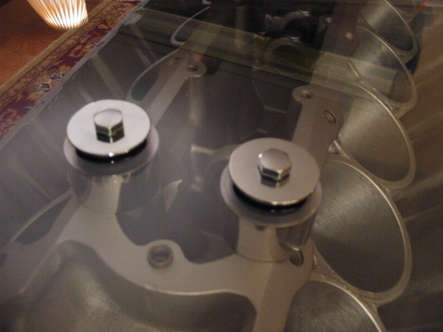

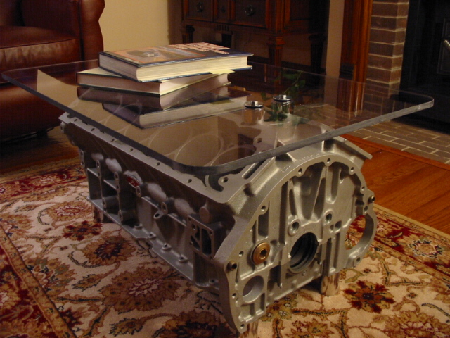

A 24” x 36” section of half inch polycarbonate was carefully cut to size and the corners rounded with a 1 ½ inch radius. This was bolted to the top of the block using the 1 inch polished aluminum spacers, sandwiching the polycarbonate between rubber washers. Chrome bolts and washers were used for appearance.
The engine rebuild is complete. We now have a coffee table gracing our living room. Jeremy Clarkson, eat your heart out !

I much prefer your table to Clarkson's. For one thing, their's has some rather tasteless "boy-racer" blue lights fitted!
I have a friend who has almost finished a table with all the pistons still in place (rings removed). Turn a handle on the flex plate and the pistons all go up and down - sad but true .... :)
