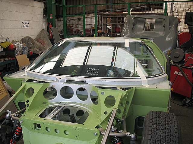

re: Jimmymac & Alistair's Cars
Ali's car is shaping up nicely
Jimmy, perfect, what struck me looking at that photo, is that it is like, here we are in 2011, watching the construction of an 'original ' GT40. ok, the people are different, but the product is the same.
With the care and attention to detail that you and Ali are putting into the job, these cars will be something special, of that I am sure. Keep posting, you are doing something that most of us can only dream about, and doing it well.
