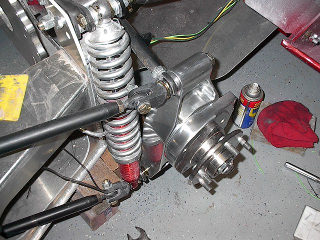

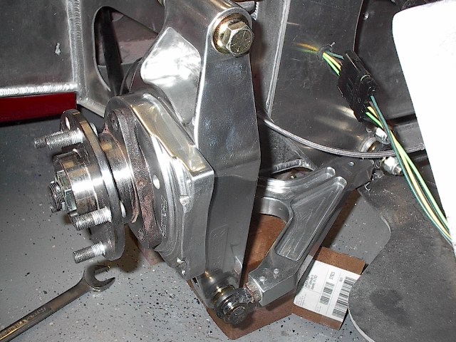

I decided to polish the rear uprights and control arms while I had them off. Here are some pictures:
