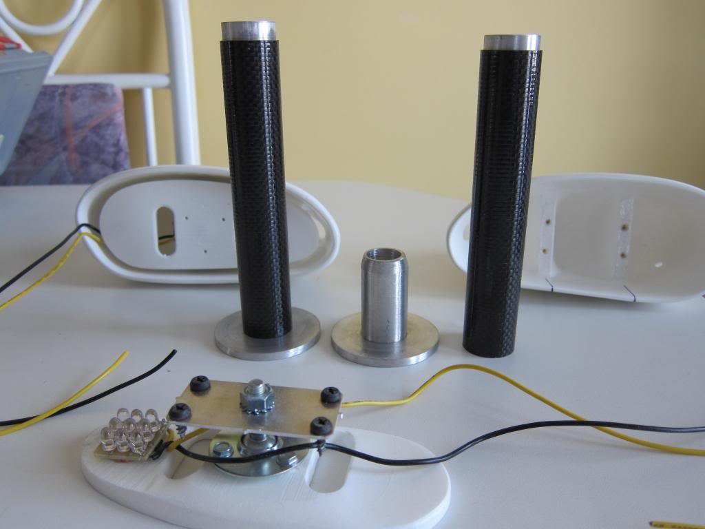

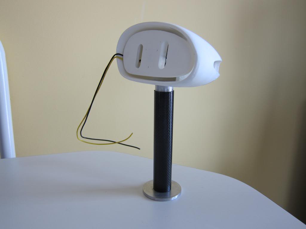

Working on the mirrors now. I'm using carbon fiber tubes with aluminum inserts that will be bonded in at each end. I have shaped the factory low mounted mirrors by removing the arms. I just need to come up with a good way of mounting the upper insert into the mirror housing then I can bond the pieces all together.

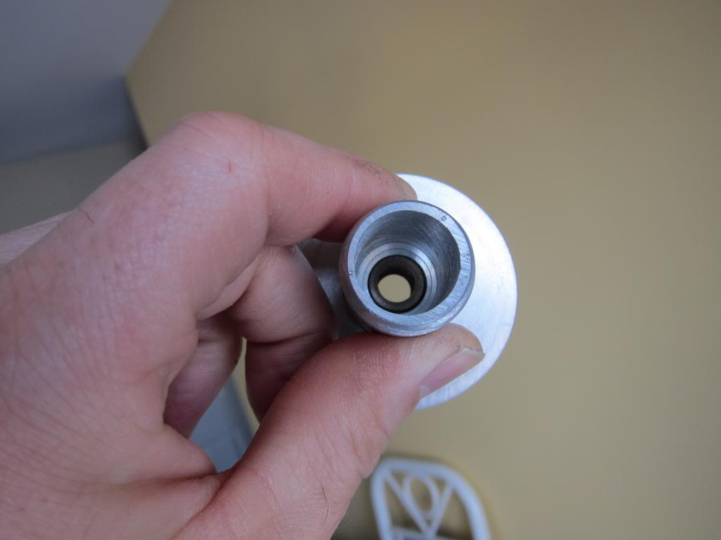

To mount to the door panel I installed a hardened steel threaded insert into the bottom bonded aluminum piece. It's called a Gardsert and is similar to a helicoil.

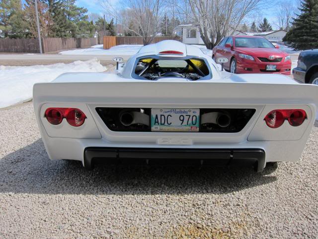

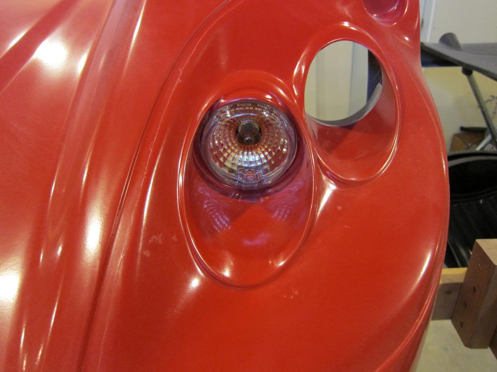

Here is a picture of the DRL installed in the inner light position. These are made by Hella.
The bracket needed to be made to locate it correctly in position.

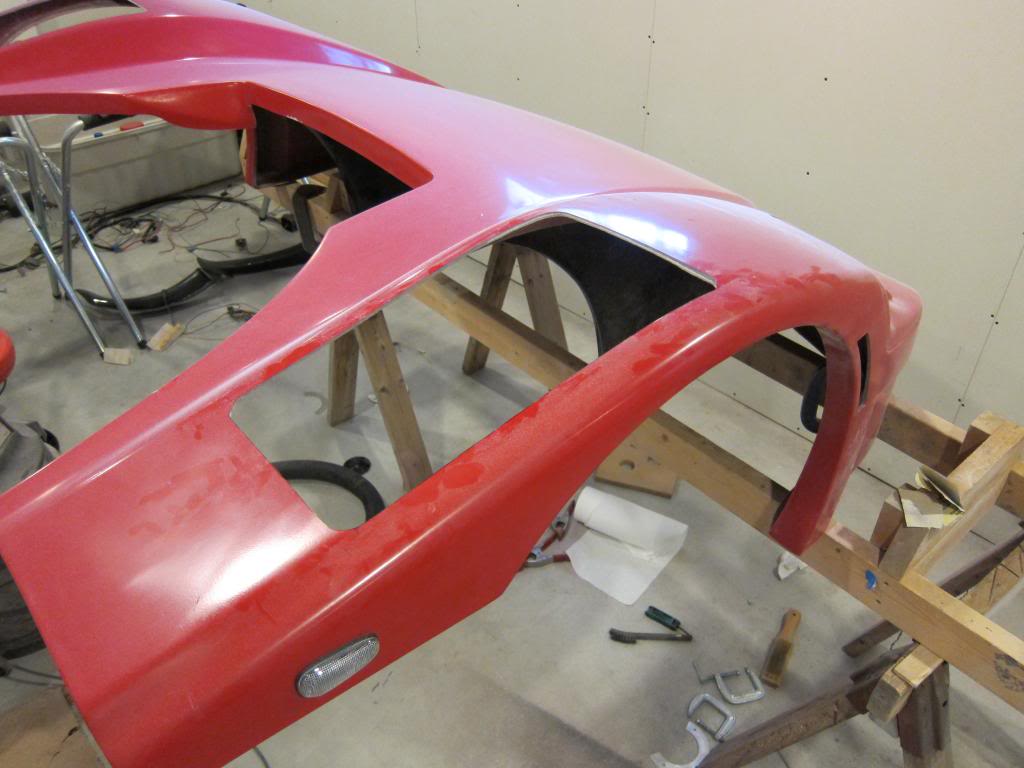

I have cut out the louver opening in the top of the fenders. The fiberglass pieces that were cut out have been cut into thin sections and will be bonded into the bottom edges of the holes to make a ledge for the louvers to sit in. I also added side position lamps from a Corvette/Cadillac.

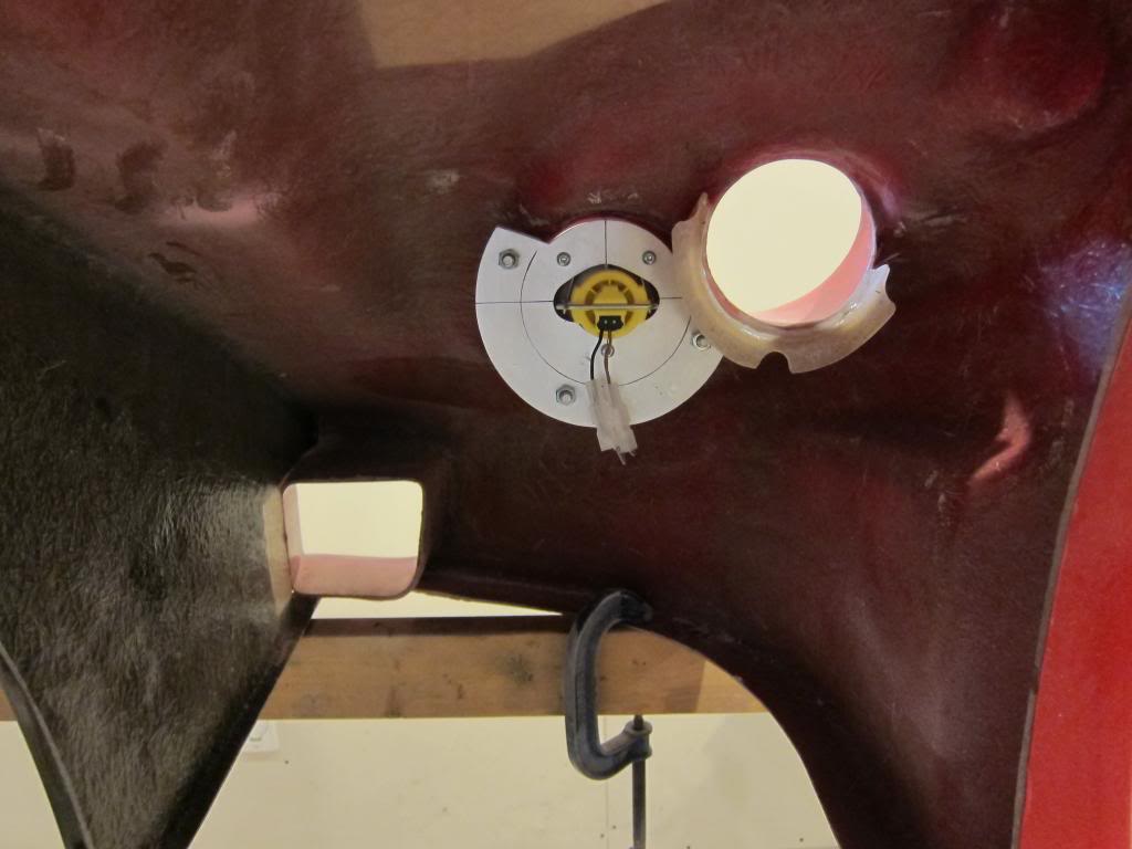

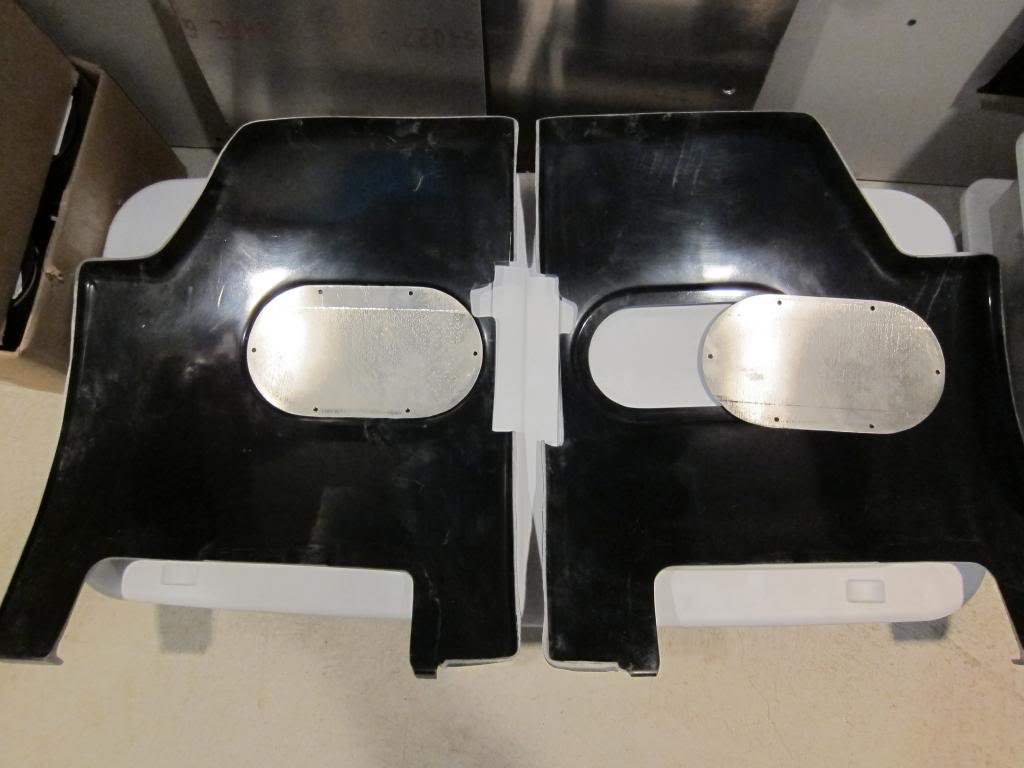

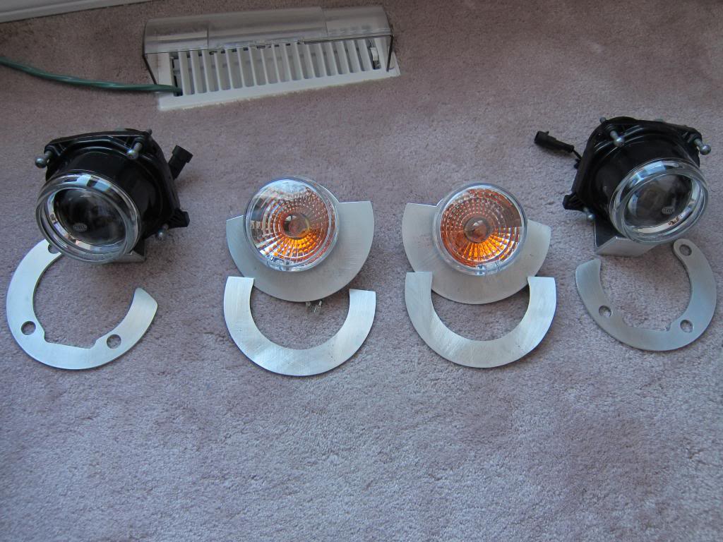

The front wheel well tubs have been modified for use with the race splitter and side marker lamps. If you are planning on adding brake cooling hoses additional holes will need to be made in the tub. I have made aluminum curved panels for servicing the lights. Rivet nuts will be inserted to remove them.

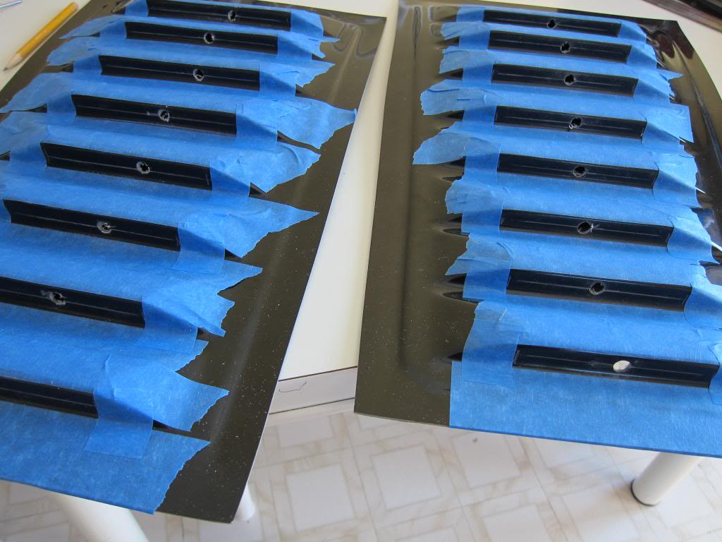

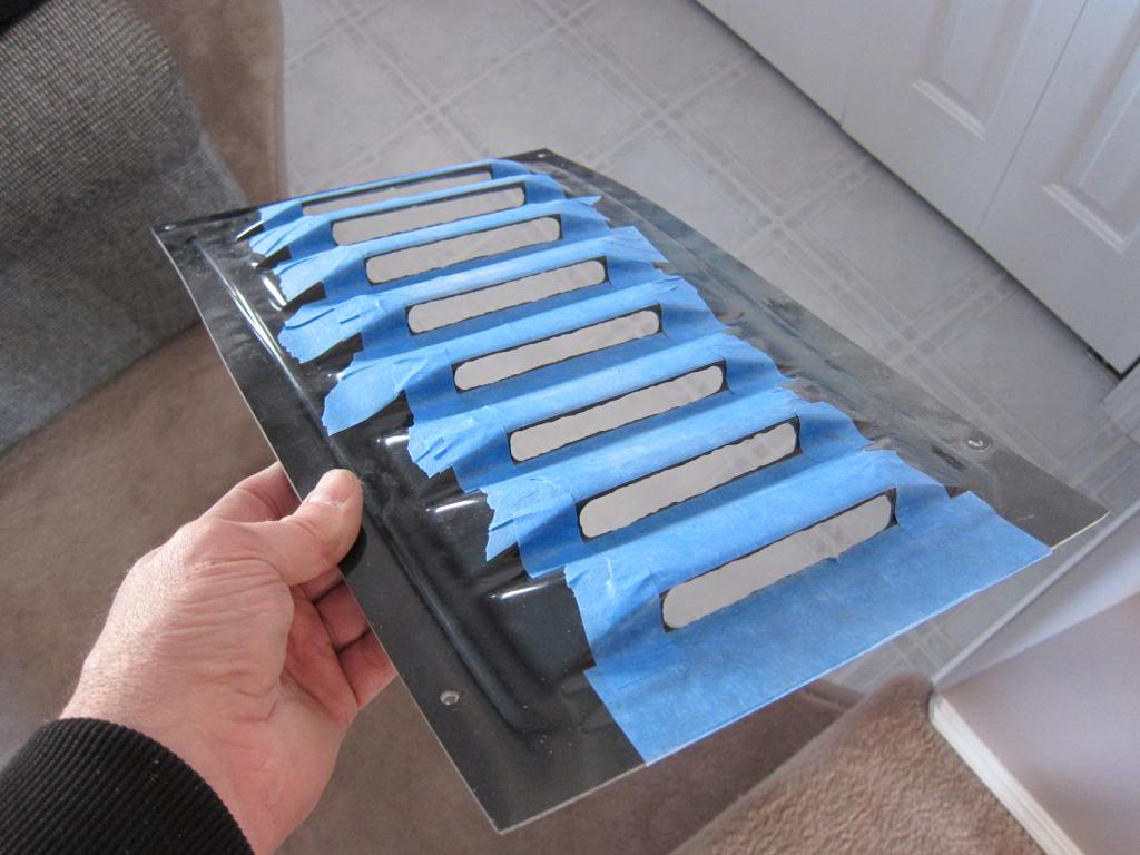

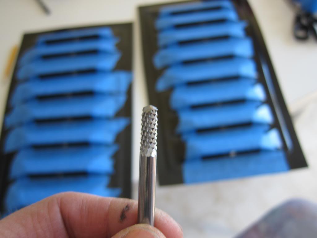

Working on the top fender louvers today. I first marked off the intended cutout pattern then used a special die grinding bit to rough cutout the slots. Start off with a large hole somewhere in the center of each slot. Final finishing of each slot will be with small files and sandpaper.

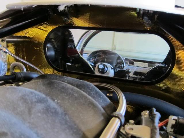

I installed a small window in the firewall.

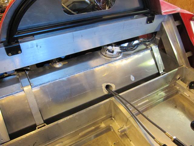

Finished off the fuel tank installation with stainless fuel tank straps. The height of the tank was shortened slightly to fit the 2002 Camaro module/bucket. The internal pump was changed out for a Walbro 255 and the internal regulator was gutted and just allows fuel to return to the bucket. A C5 Corvette external filter/regulator is used. I used nylon fuel lines from the fuel pump module to the filter/regulator then stainless braided teflon hose from the filter/reg to the fuel rail. I accomplished the complete fuel system run to the fuel rail without any 90 or 45 degree elbows. I welded a Swagelok fitting on the end of the fuel rail for a transducer so I can monitor the fuel pressure from the drivers seat.
In the bottom middle of the picture you can see the seat belt anchor point for both driver and passenger. It is a 1 1/4" aluminum rod about 6" long with a hole in the middle.
