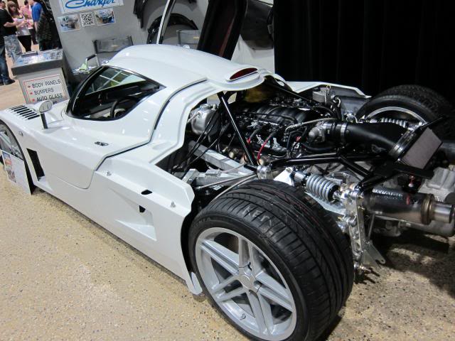

The car show just ended and the car also won the "master builder" award. I'm a little bit shocked at that as it's only 60% complete.

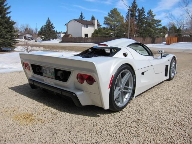

Do you have any pictures with the rear clam showing your exhaust exit?

I'll post some pictures of the exhaust from the rear. Also the rear window I added actually works quite well too.

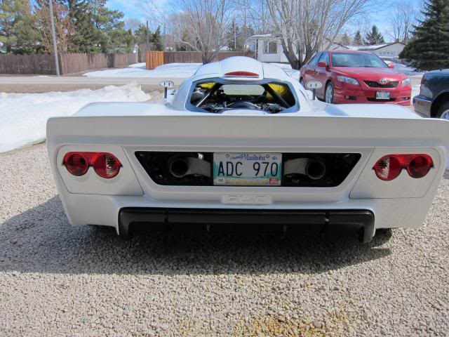

Ken Roberts
Here's a picture of the rear. I used a Ford Taurus Wagon third brake light up high on the spider. 1/4" rivet nuts hold the license plate on. You can see the Austin/BMW Mini side marker lamps installed for registration approval. The mufflers were able to be installed with the tips poking through on each side of the license plate. Don't attempt to use 6" mufflers. They will not work if using the street tail. The slots cut in the black panel will be for the external bumper that will be installed. It will look similar to the Ford GT bumper.

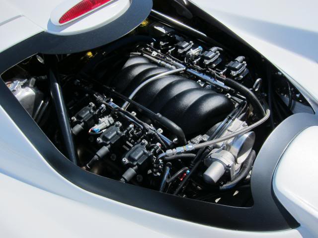

Ken Roberts
I like the look of the Katech coil brackets. The brackets have been shortened so they don't stick up as much and riveted to the smoothed stock valve covers.

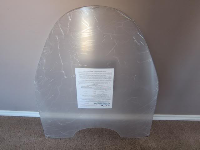

Ken Roberts
I think I've been given the wrong rear window. This one looks like it's shaped for the race tail or am I required to cut it to fit?
