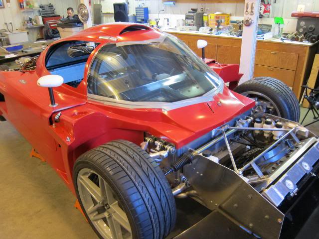

I put a slot in the fiberglass next to the wiper motor for a tow hook. It will bolt to the top of the tub. I used DOM tubing to brace the nose area to help eliminate excessive movement. The floor at the nose was upgraded with 3/16" thick aluminum.
The carbon fiber tubes were cut down to their final height (5") for the side mirrors.

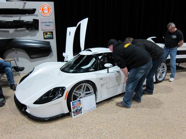

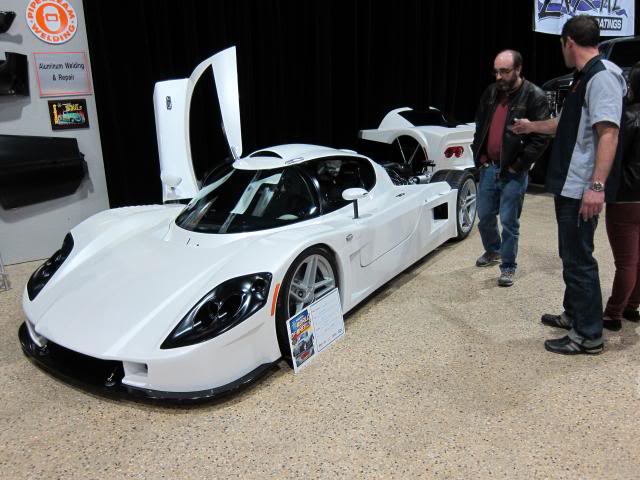

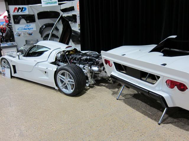

Here are a couple of pictures from the car show. The car wasn't wrapped after all but painted Cadillac pearl white. It won the "Master Builder "award.

Ken Roberts
For unknown reasons the outfit that was gonna wrap it changed their mind as the sheets are only 60 inches wide and the kind of stripes I wanted wouldn't have been able to hide the seam/joint.
I wanted Lamborghini "balloon white" as the fall back paint choice but the cost of the paint was out of my league so the Cadillac pearl white was the next choice. The pictures really don't do it justice.
We were then going to add silver stripes but everyone said "don't you dare" as it looked soooo good as is.
