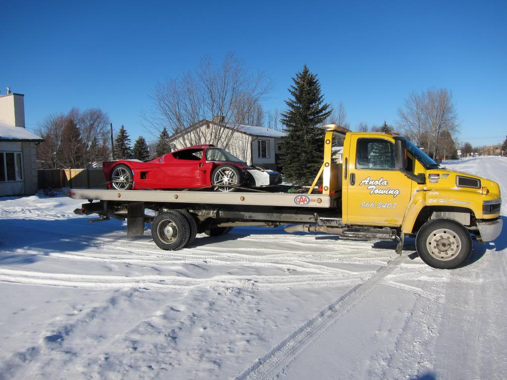

The car is off to have the exhaust and coolant tubes welded up.

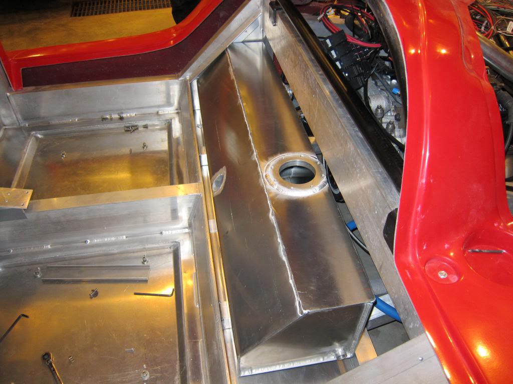

The fuel tank has been welded up and ready for the stainless steel straps. Then gold foil installed on engine side.

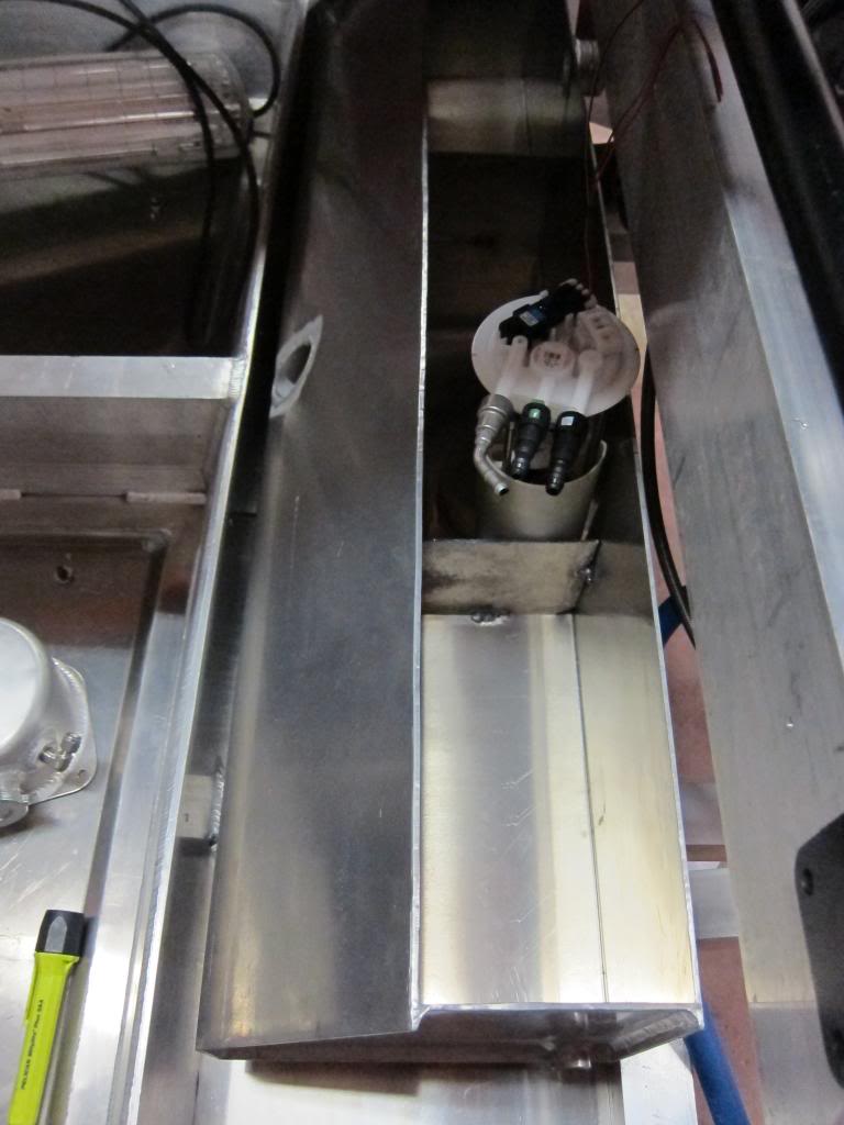

Will have another look at where the sending unit go's, its bigger, If my memory is correct, Ken was going to use an in-tank fuel pump set up.

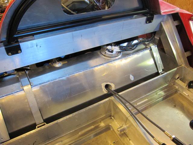

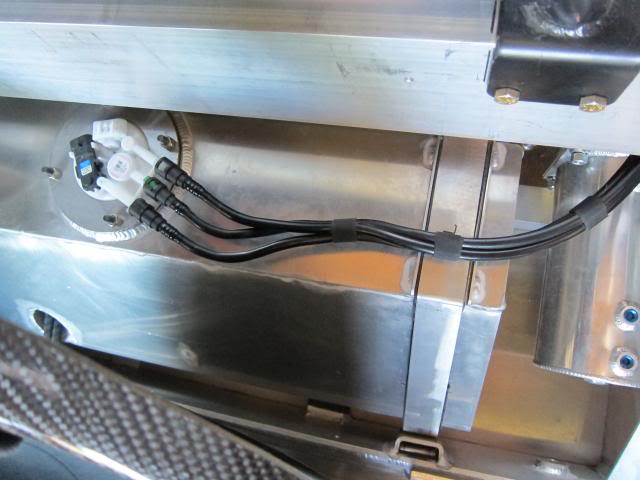

The top 2 inches of the tank was cut off. I needed a wider surface for the 6 inch sender flange for the drop in fuel pump module. I'll post a better picture in the next few days to show the module installed and the stainless tank straps.
My fuel tank baffles looked like they were welded by someone that doesn't know anything about welding. They would have failed in no time.

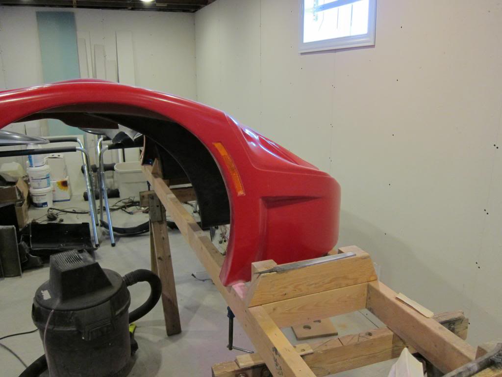

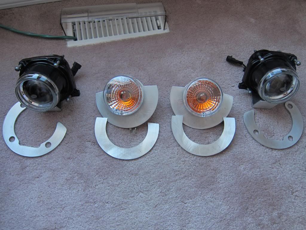

I cutout the front side fender area for marker lamps as required for street registration here. These are from a Mini Cooper.
Here is the headlight arrangement I'll be installing shortly. The inner lamps are a combination of daytime running lamps and turn signals. The outer lamps are Bi halogen projector headlights (low and high beam in one housing). The smaller lamps not pictured will be the front marker lamps only.
