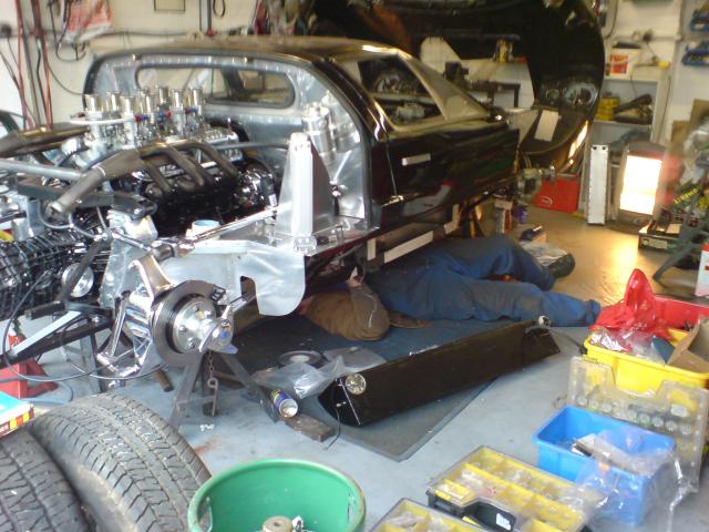

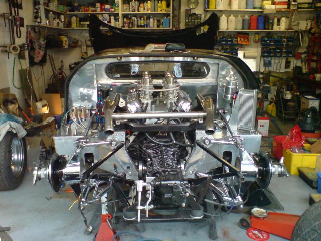

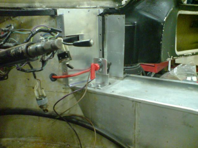

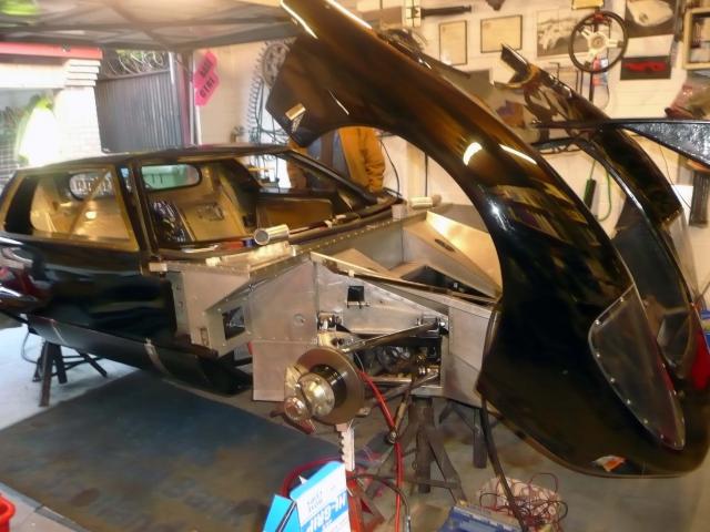

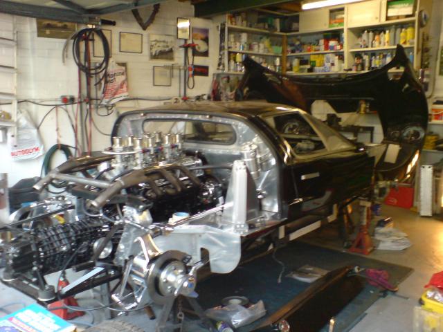

ok...time for more pics...john has been busy this week and he has promissed me that the engine will be in for christmas so fingers crossed....would make a great present.....really happy with how the car is coming on....not cheap but the smile on my face will be worth every penny!!!......hope to have the car on the road soon.....just got the fun of the SVA to do, which will not be easy as the car came with no receipts or paperwork for all the other bits and pieces, but we will see what happens.....loving the feed back guys so keep it coming.....

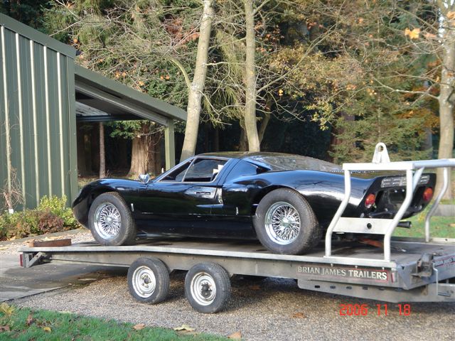

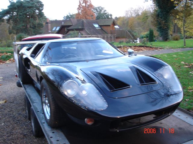

couple of pixs from when i first saw the car!!!!

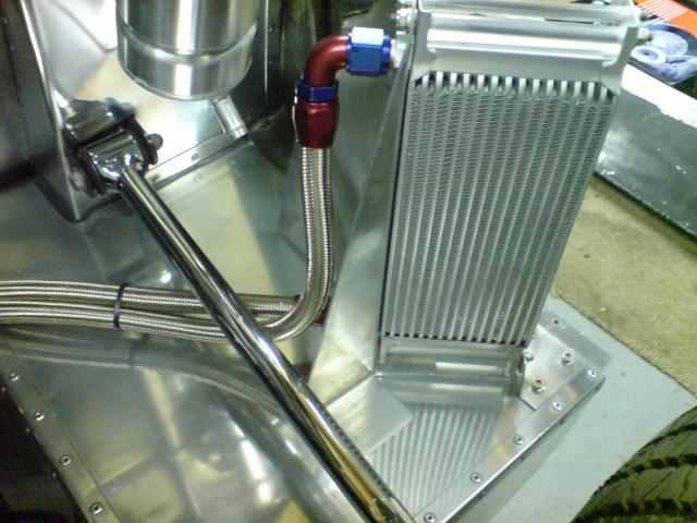

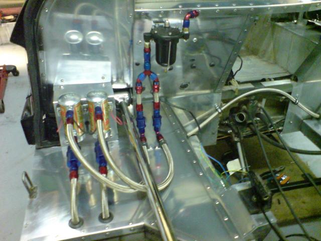

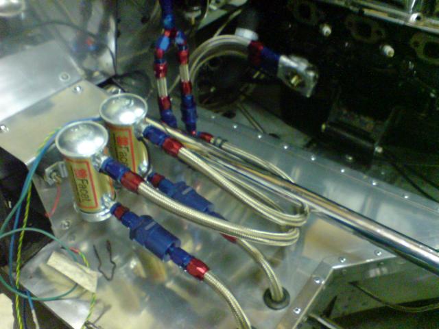

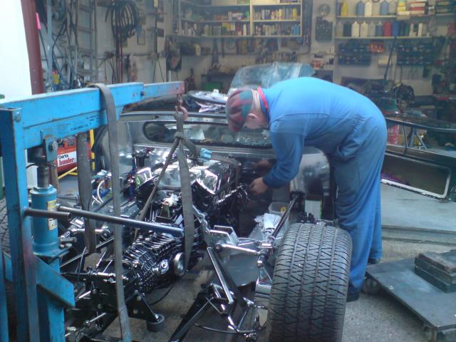

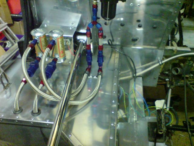

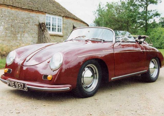

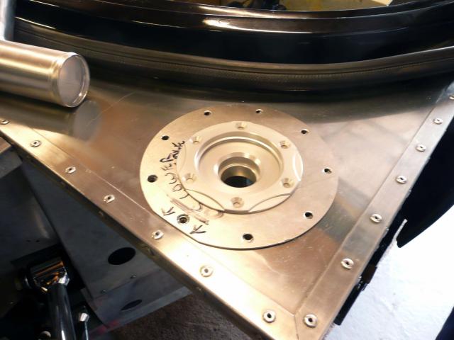

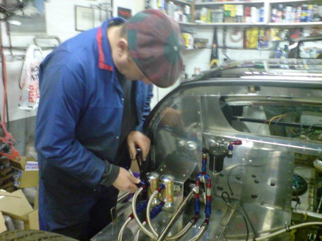

some pixs of the pumps and filters and the man , the legend that is Honest John!!!!! also a pic of my replica 356 that got stollen.........she is out there somewhere and i want her back!!!!!!!

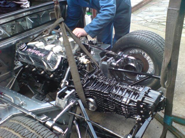

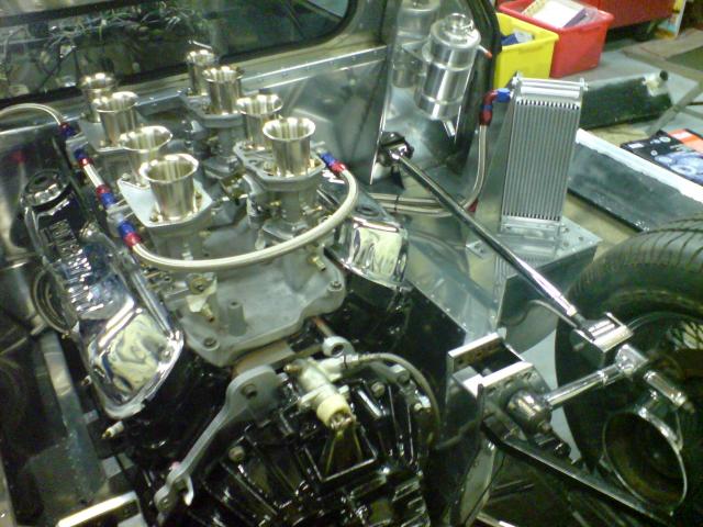

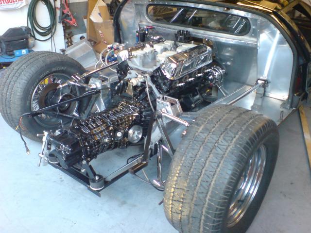

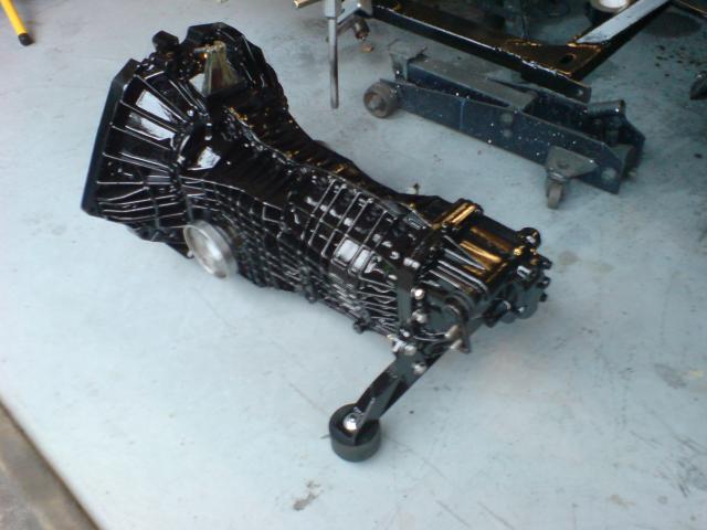

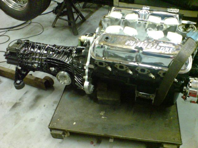

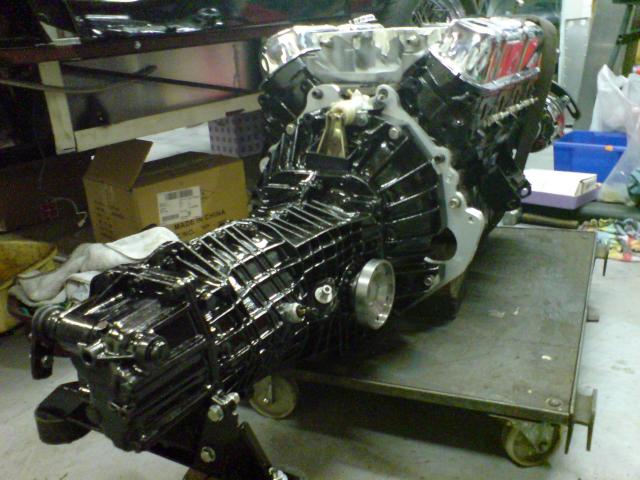

well john kept his word and the engine and box was in for christmas.....cheers john, hopefully have it all plumed in and fired up for the middle of jan, would make a great birthday present (hint,hint)....... heading fast towards SVA day....what fun that will be.........keep the feedback coming, would love to hear from any other mk 111 owners.......all the best and a happy christmas

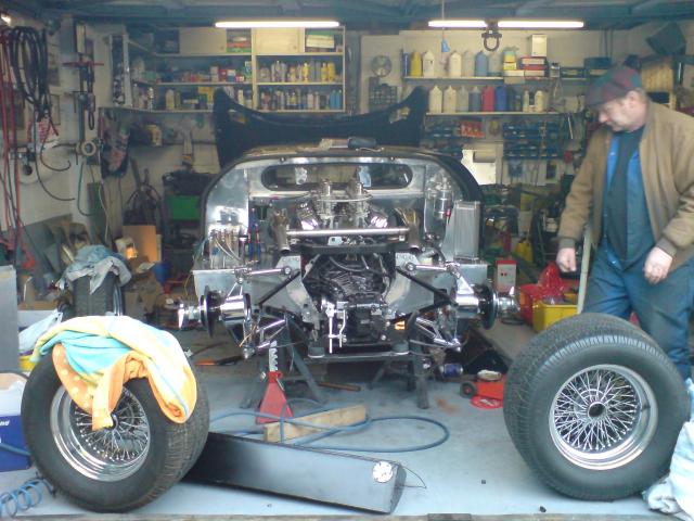

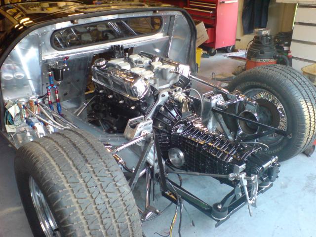

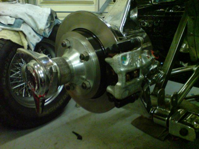

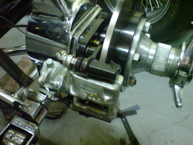

James, lovely wire wheels you have on her there. For a predominantly road car I've often thought the wires are the ultimate vintage/period feature. Do you know what kind of hubs were used?
Hi Cliff
The wire wheels certainly add to this cars vintage look, James and myself really want to keep them on the car .The hubs are splined 42mm adaptors bolted on to 5 stud granada hubs,i have not yet identifide the wheel manufacturer,there is a problem to be sorted in that the 5 stud nuts are fouling the back face of the wheel centre preventing the conical mating surfaces from seating correctly. This is on the list of jobs to do,hope i get there before old age stops me.

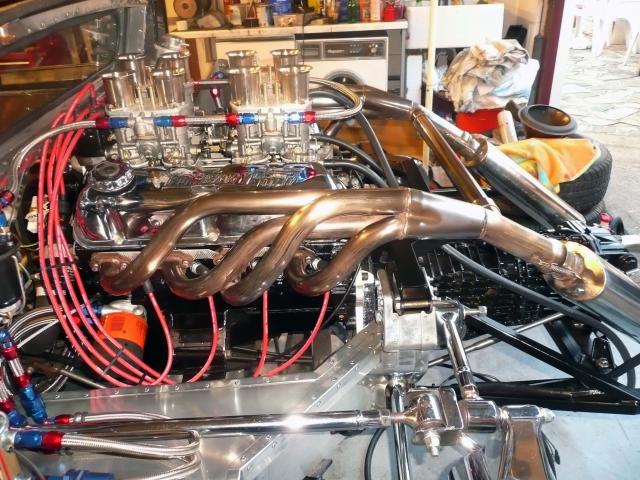

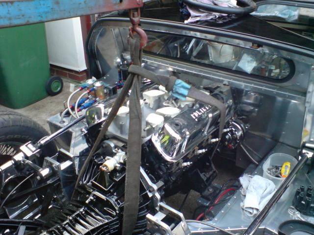

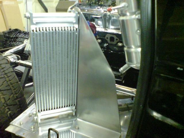

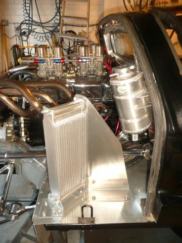

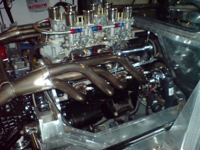

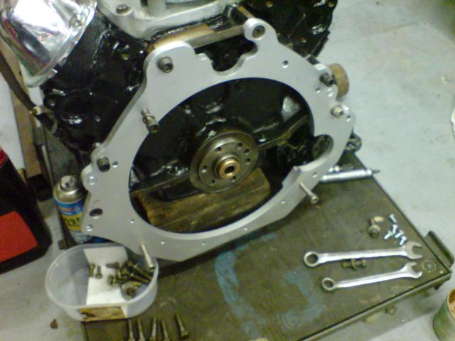

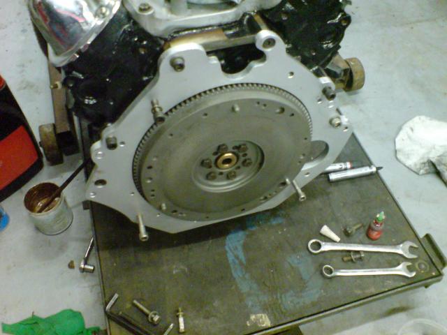

more pics of what john has been upto...engine is really starting to take shape....fingers crossed we will be able to get the car finished in time to miss the sva changes!!!!!!!

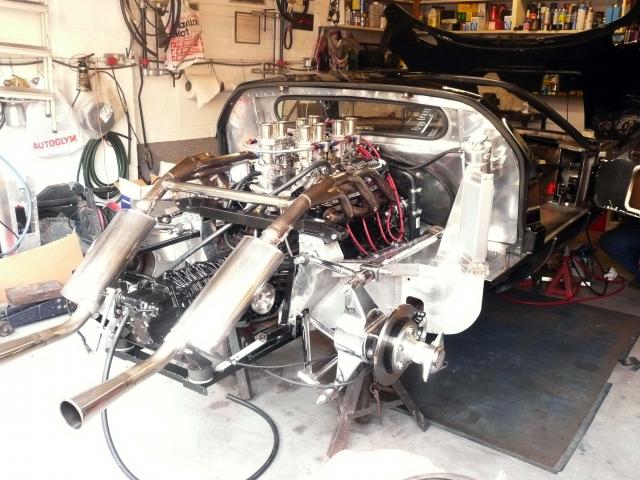

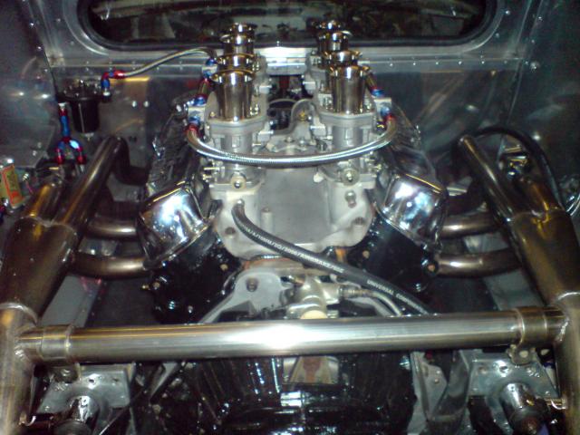

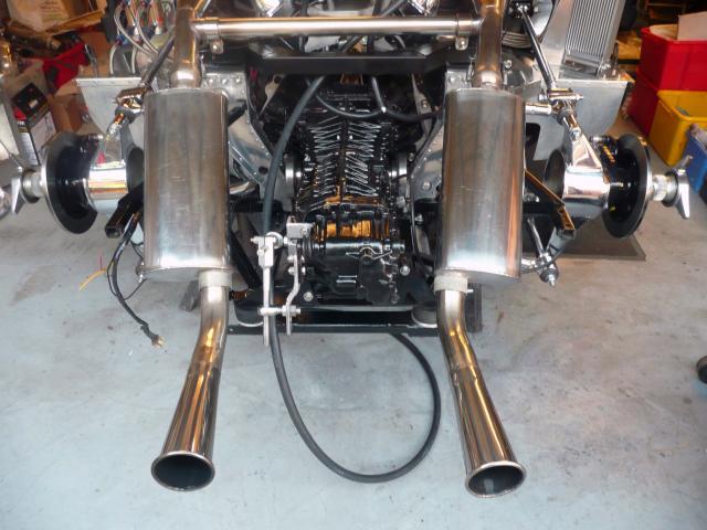

just thought i would add a few more pics...exhaust went on today so making good progress!!!!!!!!

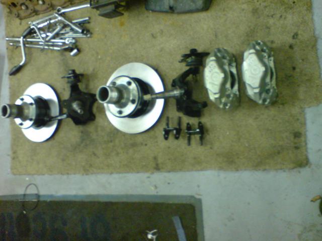

john spent the weekend on the brakes while we wait for the idf base gaskets...tried two different surpliers and each have sent the wrong ones....a few things seem to be throwing a spanner in the works...but that is gt40's for you.....would be good to hear from some other mk3 owners......are there any?????????????

Hi James
Forgot to mention that the pictures show that the spline retaining nuts arrived and all appears ok to keep the wire wheels. I shall try to source some SVA ok wheel nuts,whilst resolving some of the other parts/fitting issues this week,hopefully then I can fit up the front brakes (pictured awaiting assembly).
Cliff ,not able to as yet identify the wheel manufacturer, may find a clue when we remove those massively oversized rear tires.

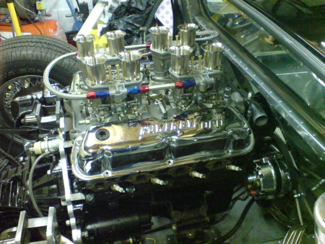

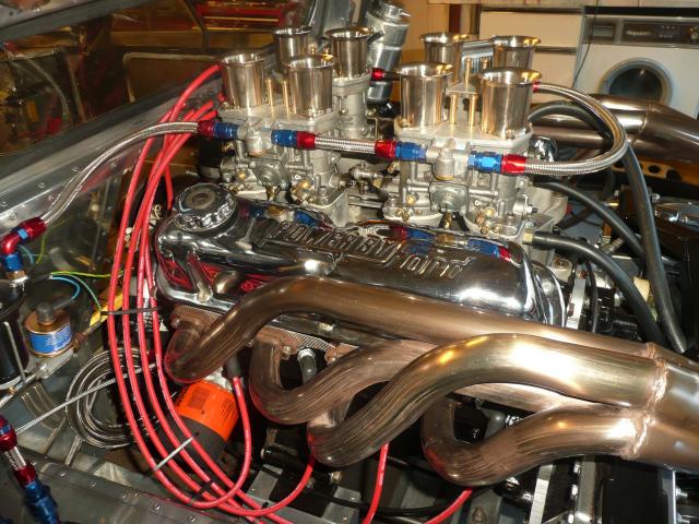

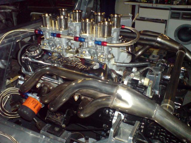

ok......BREAKING NEWS!!!!!!!!!!!!!.....today gentleman, another GT40 burst into life..... it gives me great joy to let you know that we fired my engine up today for the first time............drove to johns this morning only to arrive and hear my engine fired up..........stilll walking around with a massive grin on my face!!!!!its a good feeling.....john has worked so hard over the last couple of weeks and kept to his promise of getting the engine running before Feb........ seriously, if anyone is looking for a builder to help with there project , you carnt go wrong with john...
now we just need to get it finished off so we can get the SVA done ..........easy!!!!!!!!
