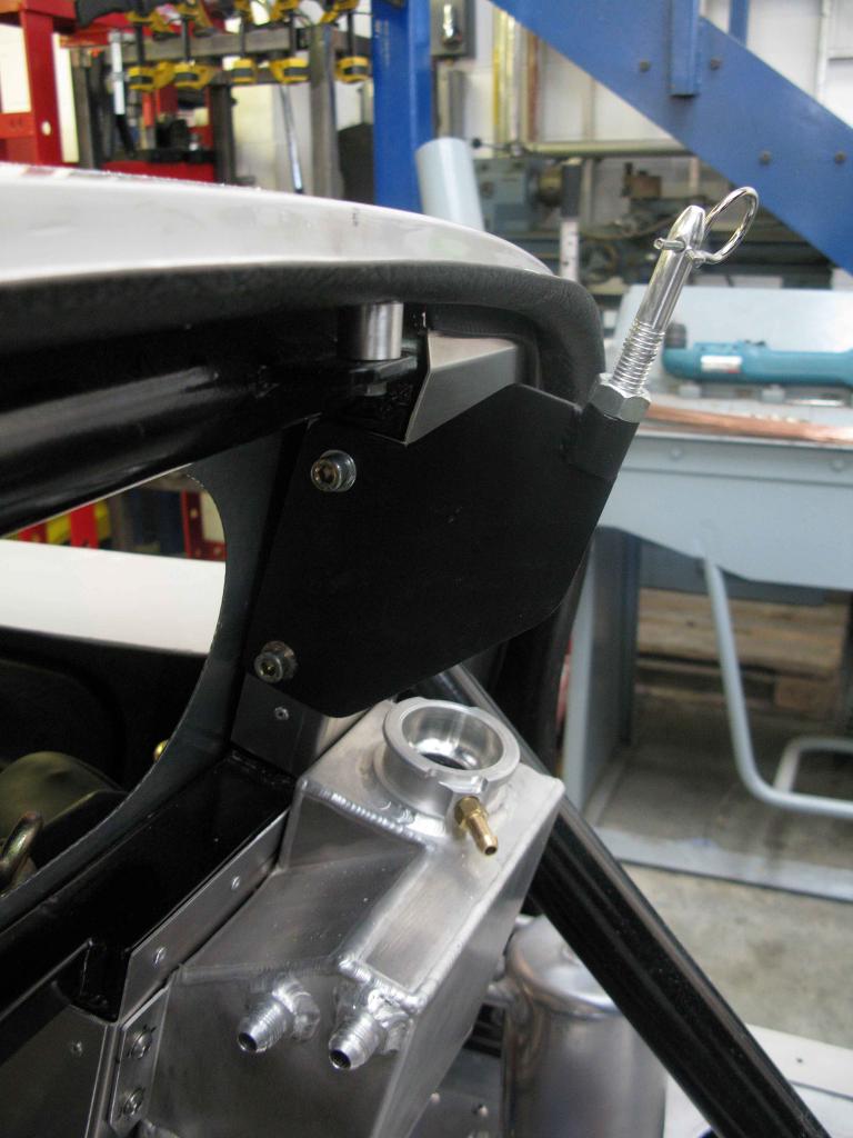

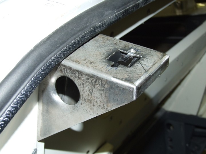

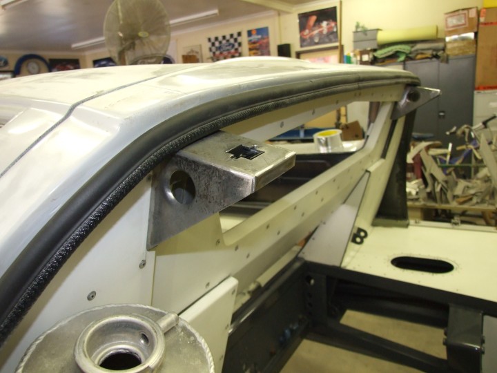

GJ, we did the first install on GT40 for the manufacturers prior to coming on the market, Frank

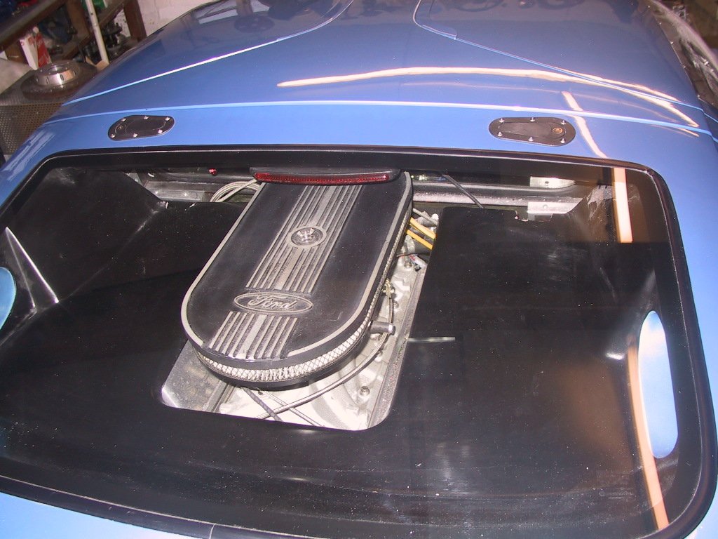

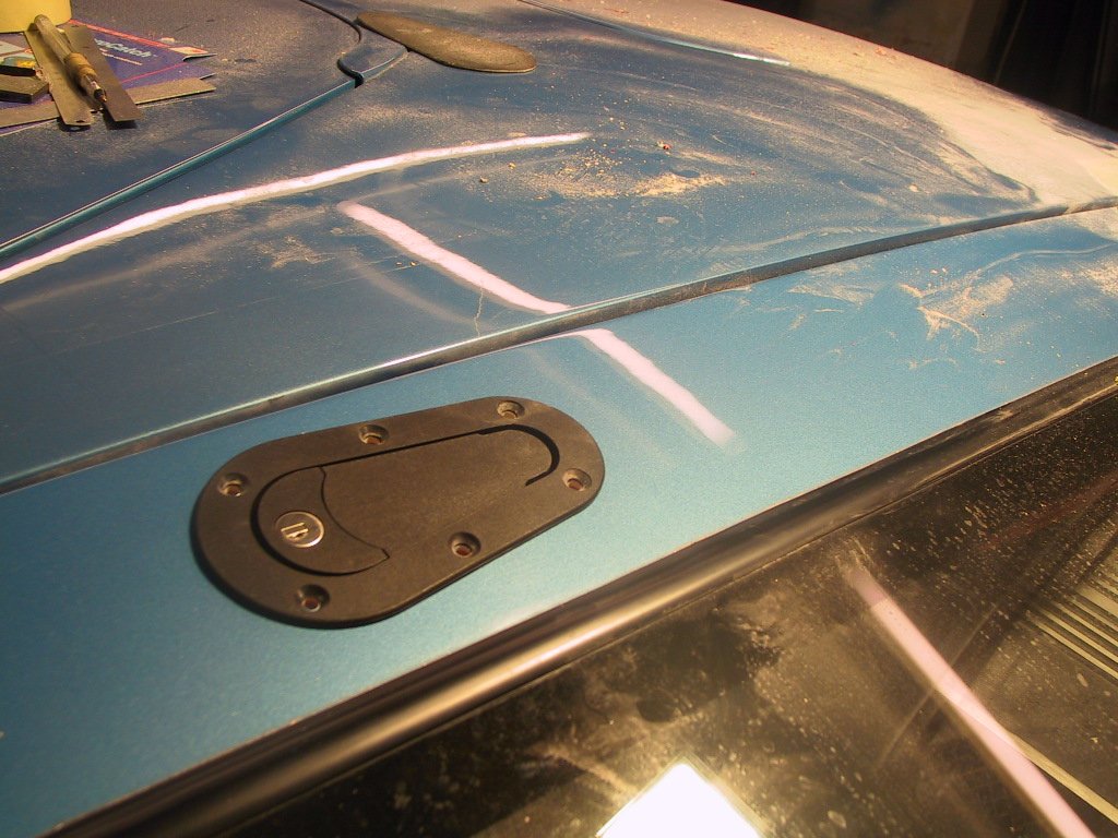

I thought this out for a long time before going with the Aerop Catch system. I finally acquired them back in '09. I have been pleased with them in that you can't accidentally leave then undone as some who have the locking pins that stick through have had happen. The cover sticks up too high to miss it, and if you close it and don't lock it your are safe in that the pin is secured.
The only draw back is that this system is not a draw down type system. It merely holds the clip down and keeps prying eyes from opening the clip without the key. It works on either side panels or top panels. The very latest works like a Hartwell latch. For some info on my setup, check out my thread:
http://www.gt40s.com/forum/gt40-build-logs/13742-drb-5-a-5.html
Go down to post 83 for explanation and pics. Here are some other pics of the setup.
As you can see in the second pic, the system can be set up as a from the bottom or a from the side holding setup. If you check their site AeroCatch® - new design of bonnet pin, available in locking or non-locking versions – see how it works.........you will see their latest setups.

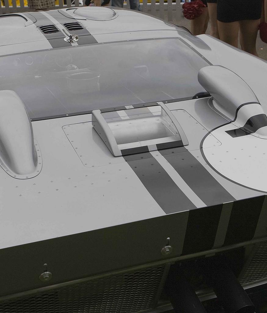

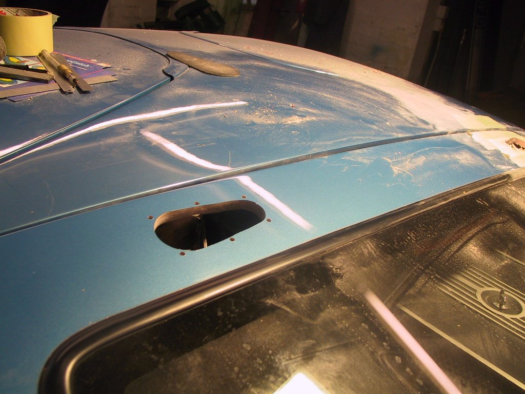

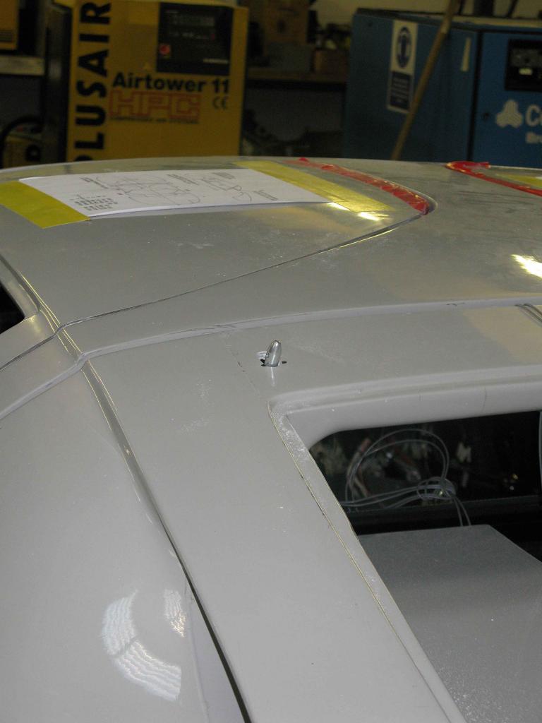

My build will have two pins one either side, I'm in the process of making cover plates. Picture shows also Graham Hills GT40 with 1 central pin.

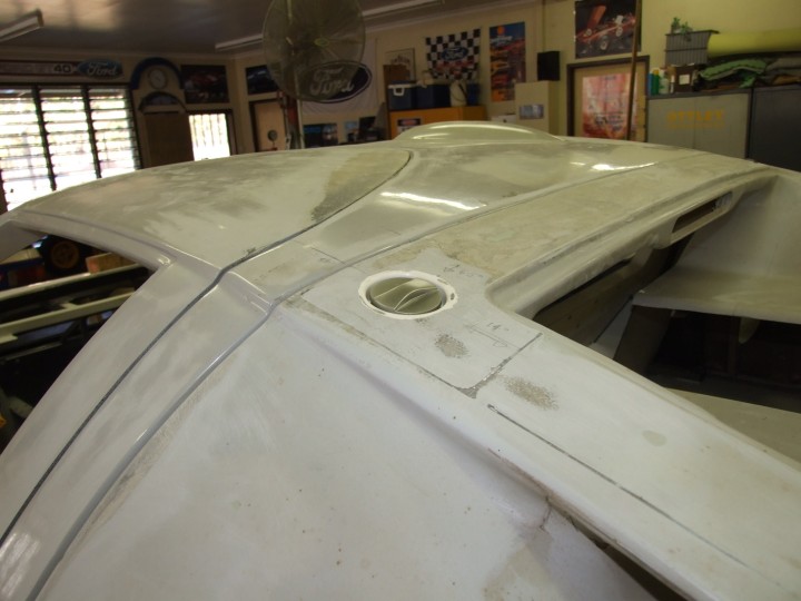

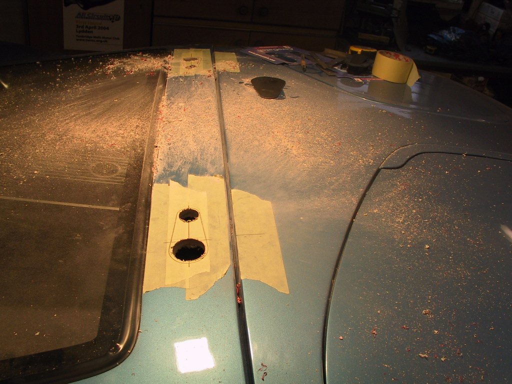

I used the 1/4 turn bonnet locks from an XY Falcon (same as Mustang) and glassed in some receptacles. It suits the era as well.
Clayton
