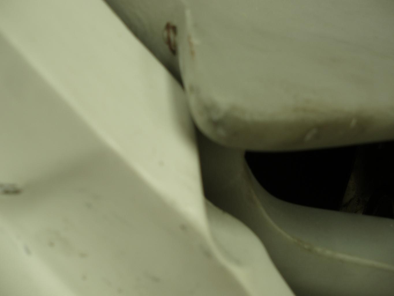

Before I do something dumb, I need some advice on the two "ears" on the rear clamshell that mate with the T70 cab. They both interfere with the cab bodywork by about 1/4 inch where there should be 1/8 clearance. I'm thinking of filling in the cavities and grinding down each ear. The rest of the clamshell fits fine.
The cavities are where the ears should come to rest when the clamshell is closed. Grind away on the ears but leave the cavities.
