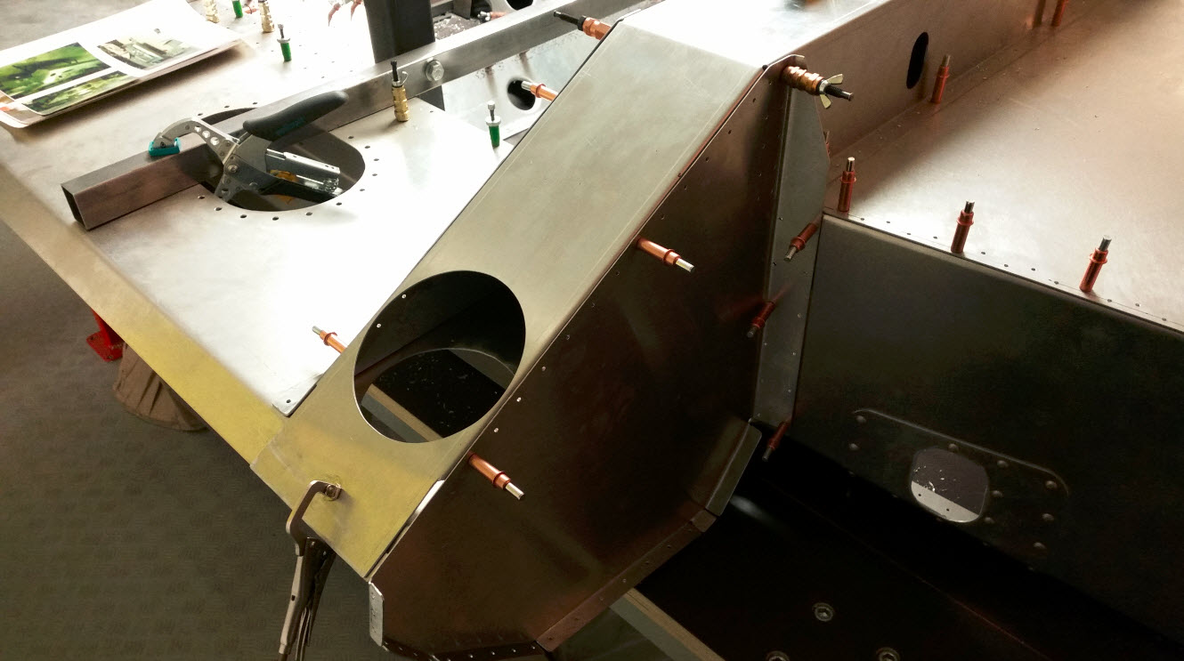

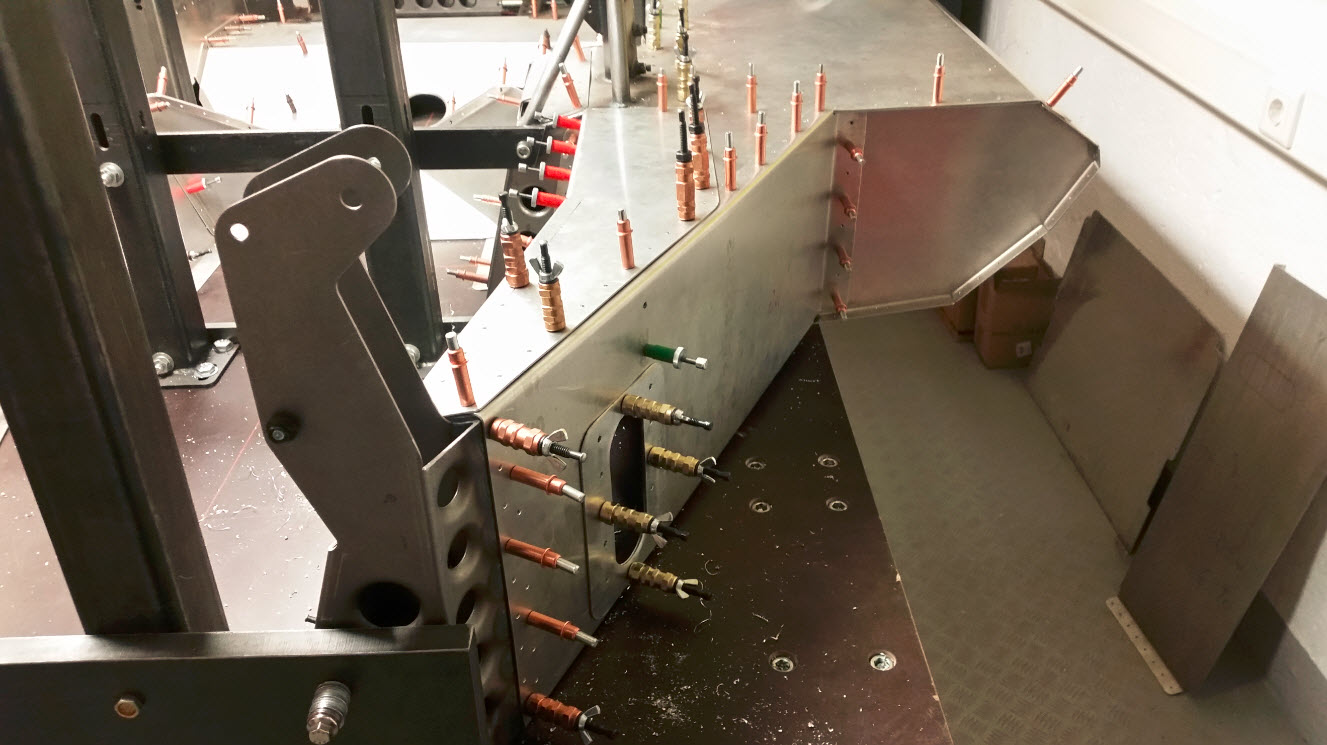

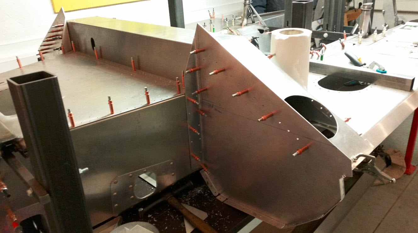

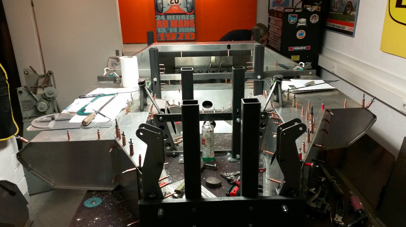

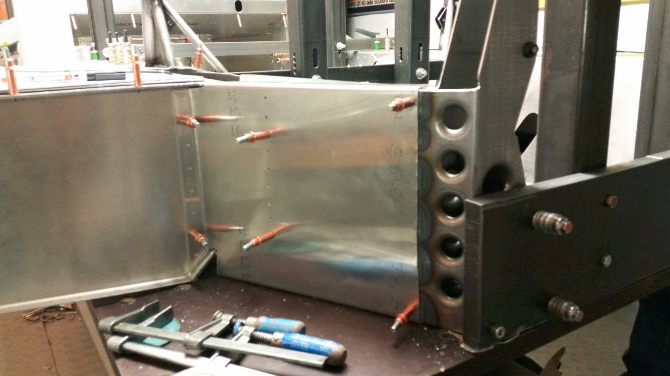

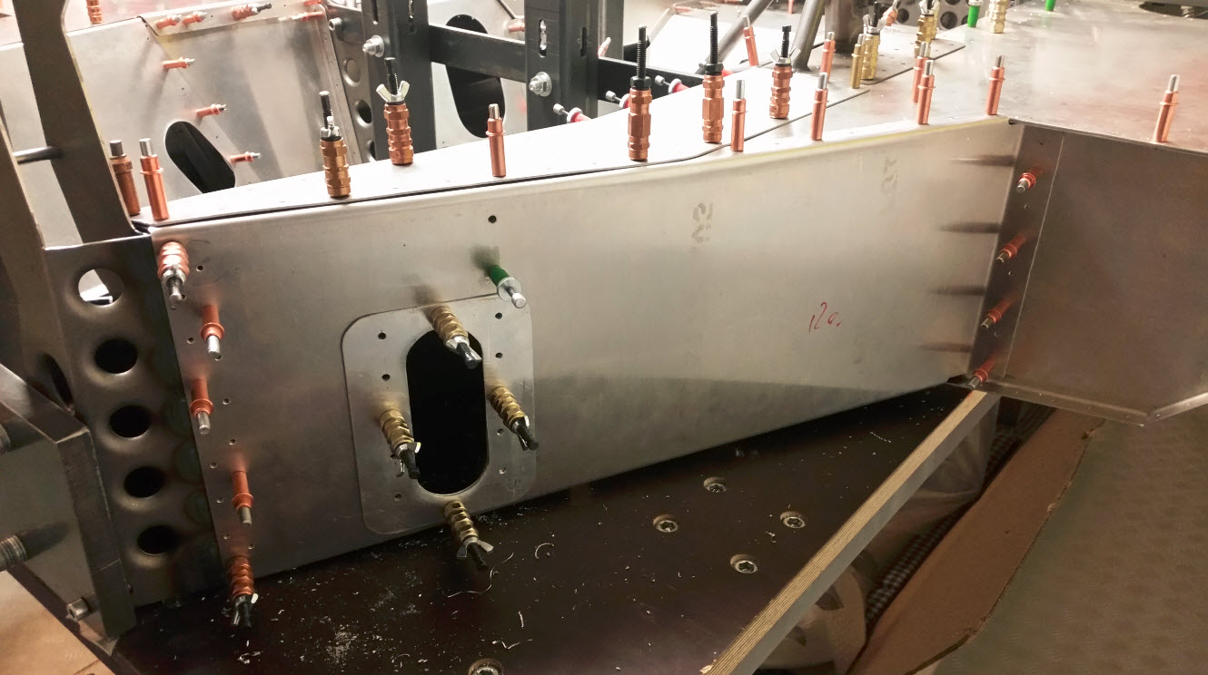

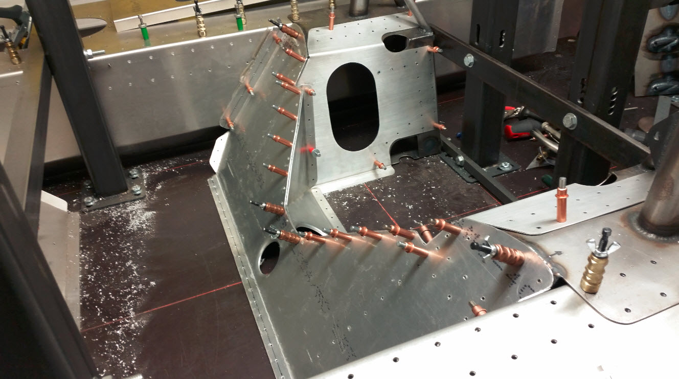

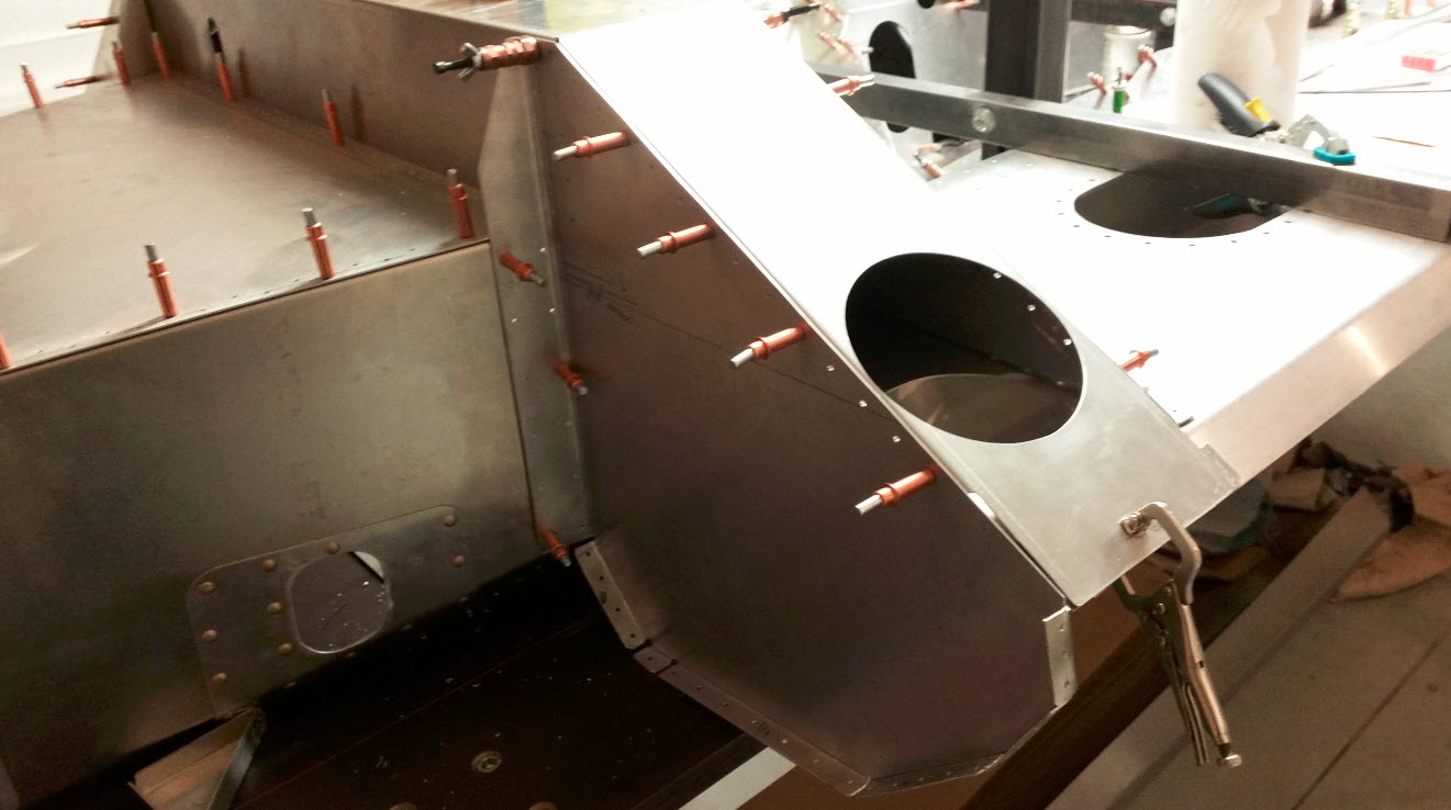

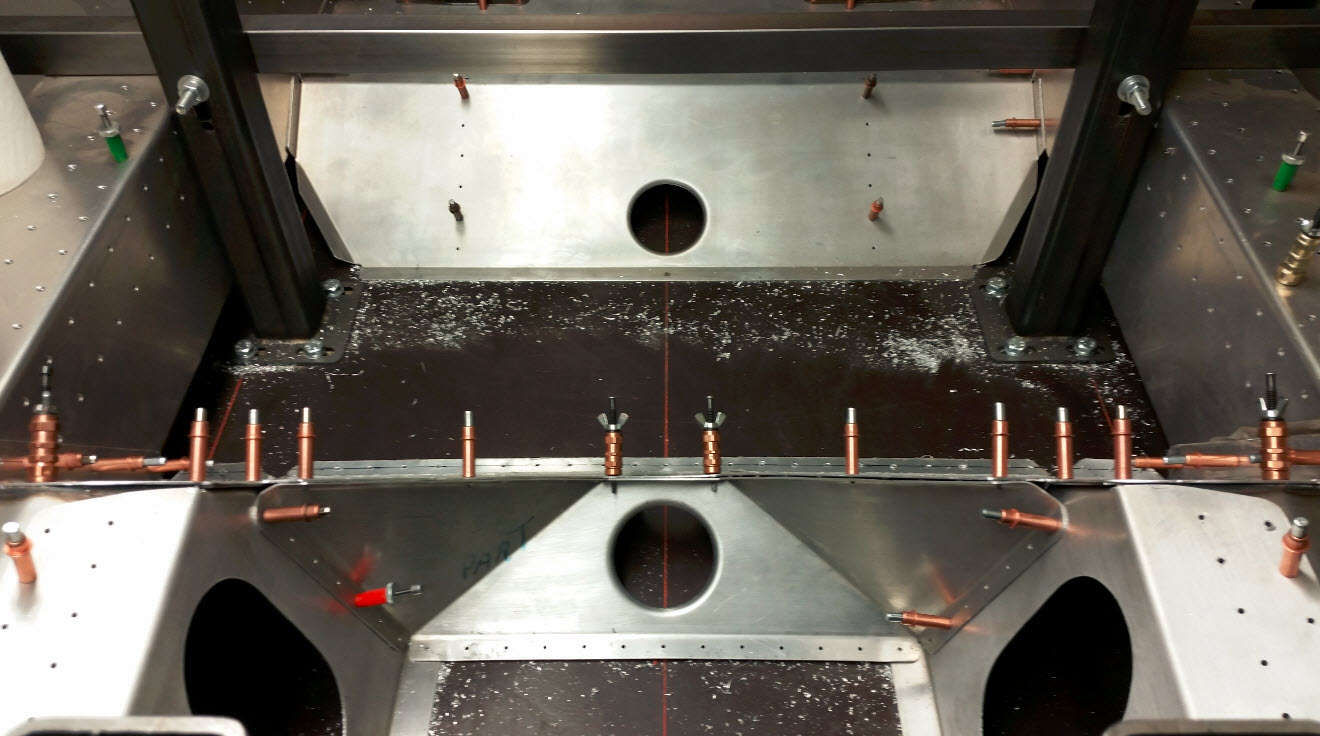

Some more progress. Over the last couple of days most parts of the chassis got sorted. I have to say that for very tricky bits (rear shock towers and their mucked up bending) I had professional chassis builder Henry Atherton (P 917, F 512, Safir GT40, Gulf Mirages) coming onsite for support.
Still some stuff to be done but I´m happy with the steps forward:

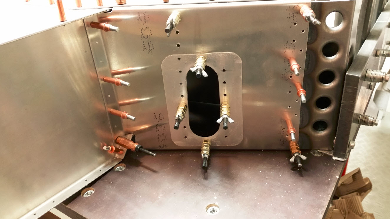

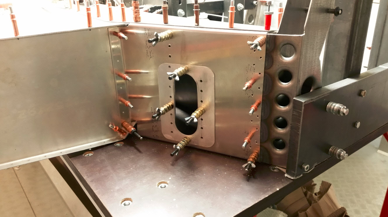

Here are some pics of yesterday´s work plus a pic of the seatback support
viewed from the rear.

This is the best you can buy. It must be sprayed in a booth with protective gear. But the chassis will NEVER corrode. Especially if you paint the chassis with a topcoat of say, epoxy white or gray. I'm thinking originals were bare but you have put so much time and effort into this it may be something you want to consider. Is it ALCLAD aluminum? In other words, does the sheet stock you have been using covered with a layer of pure aluminum?
4123 EPOXY PRIMER 7835 - PPG Industries - Aerospace
It's my understanding that this zinc can be used on steel parts as well.

Been working on the right rear section:

Do not worry about aluminium aspect until you are done with all drilling
It will be time enought when you are ready to start riveting !!!!
And remember ; a little "patina " shouldn't be bad comparativly to a too shiny tub!!!:worried:
Do not paint or coat her !!!!! not "in period at all":laugh:
