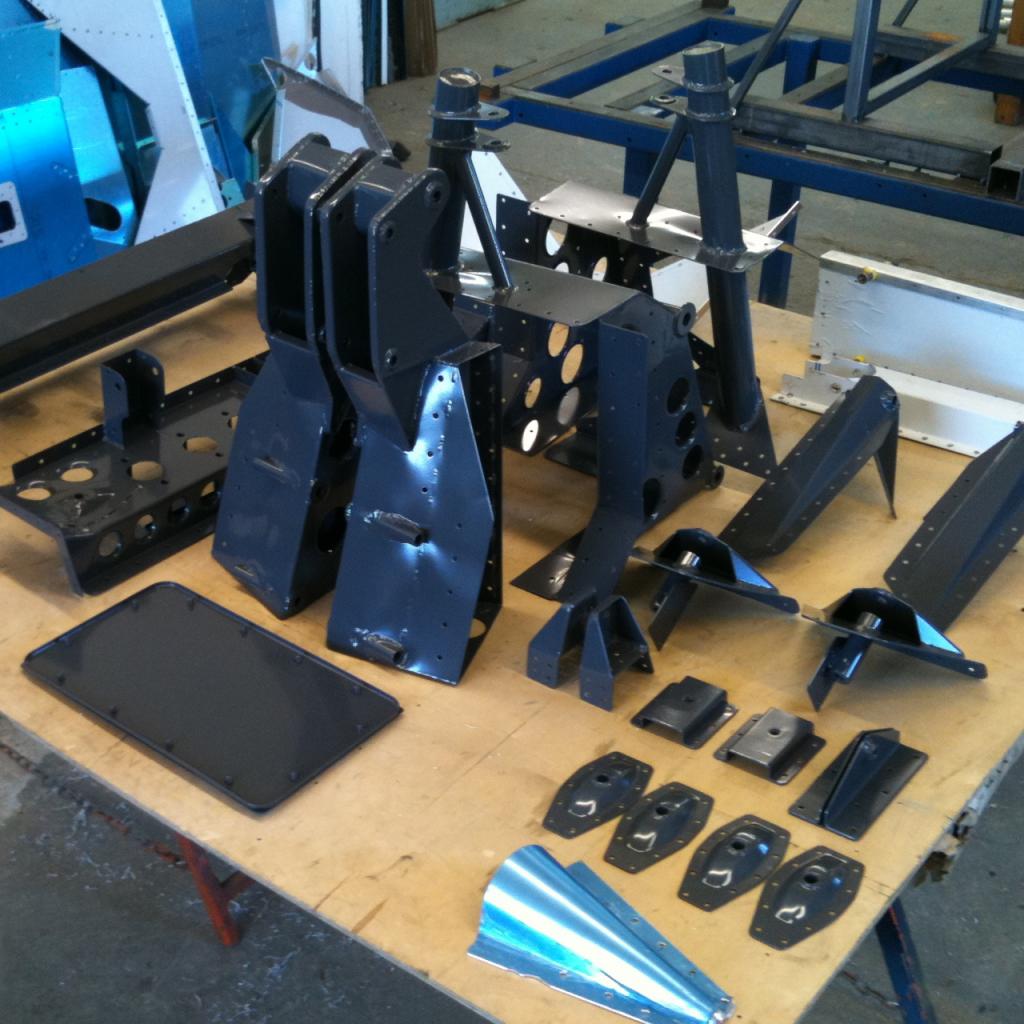

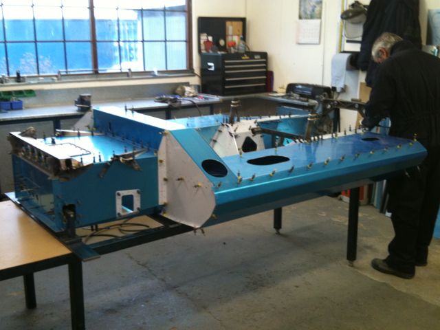

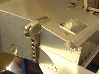

these are pics of LOLA tubs as I have seen everywhere in career ;
there where on the 75's race alumium tubs complitly coated ;
The MATRA tubs .....
They where built like aerospace aluminum parts ;
panels where trimmed and drilled as usal , then before final assembling and bonding ,riveting all panels where coated ( primed is more the term ) with an classic orange "Phosphate coating"
Yes you are right , Graham , about after sometime use ( say one or 2 seson) those aluminium tubs where changing concerning strength due to loosen rivets lines , this why we improved with manufacturer of those special structural bonding stuff and we found
a "pink" 3M bond product giving so good results that for 40 years after I was still using into carbon fibers tubs to hold aluminium suspension inserts !!!!

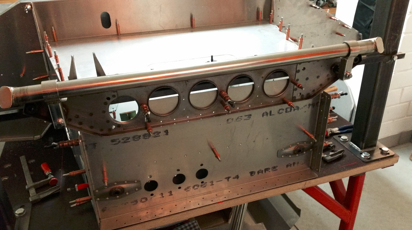

Front anti-roll bar.
To my biggest surprise, it fitted nicely...:shocked2:
