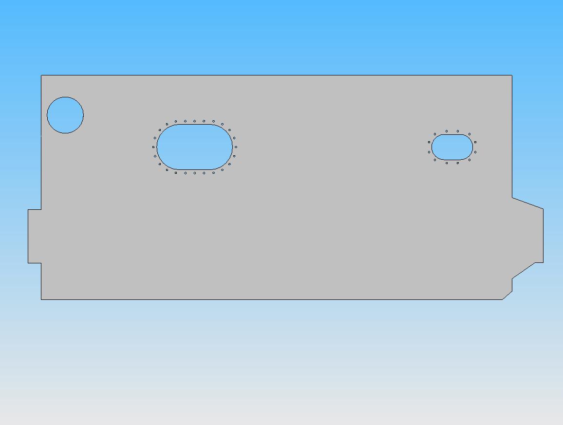

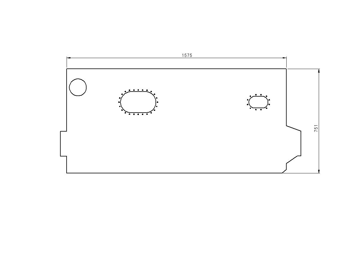

Example of Digi-panels (showcase not containing all dimensions):

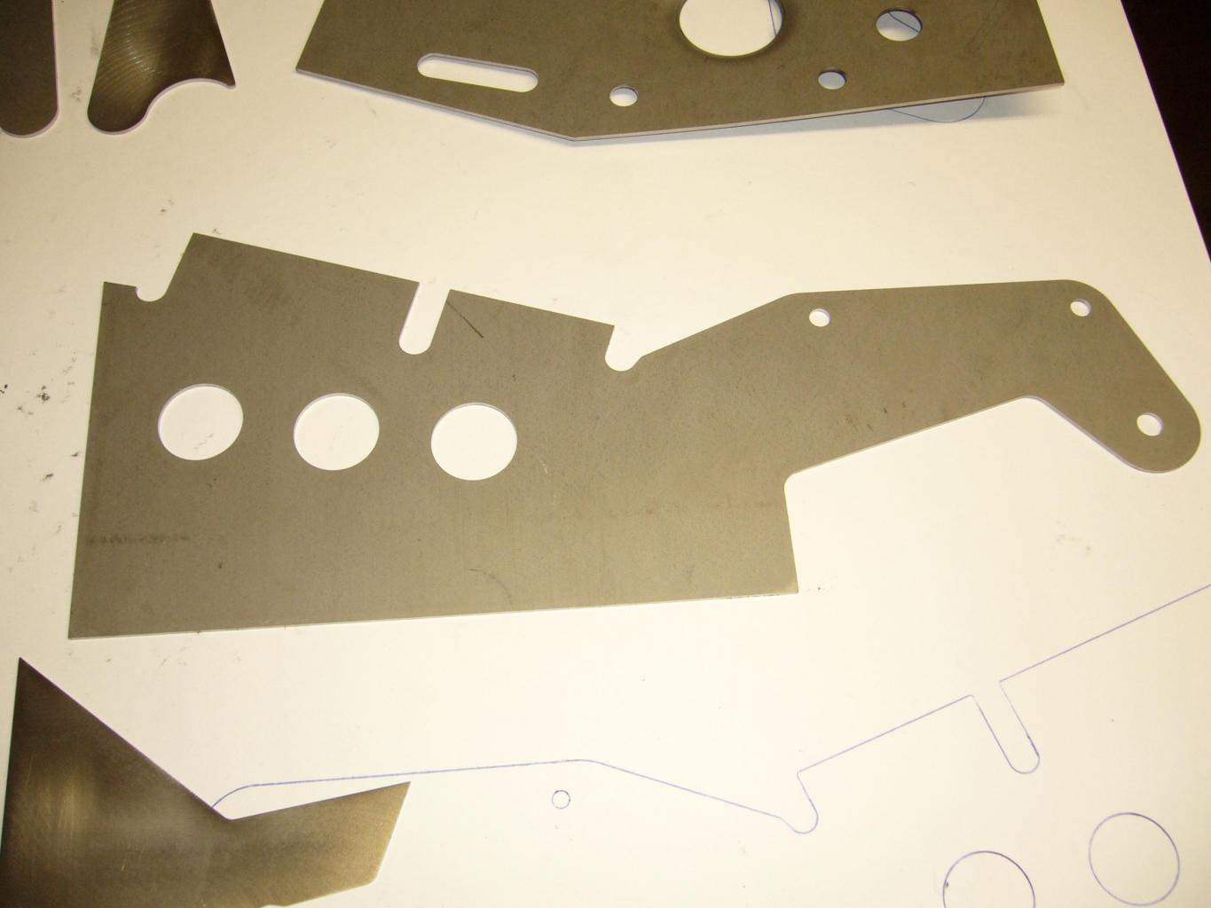

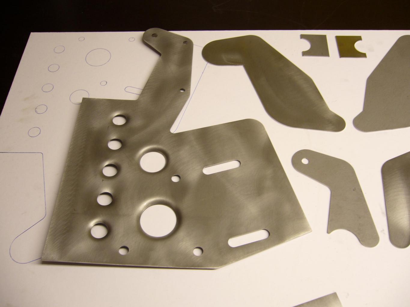

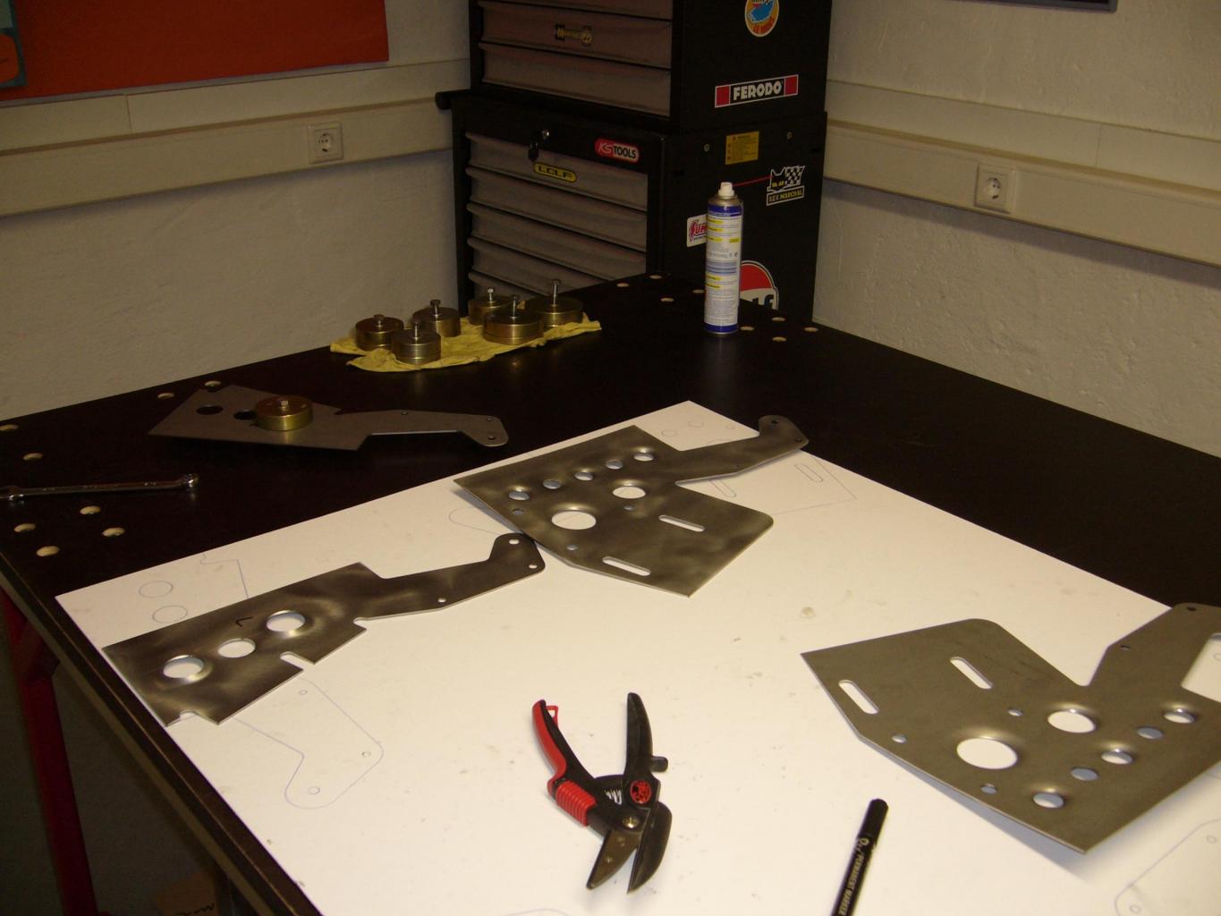

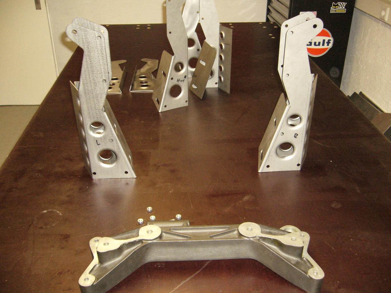

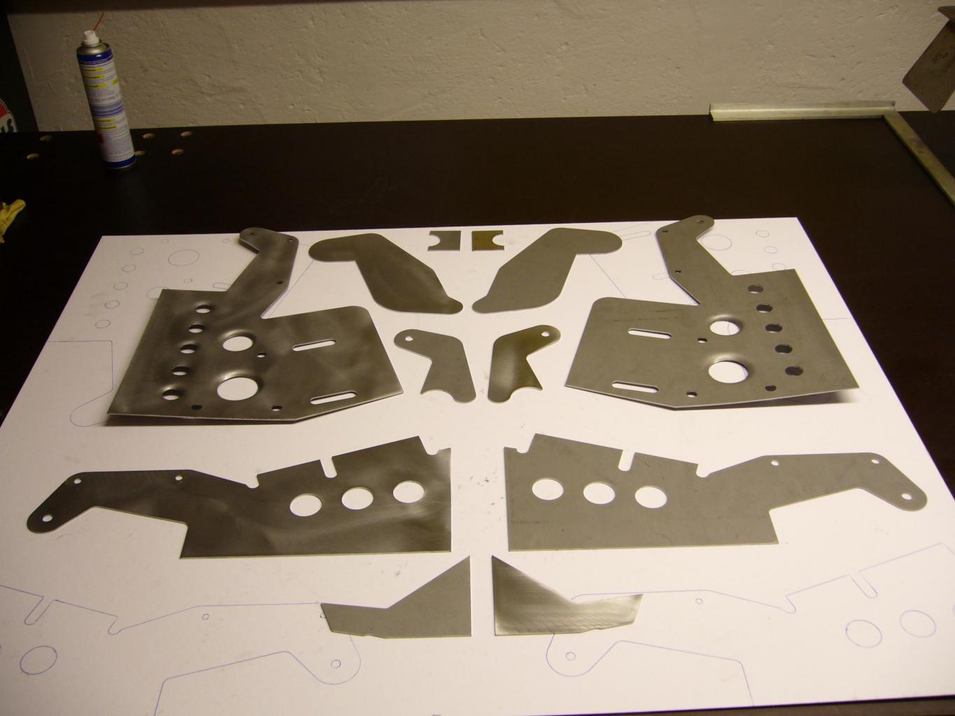

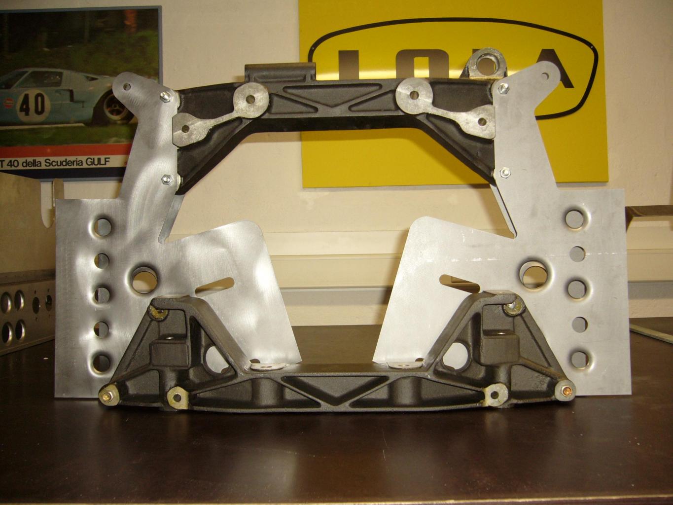

For trial reasons I´ve now had my first set of panels made from the digital files.
I was quite amazed how quickly it went...from sending the email with the files to getting the call for picking up the laser-cut parts only 2 hrs. elapsed. The quality and the accuracy of the parts turned out beautifully and to my delight they all fit precisely with the cast cross members.

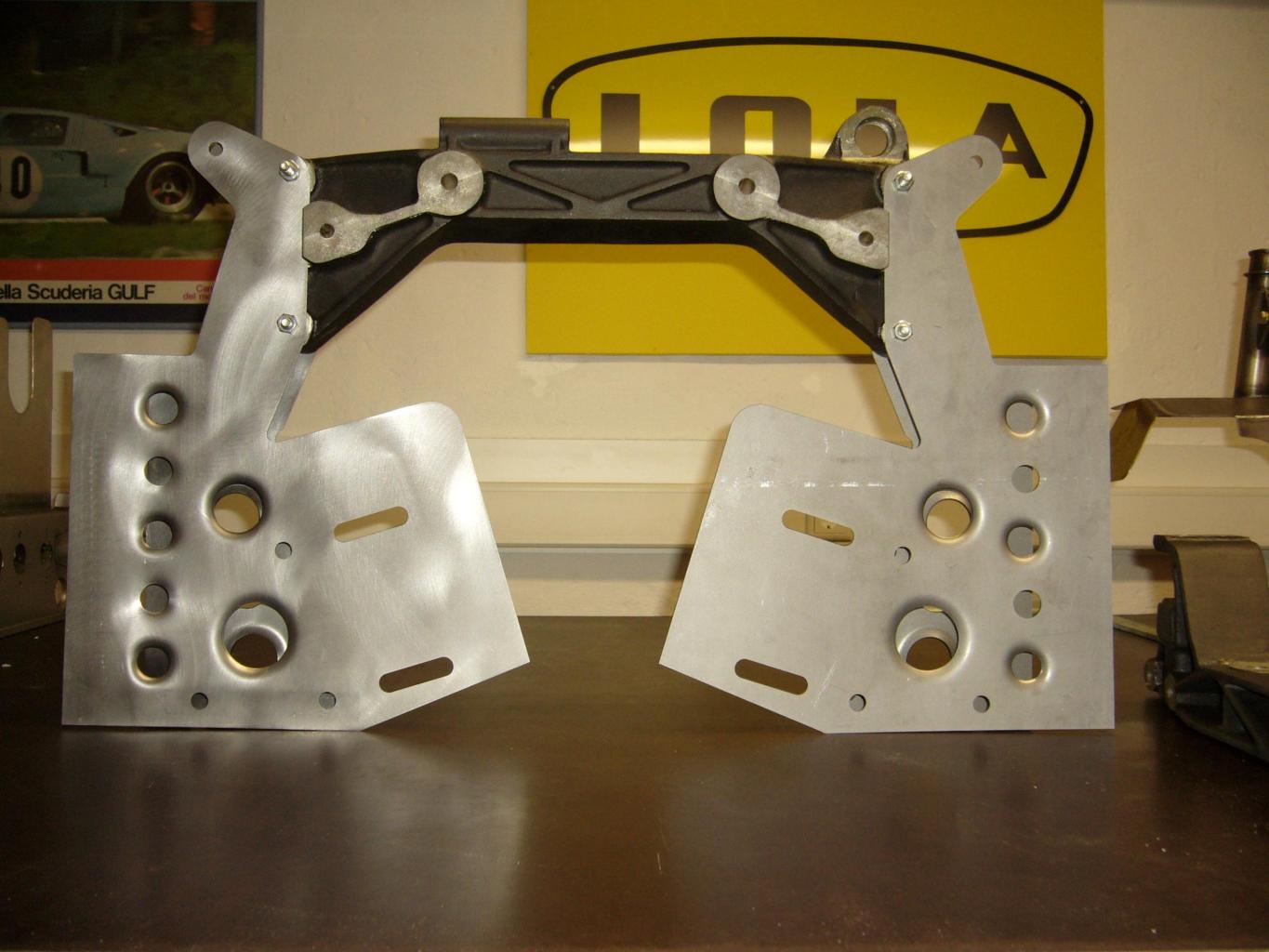

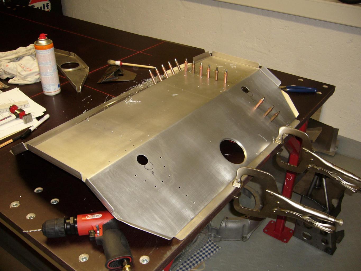

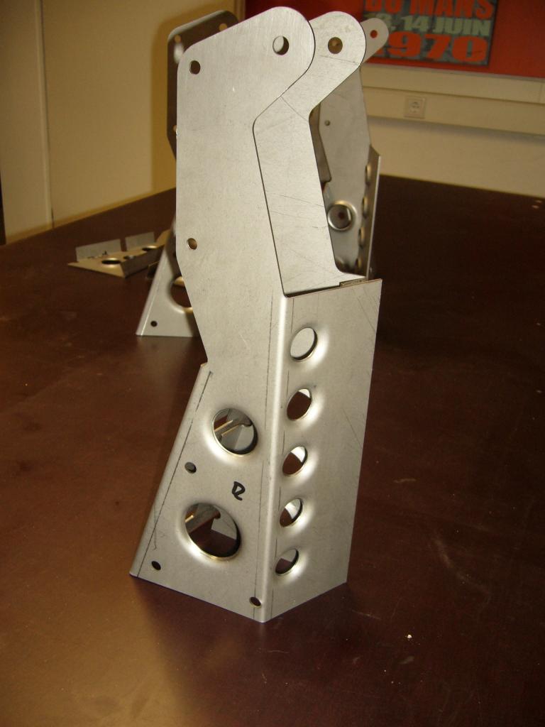

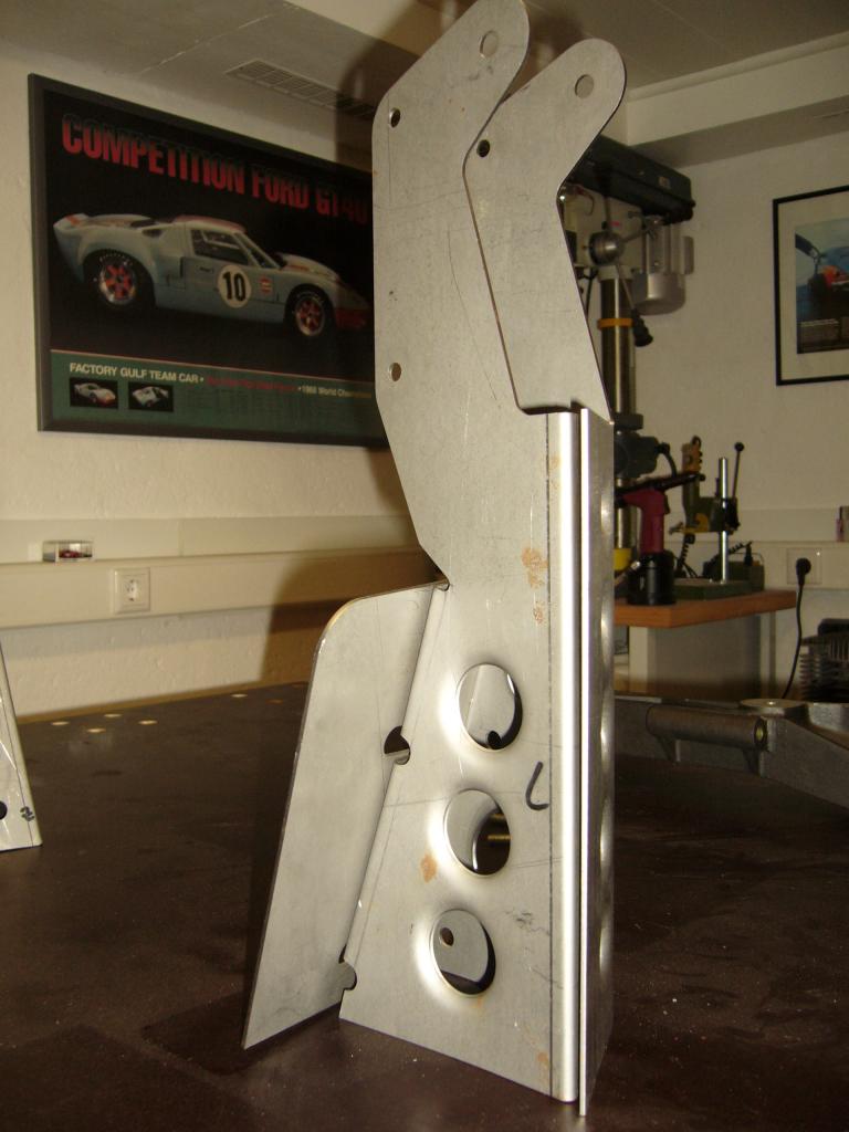

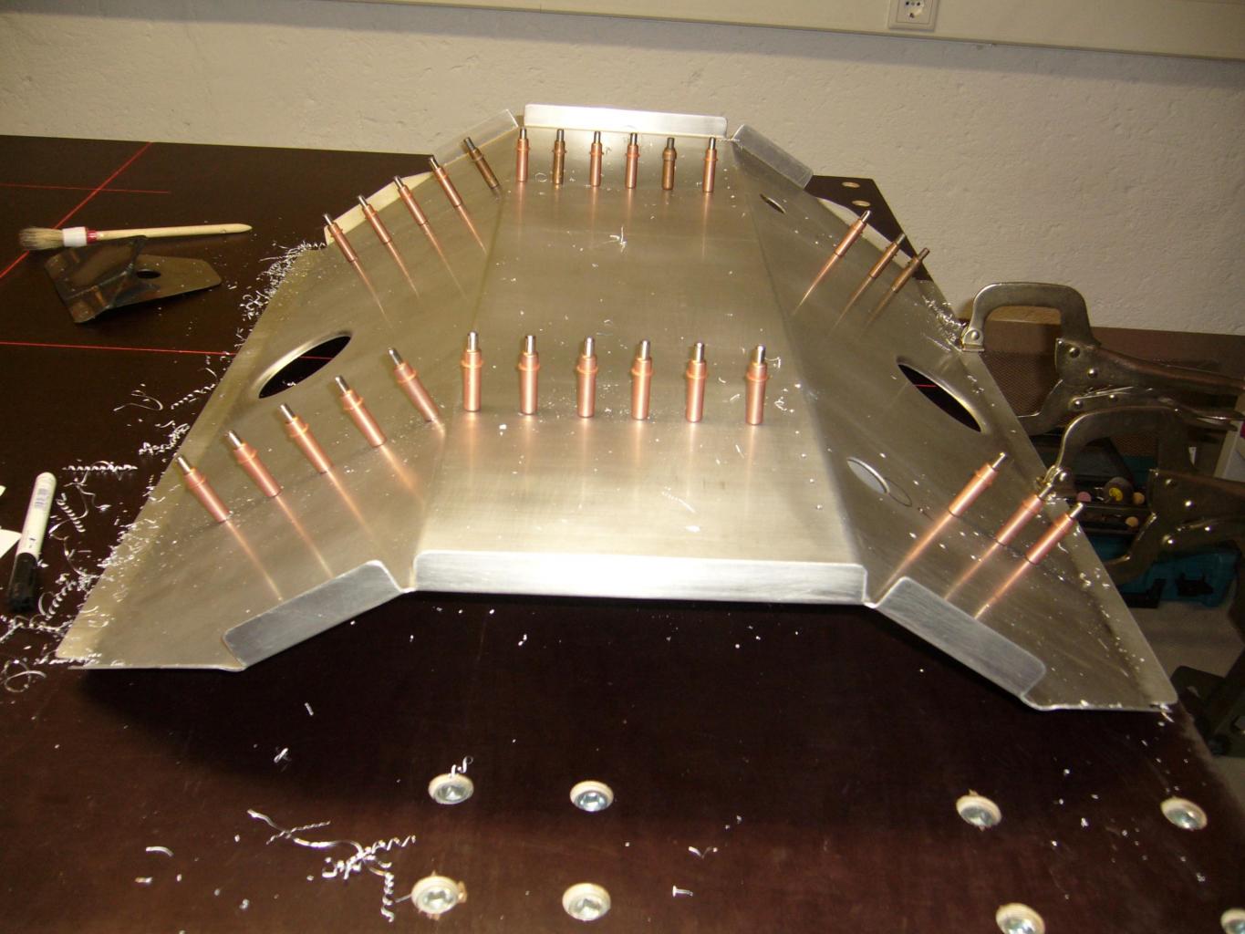

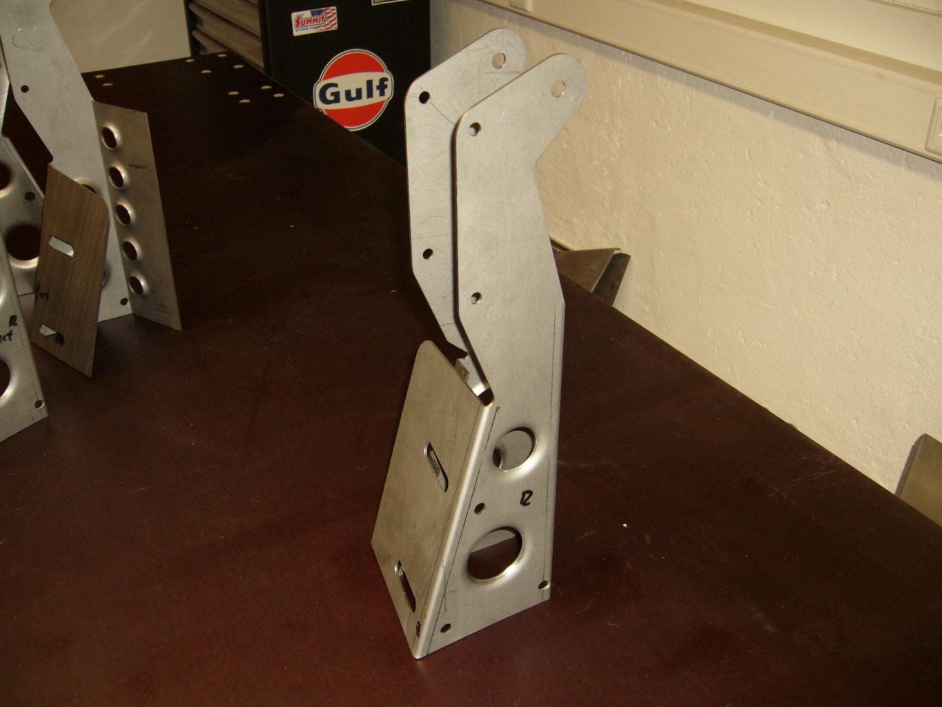

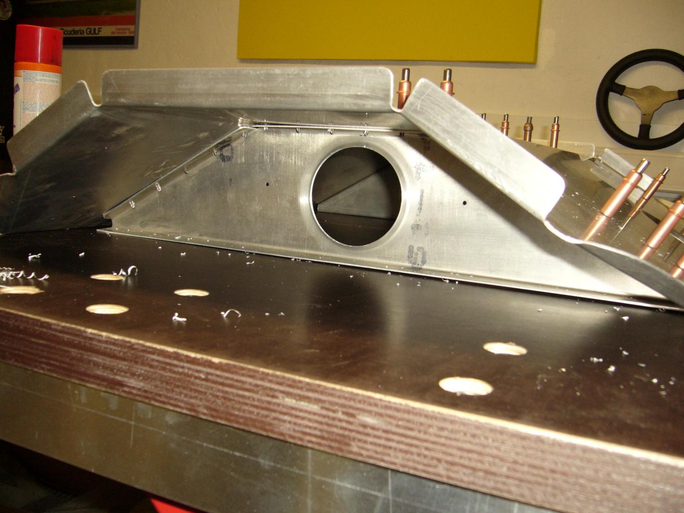

The process of finishing and bending the rear shock towers is a bit tricky because I could only flare the holes before bending yet bending the sheet metal with the holes flared is then another story...
...here are the intermediate results so far:

Very well done Marcus. Always knew you were a grade 'A' bender mate.. :thumbsup:
Can't wait to see the finished article. Will I still be alive then? :worried:

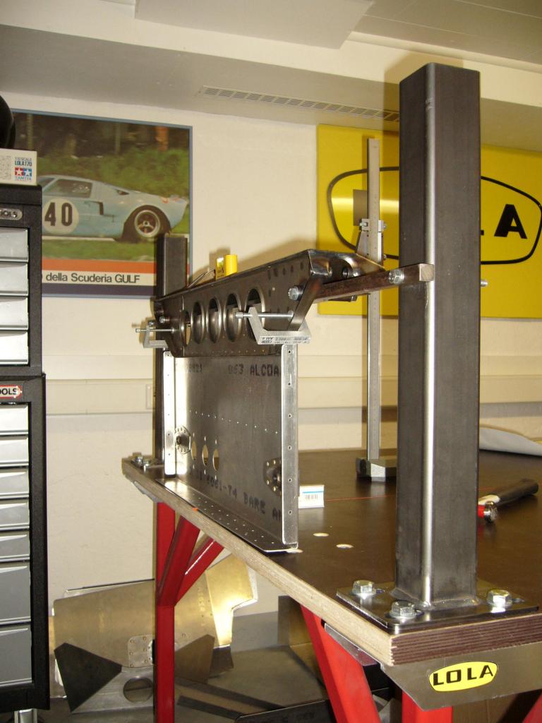

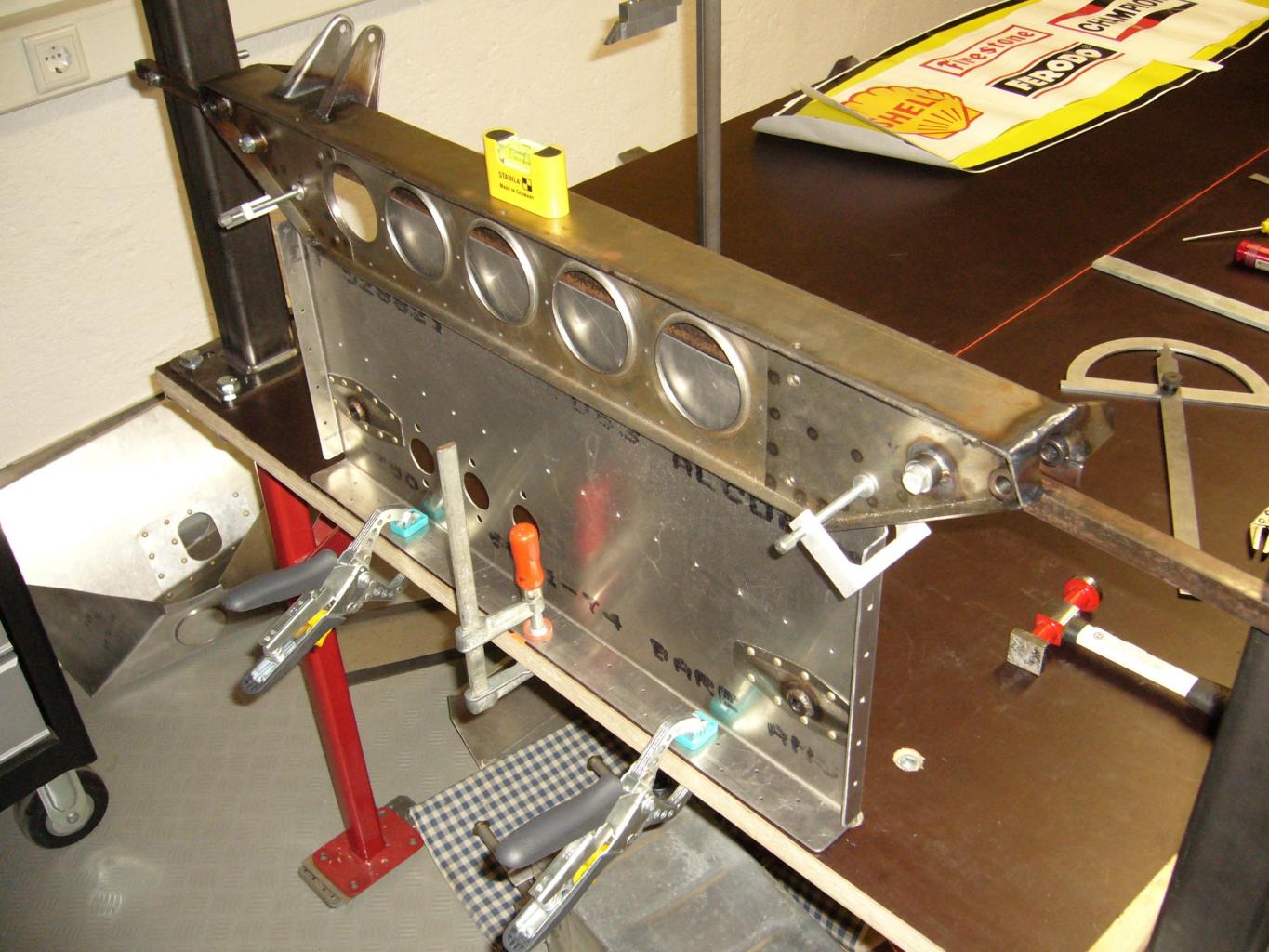

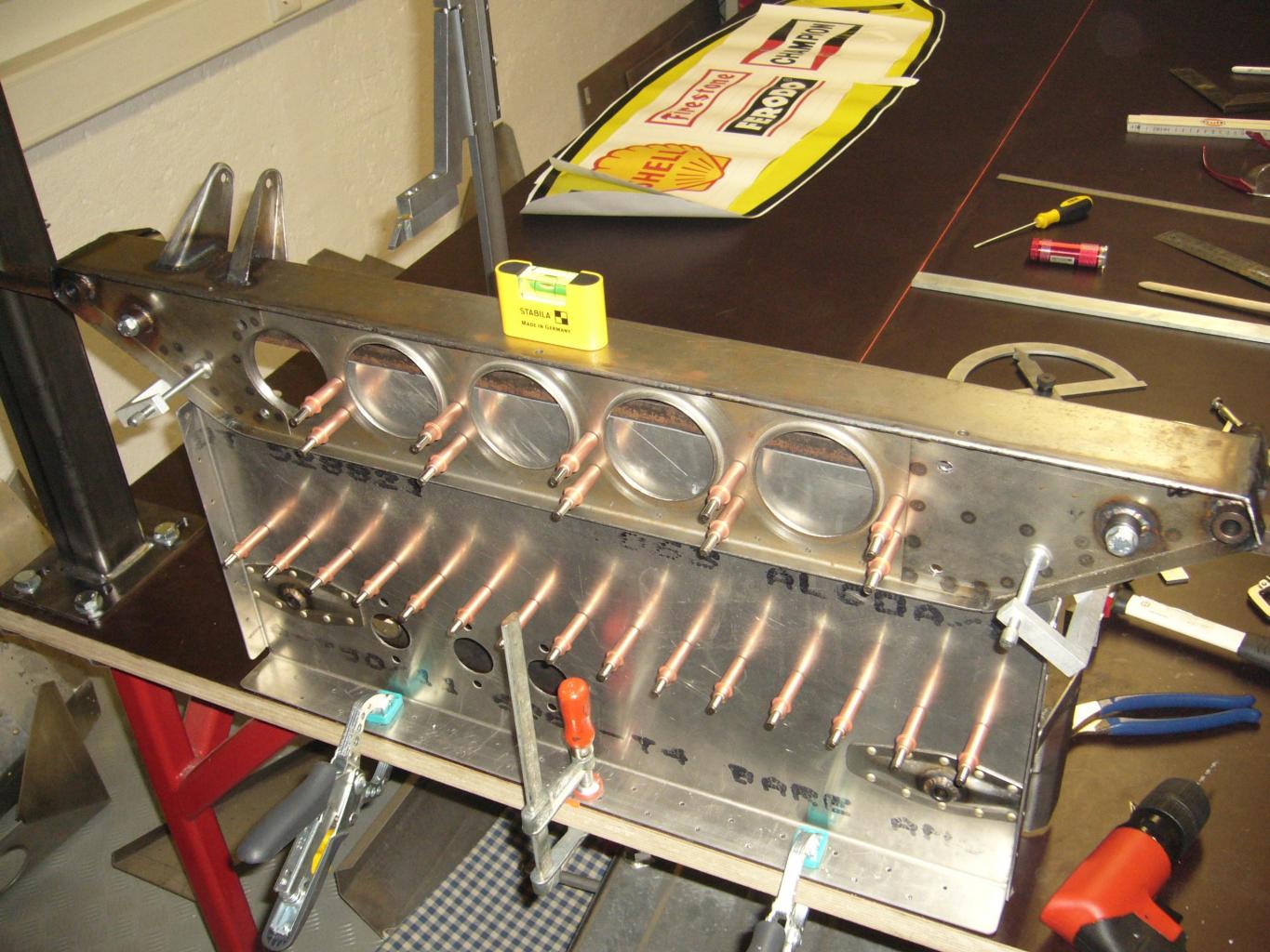

Starting now to rig up the fixture.
I begin with the front bulkhead as all dimensions of the chassis (the ones I´d been given, anyway) have the front bulkhead as a reference point. Then the other bulkheads will be positioned and then fixed according to the dimensions.
It took me the better part of the day just to align and fix the upper cross beam of the front bulkhead.
