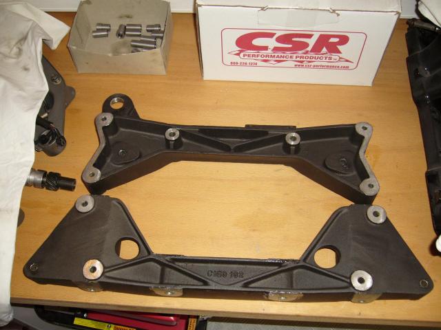

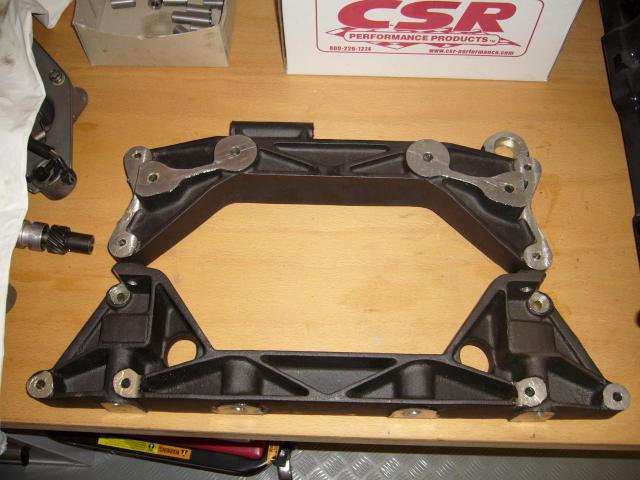

Got a set of magnesium upper and lower rear chassis cross beams:

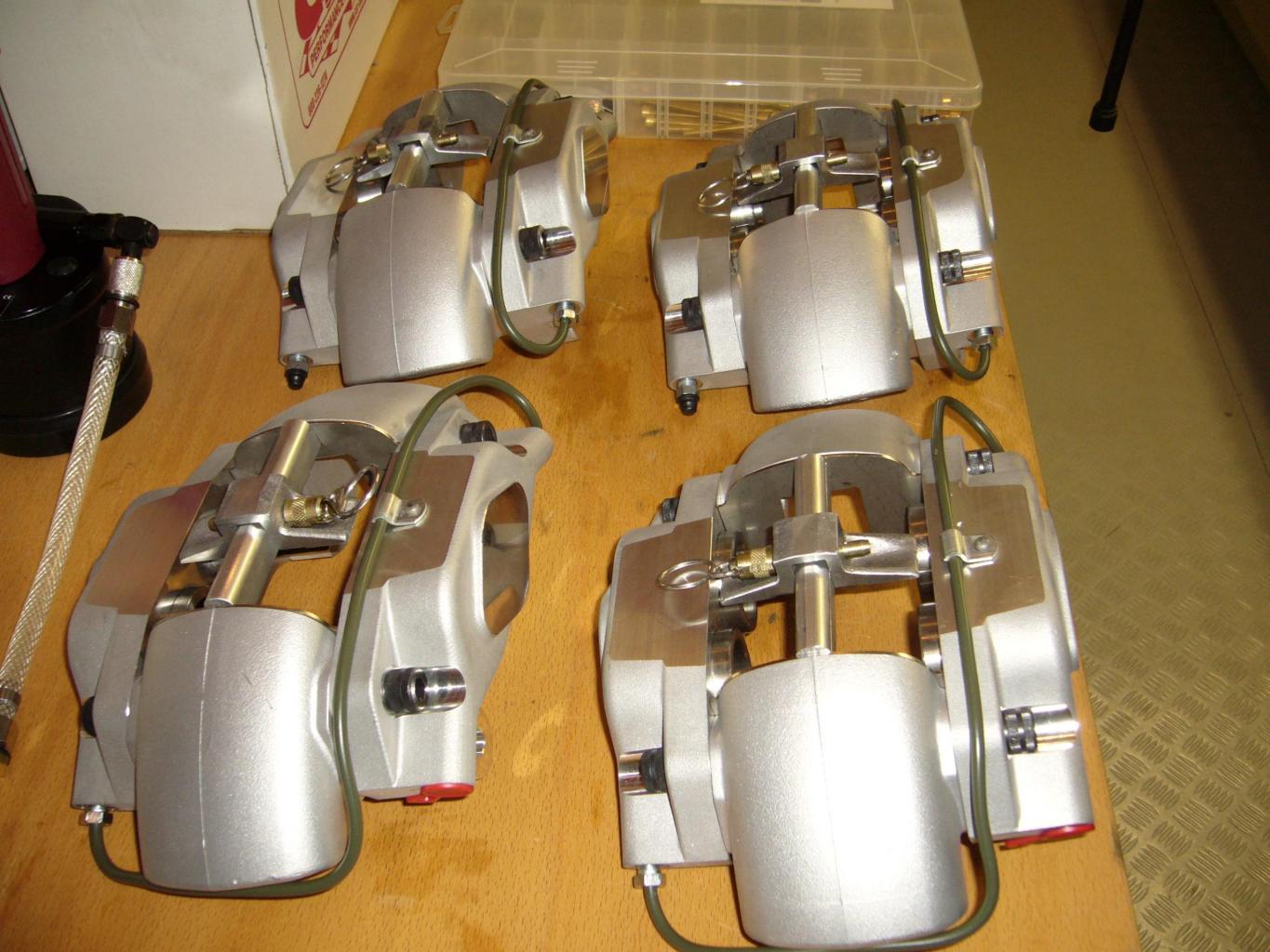

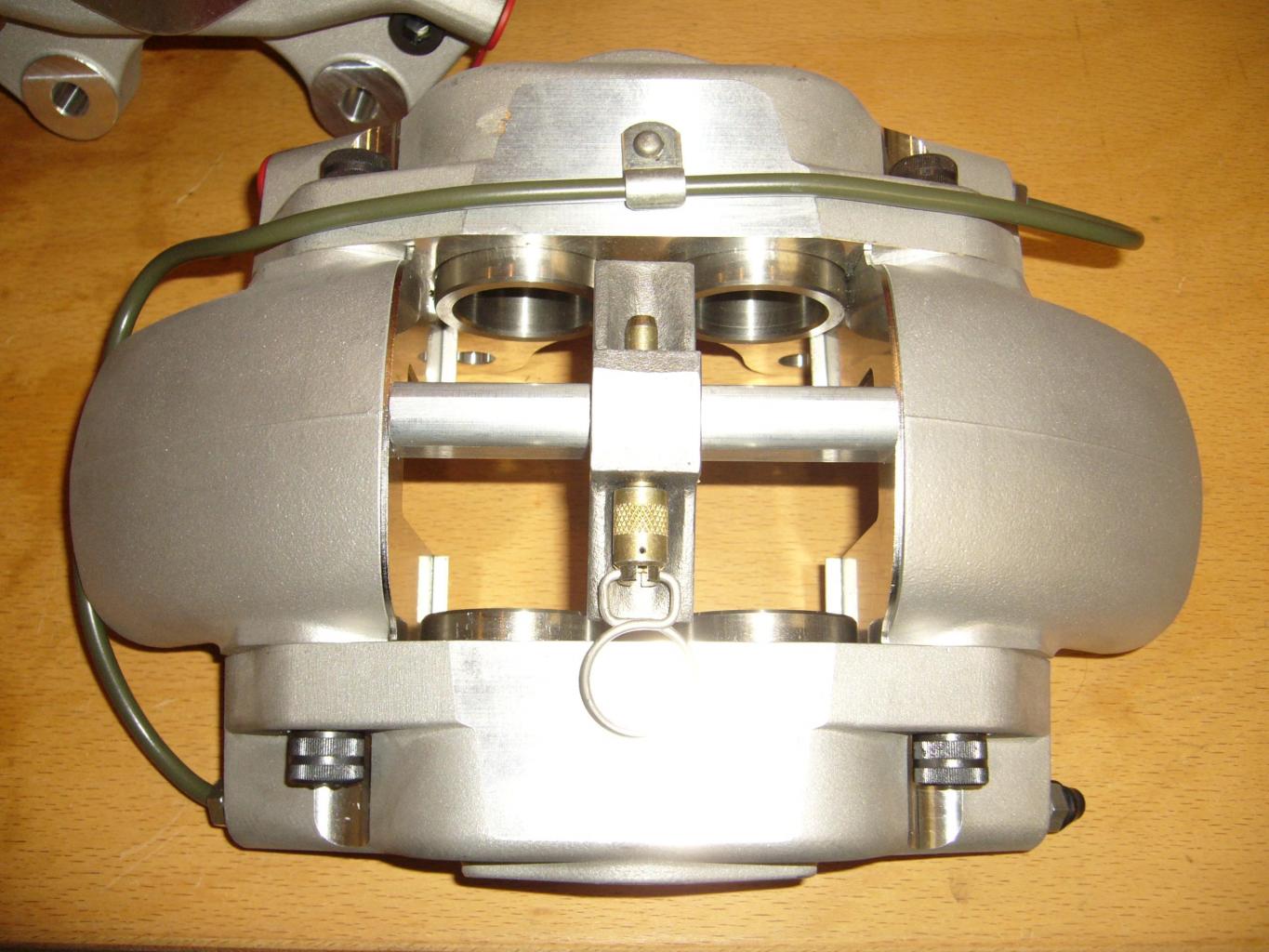

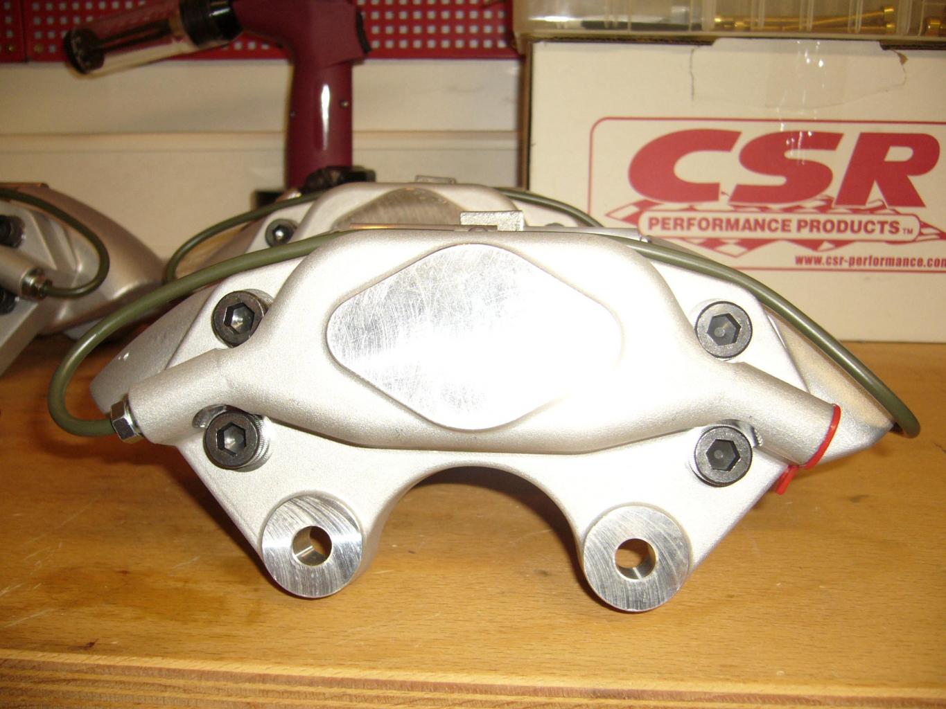

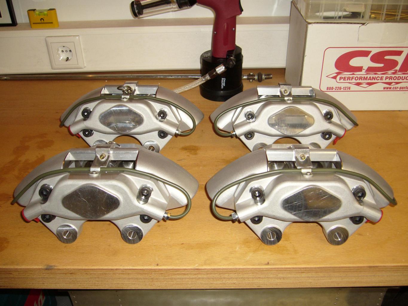

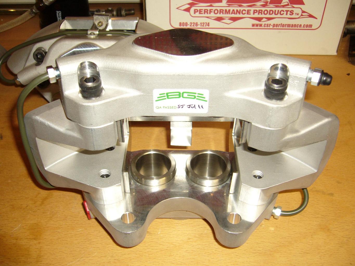

Meanwhile a set of brand new Girling calipers 18/4 and 16/4 has arrived:
