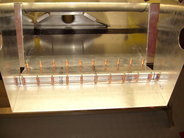

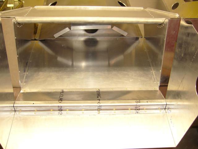

Some more work done today, fixed the Rad Base Panel:

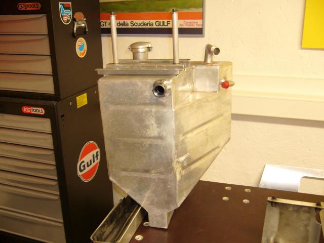

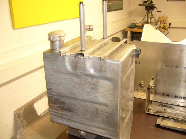

Couldn´t believe my luck...managed to get hold of SL 76/144´s original oil tank:
Marcus - that oil tank looks quite massive! Can't help but wonder what the capacity is...

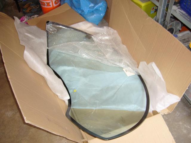

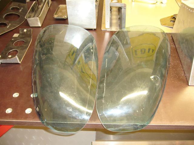

The Windscreen was quite the score as well!!!
Randy,
indeed it´s quite a big thing, but I have to admit that I´m not sure about it´s capacity.
Will find out. For all I know in Spa-Francorchamps it was replaced by another oil tank with a more conventional barrel-style design since it was under suspicion of not to having sufficient oil baffles inside to keep the oil pressure up at Spa´s famous Eau Rouge corner. So it still carries all the battle stains of oil and dirt from it´s last mission in Spa.
The front screen was made by Triplex Pilkington and carries a "DOT"-sticker which makes me confident of it being eligible for road-driving...
Best,
Marcus

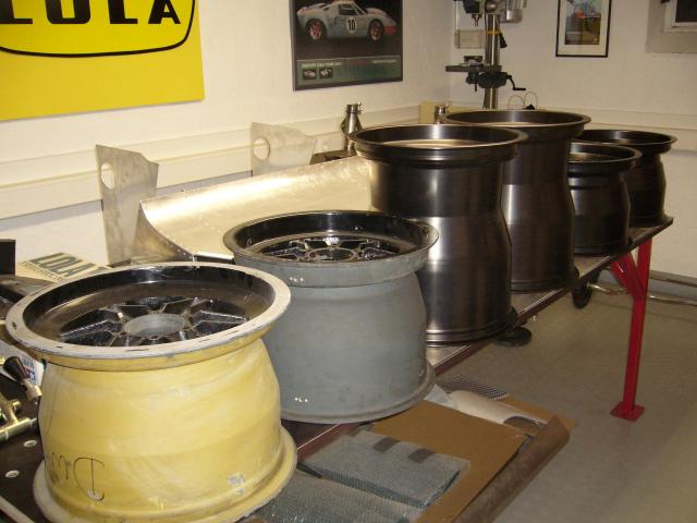

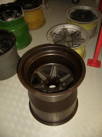

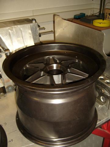

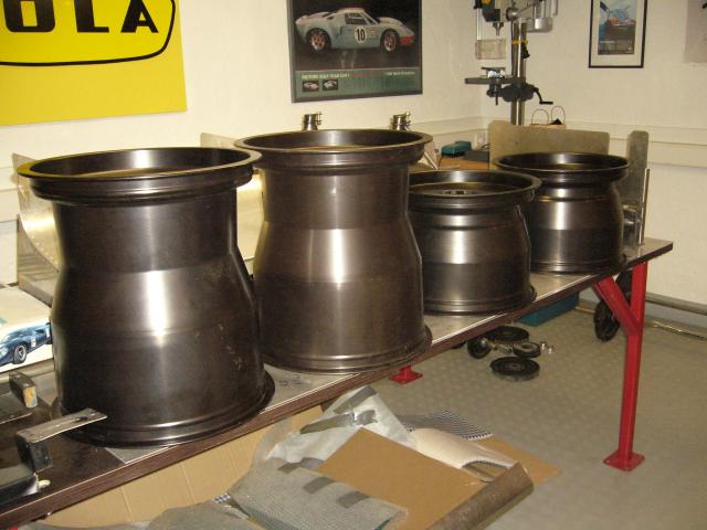

At last got my set of brand new cast wheels 11 x 15 and 17 x 15...
My thanks go to Dave Morton for collecting them!
The story on my bodyshell is rather strange. It is an original shell from SL76/147, whose by then owner literally works and lives round the corner from my office.
