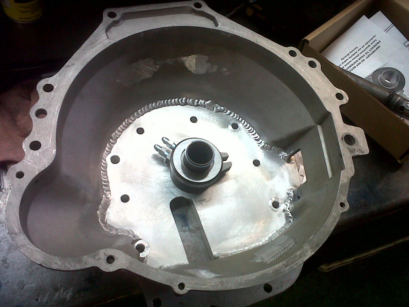

Kennedy doesnt offer one. I was going to order one today from GTO (very helpful guy) but, thank god he sent me a pic. Because the trans is in my Delorean is in front of the motor, The pocket for for ring gear is on the other side. Can't justify spending that kind of money and trying to modify that. I think what I'm going to try is to mill down a ford bellhousing on the trans side,, mill down the un1 bellhousing on the engine side,, make a fixture to index them, and weld them together. That way I will be able to use the ford starter and clutch assembly and the renault/delorean release bearing assy.

After a little bit of thinking, I finally got a bell housing finished for my project. 3/4" aluminum plate, 302 t-5 original bell, trimmed down and I welded them together, going to use a hydraulic bearing so I don't have to worry about the Renault fork/ linkage set up. I made it 135mm deep and just going to get the ford coarse input shaft, thats seems to be available from gto, if some one from gto sees this, could u please contact me? As u can see, I am serious about ordering one!

I need to replace the input shaft because I made the bellhousing 135mm which is deeper than the original, and from what I've found on the net, the stock piece is apparently very weak. I was quoted a price on a bell housing and an input shaft, and after making my own bell housing, the guy told me that he wouldnt sell me just the input shaft. :mad:

if you look up at my pic you can see that I am using a Ram throw out bearing, there is enough room. I made my own ring gear cover, hope that helps,
as far as the input shaft, I will end up making one, just havent had the time yet, trans is in the car as I am in the midst of making the 180 headers and fabricating whatever I need to right now
