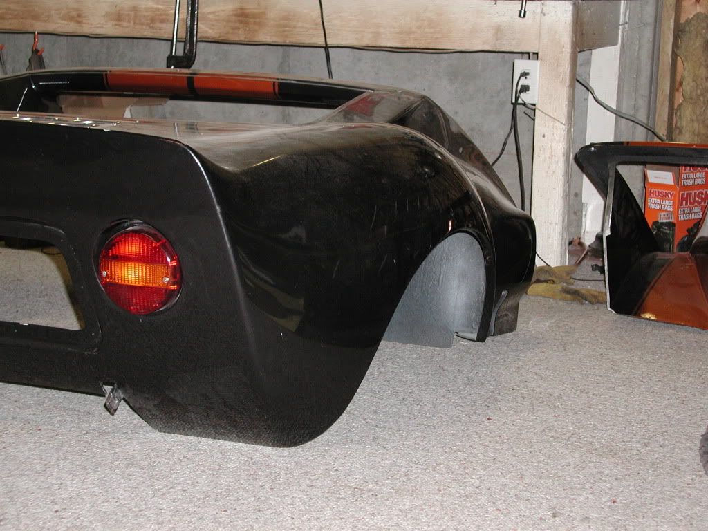

I don't have a CAV, but I do have the 325s. I have the DRB and it came with the regular fenders. When I got the car it had 295 x 15" tires and it barely fit under the wheel well. When I put the 325s they sat outside the wheel arch by at least an inch or two. When I took it off the stand the tires hit the arch, so I had to graft on some fender extensions to get a god fit. My car is a little older than most so it helps to understand the fenders not being as wide as some of the other makes.
Here it is in primer. I would suggest you make sure the suspension will be able to go through its travel without any issues.
Mike, I have 295/50/15s on my CAV, with the standard fenders, and it barely fits. I doubt a 325 will fit unless you have some add'l fender extensions. In other words on full (or near full) compression you'll probably have tires rubbing on the wheel well. You might also find that the rear clam shell is not perfectly centered over the rear wheels, making the clearance problem more acute on one side v. the other side.
