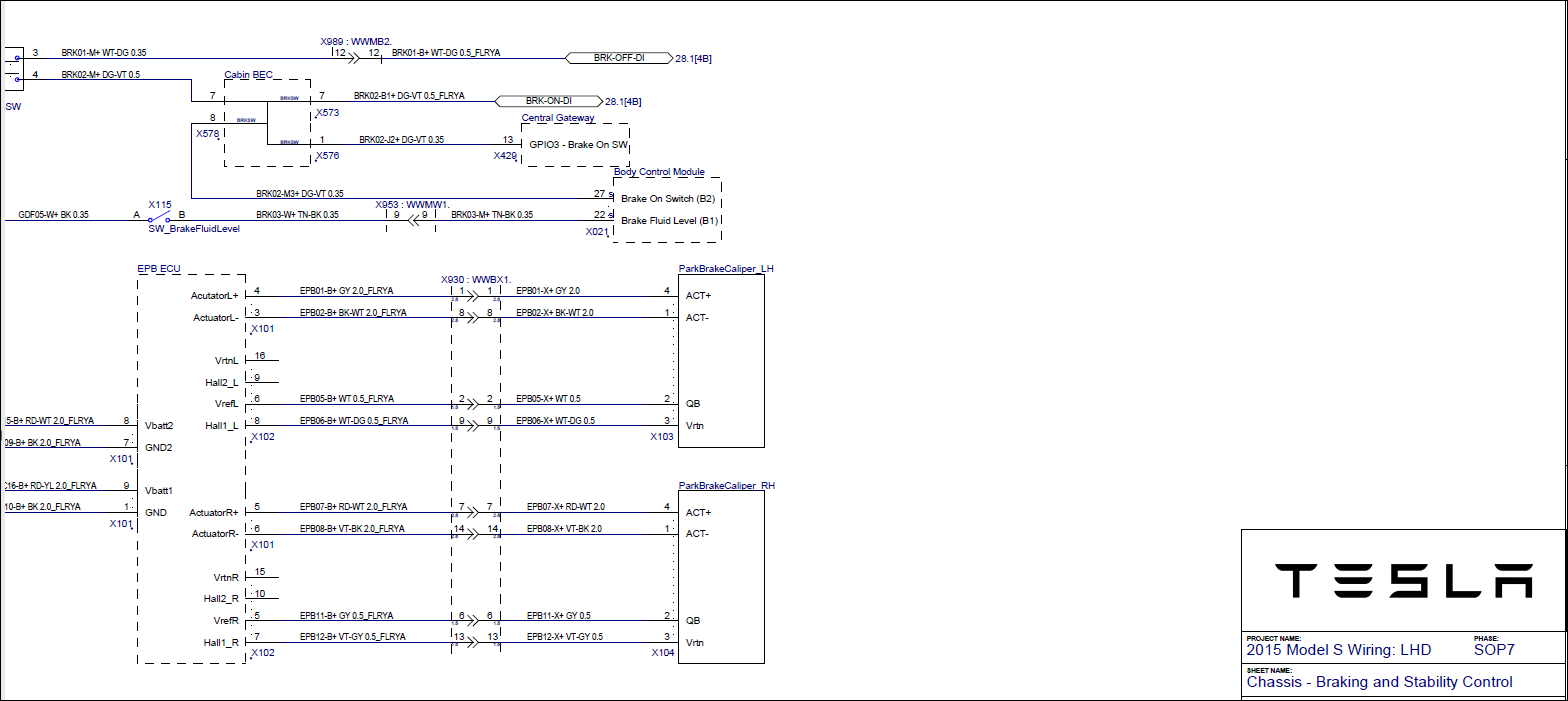

I have been trying to source a good EPB solution for a while for a kit I am builing (Gardner Douglas T70). Found the Hispec caliper but not impressed with their support or the price, also not entirely sure how good it is as there is limited info out there and pad size not too big (granted its not got to do much most of the time).
So I thought about repurposing a tried and tested solution from an OEM, sadly most of them are probably over complicated for a Kitcar, getting into CanBus messages etc. So was interested to see your take on using the Tesla calipers with the controller you selected. Seems a perfect solution, if I understand correctly the controller will current limit so avoiding burn out but at same time getting a consistant application despite pad wear etc. So really interested to see how it worked out. Is it wired and working, would you do anything differently ?

Works really well !! Used one controller for each side so if one fails you still have one working.
I have the "force" amperage set almost at it's minimum setting and it's great !

Thanks for getting back. How much current do they pull each when set "almost" at minimum?
The controller is adjustable from 10 to 30 amps. I used #10 wire (didn't need to) and the 10amps locks the rotor SOLID.
