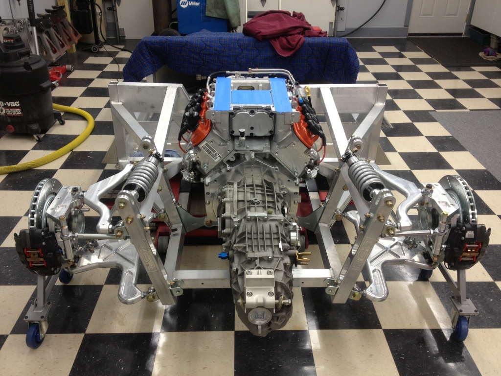

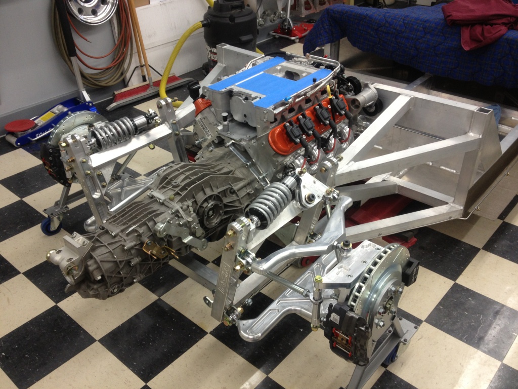

This is how I received the car from RCR. The LSA was fit in the car along with the required frame mods to make it fit.

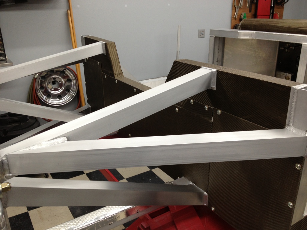

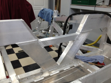

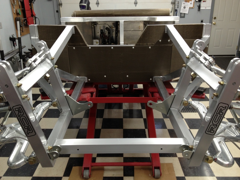

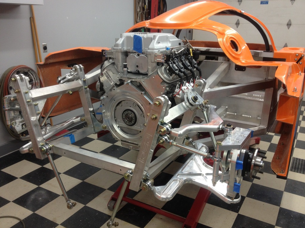

Once the LSA was out you can see the "V" shape mod for the accessory drive. The real issue was the TB .. (air intake) the LS9 has a different angle. This LSA just wouldn't clear the stock configuration.
Installed a bulk head, sheet aluminum covered in Lava Shield.

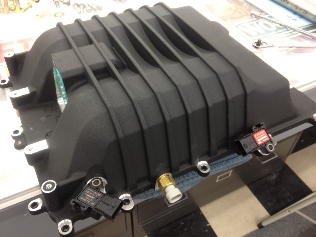

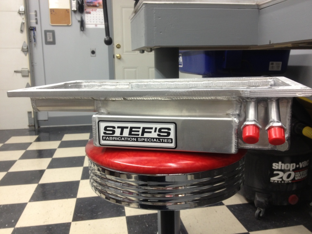

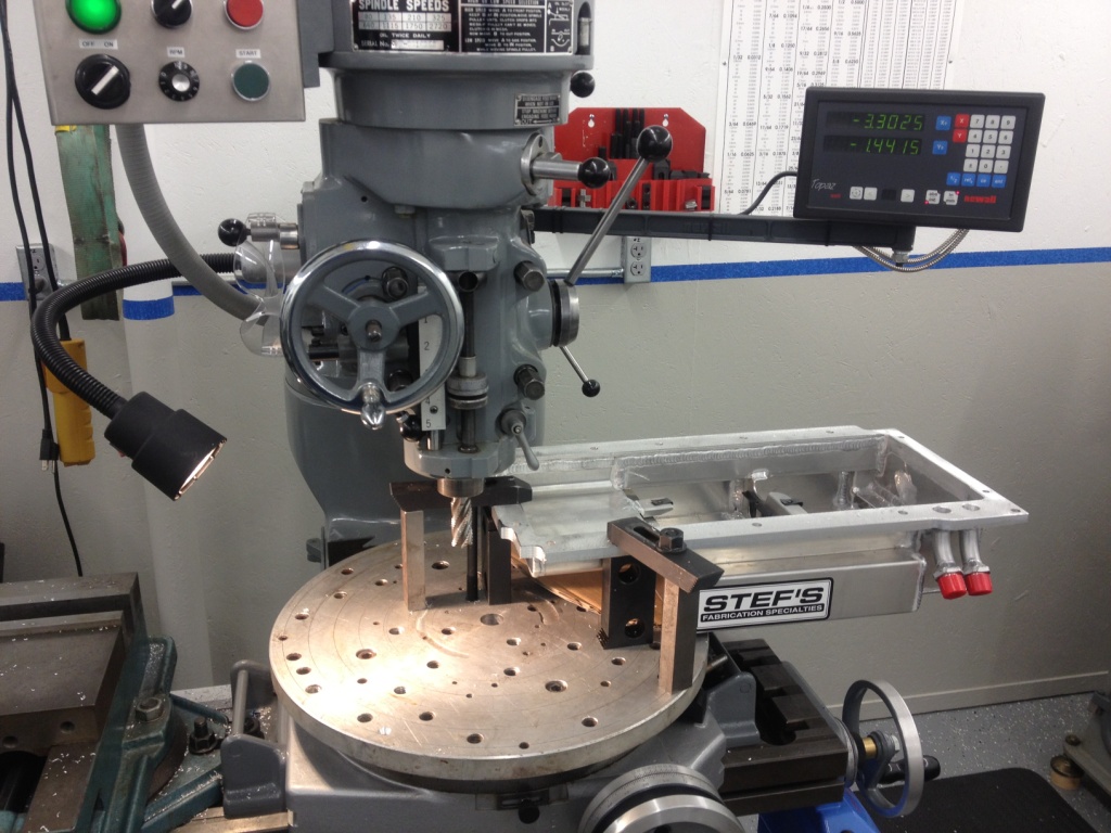

Time for a couple changes to the LSA. Stock oil pan was too low so a custom pan was made to the SLC dimensions. Pan still holds 6Qts, with filter, cooler, and lines, ends up right at 8Qts.

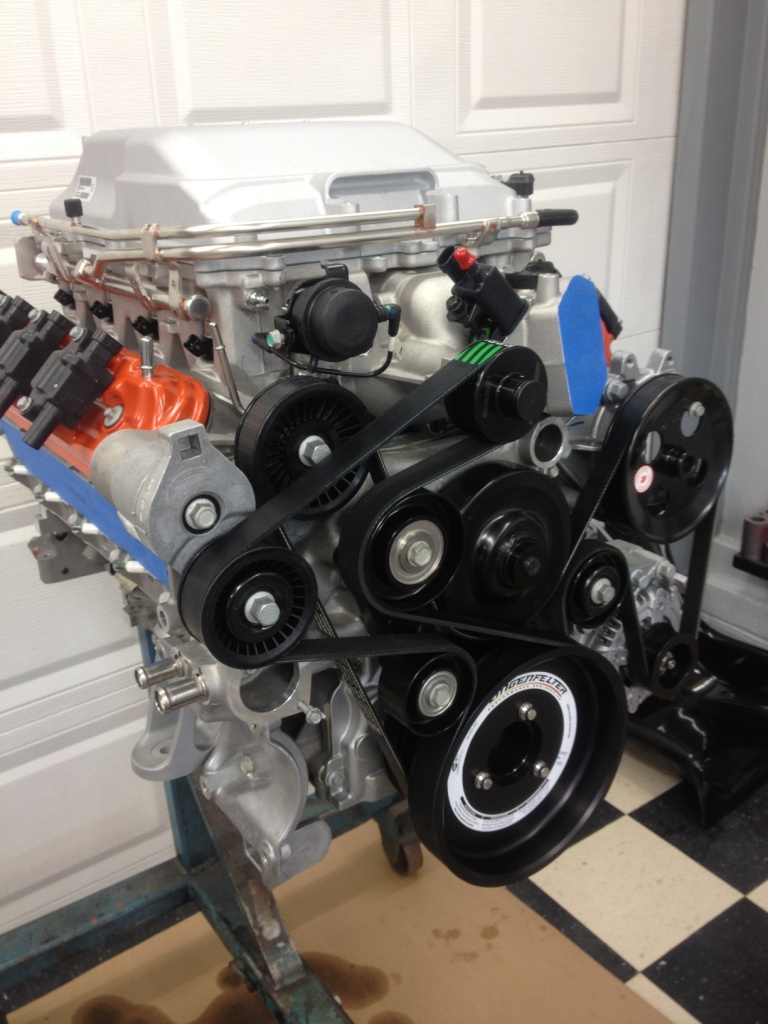

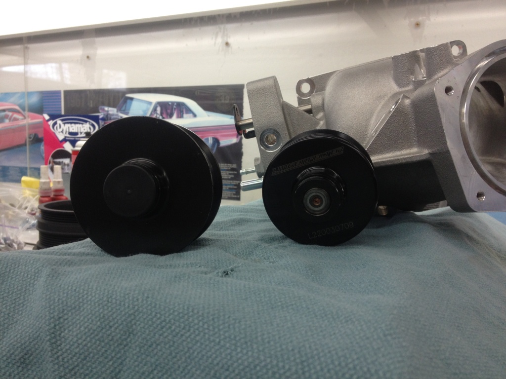

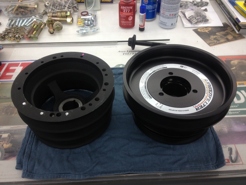

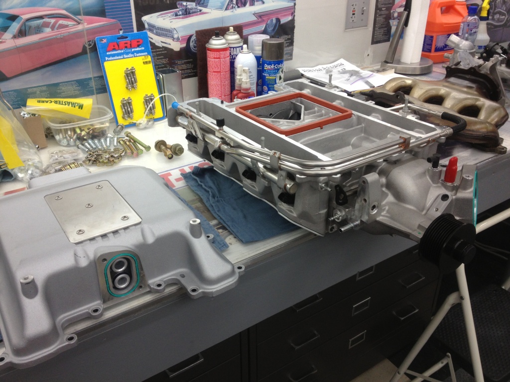

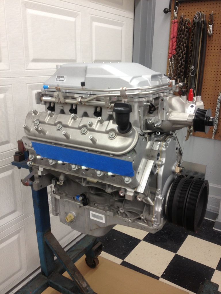

Changed upper and lower pully, changed over to the ZL-1 blower hat, and installed LS-9 injectors.

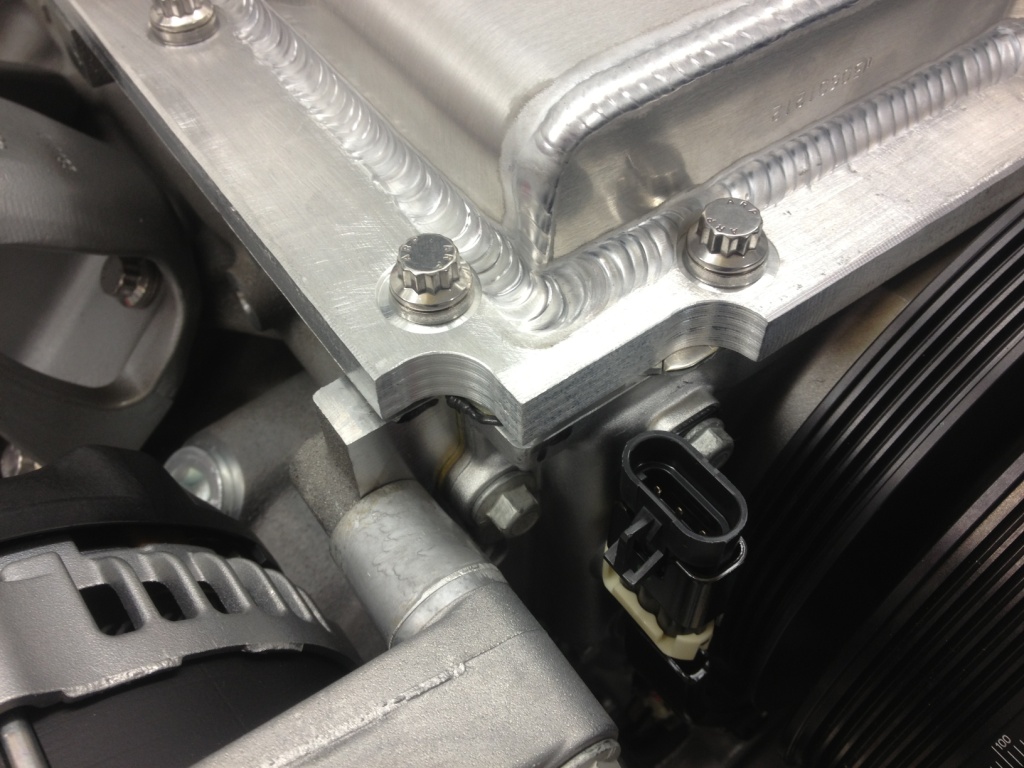

And you know how it goes ... Things just never seem to fit the first time !
A little nip and tuck off the pan rail.

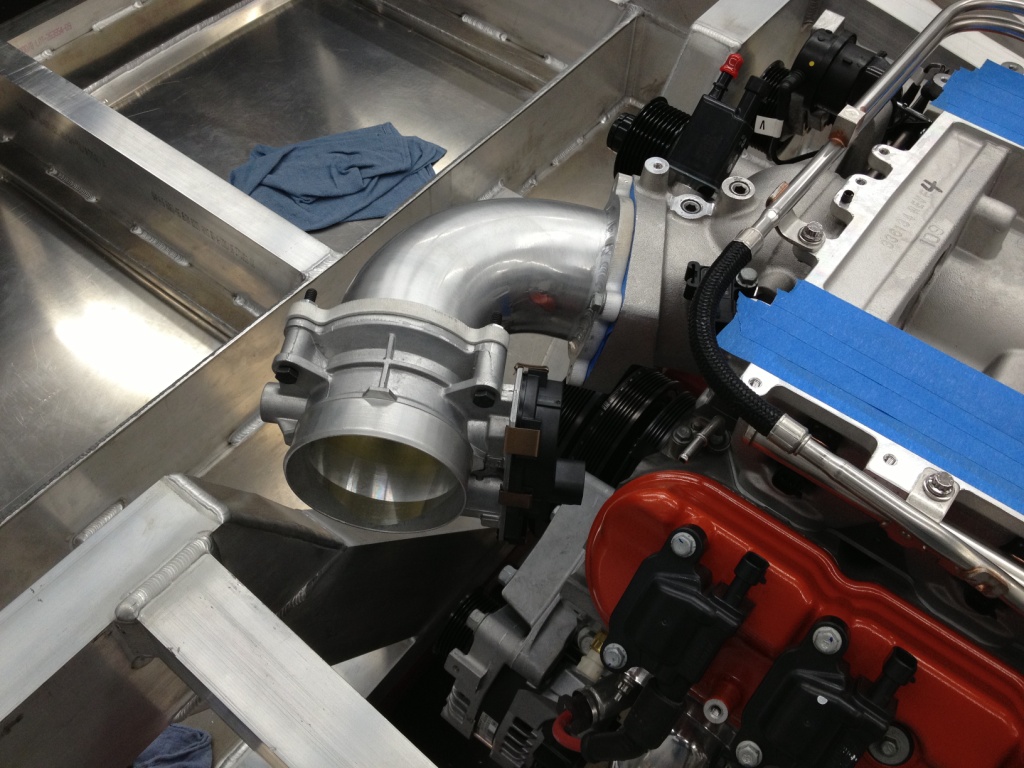

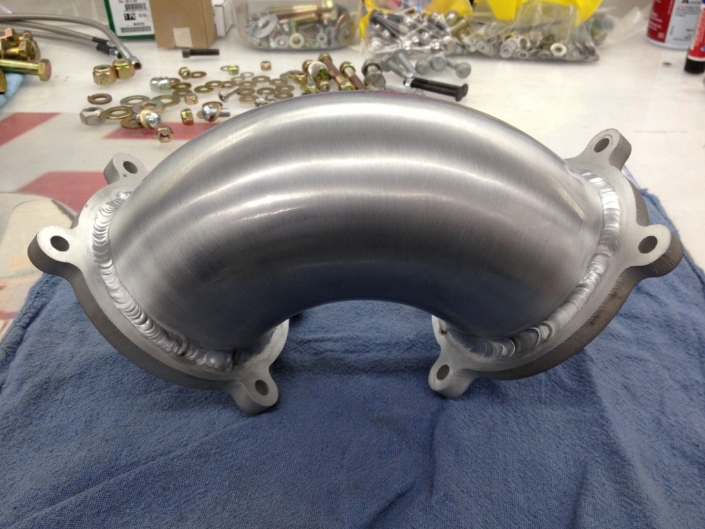

I made this adapter to move the TB. After talking with guys at Lingenfelter Performance, they felt in a manual shift application, the elbow "should" not hurt performance. We will see ...

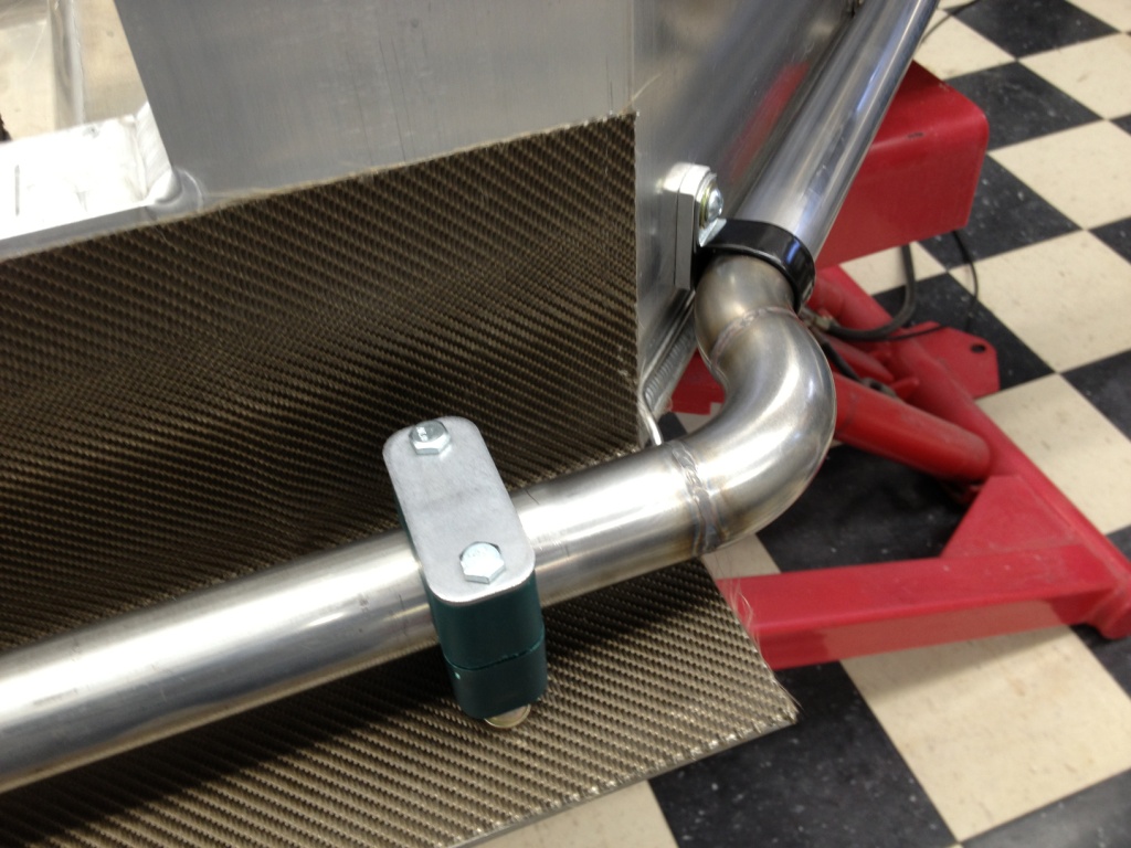

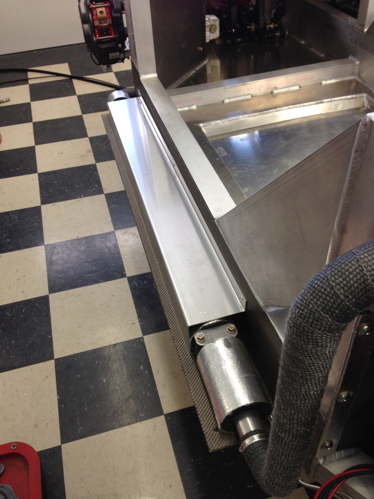

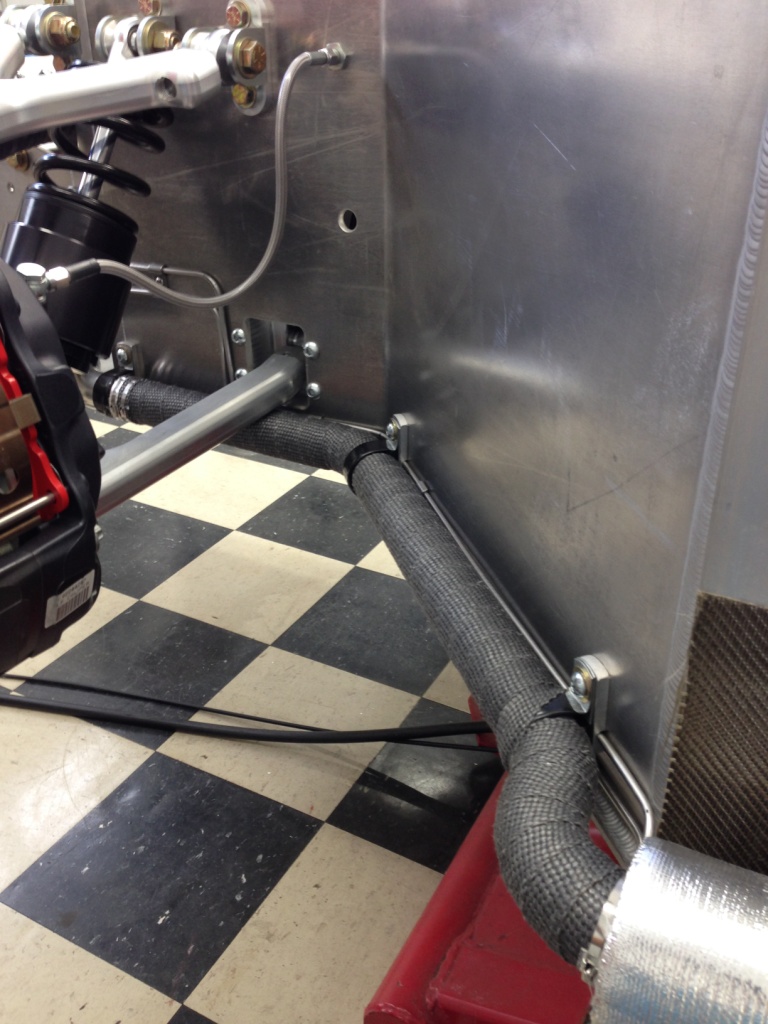

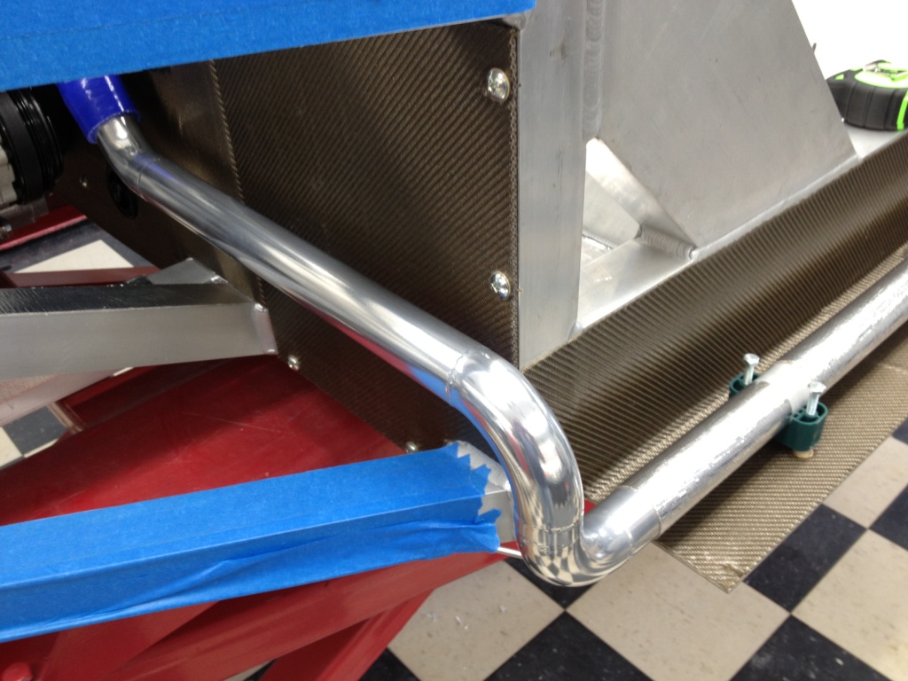

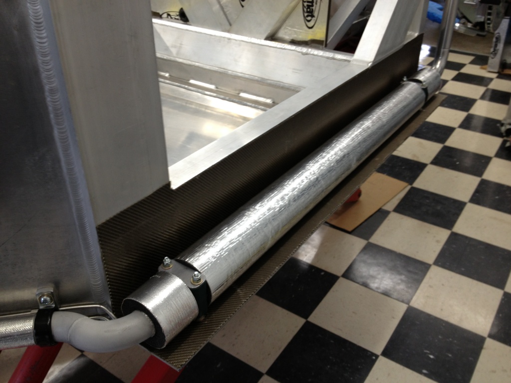

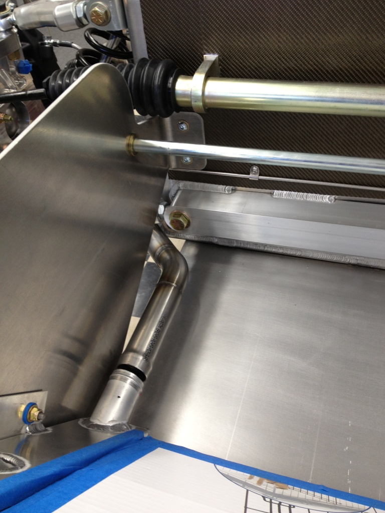

Made cooling tubes from stainless tube, then had them Jet Hot coated to try and keep the heat in. Added additional heat insulation at the passenger compartment.

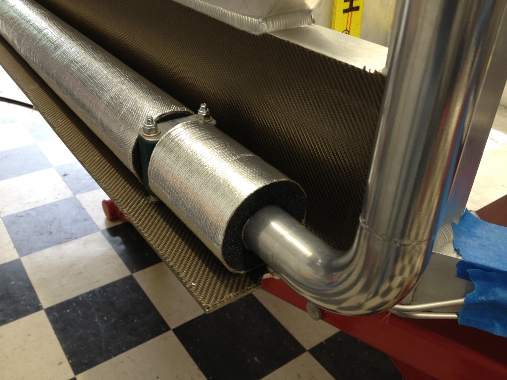

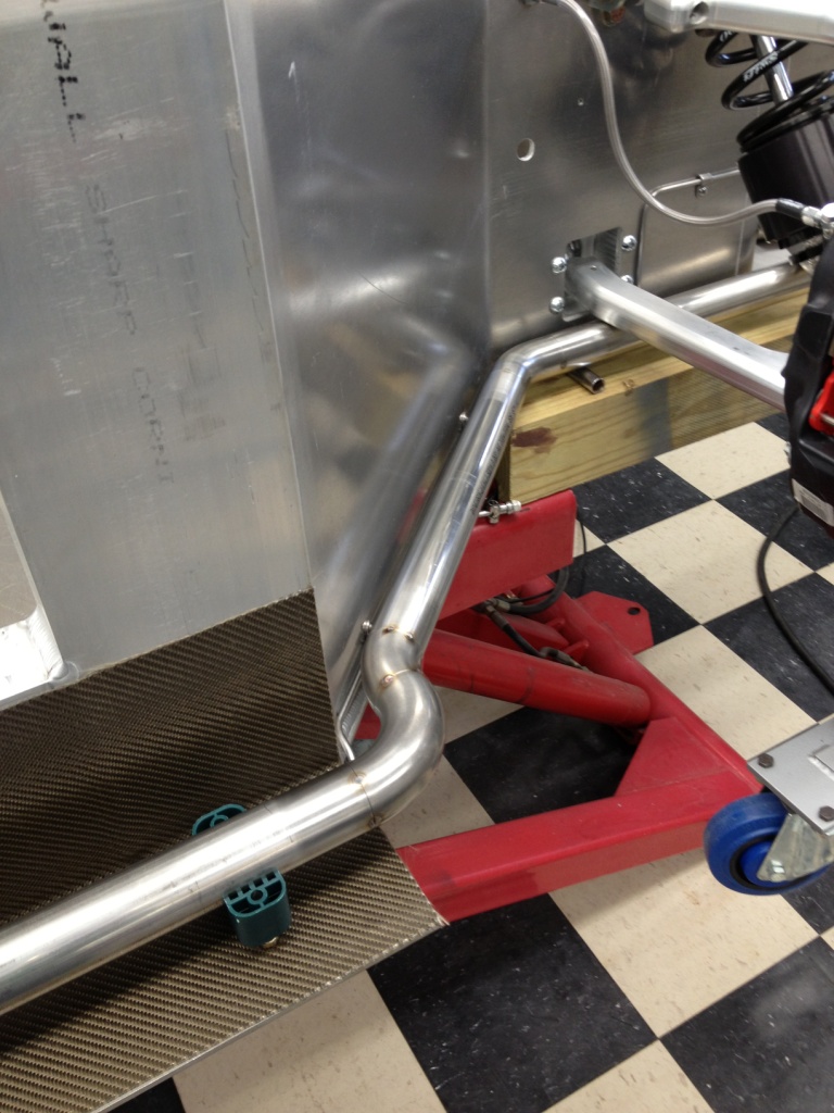

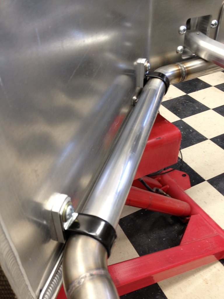

I have been concerned about heat in the drivers compartment. So even though I had the cooling tubes jet hot coated, I decided to wrap them.
May be over kill ? Not sure ... but it only took a couple hours.
Fran also suggested boxing them. Should be a nice spot to run lines and wires.

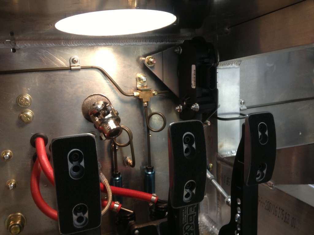

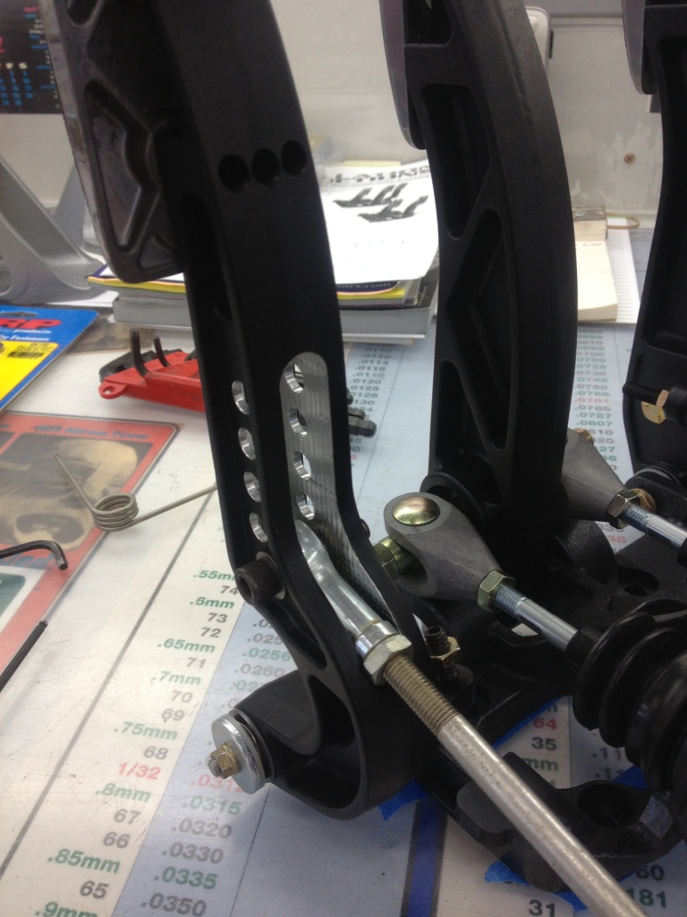

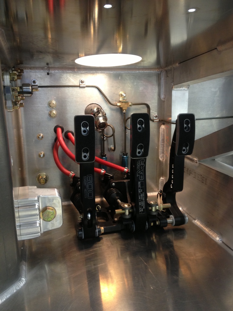

Pedals are in ... Nothing special. I'm a tall guy, so decided no slider, just as far back as I can. I was thinking about notching the front bulk head to allow even more room. But the work would have been extensive and I didn't want to risk stuctural issues. To save space, I mounted the throtle switch on the bulk head and used rod ends to connect. Very stable, works great. Breaks and clutch slave are bled too. So if I was rolling down a large hill making vrooom vrooom sounds ..... I could stop !!
