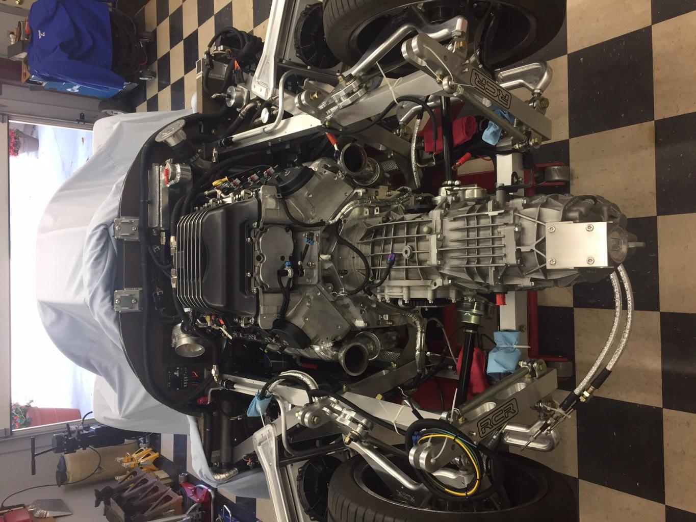

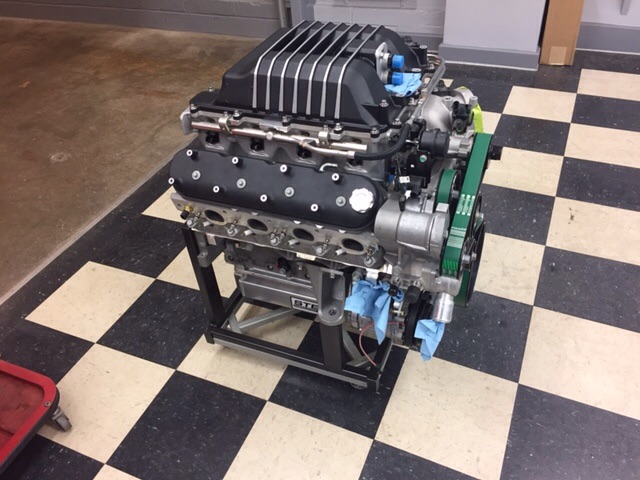

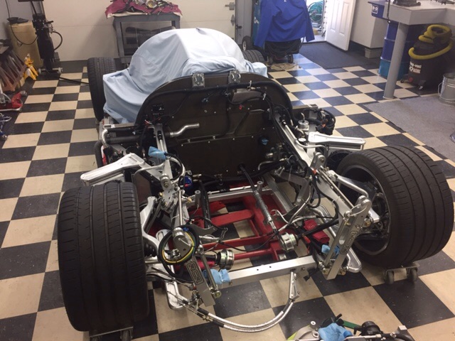

Pulled exhaust and anything in the way.

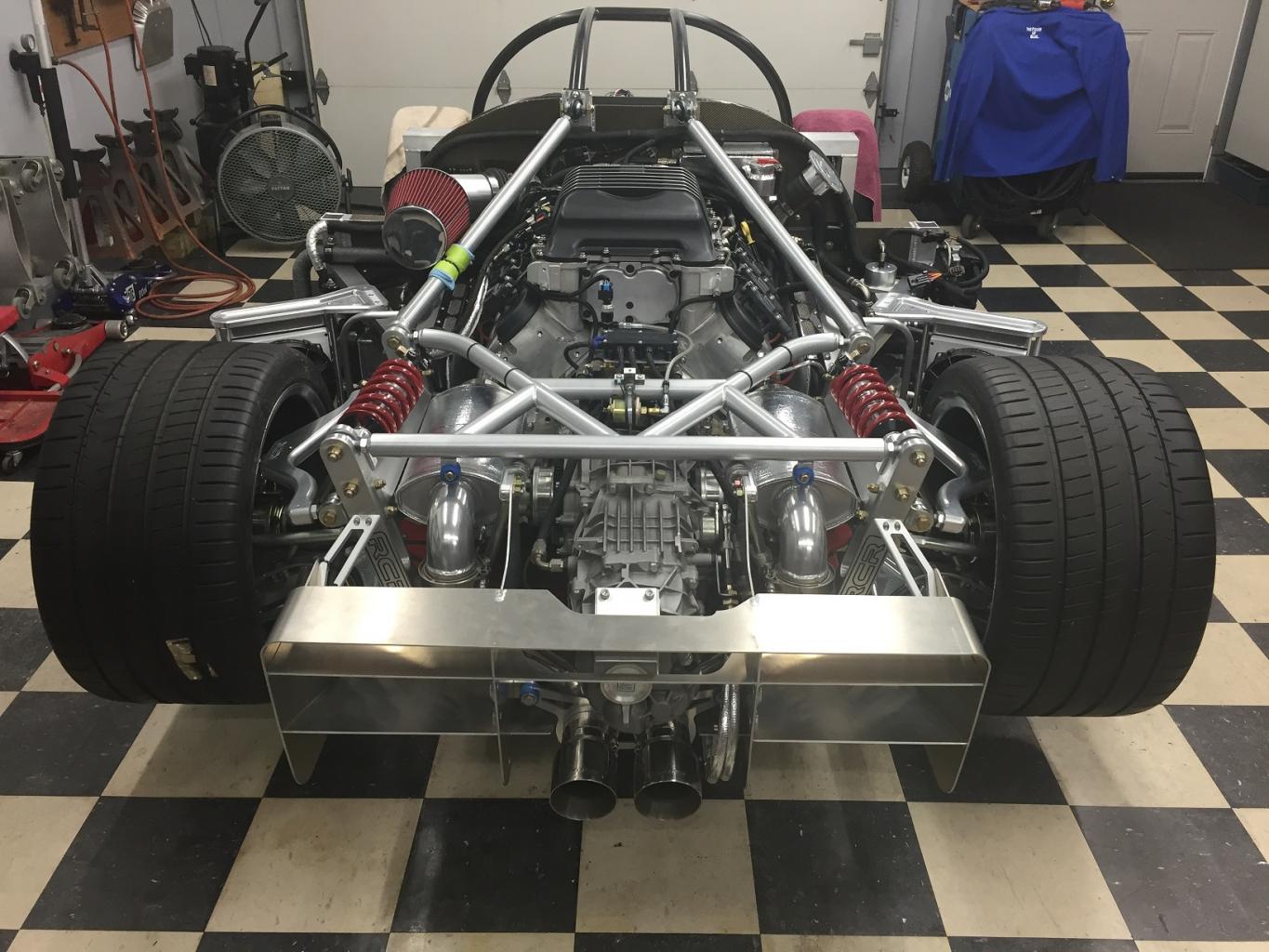

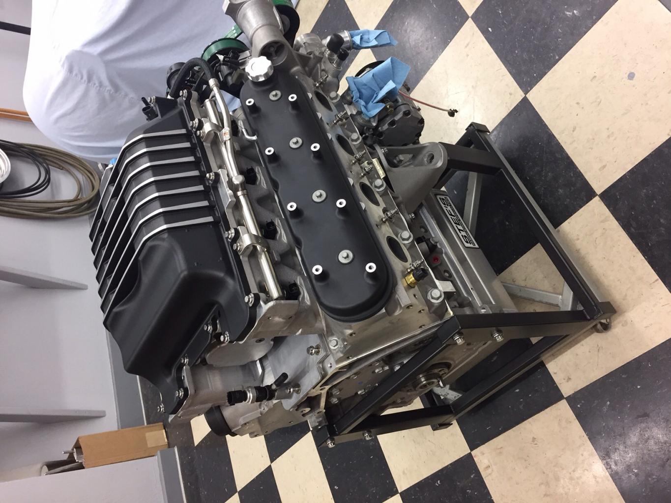

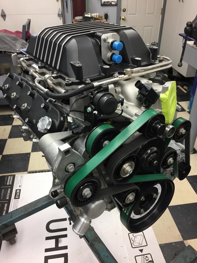

Well guys it set back the build almost a full year ... But I'm back at it !
Engine has been repaired, and improved. A little more boost, better oil system, complete valve train up grade.

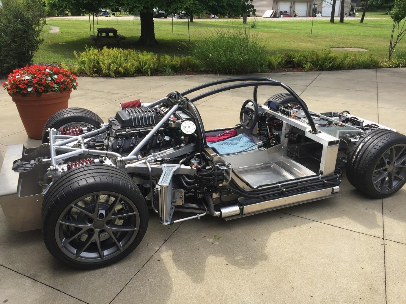

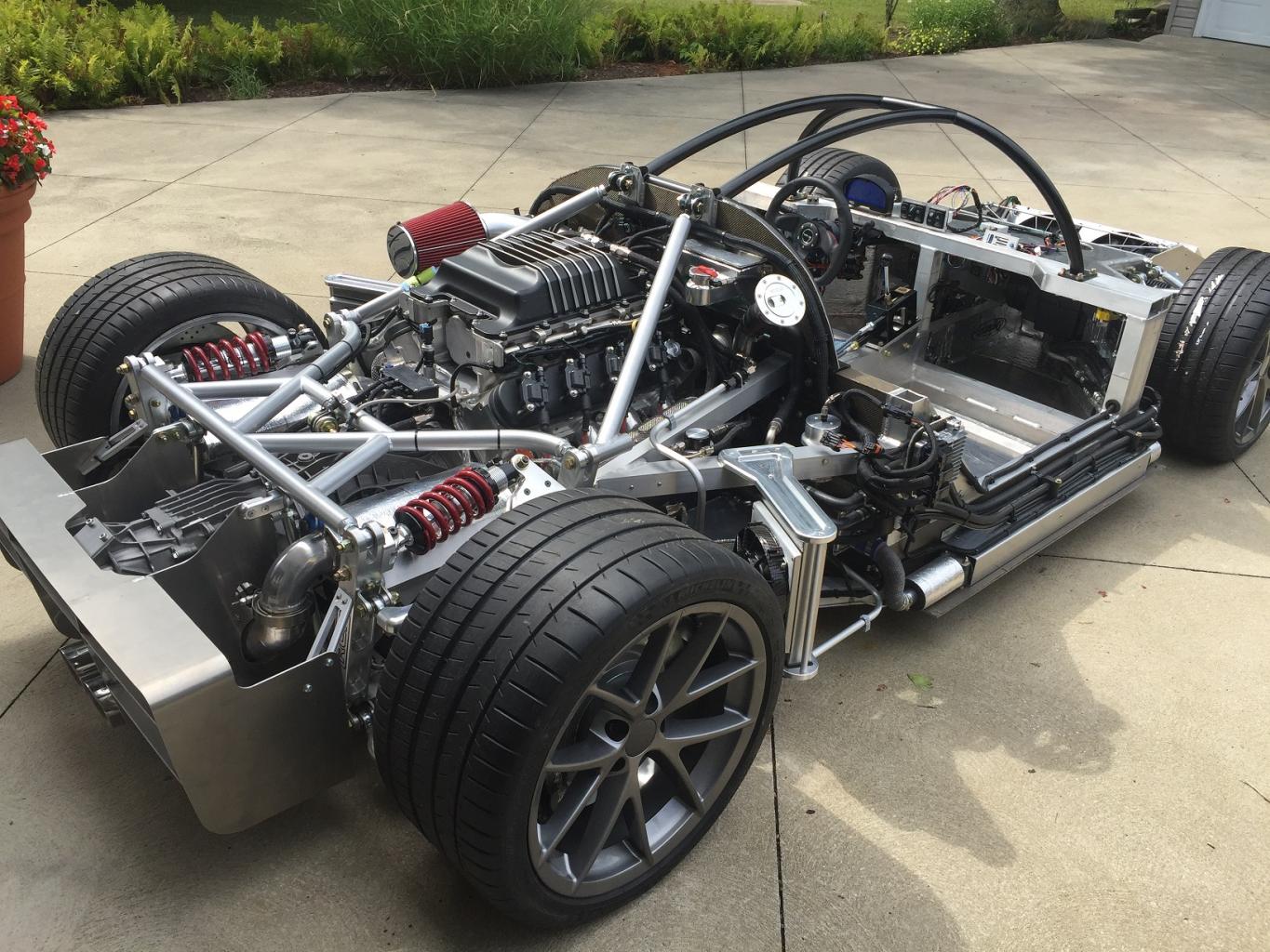

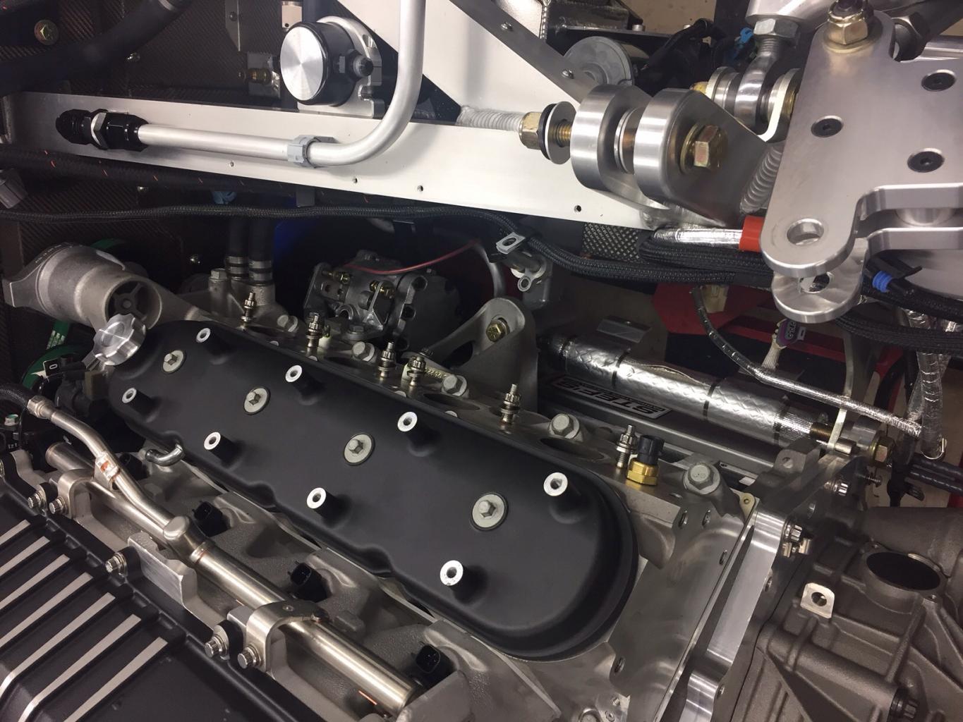

So this was last summer, hope to be BACK at this stage of the build soon !

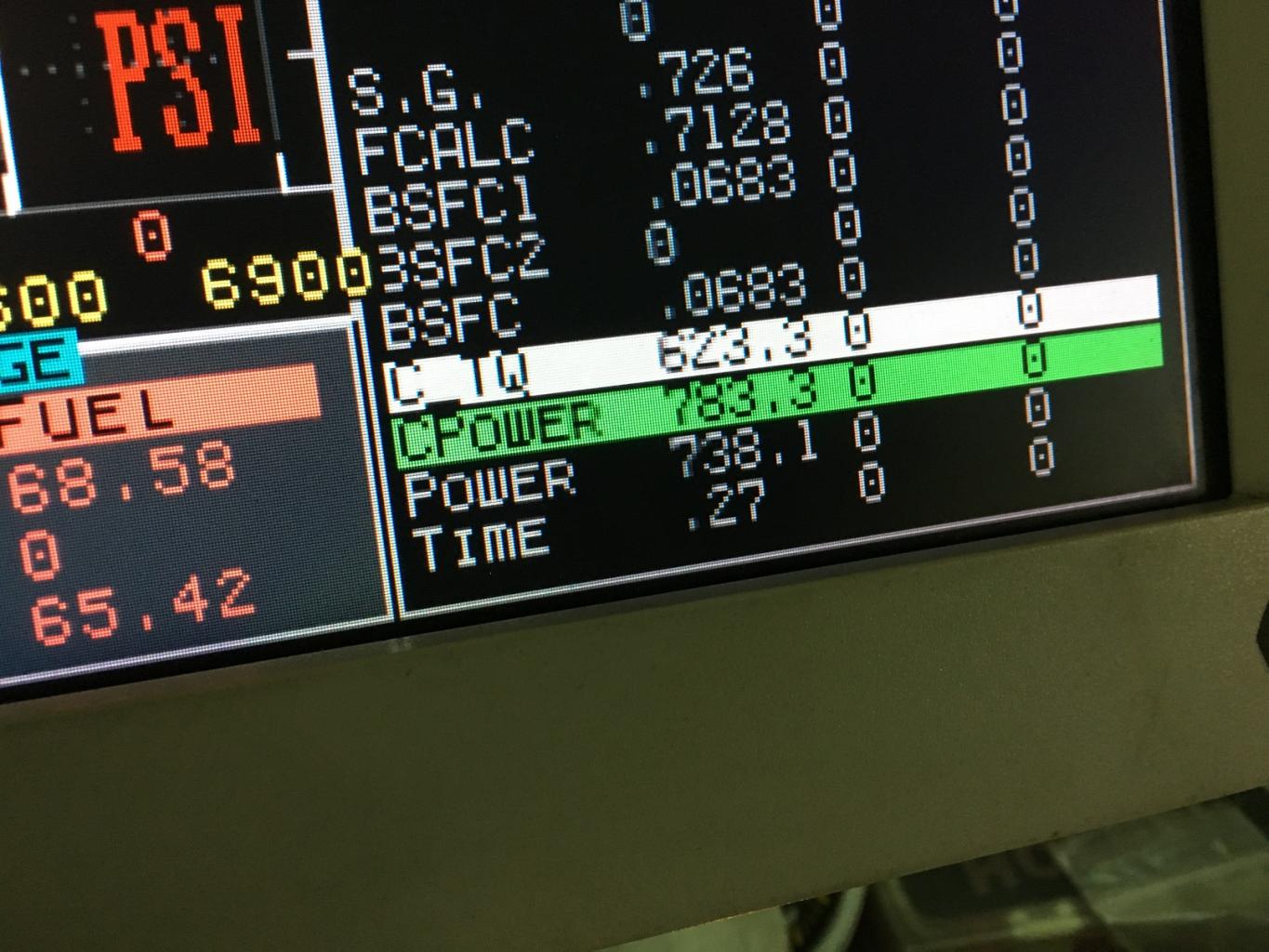

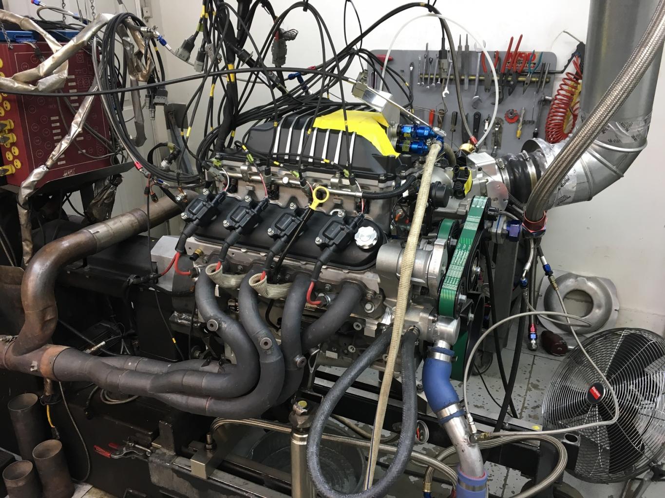

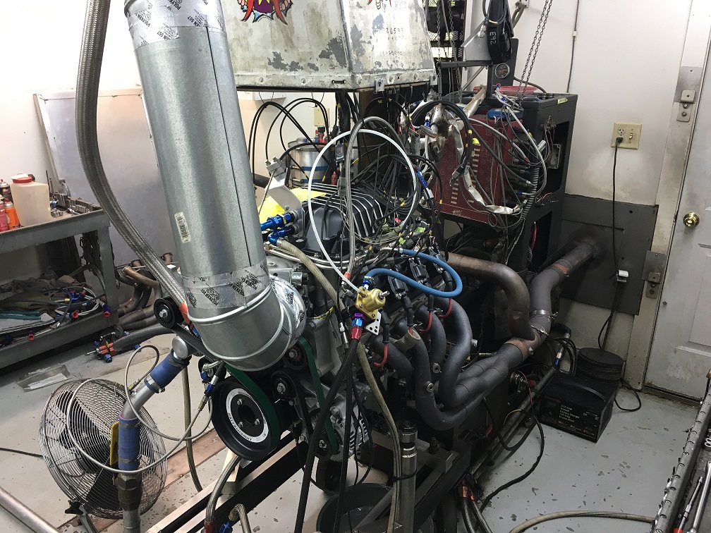

ok .... You can see from the number ... 783HP on a mild tune they said ...
NOW I will be looking at the axles, and clutch .... OOOppppss :stunned:
Guys at the dyno said as rings seat, and we do the final tune in the car ................
Yes ! 800 HP !! :thumbsup:
I have no excuse for my decisions I told my wife ... LOL :stupid:
Nice chassis build up to this point, some cool brackets and bits in there.

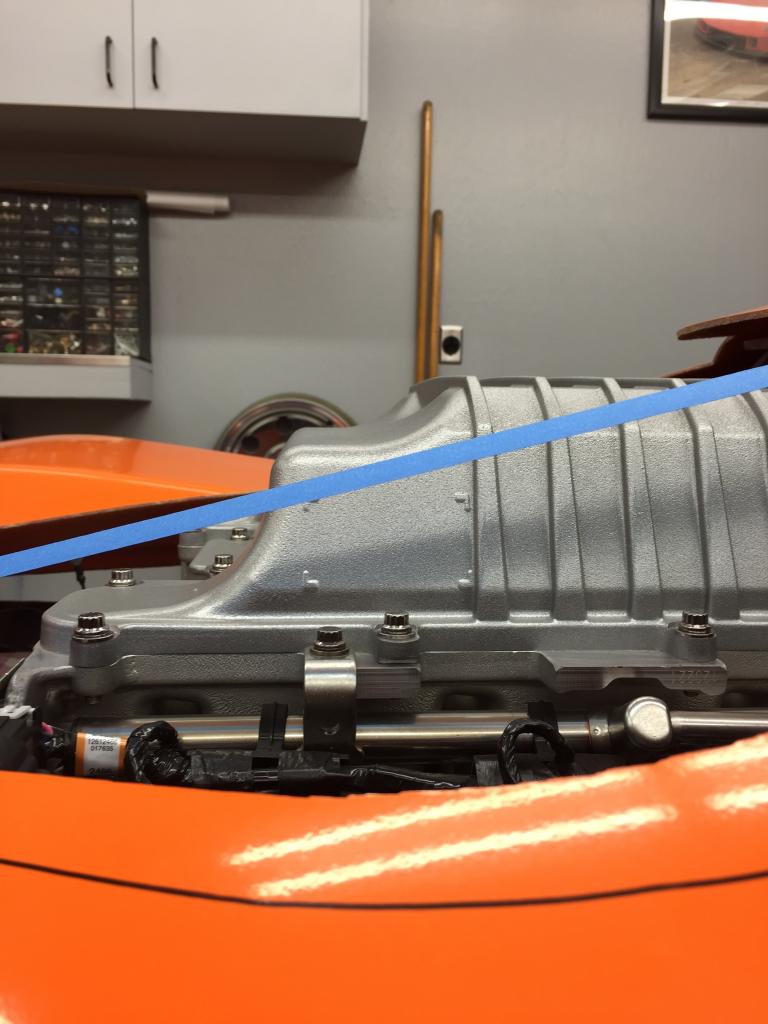

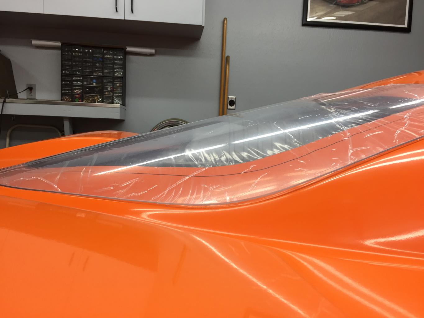

Does the blower fit under the back glass? (sorry if you answered this earlier)
