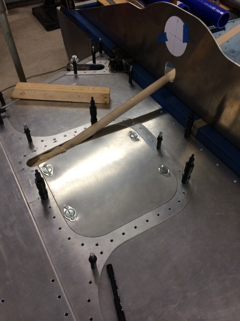

Hi Guys, here are some pictures of my latest work. I'm having a lot of trouble with resizing pictures. I'll keep trying.

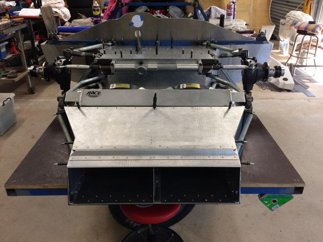

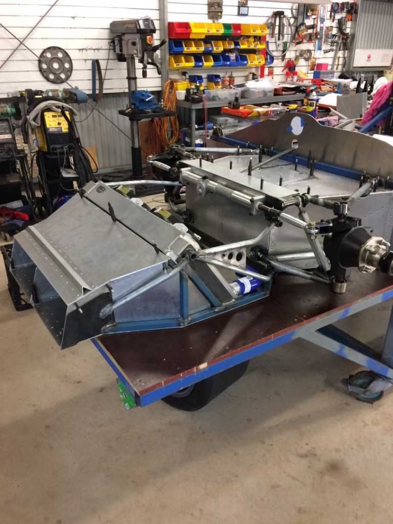

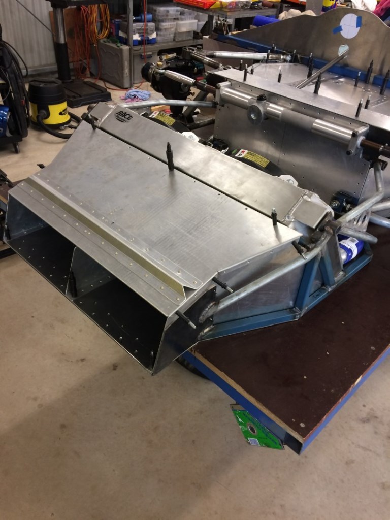

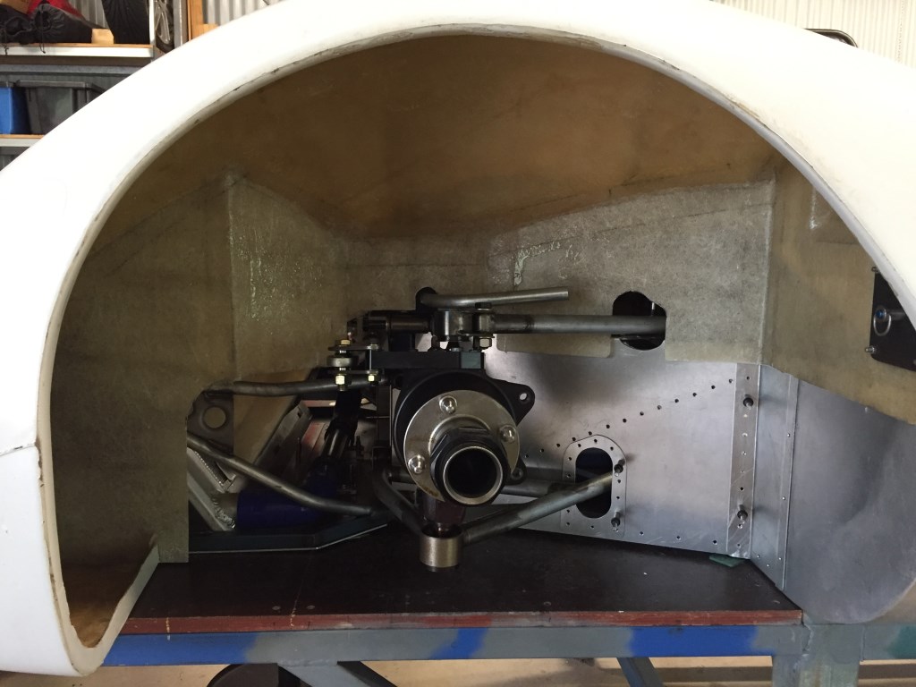

Thanks Randy, But my mate Clayton has come to the rescue again and resized them for me, don't know what I did wrong, but it seems to be working. These are pictures of the front end I have done a bit more on.

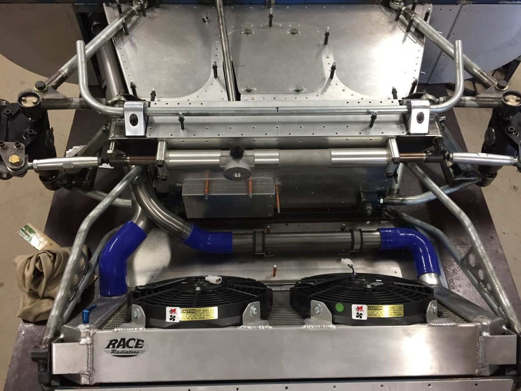

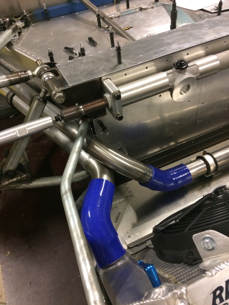

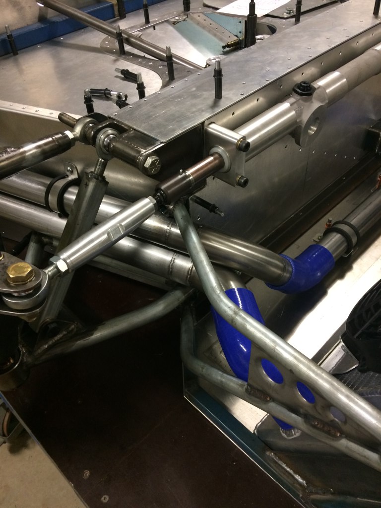

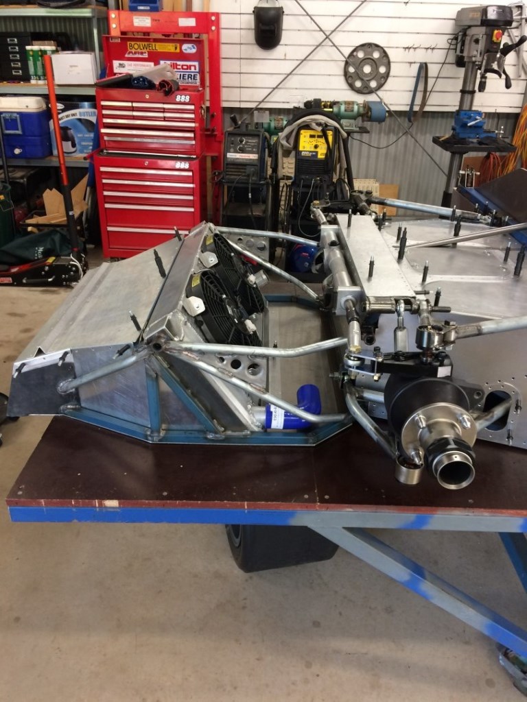

Here are some of the lines to and from the radiator. I've used 2" for the suction and 1 3/4" for the return to the radiator. Now I have to make up a swirl pot ( de aerator ) and header/ fill tank. Getting there slowly.

Awesome work mate. any guesses as to what it will weigh when finished, this is a track car right. I see fans and have to ask now I'm thinking I have asked this before. I turned 59 the other day and think the Alzheimer's is setting in. Cheers Leon

Hi Leon, yes you did ask before, but don't worry out of 8 hours working in the shed, I'll spent 7 walking in circles looking for something I just put down a second ago. Now I can't remember what I was going to say. Oh yeah, that's right, the fans are there as a precaution, it gets very hot here in the Territory. It definitely won't be a road car.

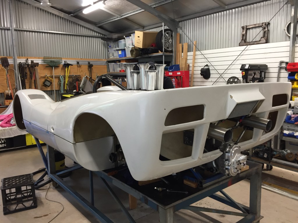

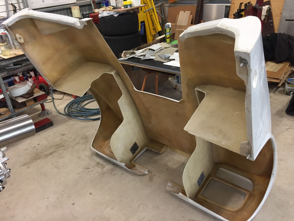

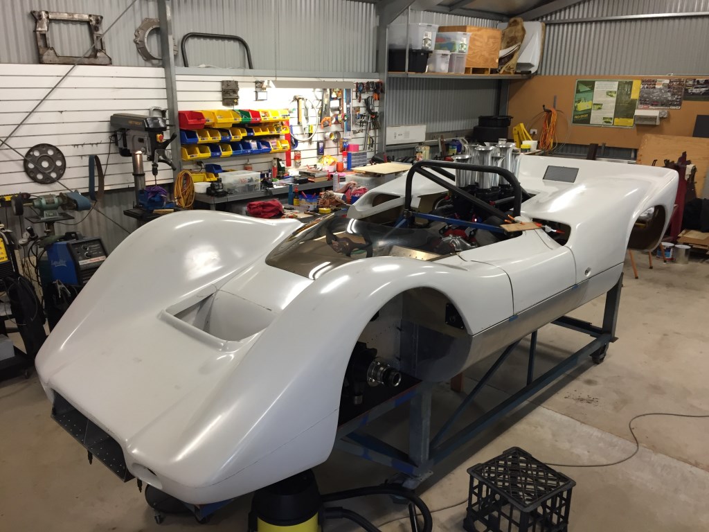

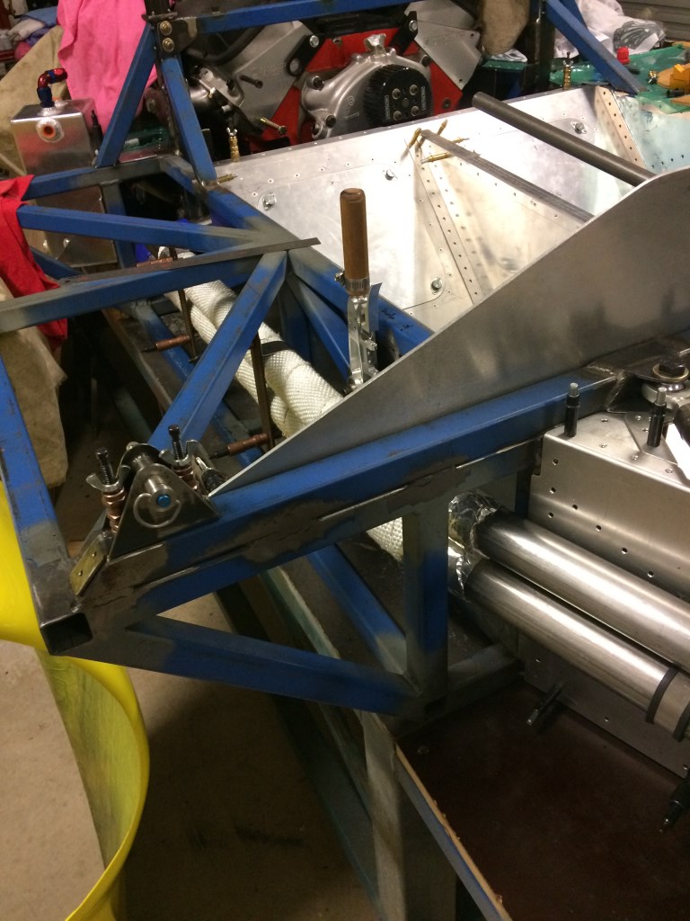

Udo's been chipping away with the body work and we all know how painful that is, especially in the tropics...

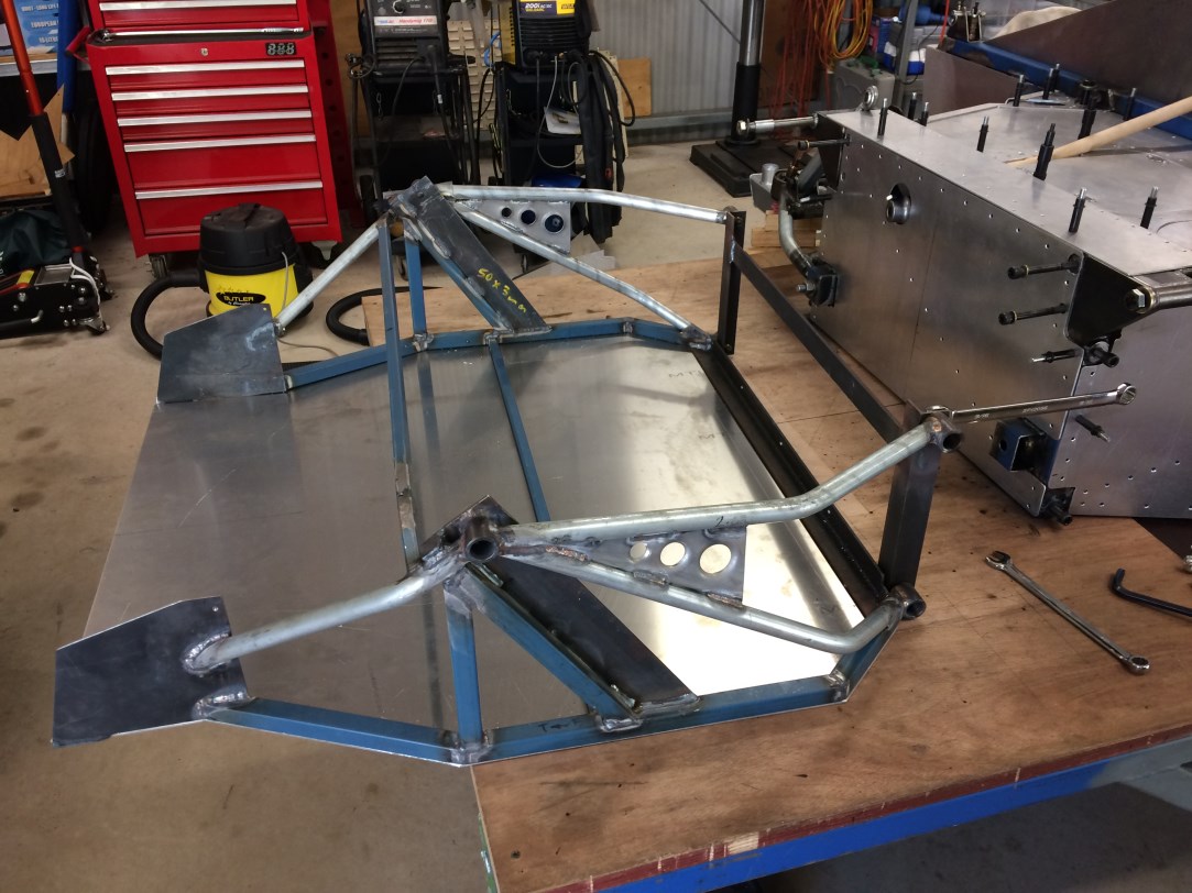

Inner guards just about done, front and rear clip mounts done. Heaps of work on the seat (no pics) and lots of other small jobs on the go.
