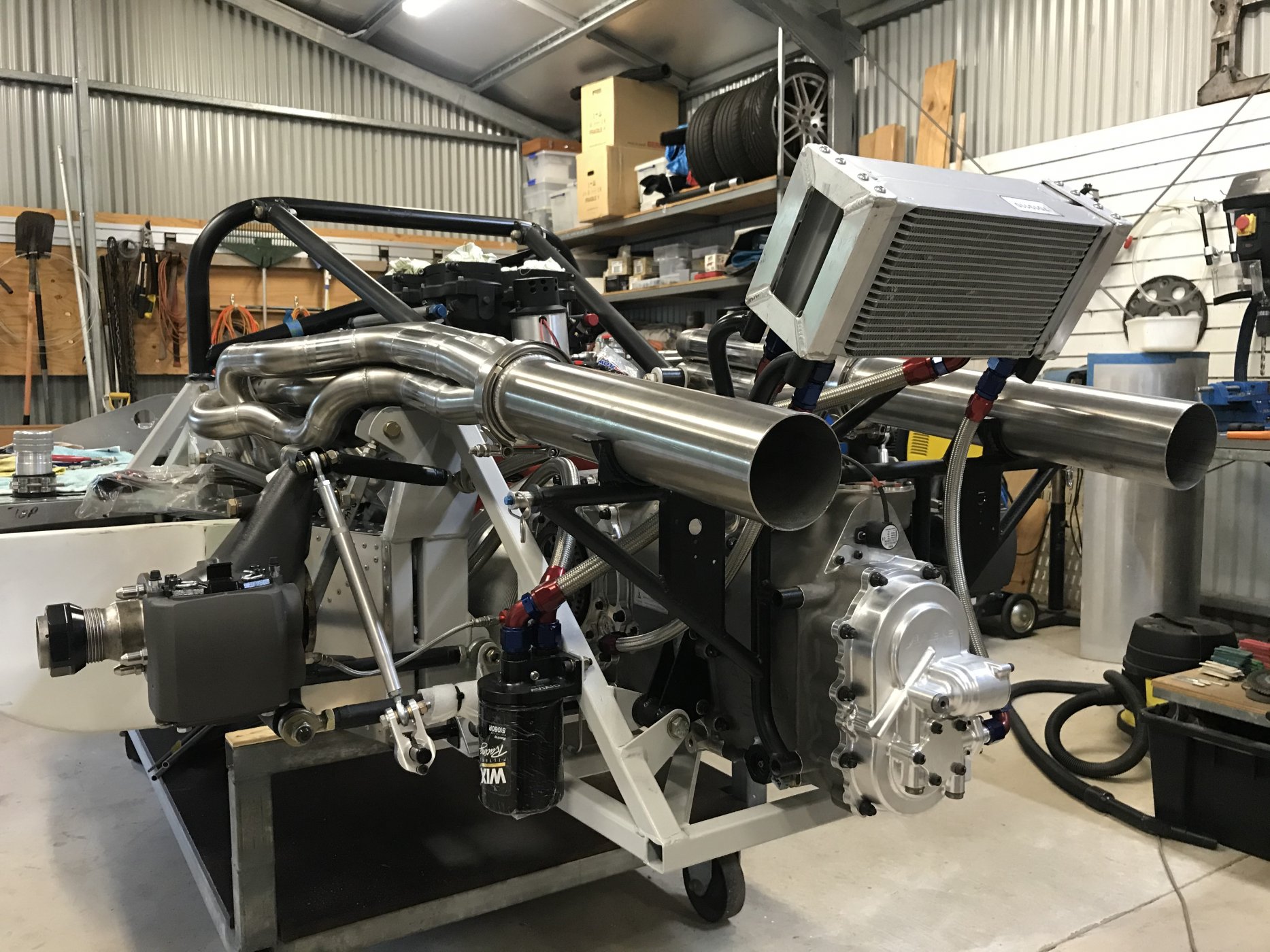

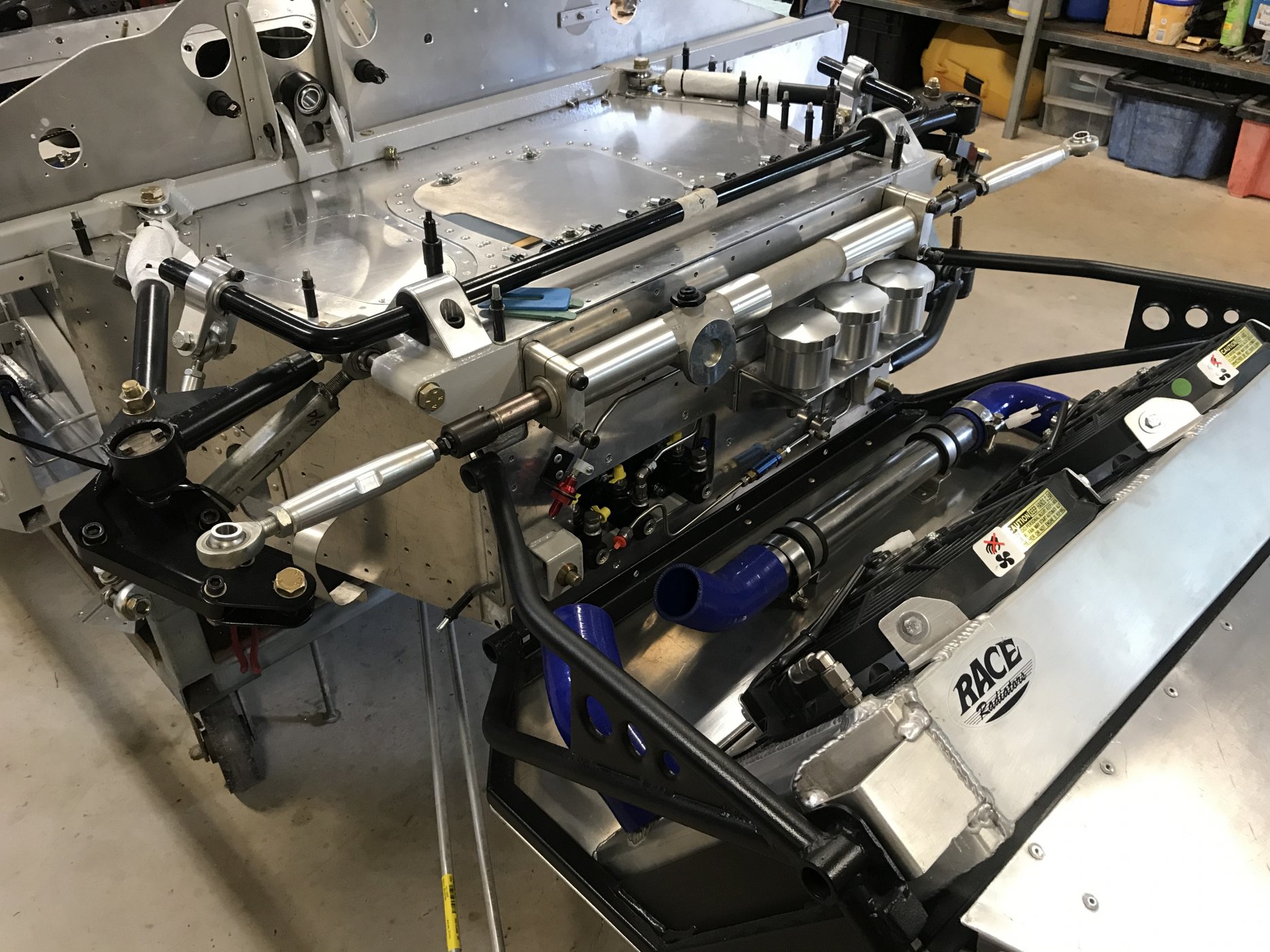

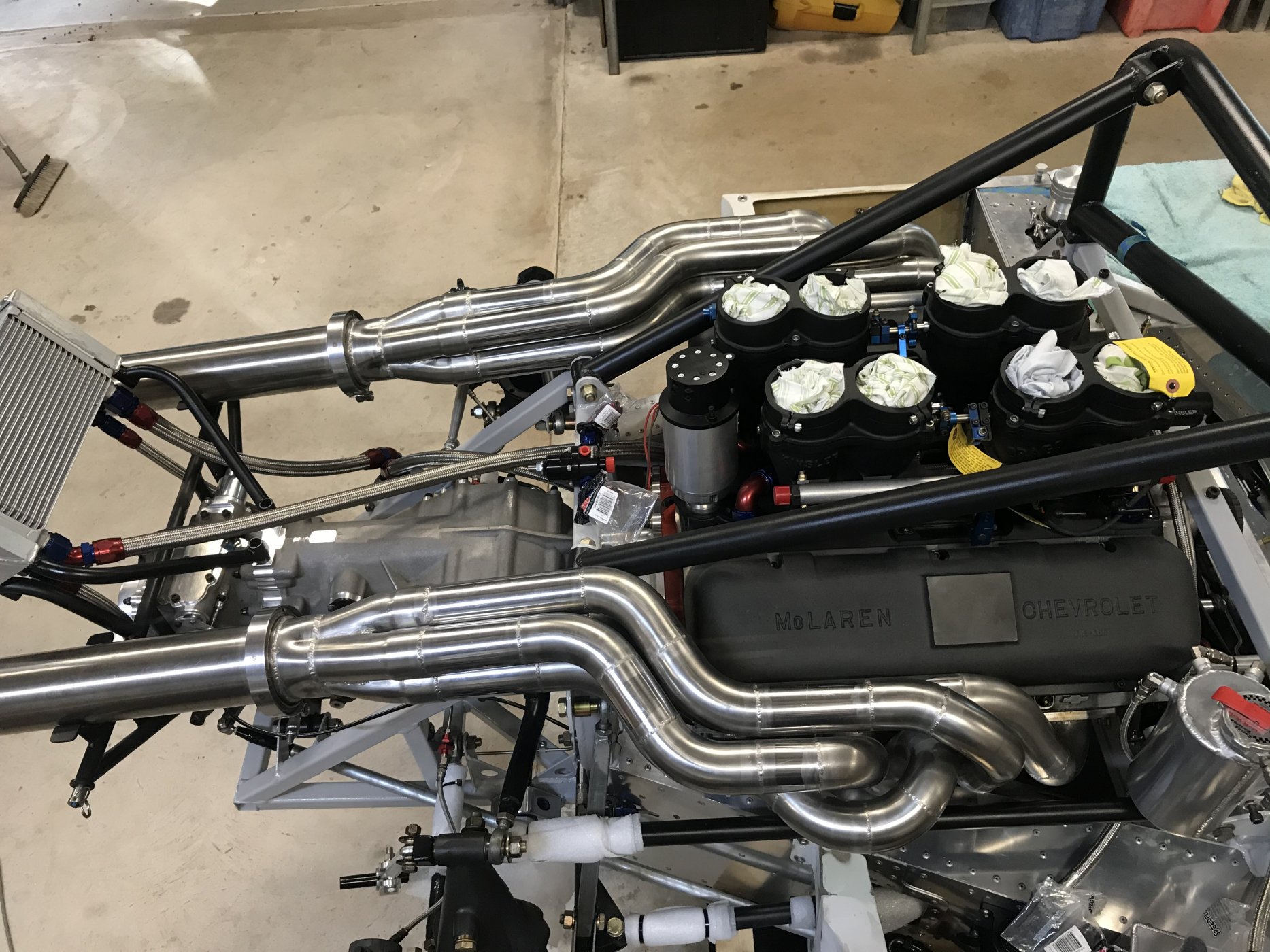

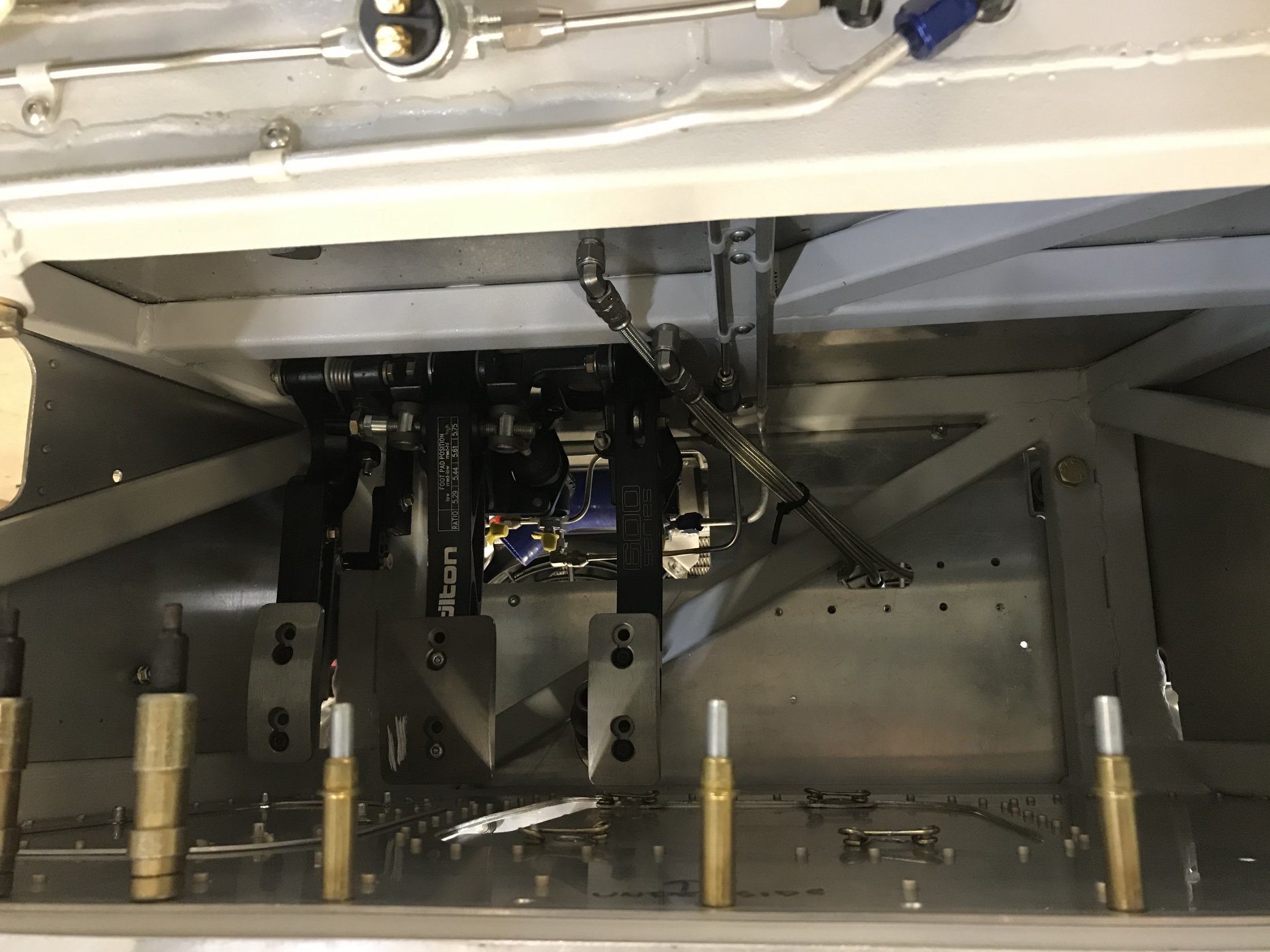

Saw Udo this afternoon and took a few pictures of his progress.
He has been very busy with work and it’s not moving along a quickly as he would like.
Clayton
Absolute excellent work as usual !!!!
And also some very very nice components !!! look at those AP calipers .... wohoooooouuuuuuuuu ( I know the cost but they are so good -say hard pedal brake!!......)
Lot of work done since last pics !!! desassembling and coating every thing it's lot amount of hours ......:)
I do like also those Maclaren cam covers !!!! ( @ Clayton ; do you know who supply those ?)
Congratulations to Udo
And Thanks Clayton for those pics and news ( Beside they just make me more in love to start quite similar project !! ouuuuuuuch !:rolleyes:

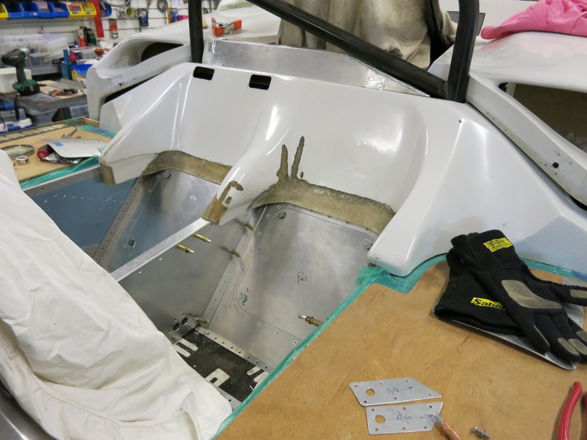

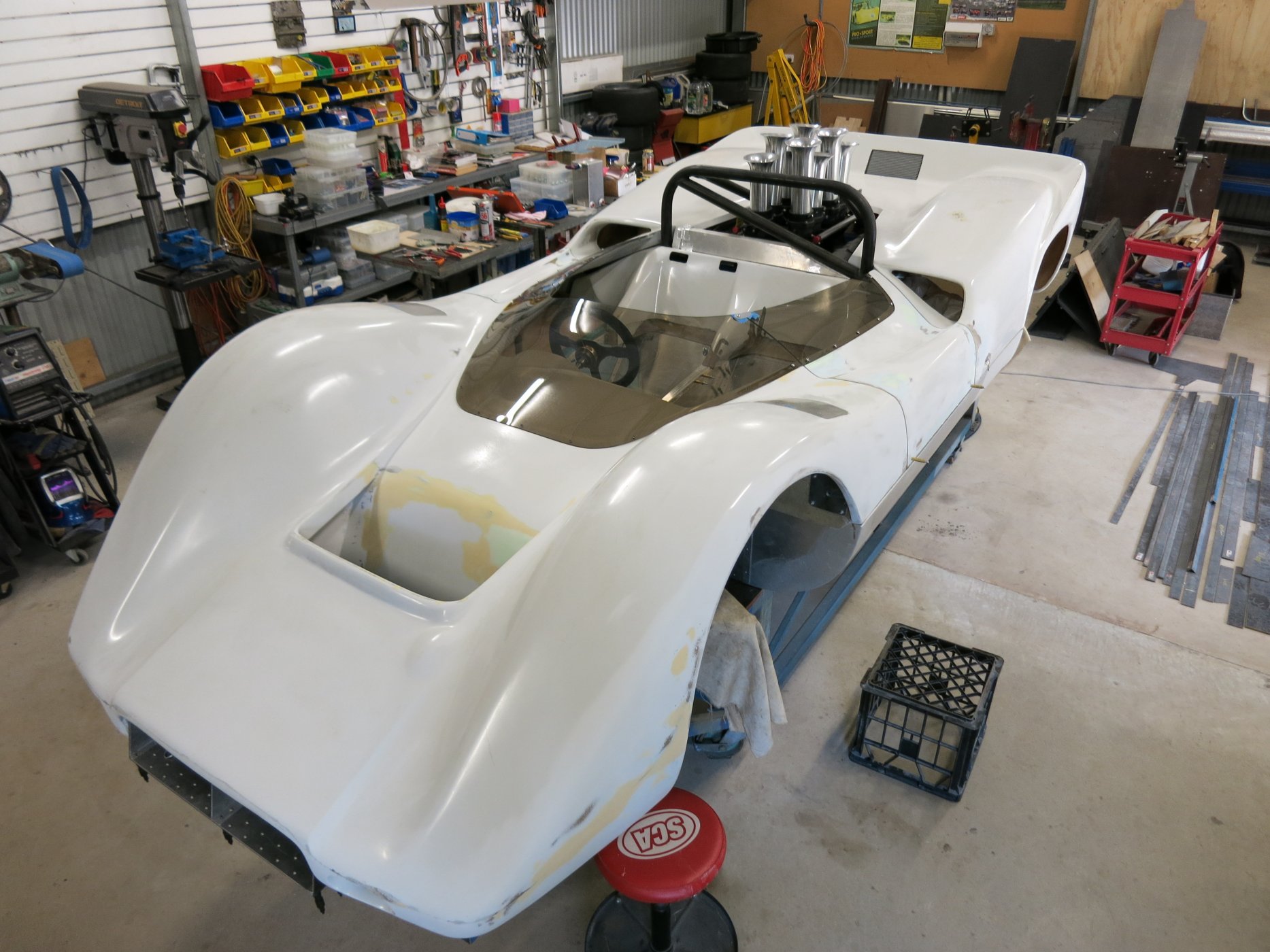

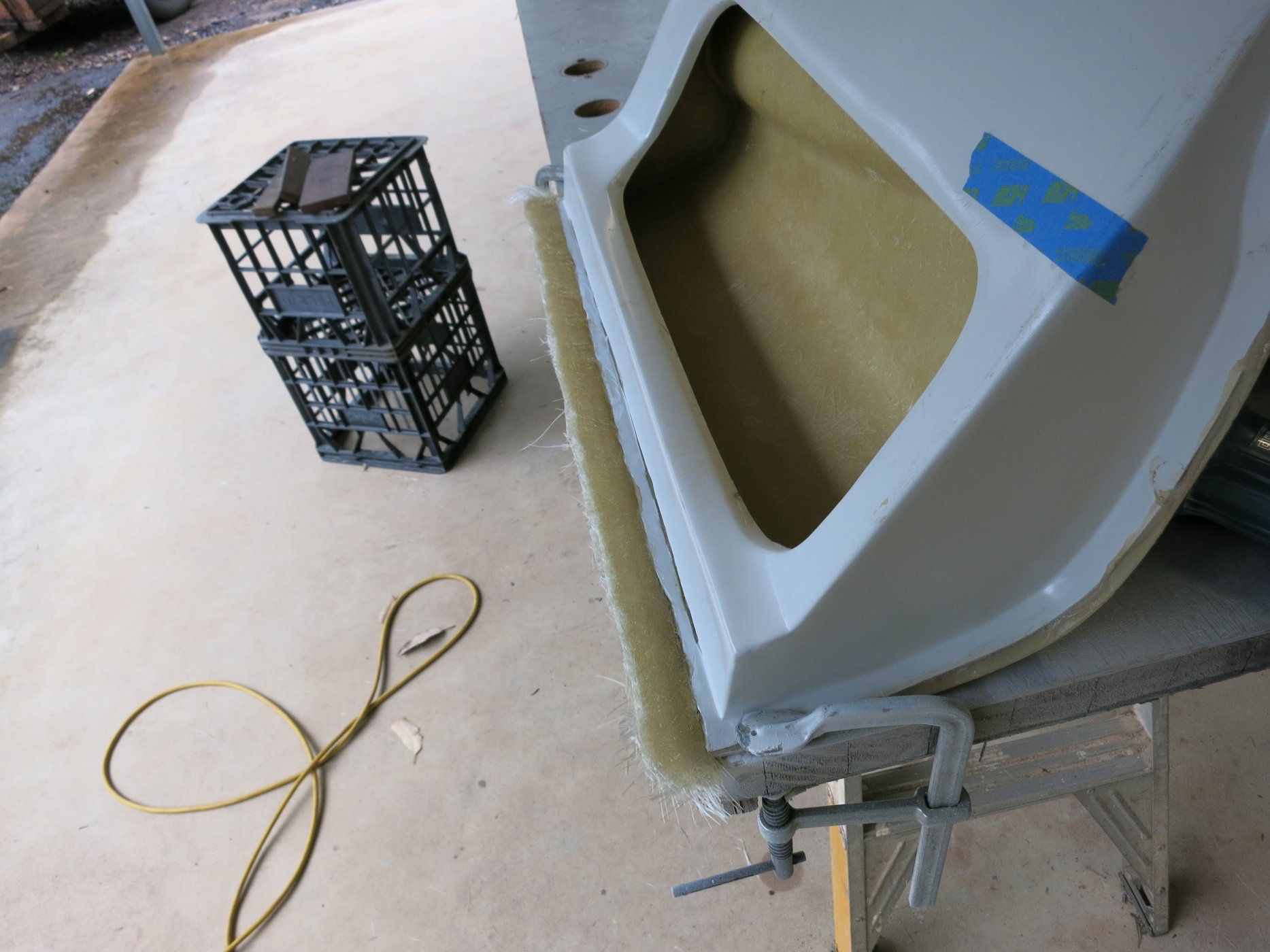

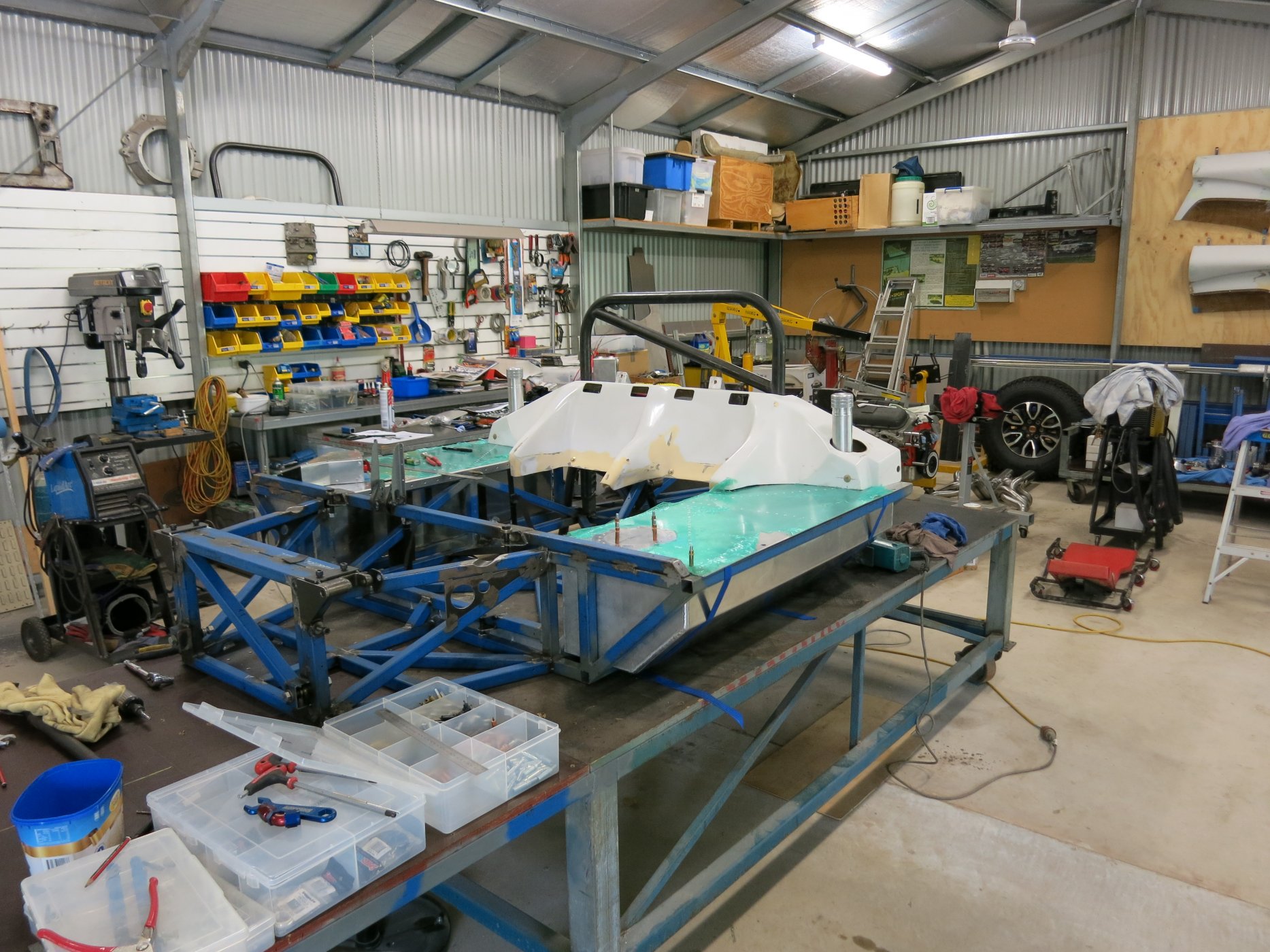

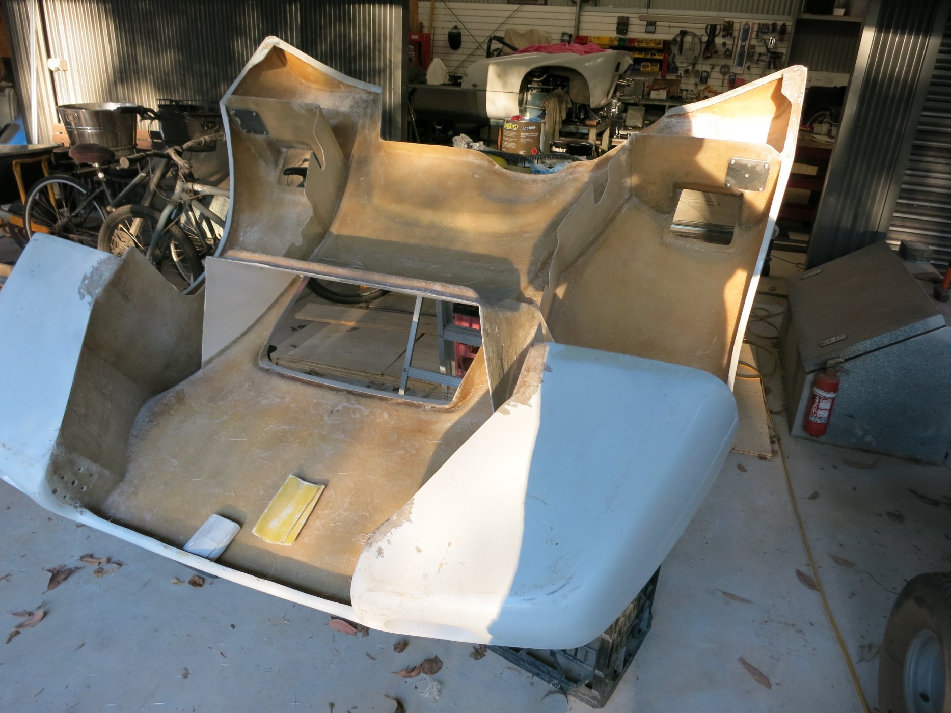

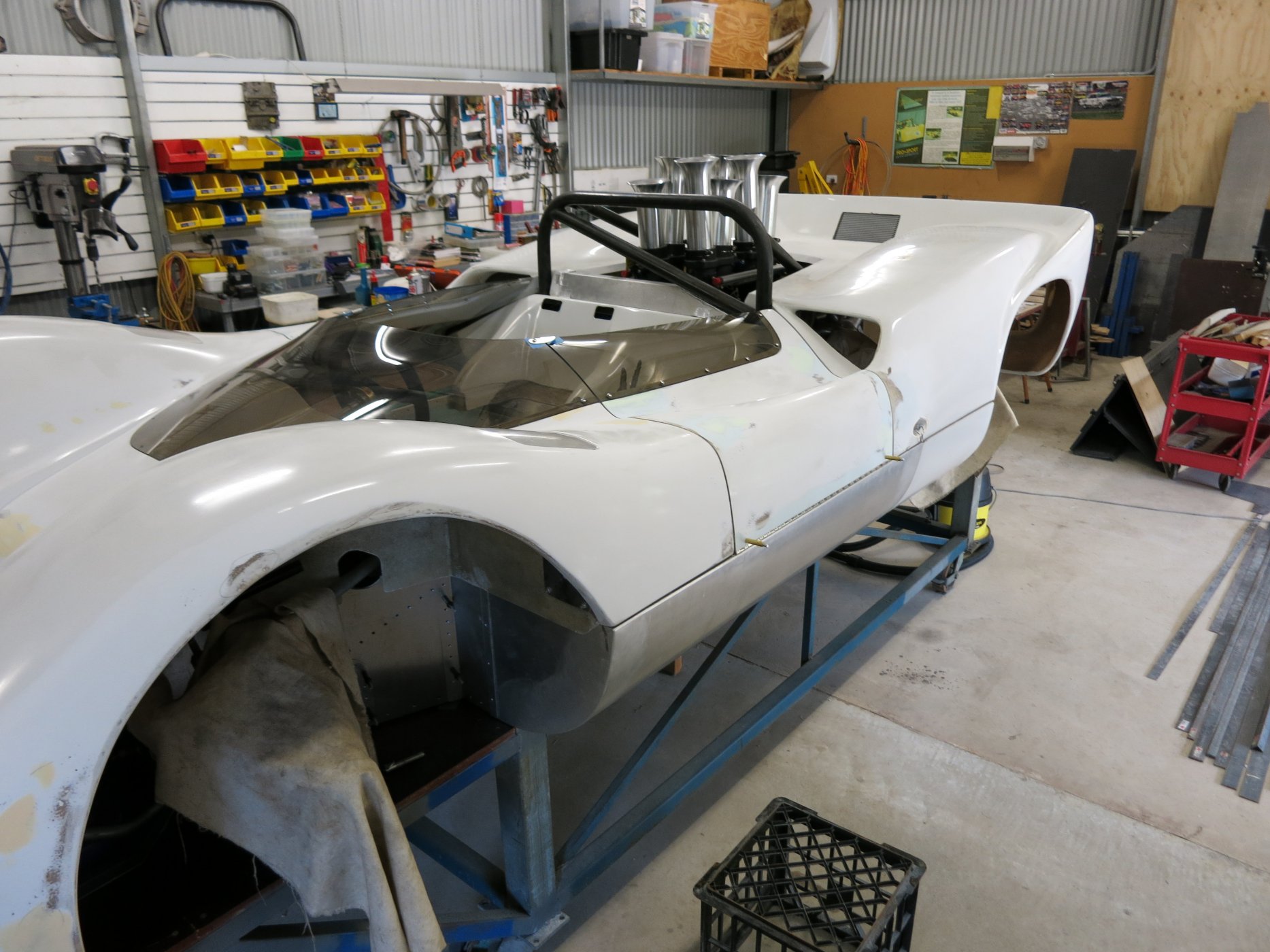

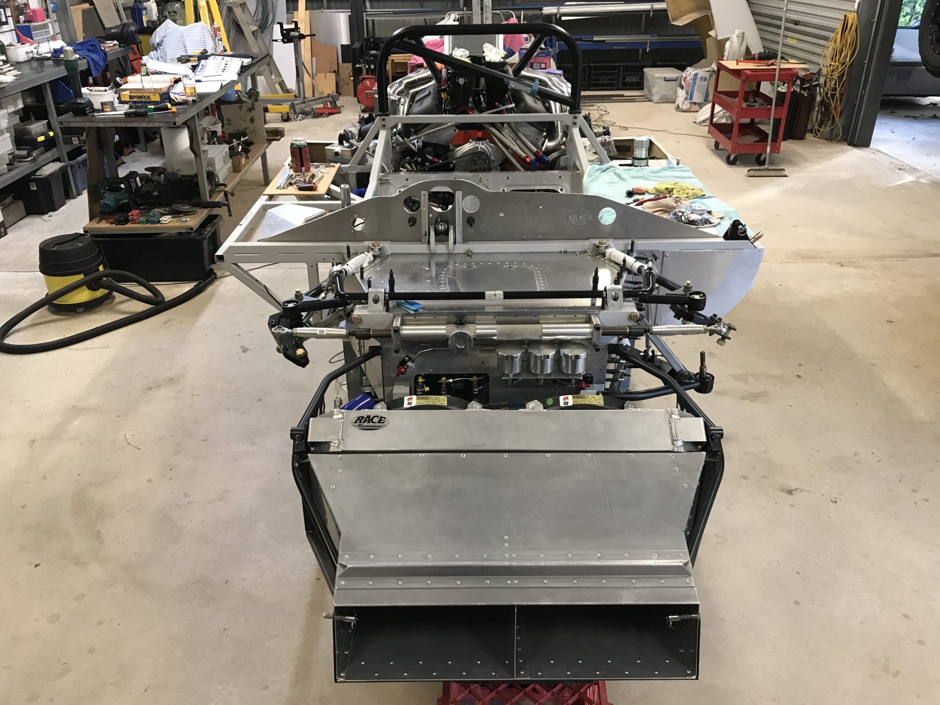

I sort of left off when I was trying to sort out the fibreglass panels and get things to fit and stay in place.

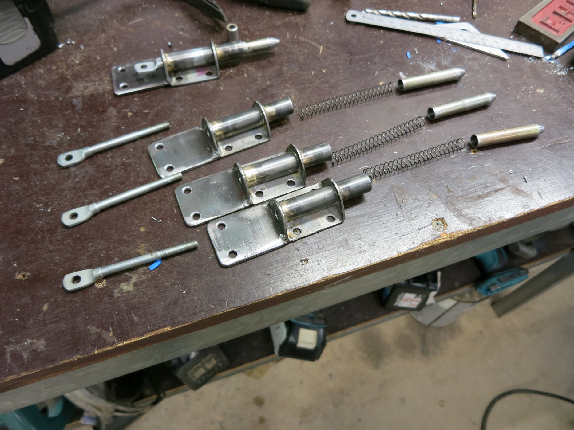

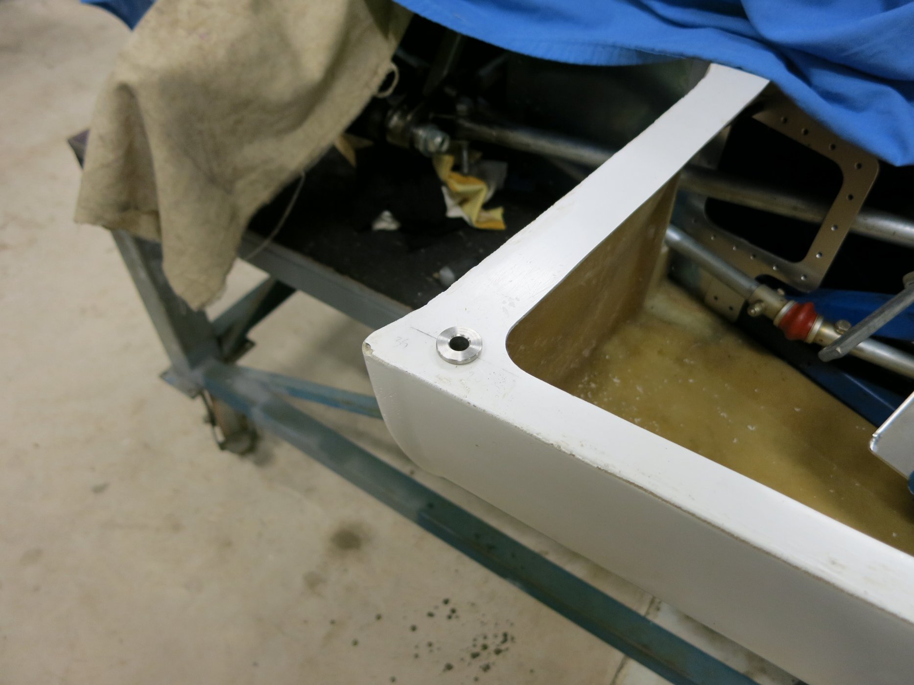

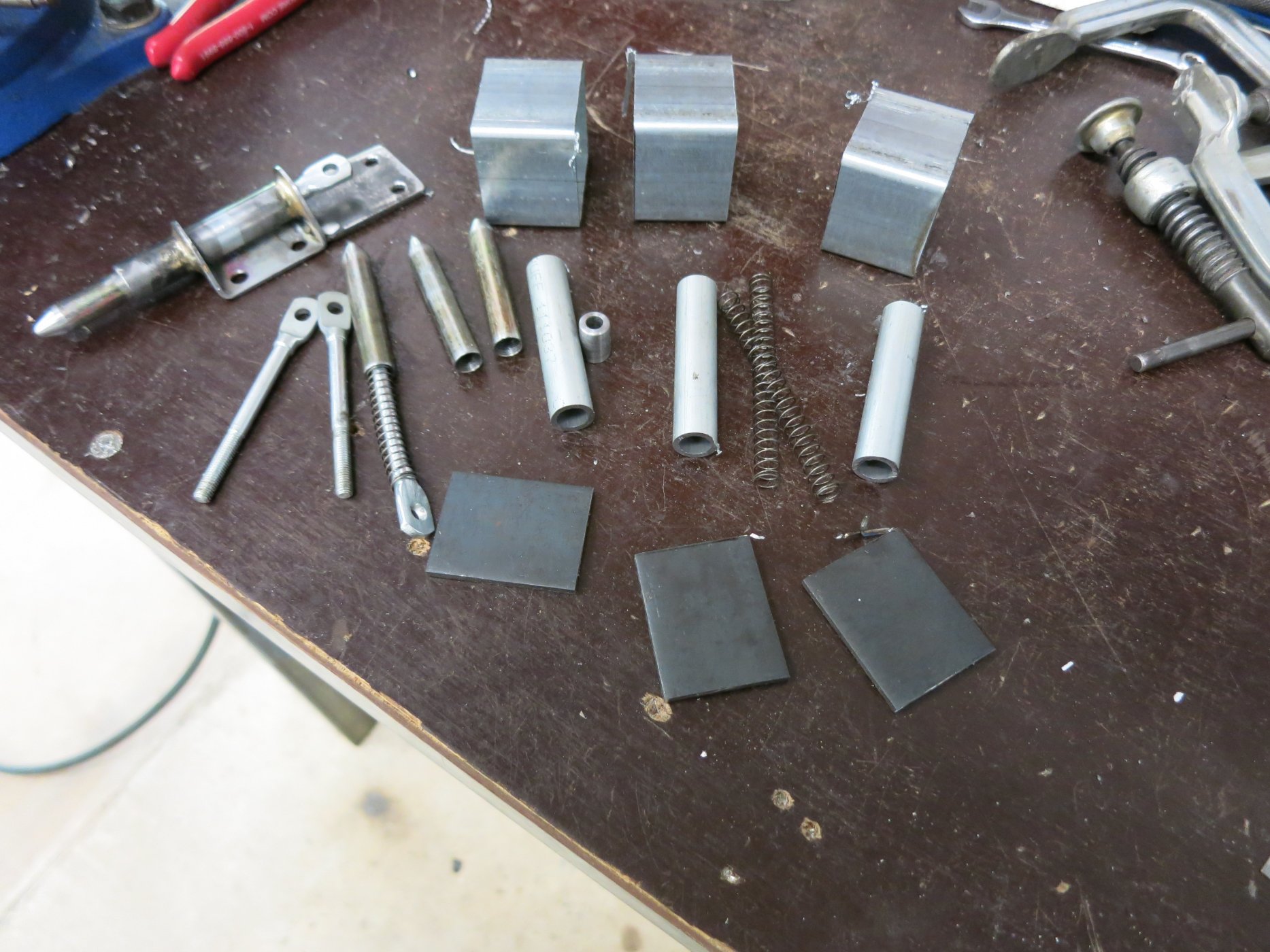

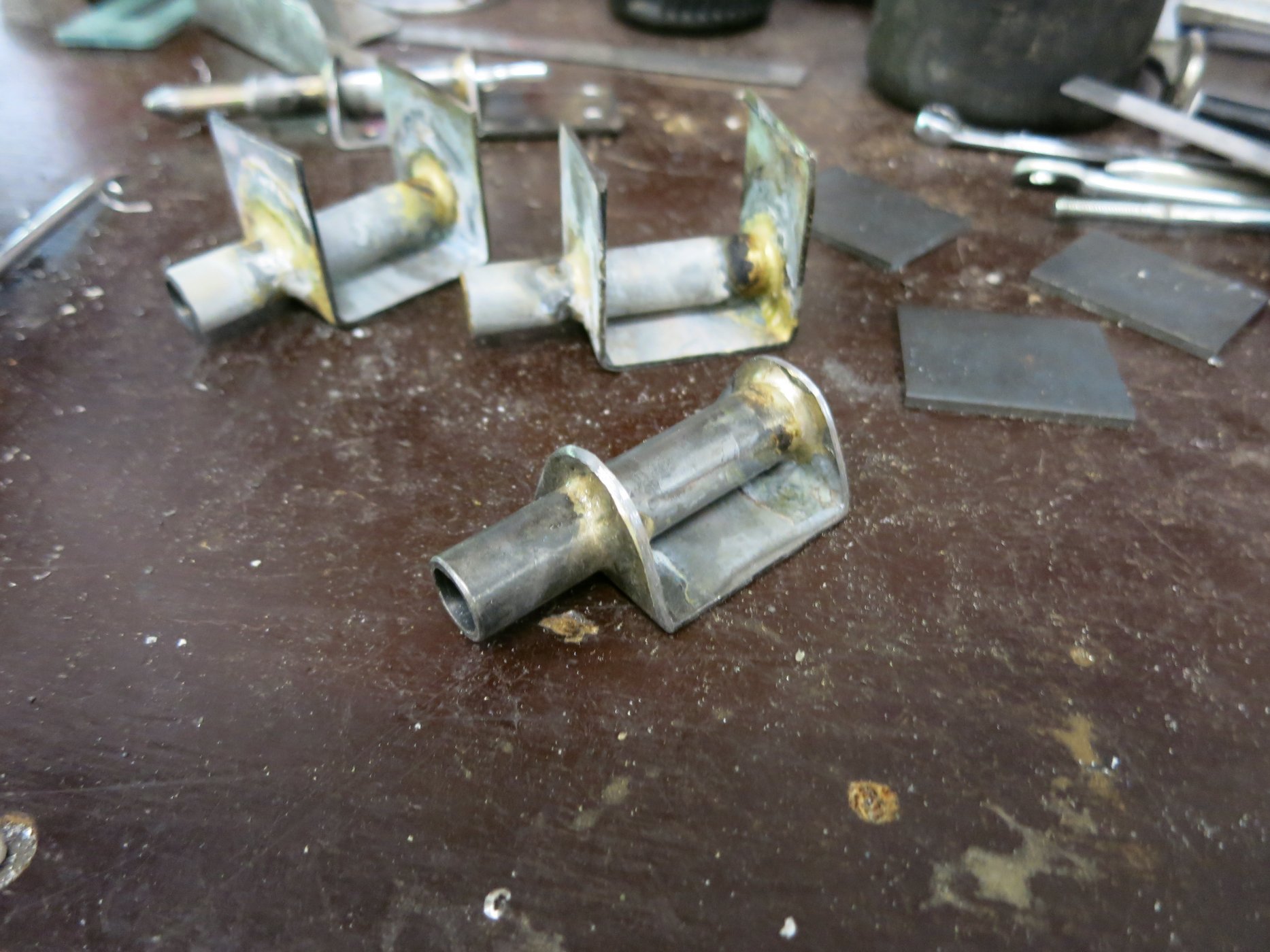

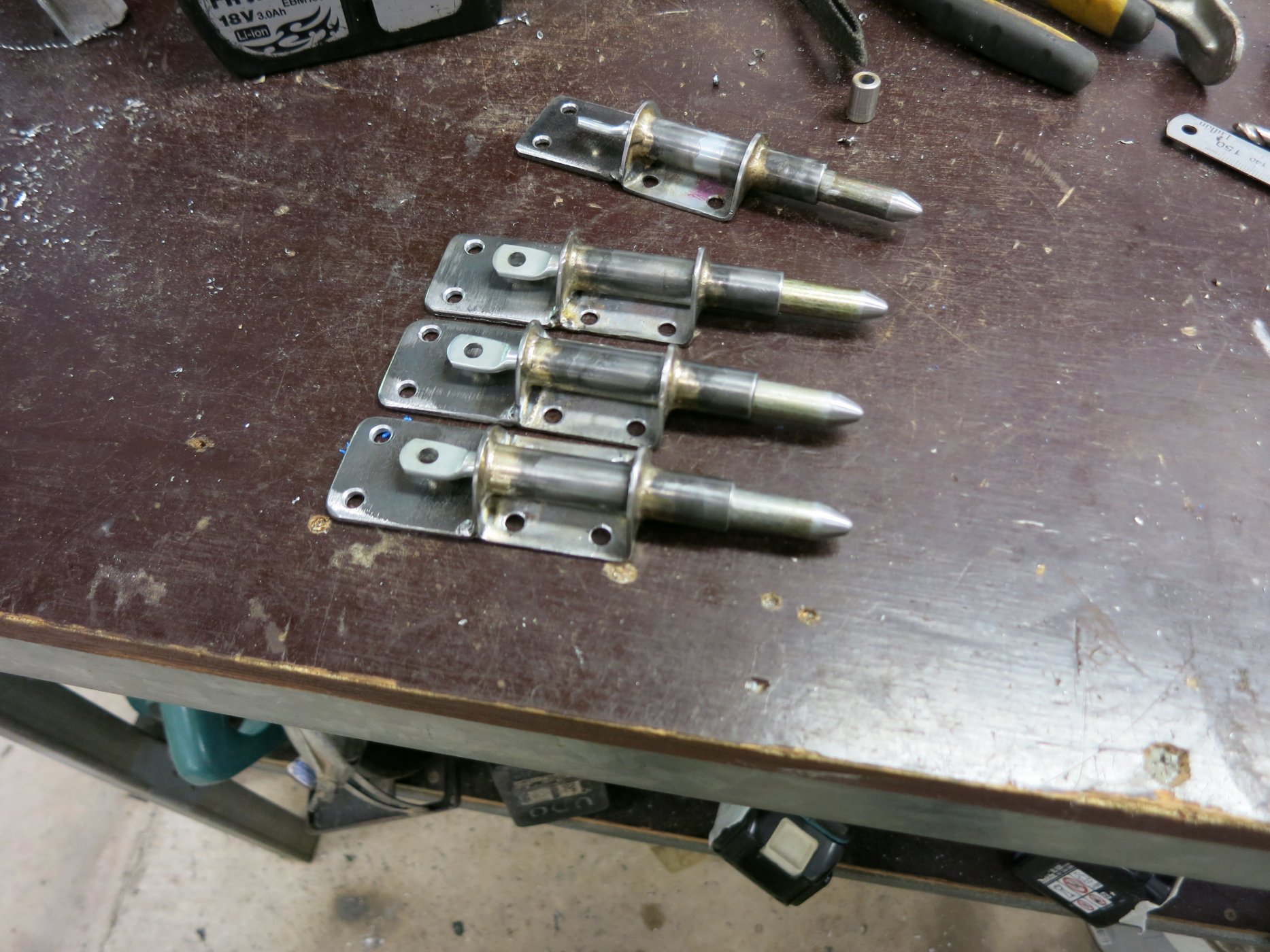

Clayton machined these locating guides out of some half inch stainless bolts and I made some pins that bolt to the body panel and they hold the body work in position firmly with nice even gaps. I also made up some door strikers that go on the front and back of the doors. You can tell Clayton made the bullets that the springs sit in. You pull on a cable in the centre and the doors flop open. Yell out if this is getting too detailed and boring and I'll skip a few pictures I've got on the camera.

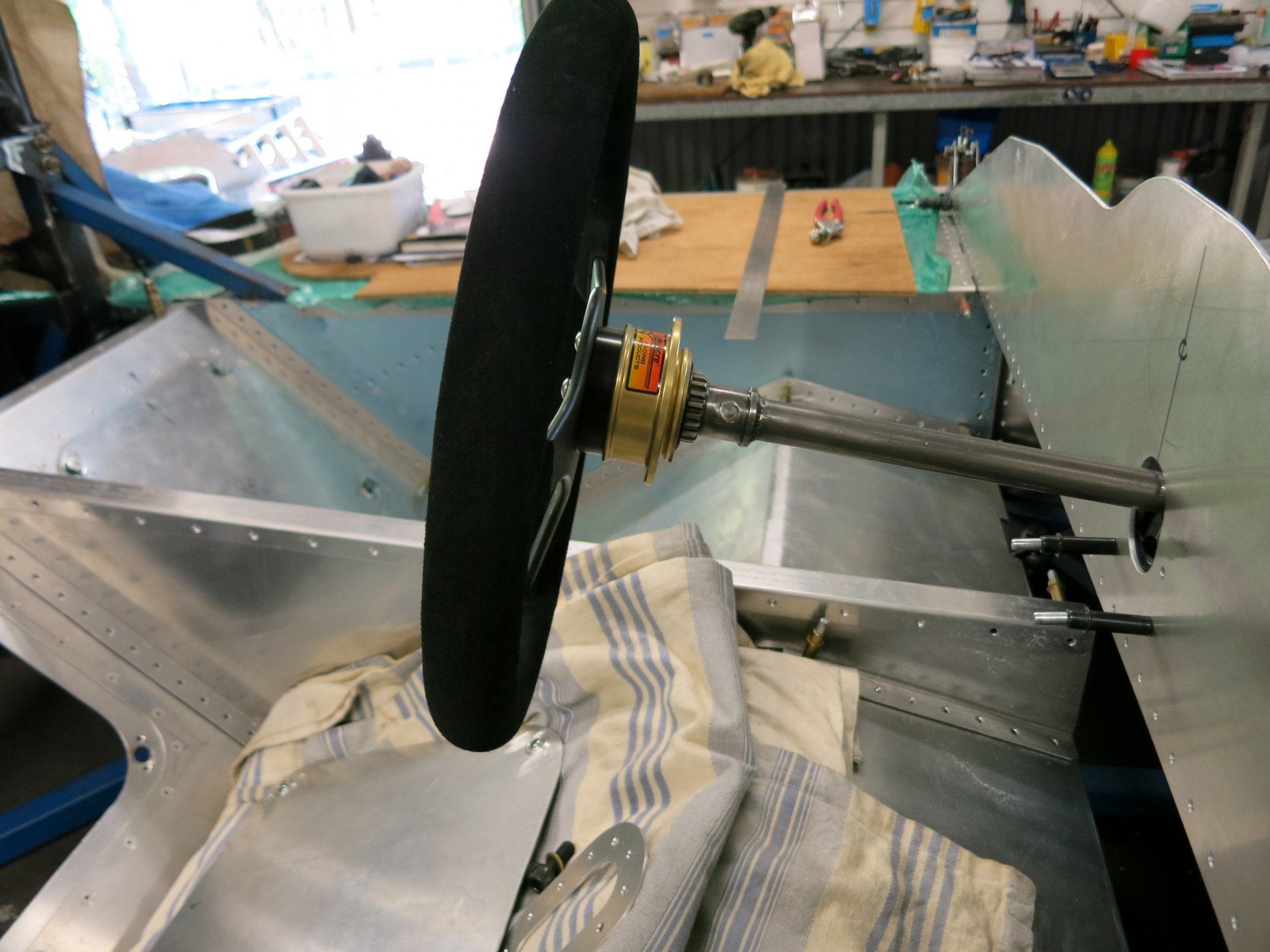

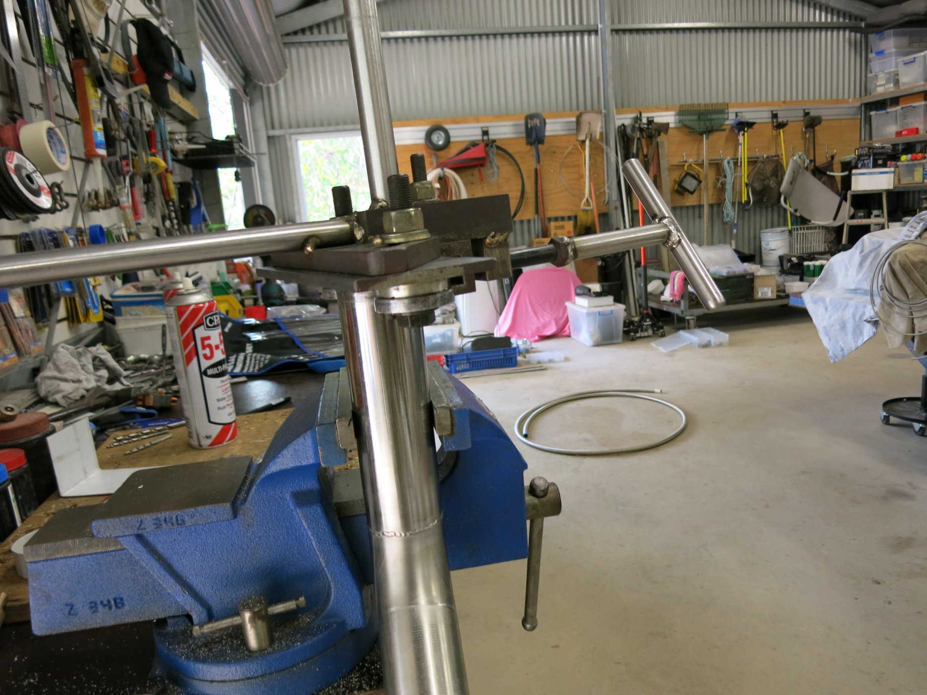

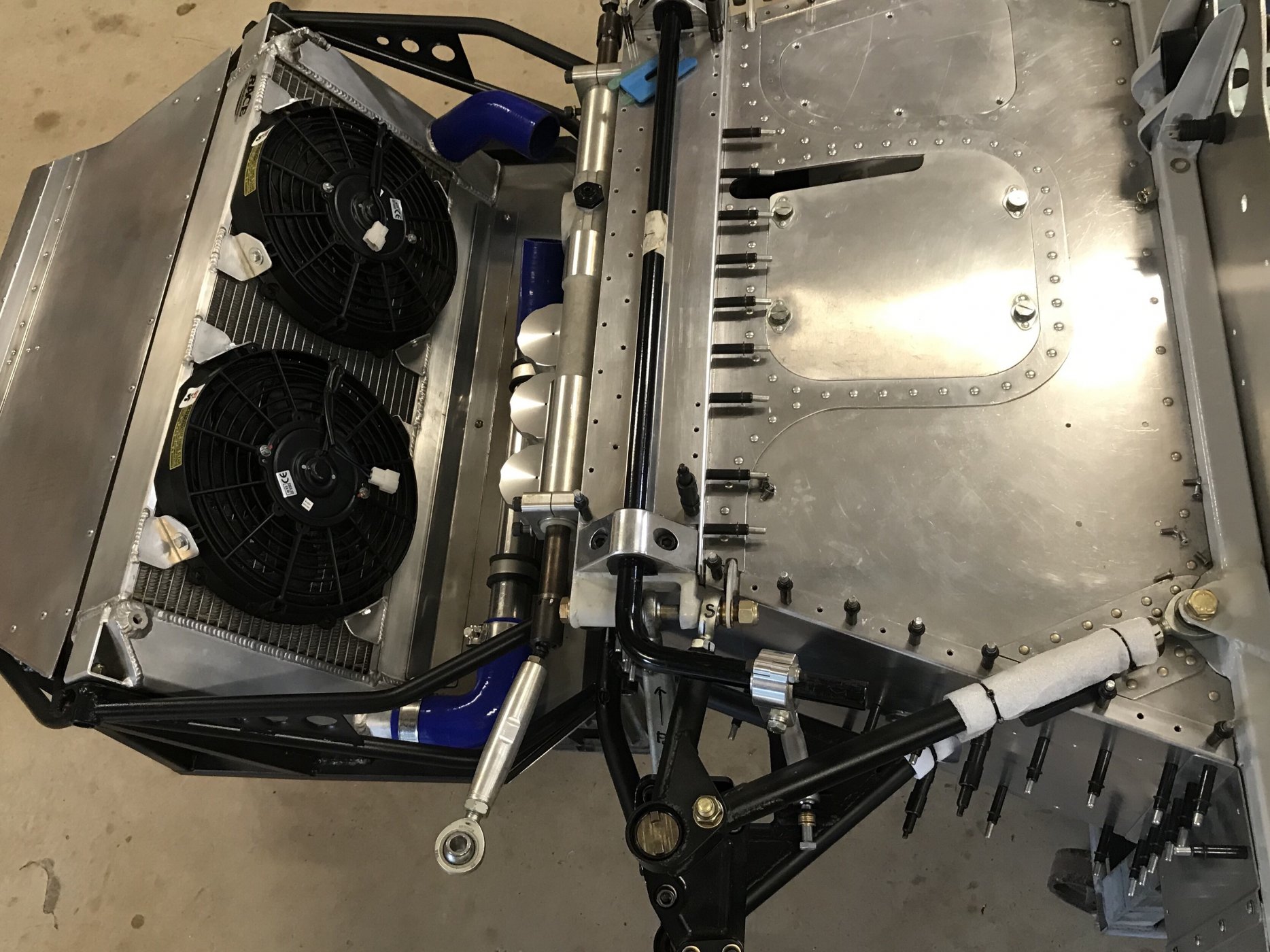

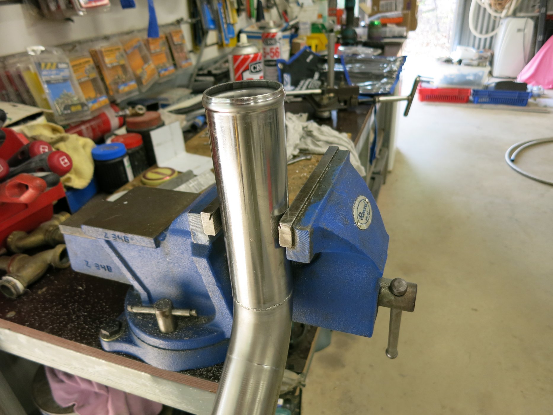

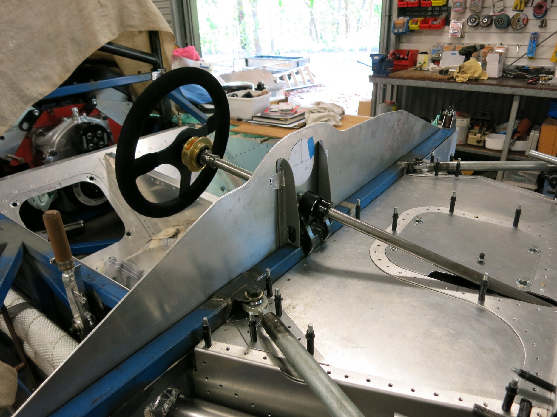

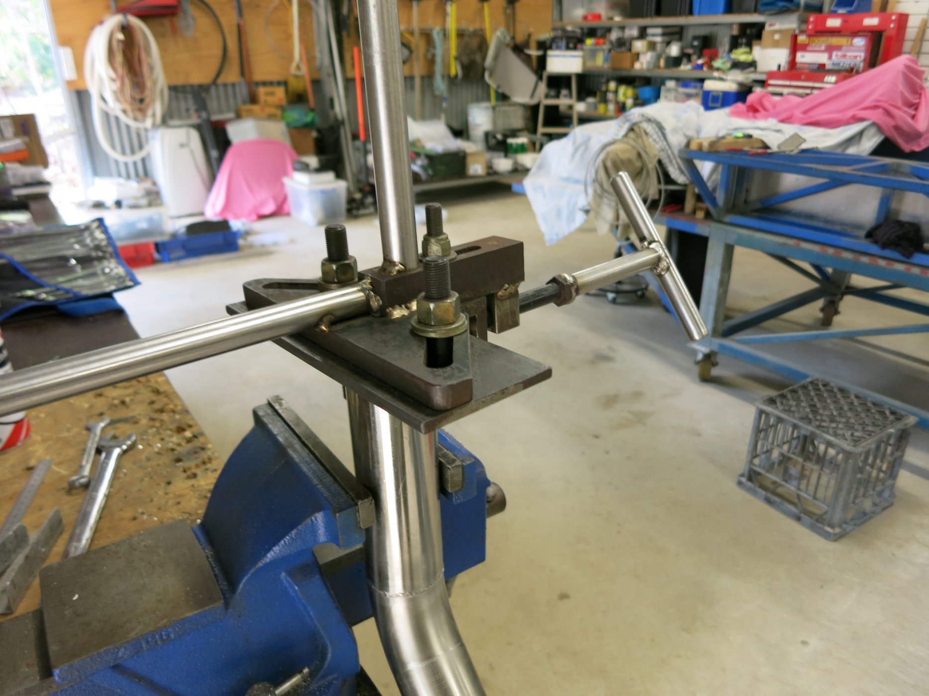

Back again. Here's some pictures of when I made the water pipes up from engine to the radiator. I used a tricky tool that my mate Clayton and his Dad made. I call it a Crox tool, because being a plumber we used one to crox the ends of copper tubes before all these new fancy crimping tools and Pex pipe came out. It makes a nice bead on the end that stops the hose from popping off. I've also added a couple of shots of the steering shaft and dash bracket.

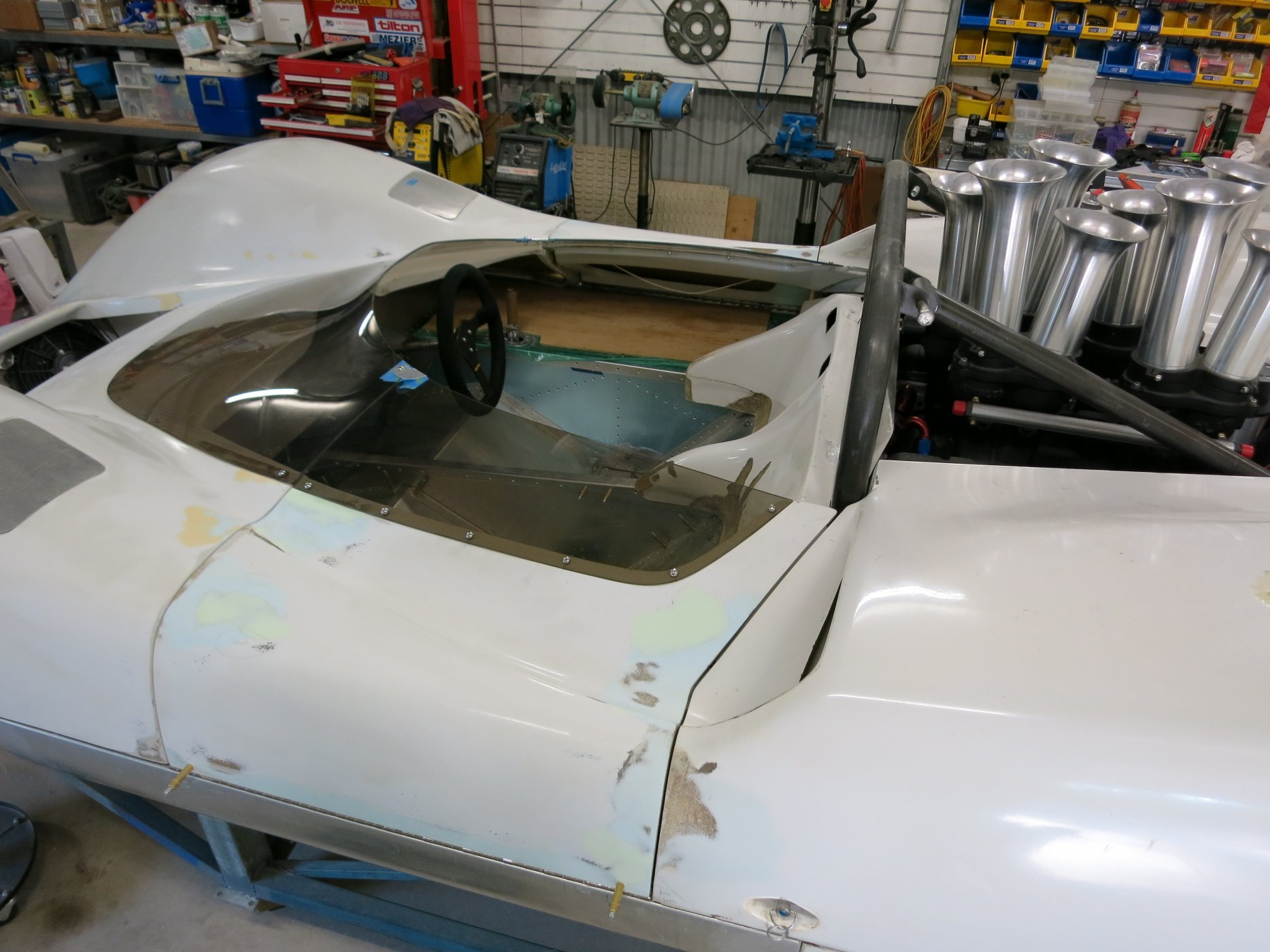

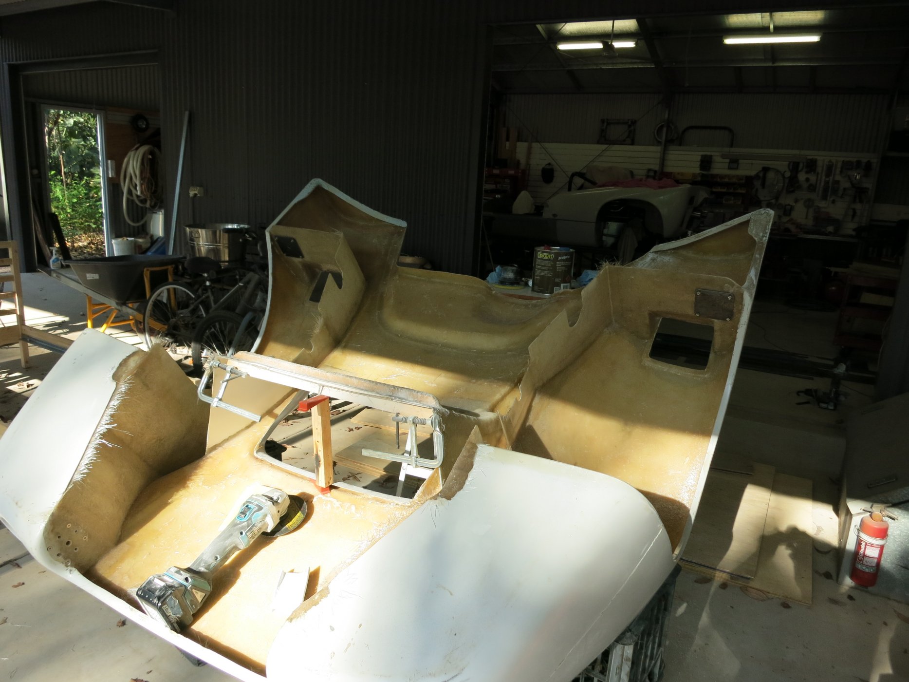

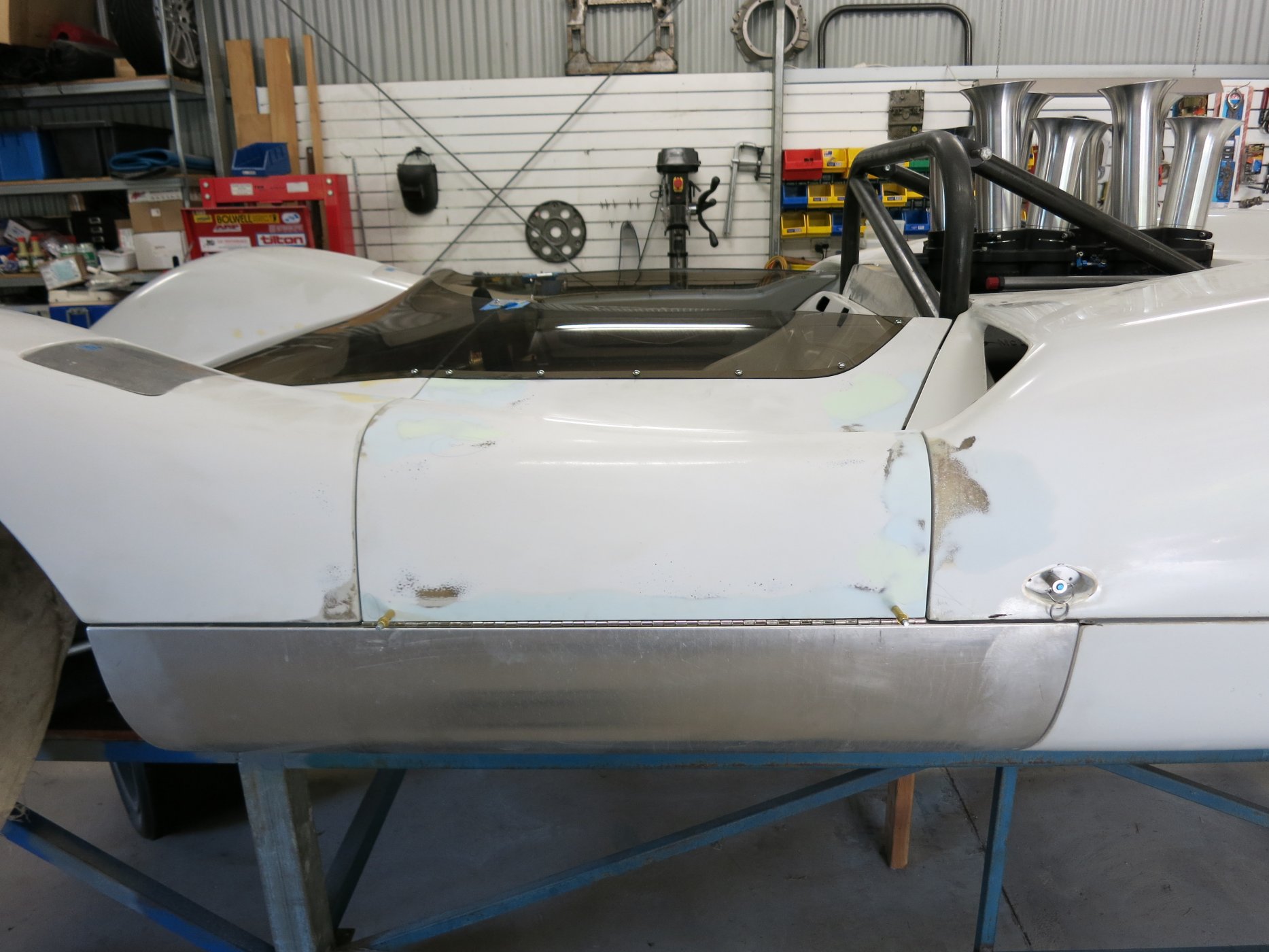

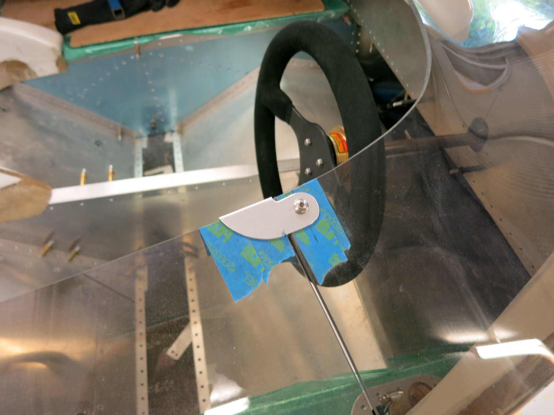

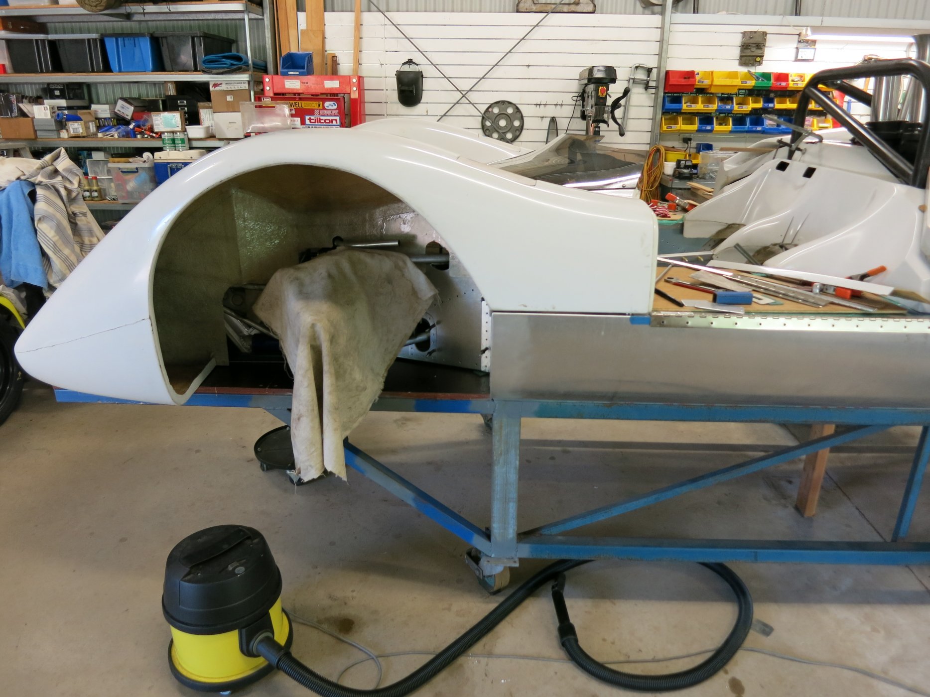

A lot of hours spent getting all the fibre glass panels lined up with correct gaps as every body knows. Also cutting the three screens and trial fitting. One picture shows the door pins in position, and I made up some little tabs that hinge over the door screens and main screen like they used to do in that era. By the way Chris, if you are reading this, Clayton sent me your latest photos of your body panels you are fitting. Looking really good.

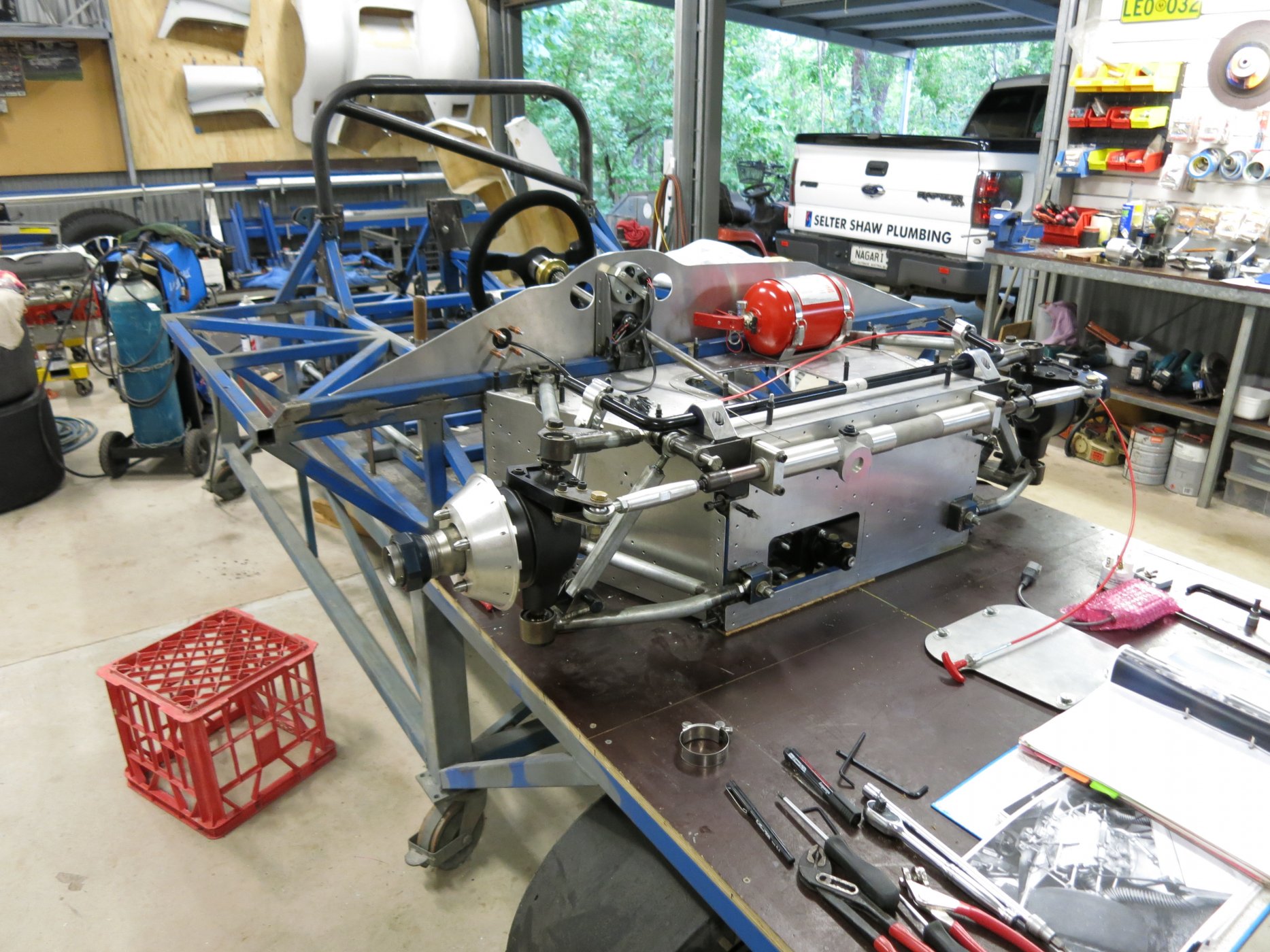

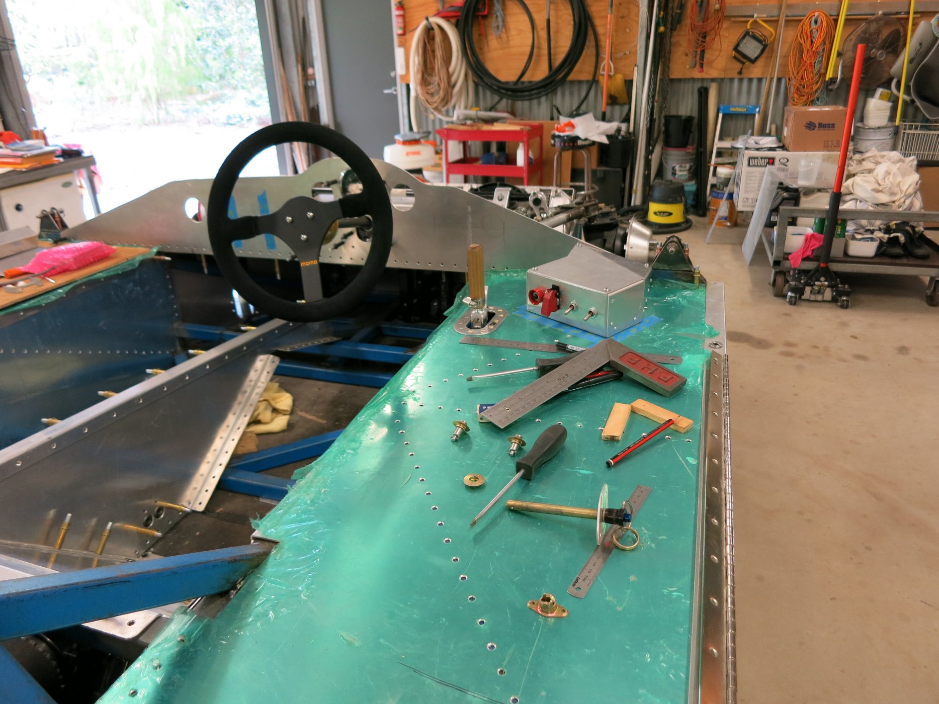

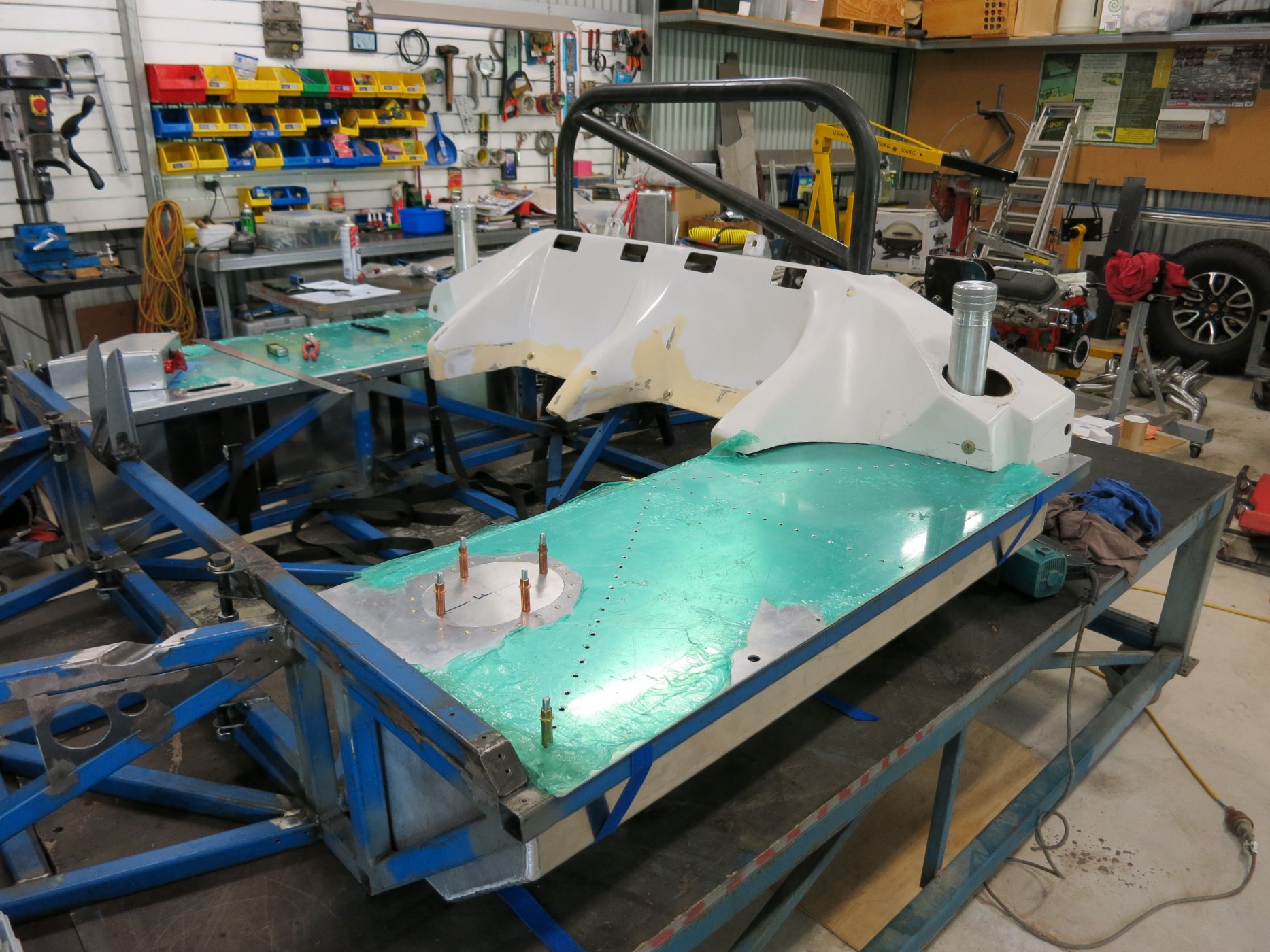

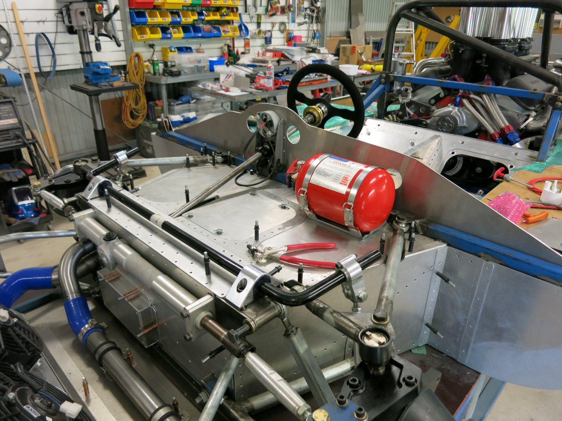

Thanks Michel, I'm glad you like them. I'll keep going. These next pictures are finding the only place I can fit the extinguisher. Then I realised I couldn't reach the dash with the harness on, so I made a small switch panel. Actually I copied it off an M8E I found photos of. There's some photos of me trial fitting the fuel tanks, and then starting to strip it down so I can add some extra bracing here and there. Got to keep that chassis nice and ridged.

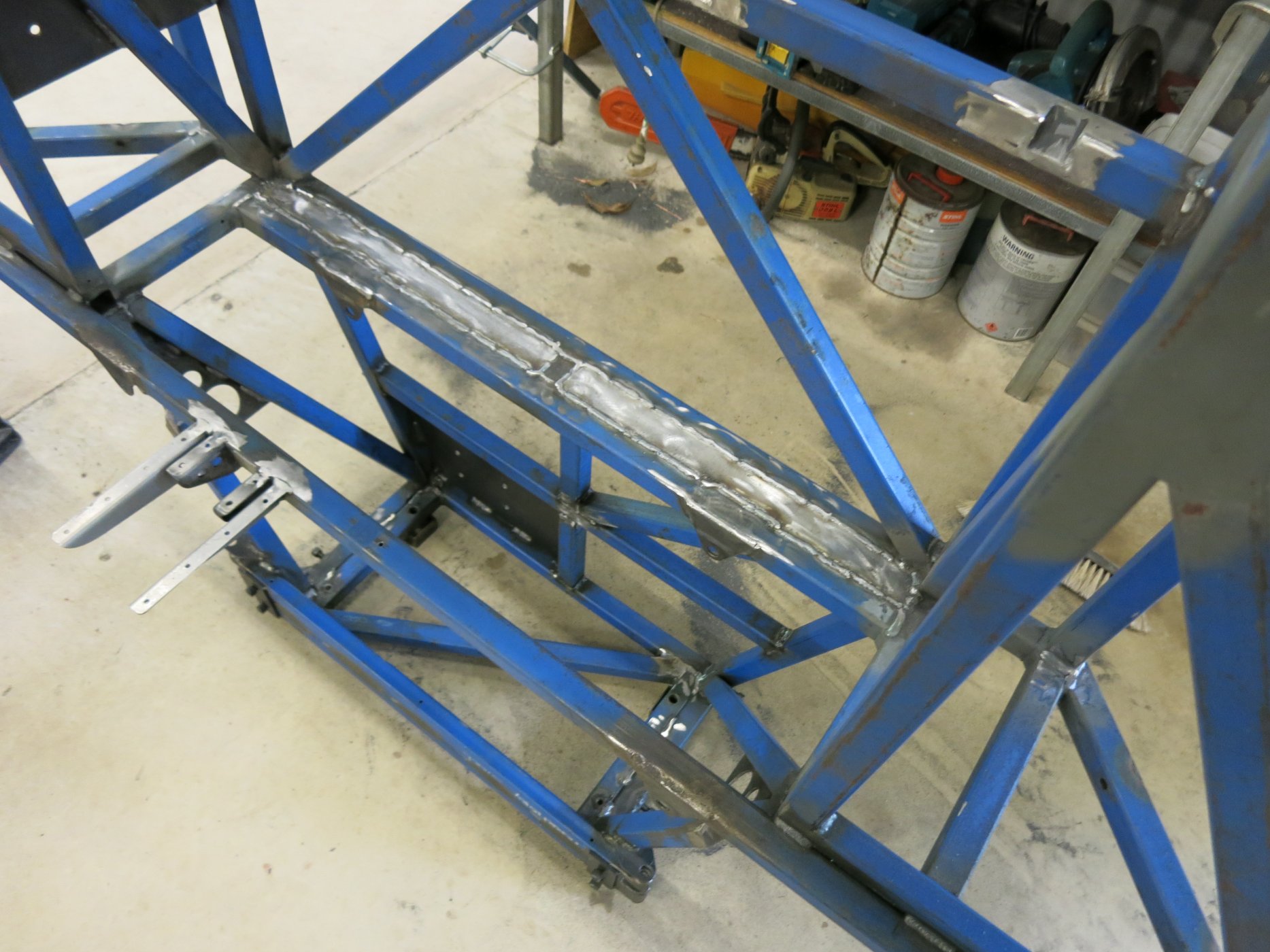

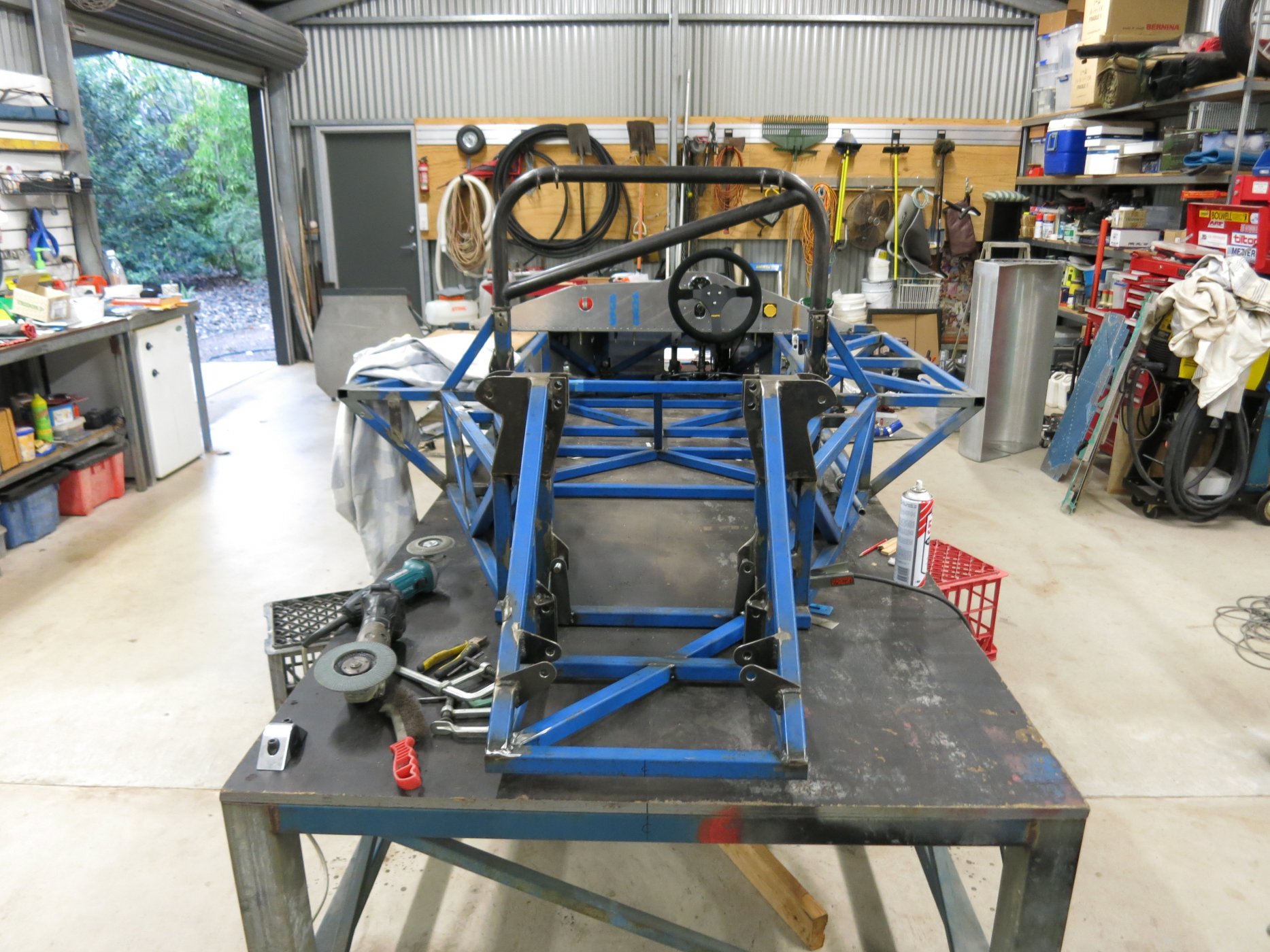

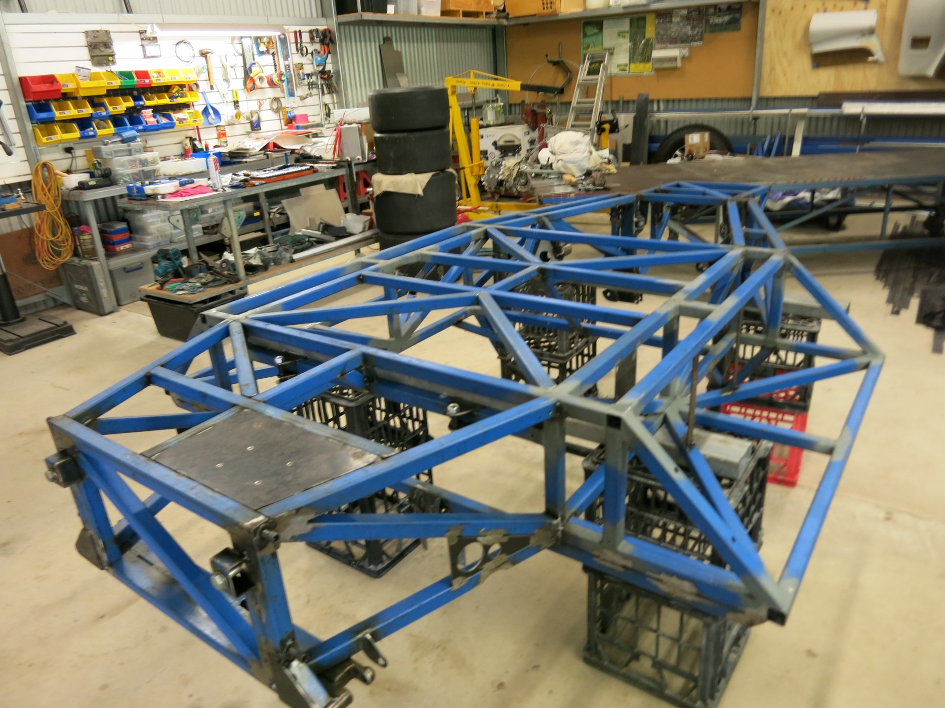

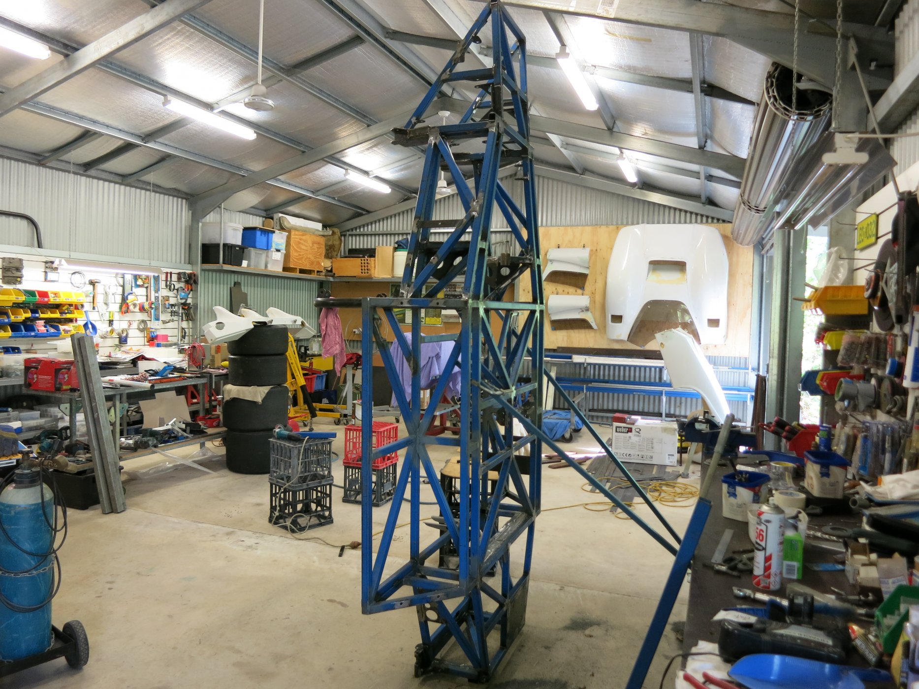

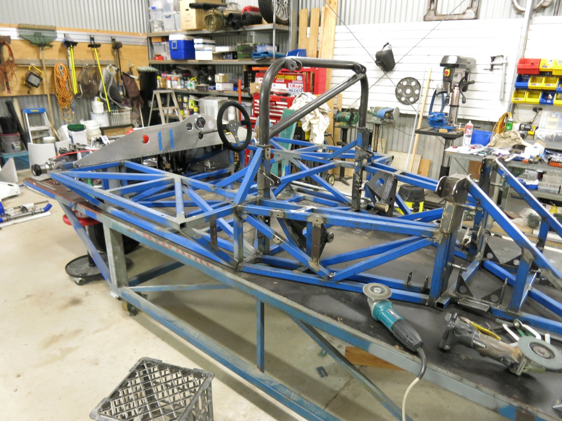

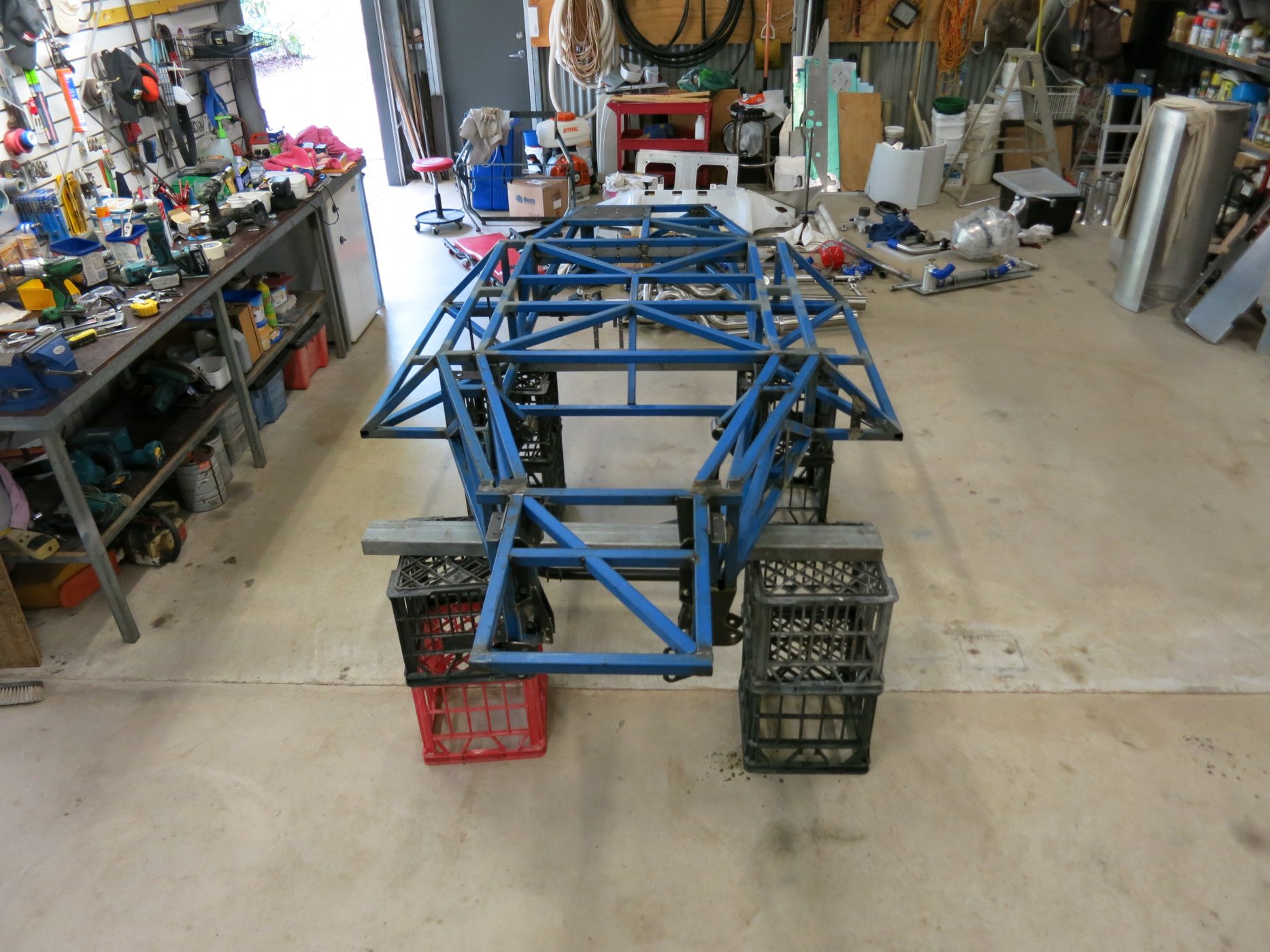

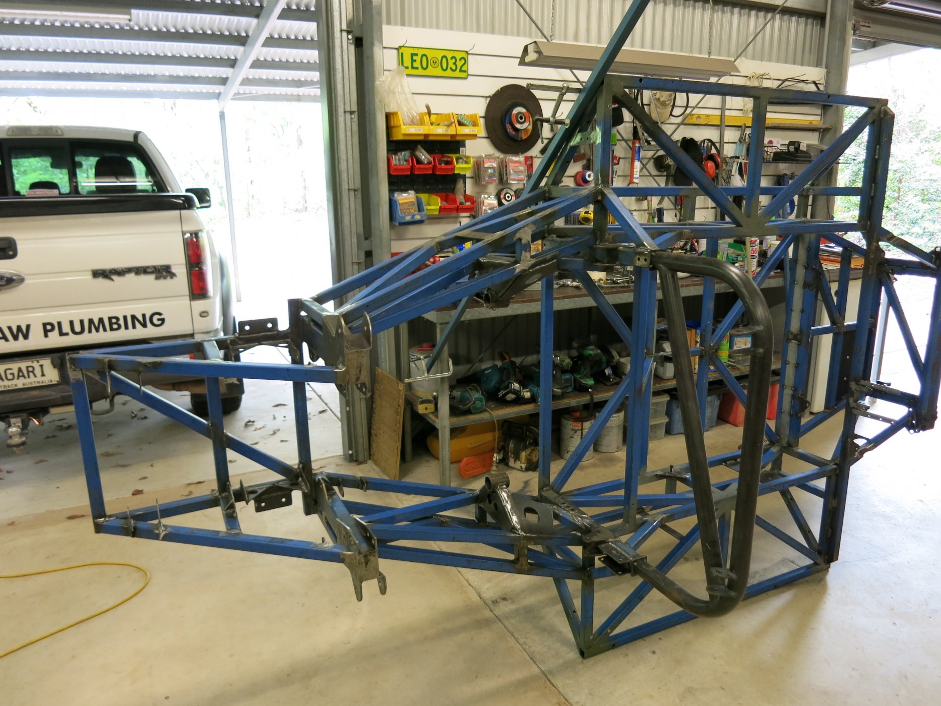

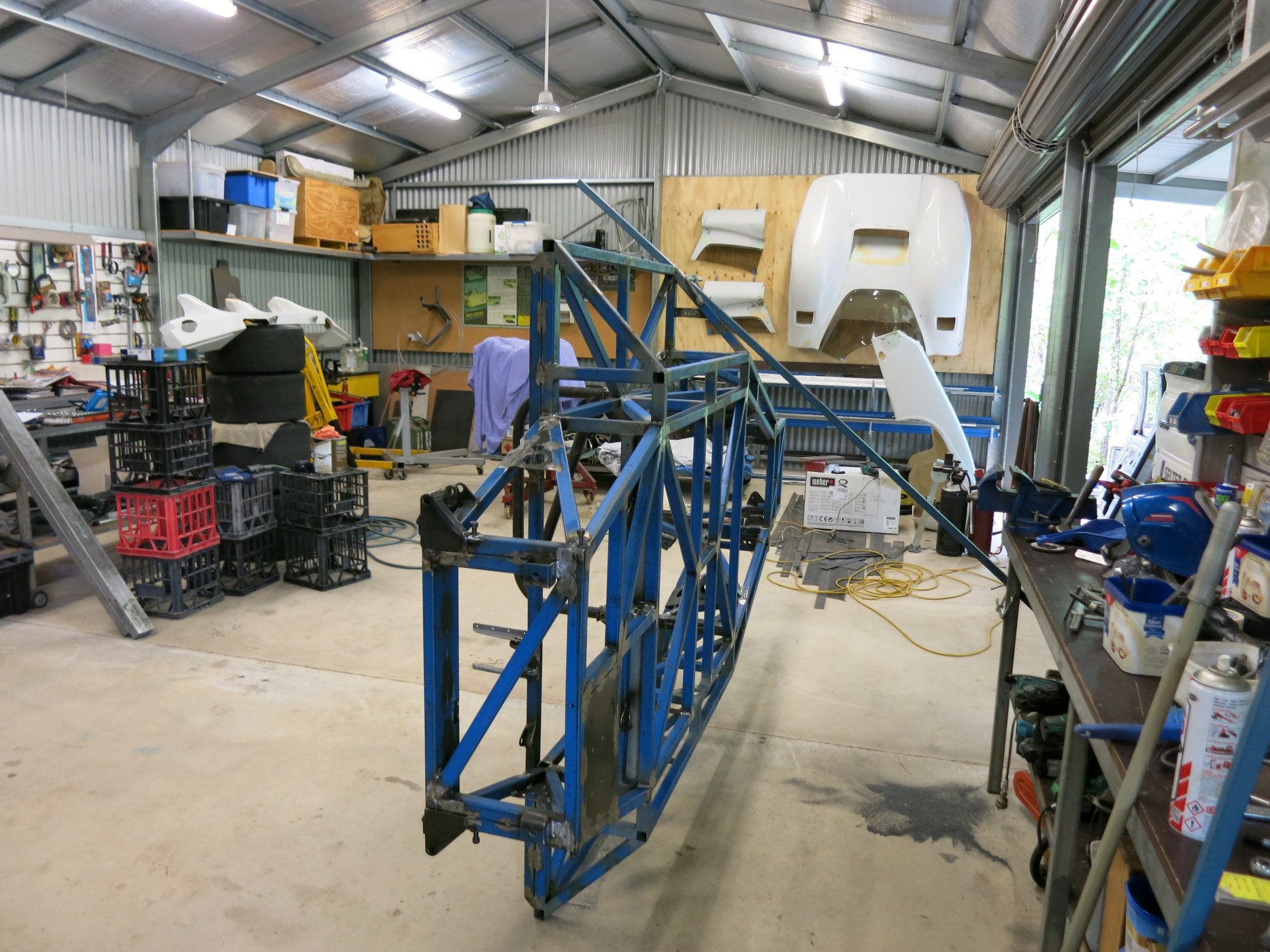

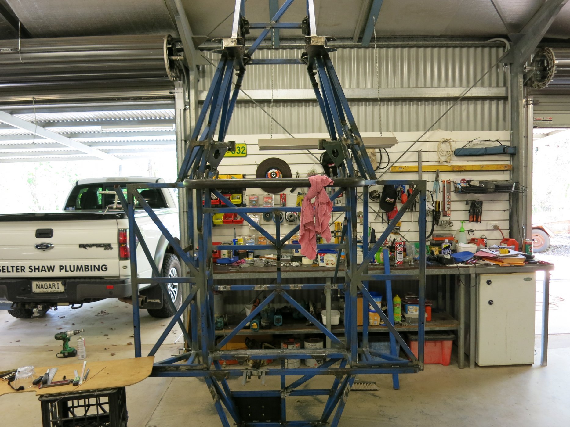

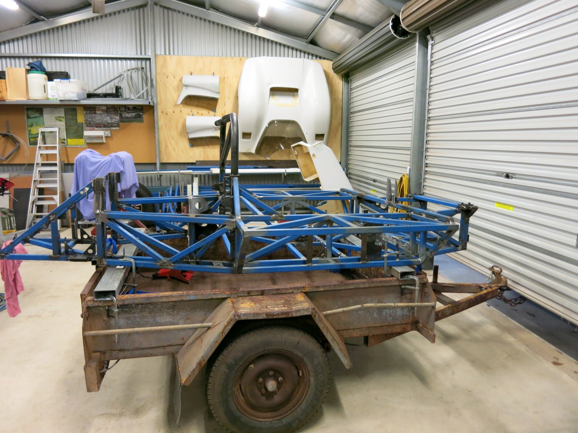

These shots are of the chassis stripped back bare so I can start welding all those places you couldn't get to before. Welding, Welding, and more Welding. Then it's off to the sand blasters and a coat of two pack paint.
