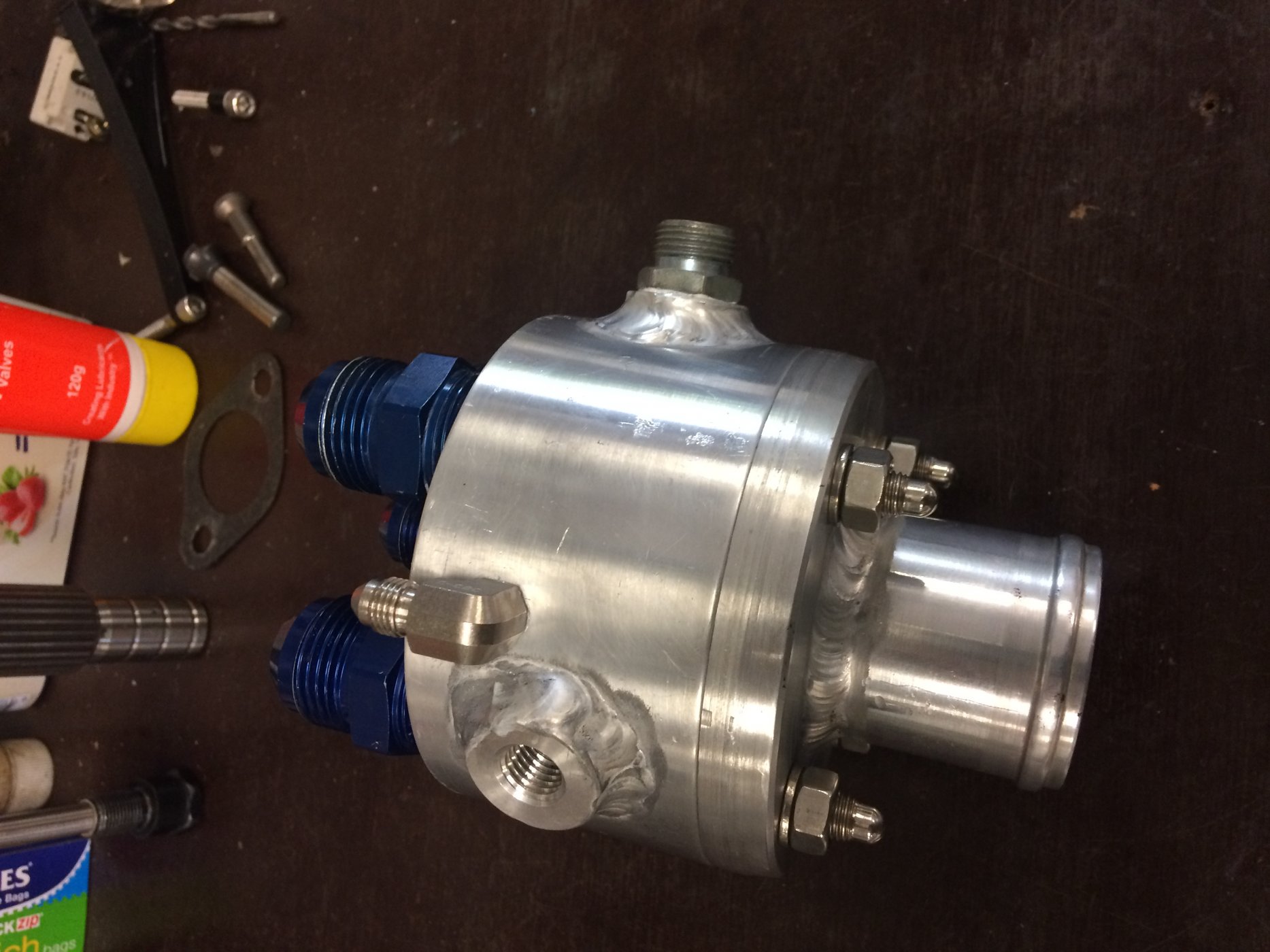

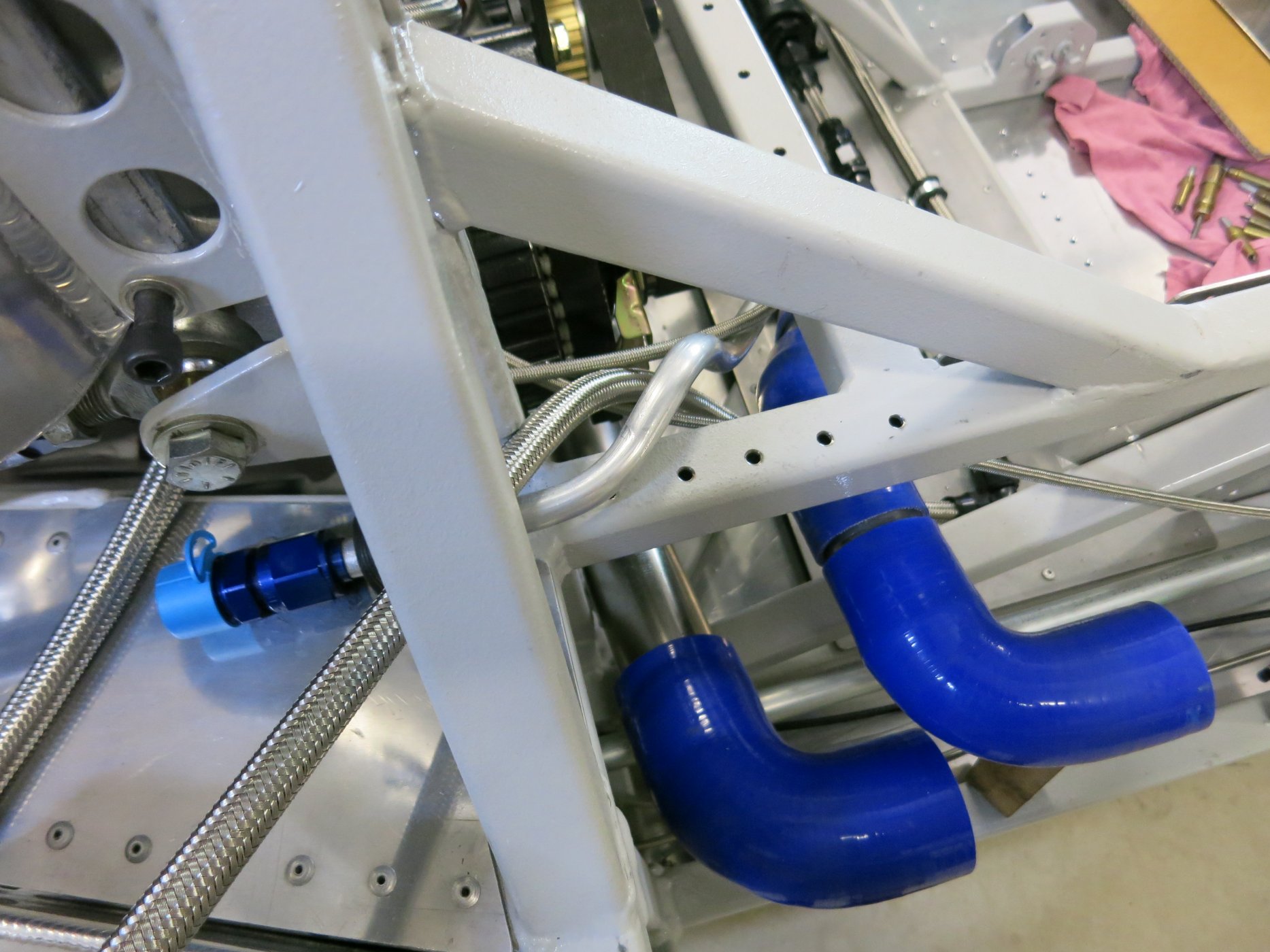

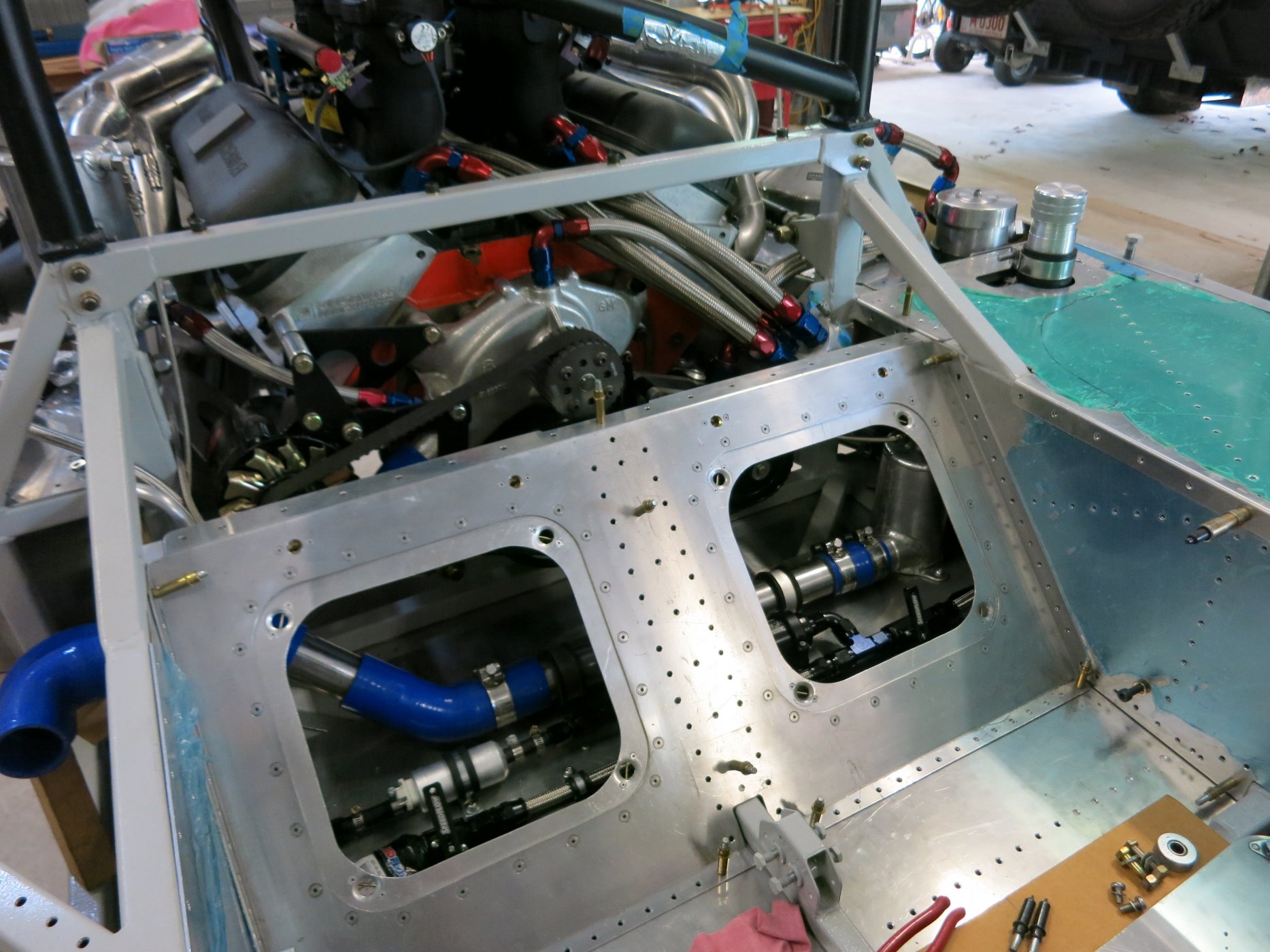

A few more of the thermostat housing, plus the swirl pot and then how it all fits in snuggly.

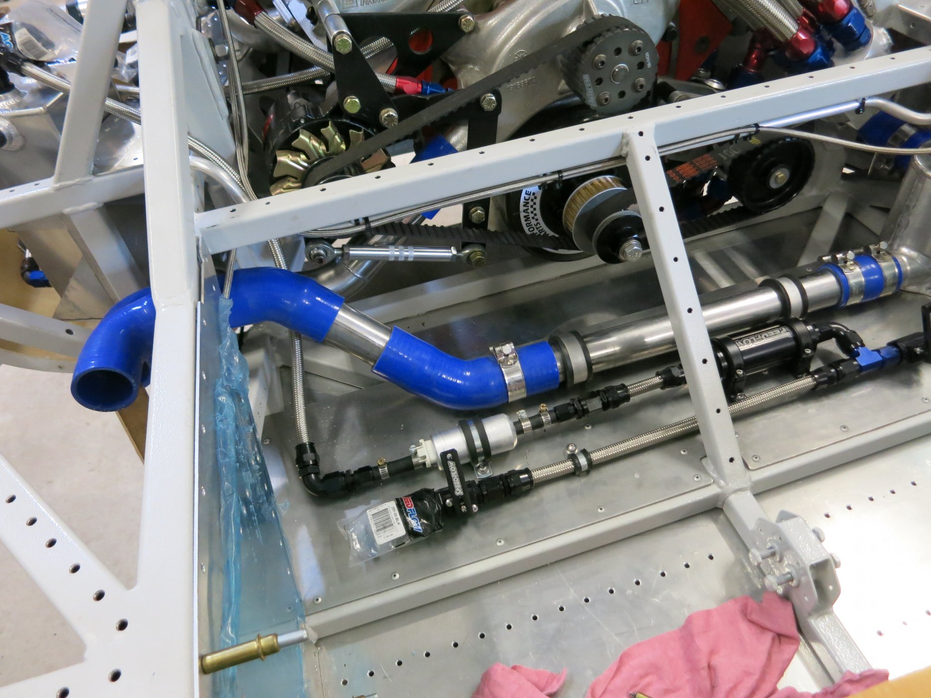

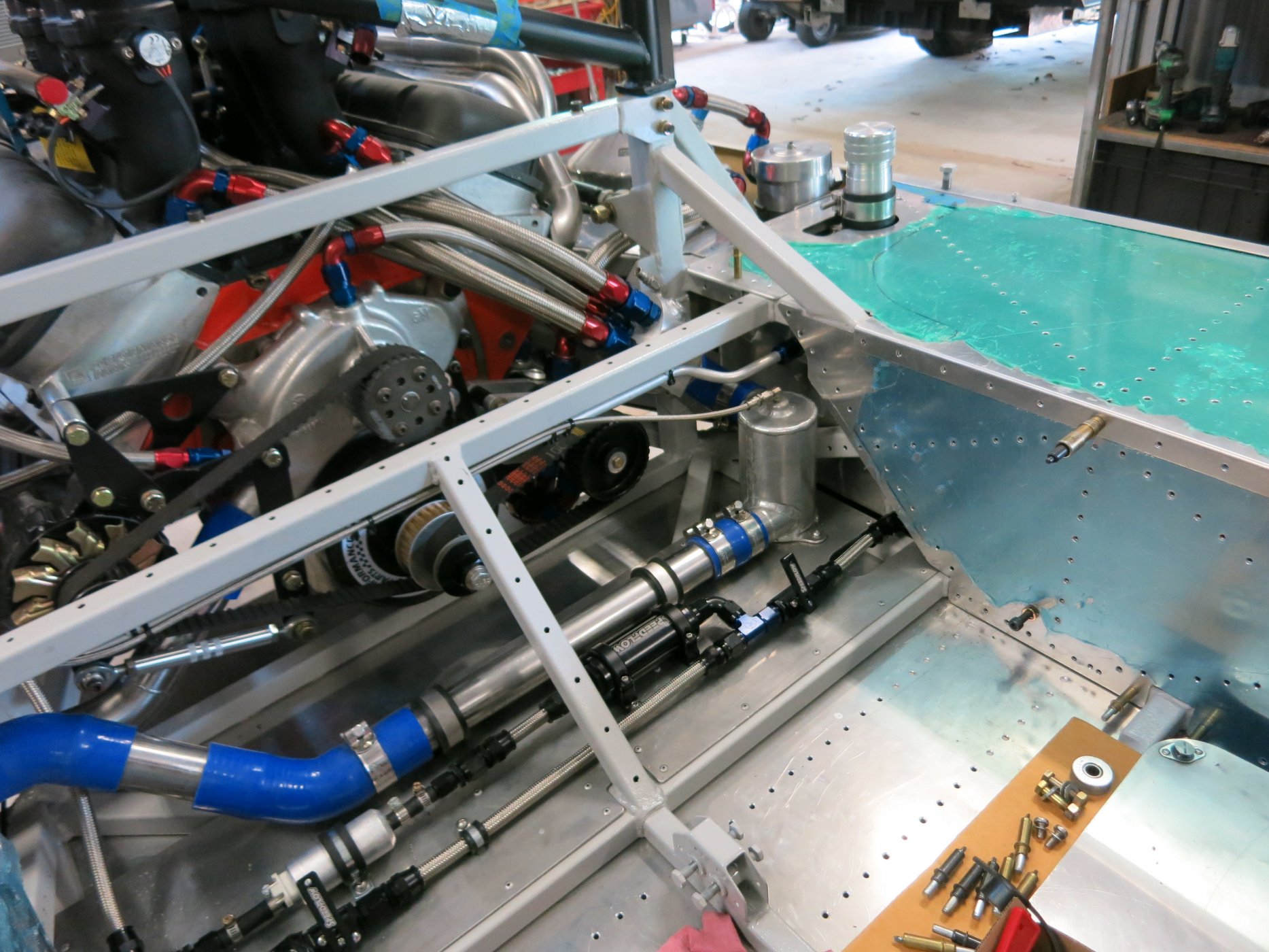

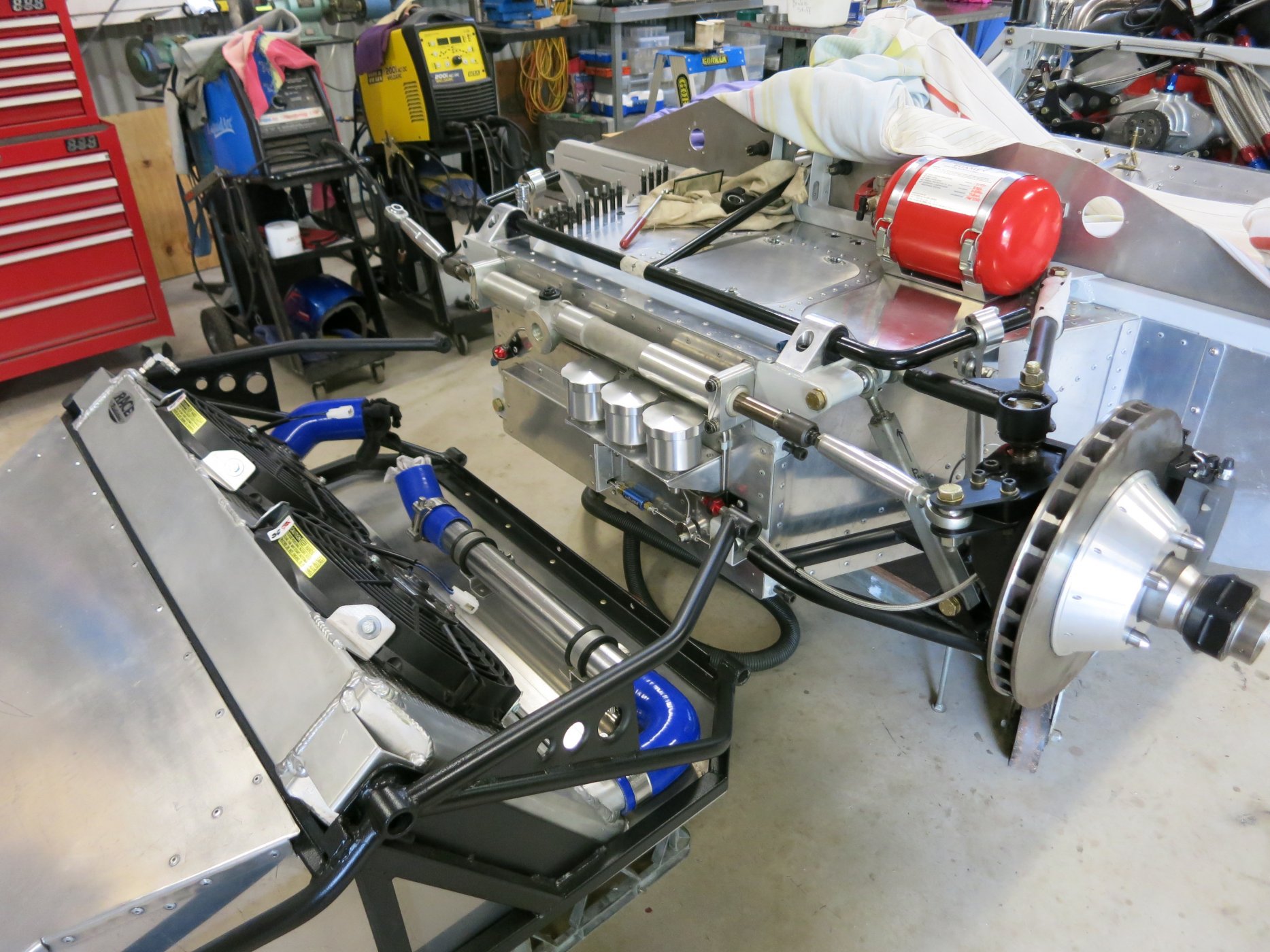

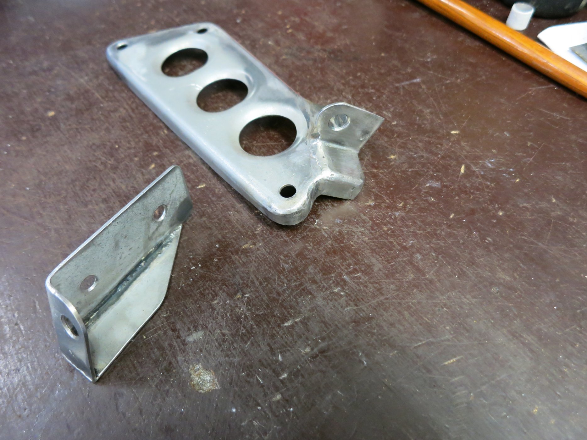

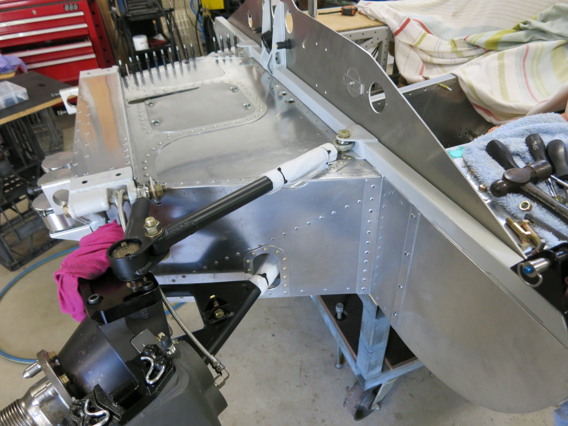

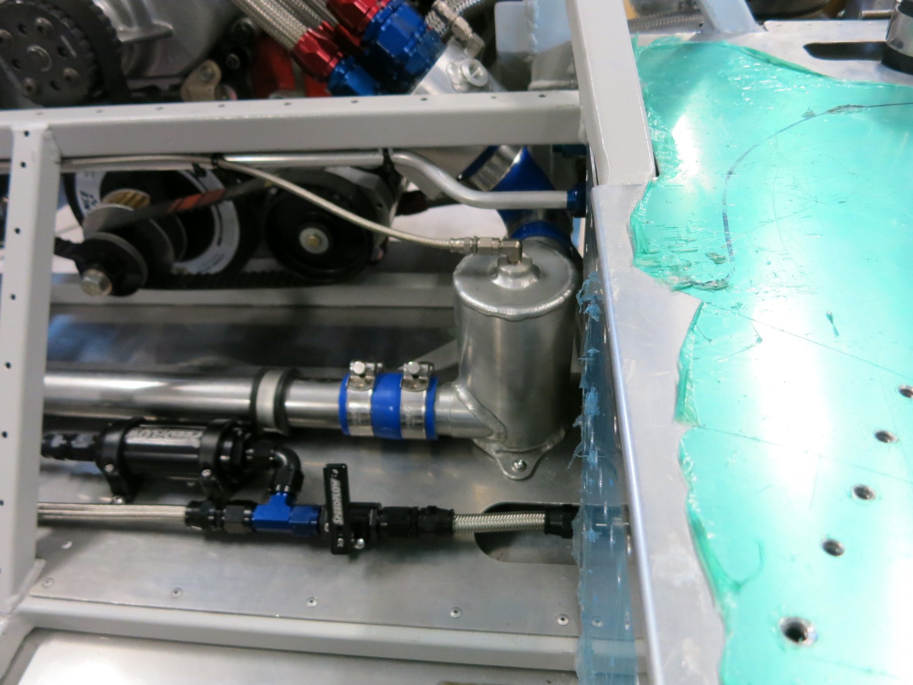

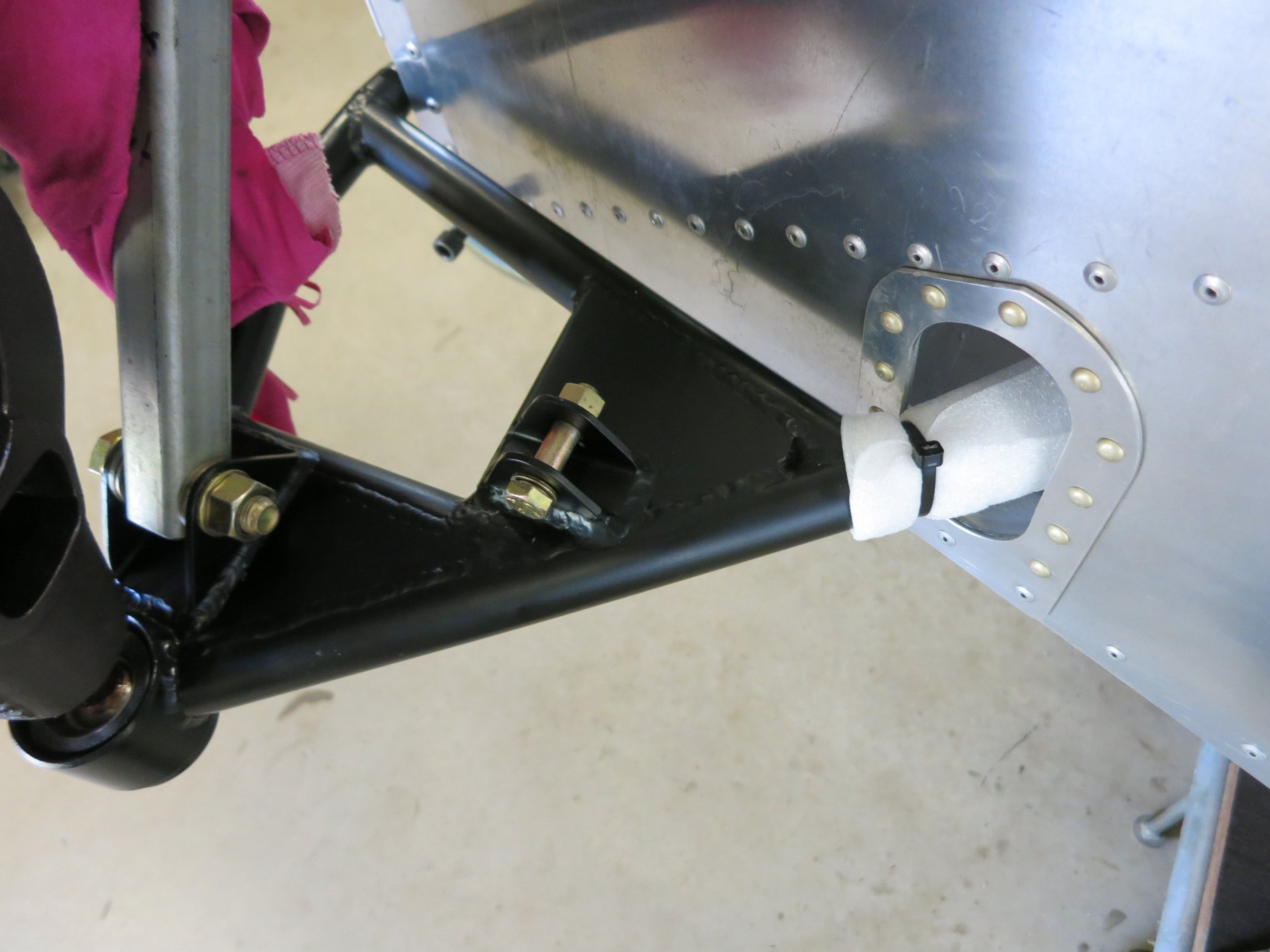

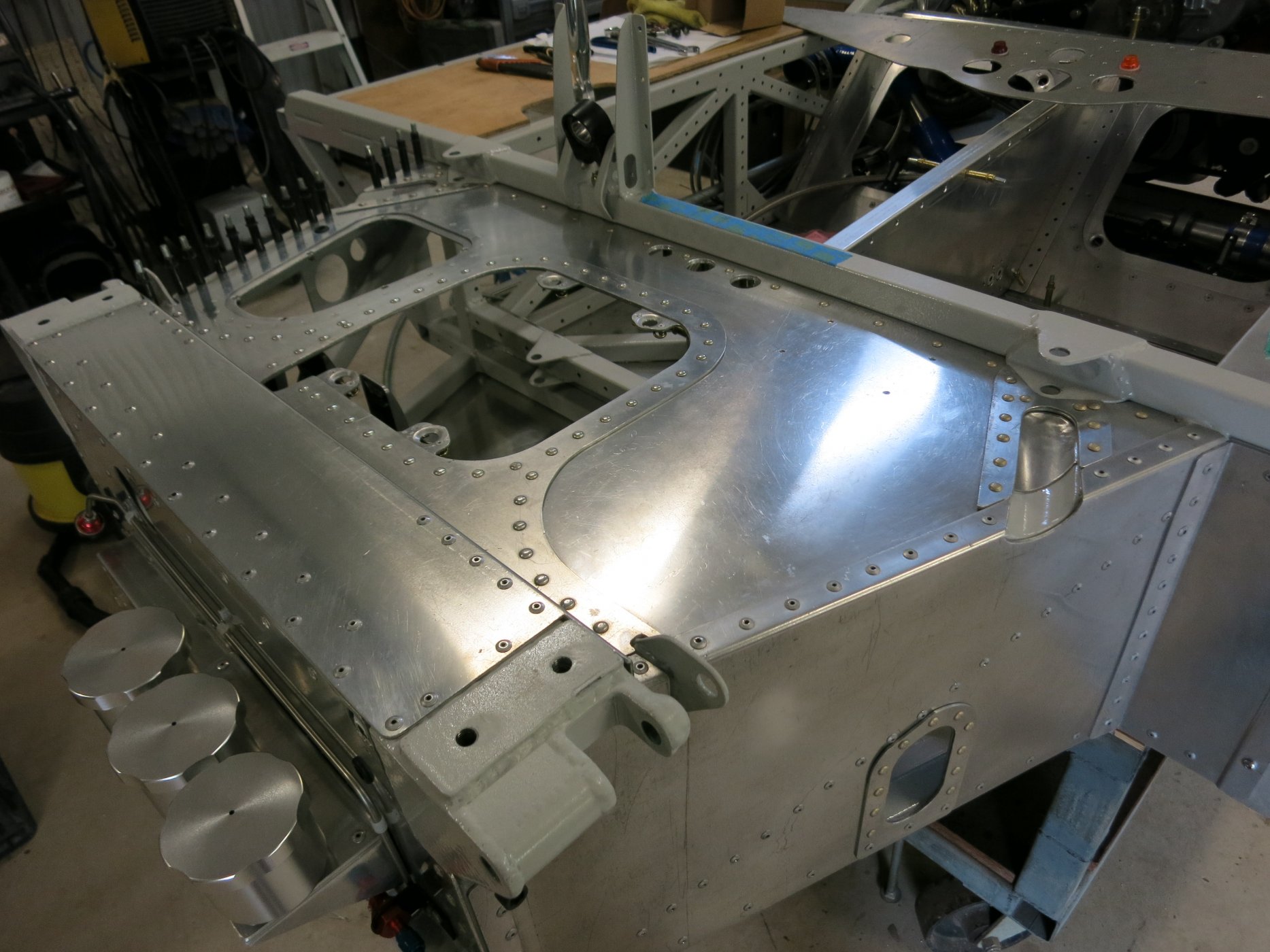

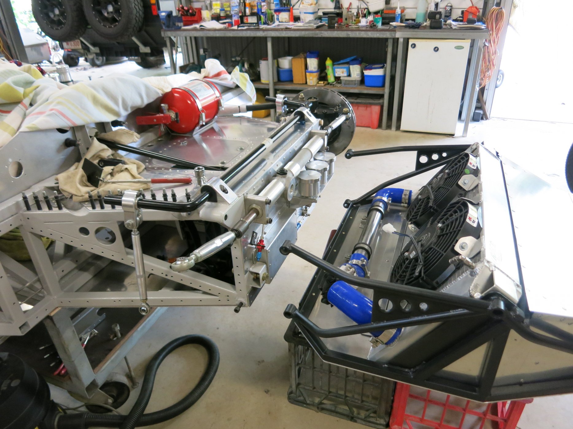

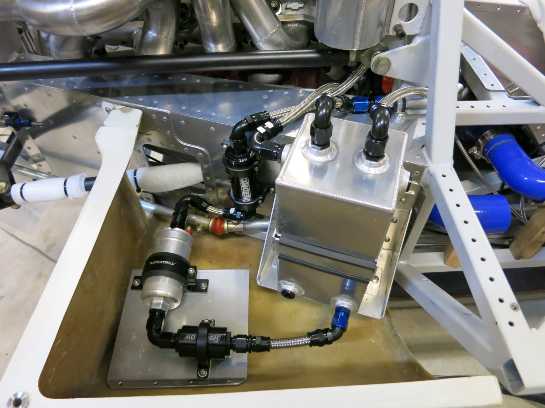

Here are some more progress shots as I chip away.

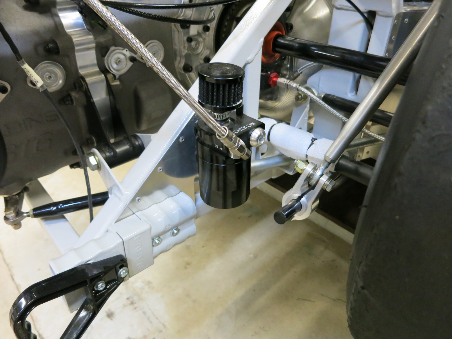

Putting the front panelling on permanently, Added a bracket to the front lower wishbone for the sway bar, sorting out the fuel pump, surge tank, more filters and lines and bolting the front sub frame back on.

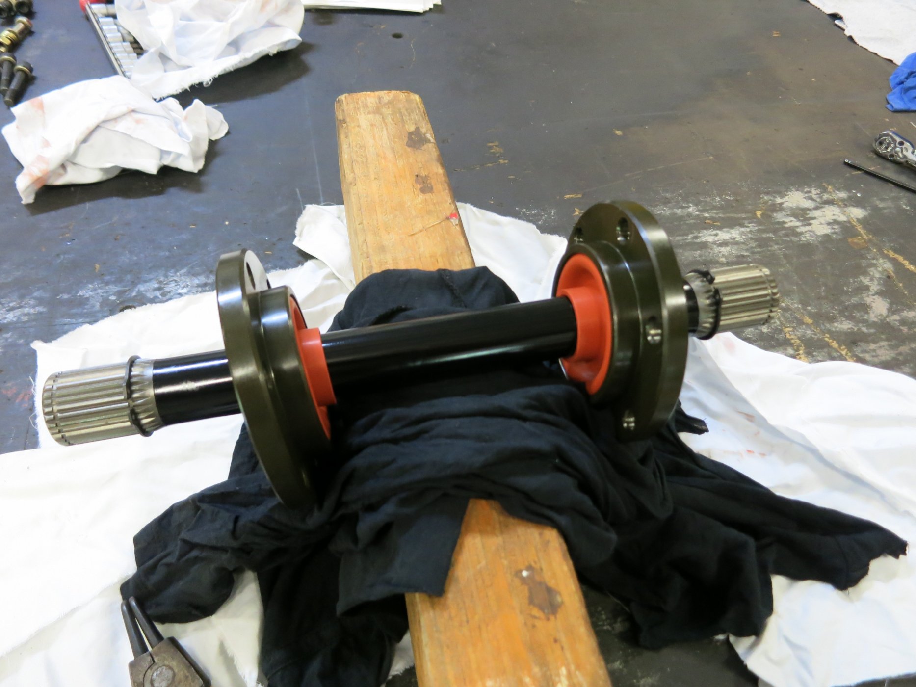

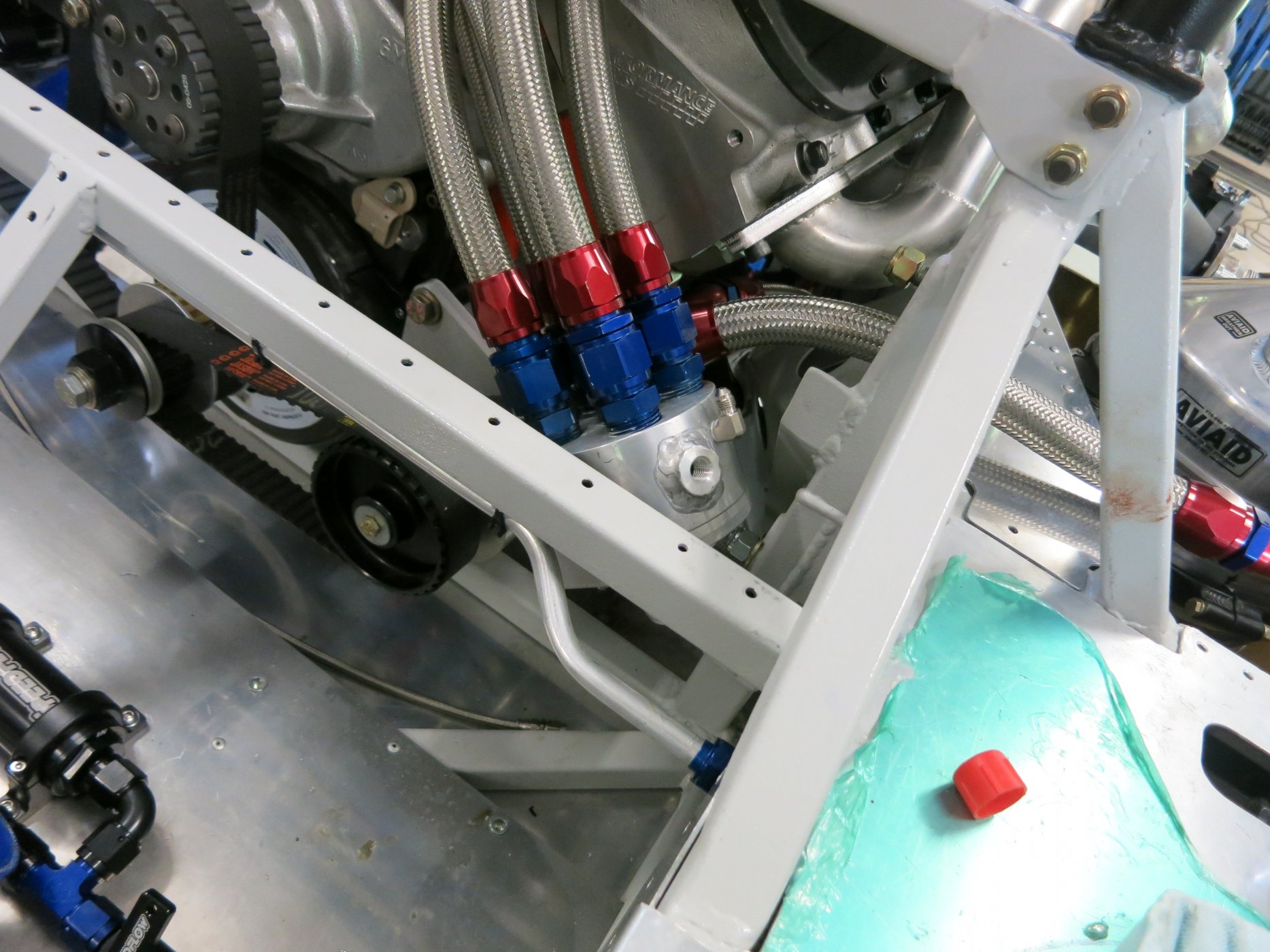

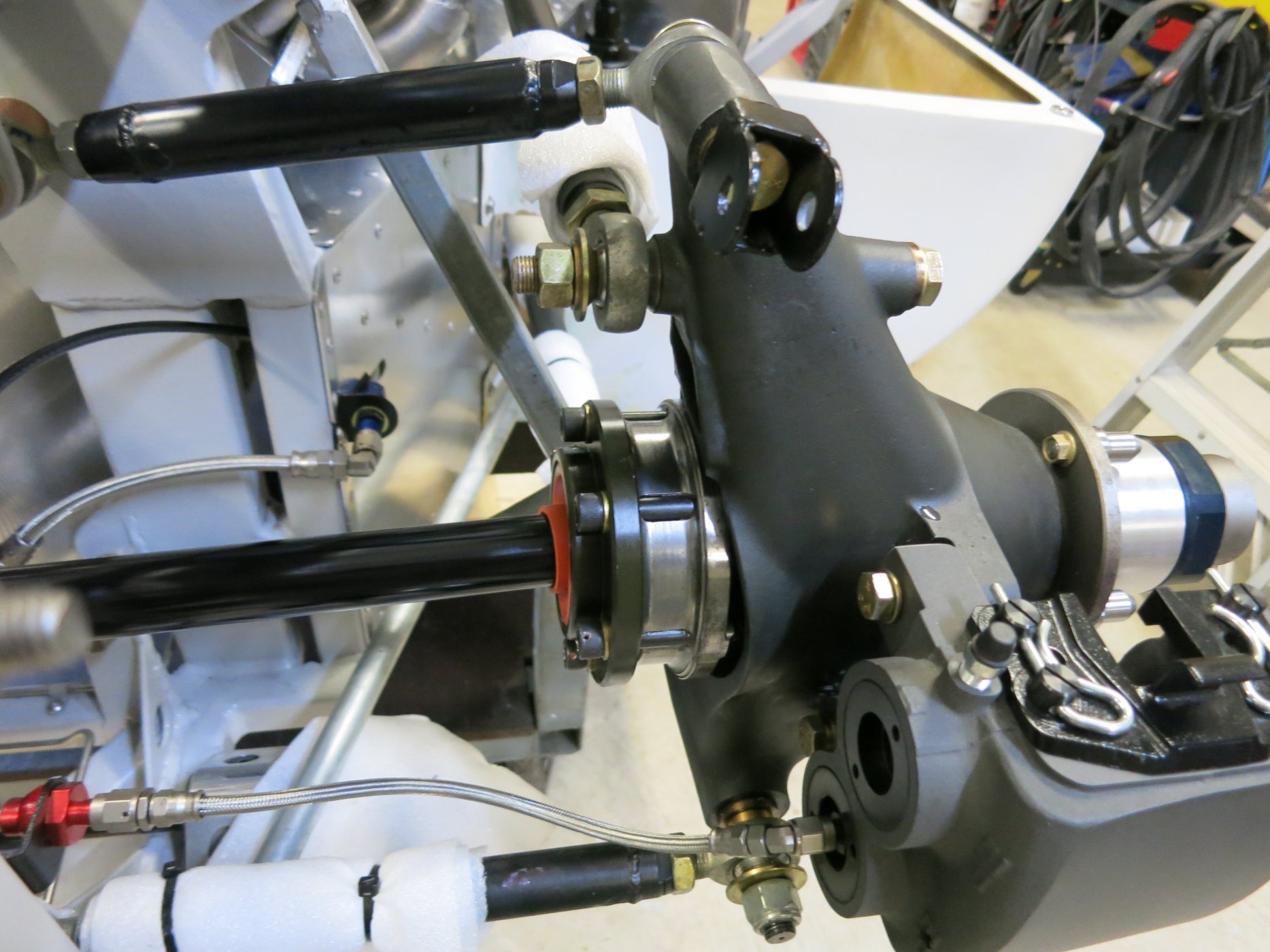

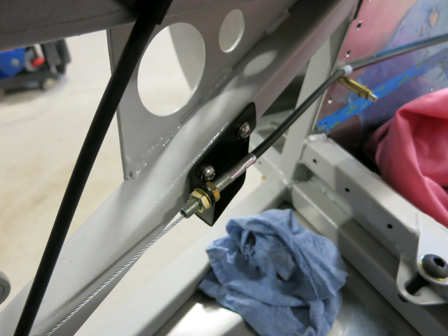

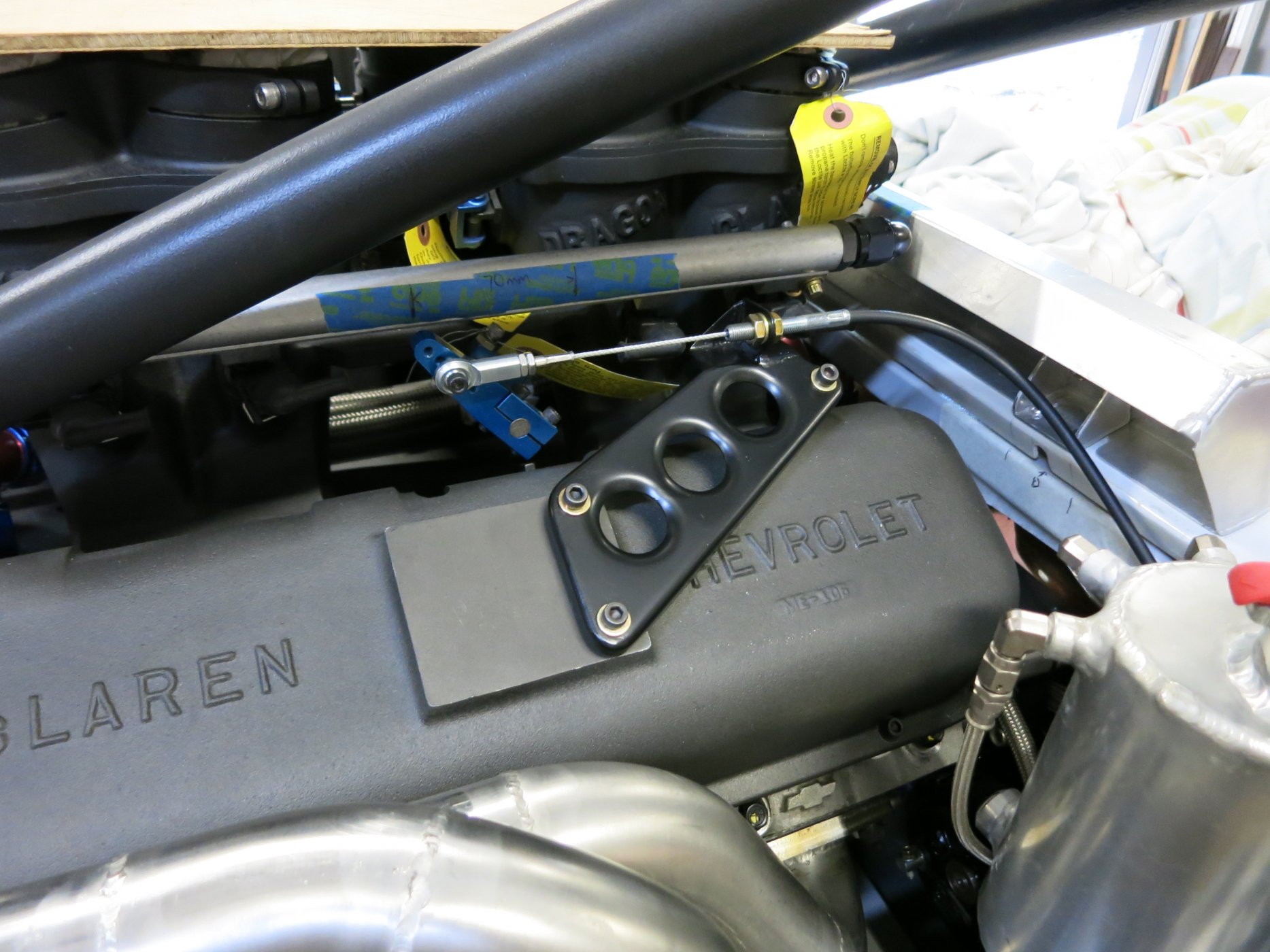

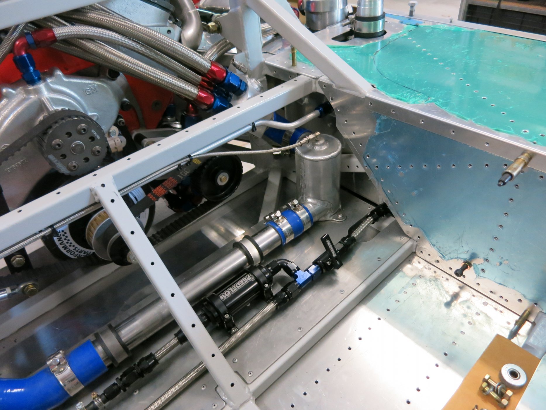

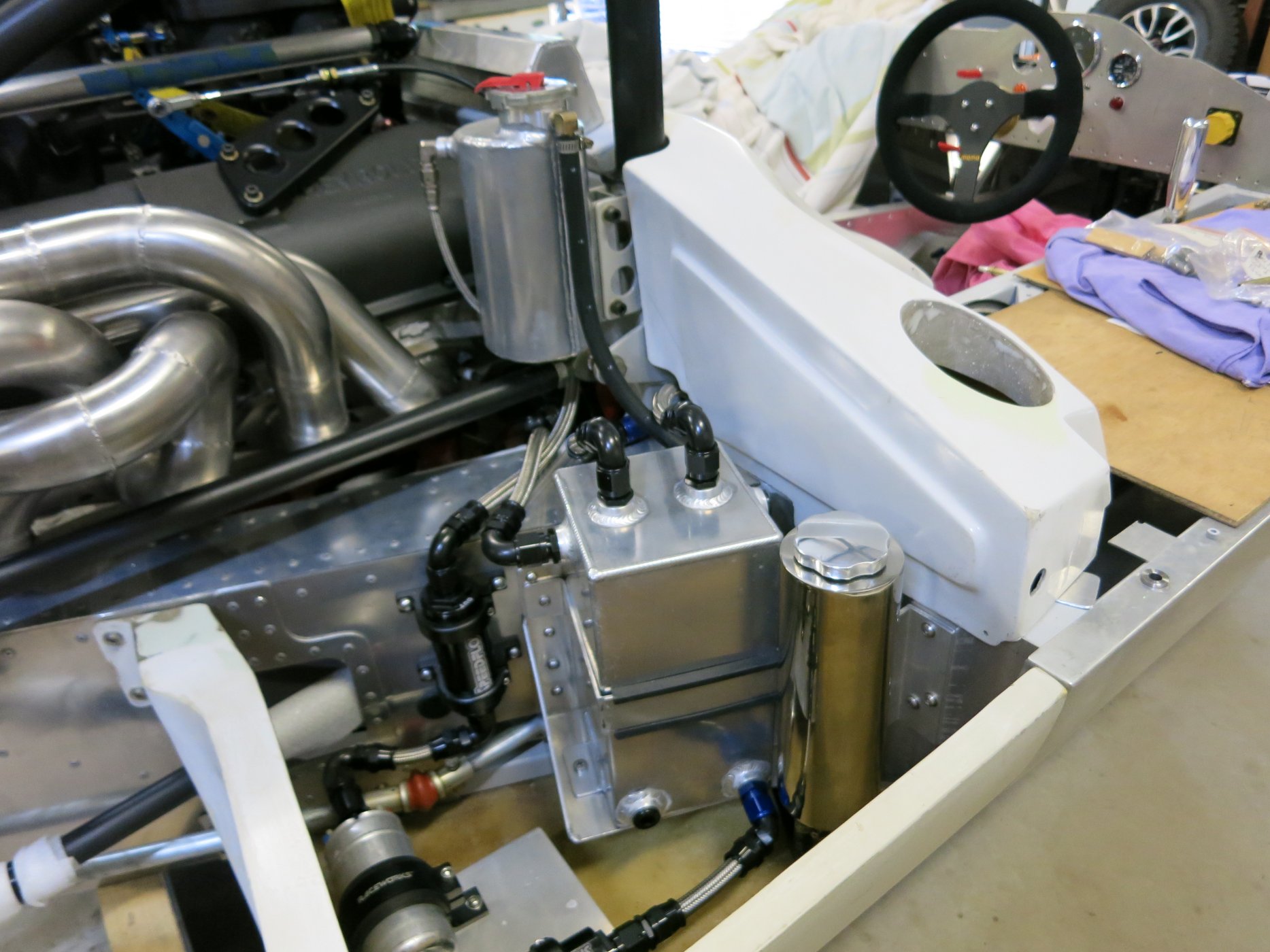

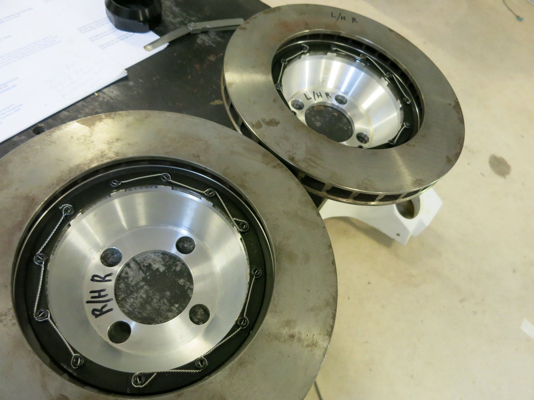

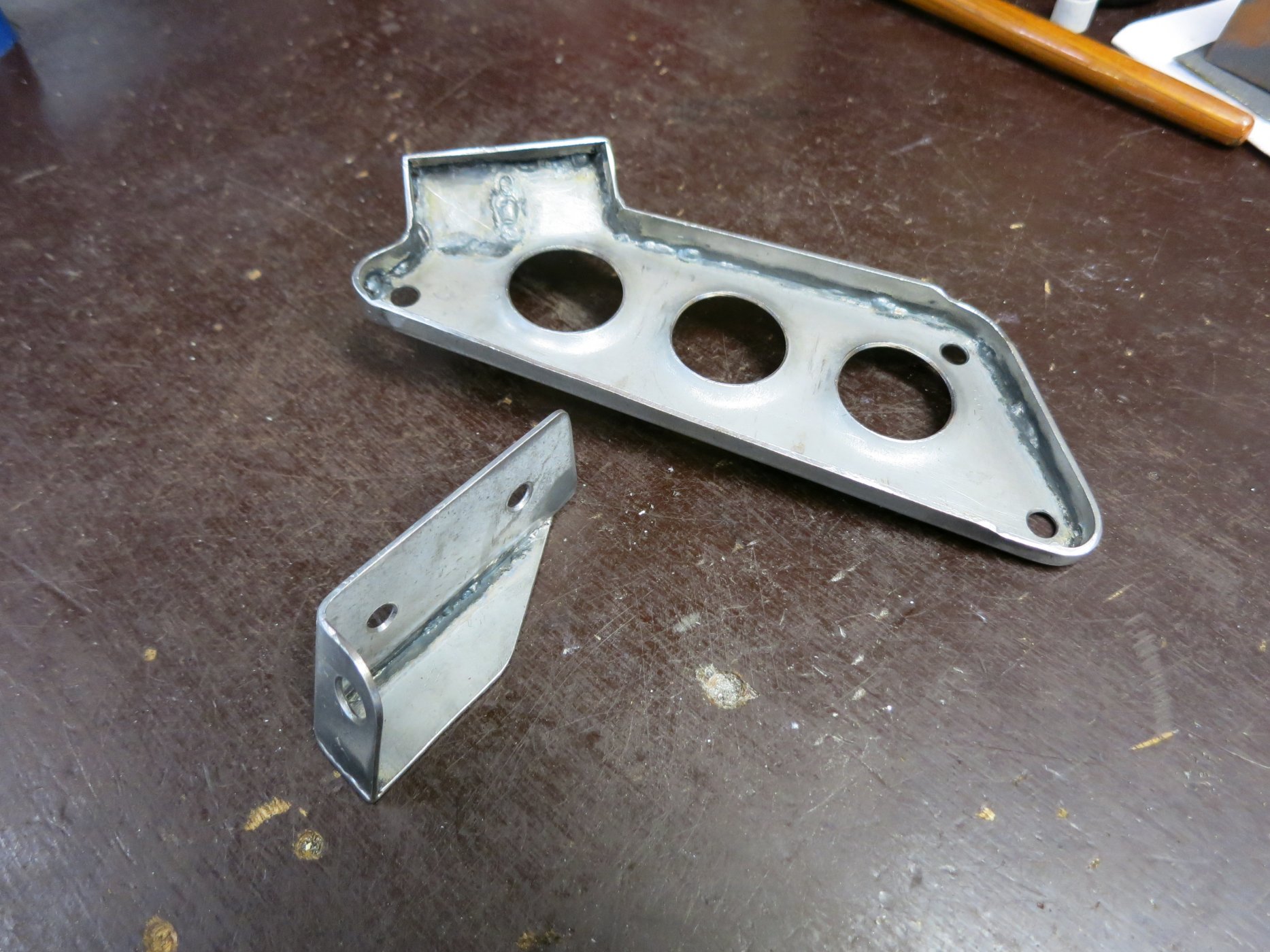

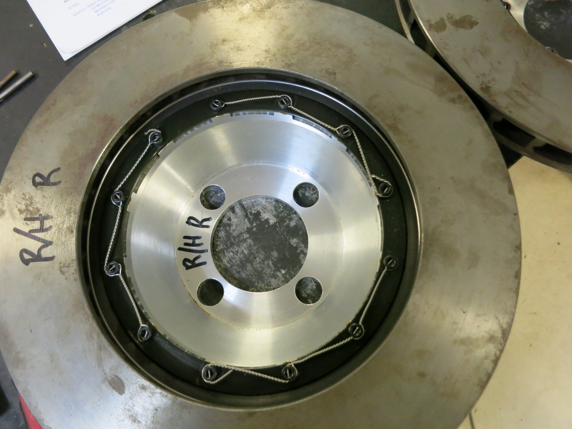

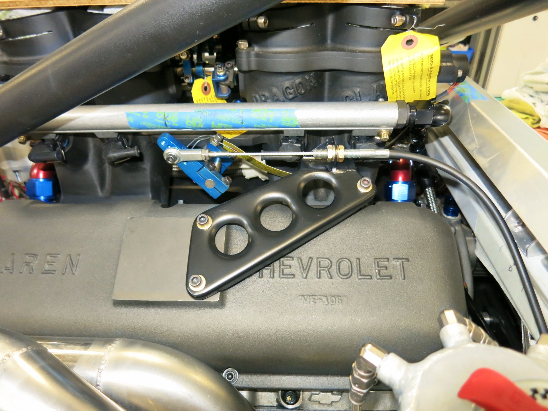

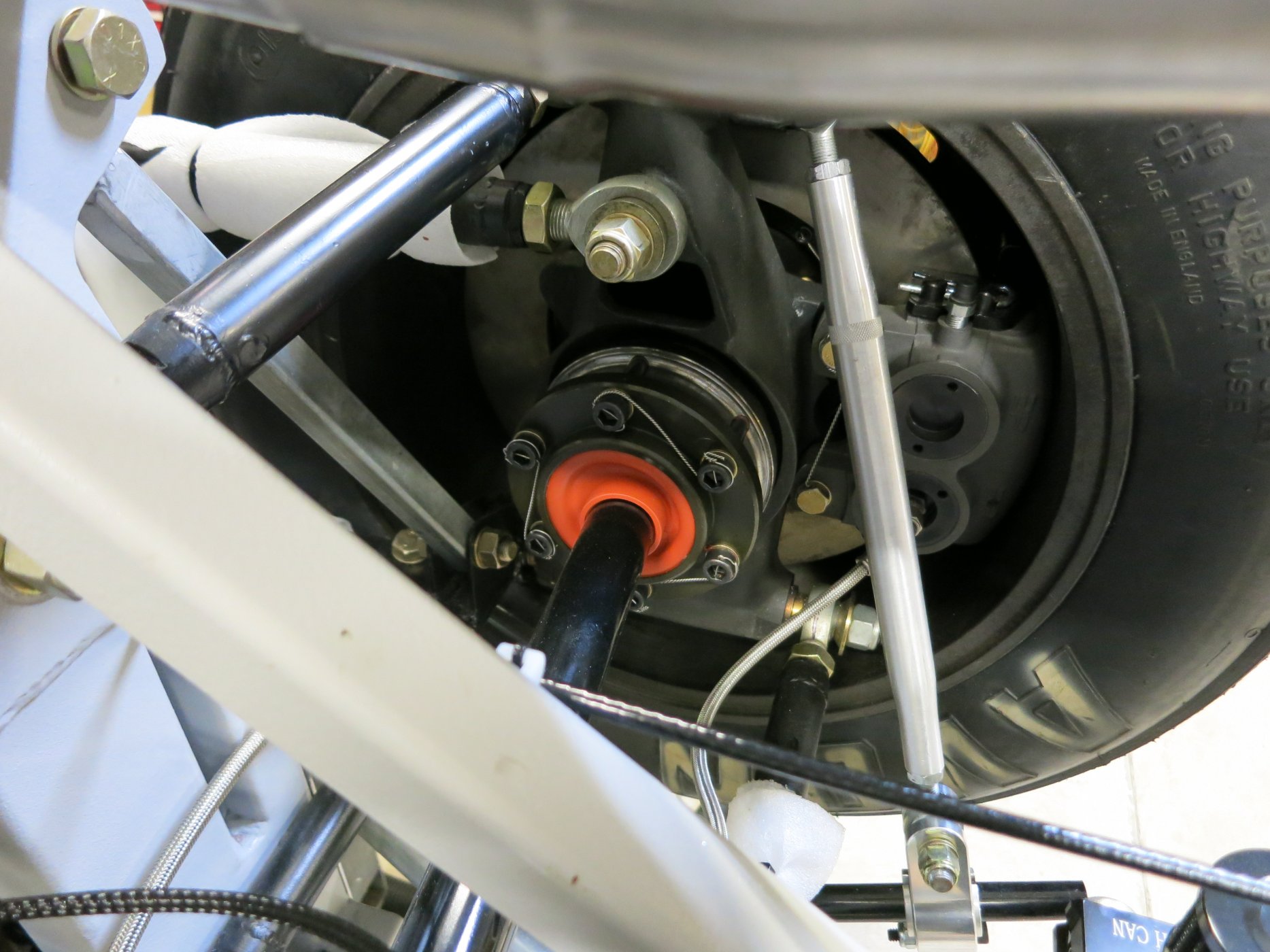

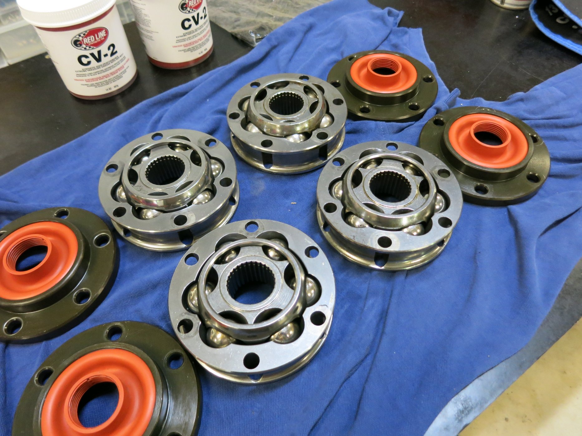

More progress. Lock wire on Disc Top hats, Throttle cable brackets, Expansion tank & overflow, Added a catch can to the Transaxle, and lock wired all the CV joints.

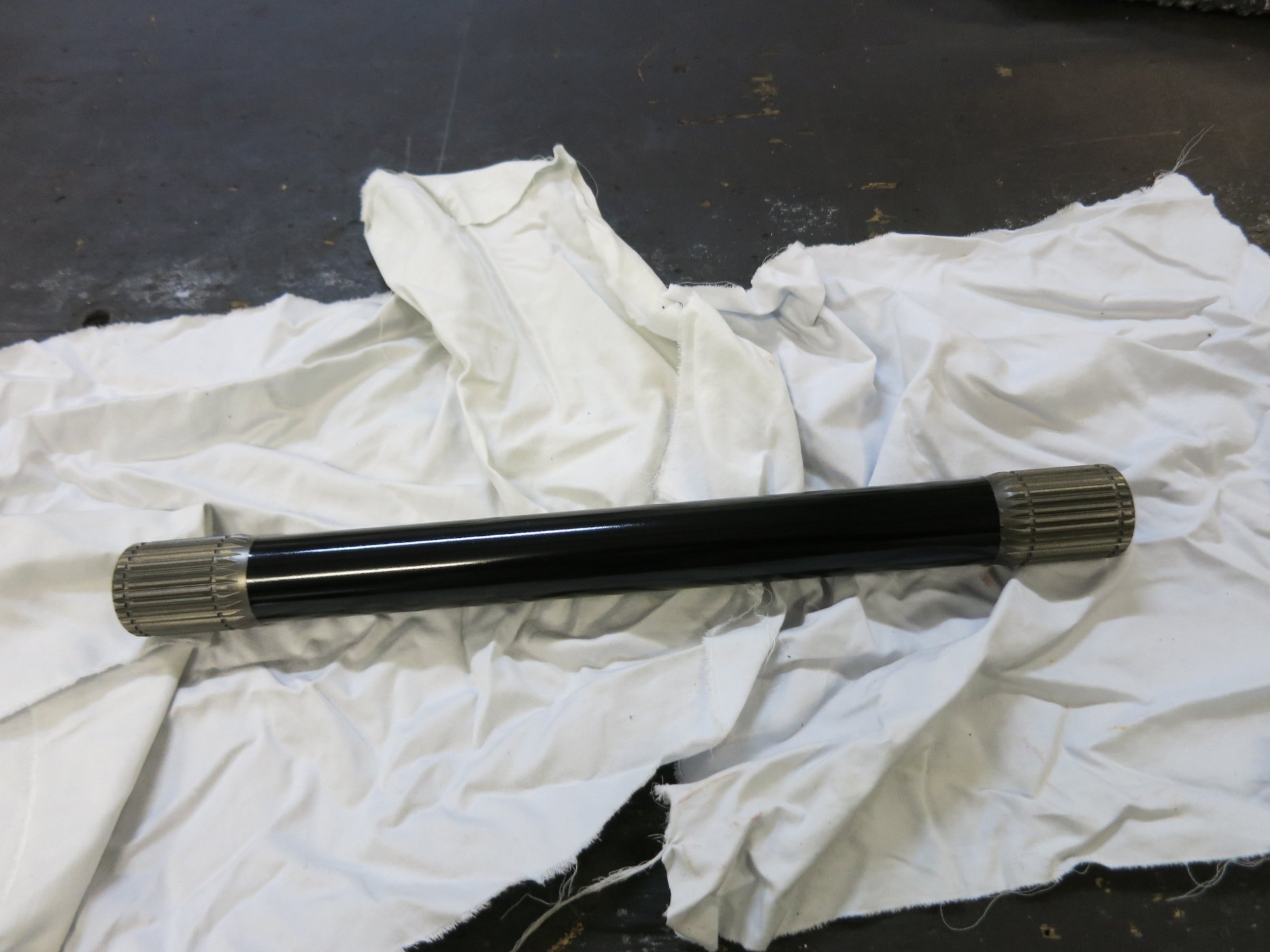

Hi Udo, looks awesome! Are those Porsche CVs? Where did you get those cover/boot assemblies for them - they look really slick.
Cheers, Andrew
Thanks Andrew, They are 115mm ( size 18 ) same as 934 Porsche. The dust covers are solid billet steel, anodized and the boots are 100% silicone.

On the drive shafts, I always thought you needed a noticeable angle in the shaft to prevent excessive wear in the CV joints?
Hi Malcolm, You are correct. It's hard to see in these photos, but they do angle forward slightly. If you go to page 4 and look at the picture 3551, you can sort of see the angle I'm talking about. I'm not too worried, because I won't be doing any interstate trips in it. Racing around the track doesn't clock up too many Kms.

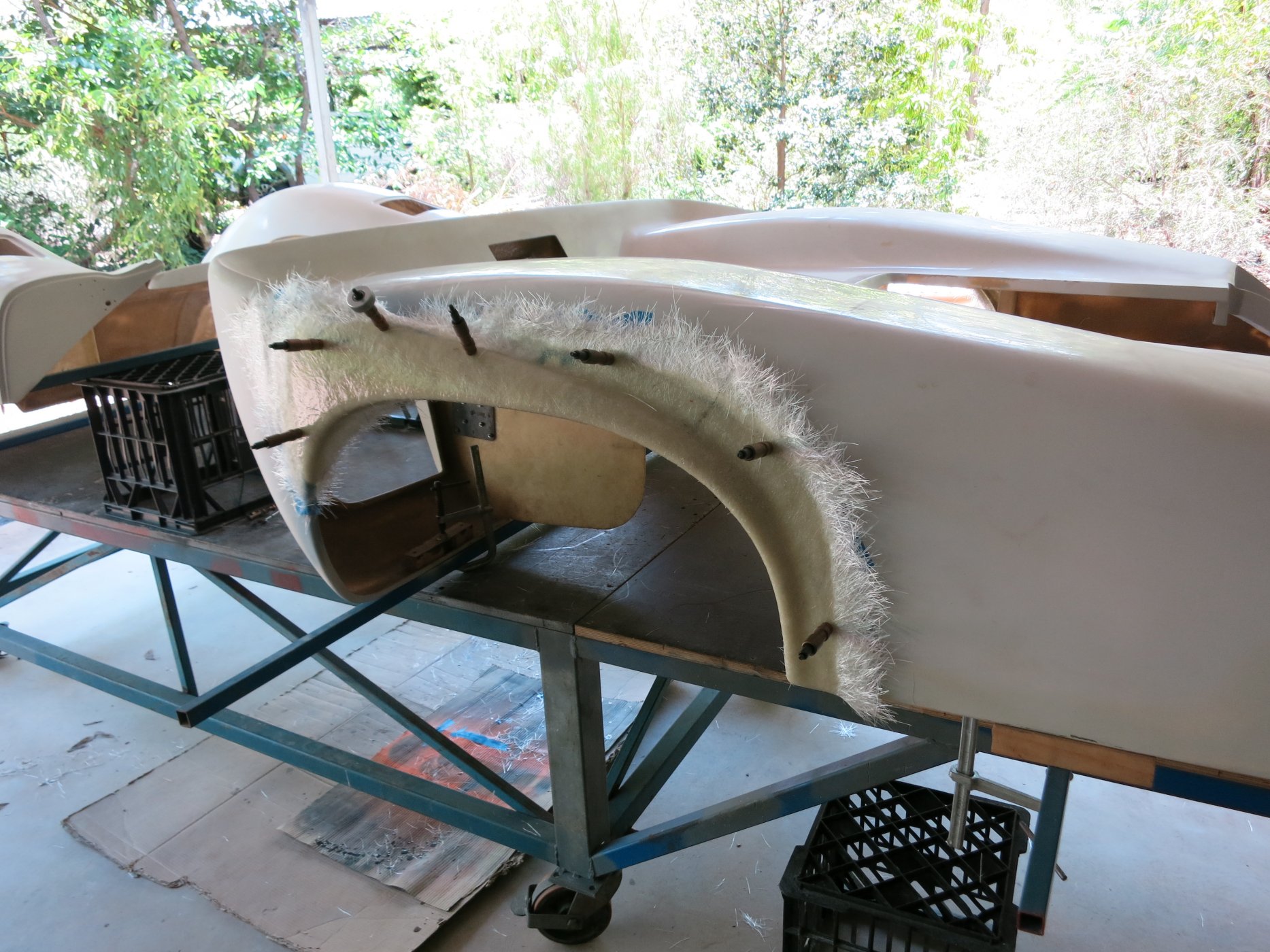

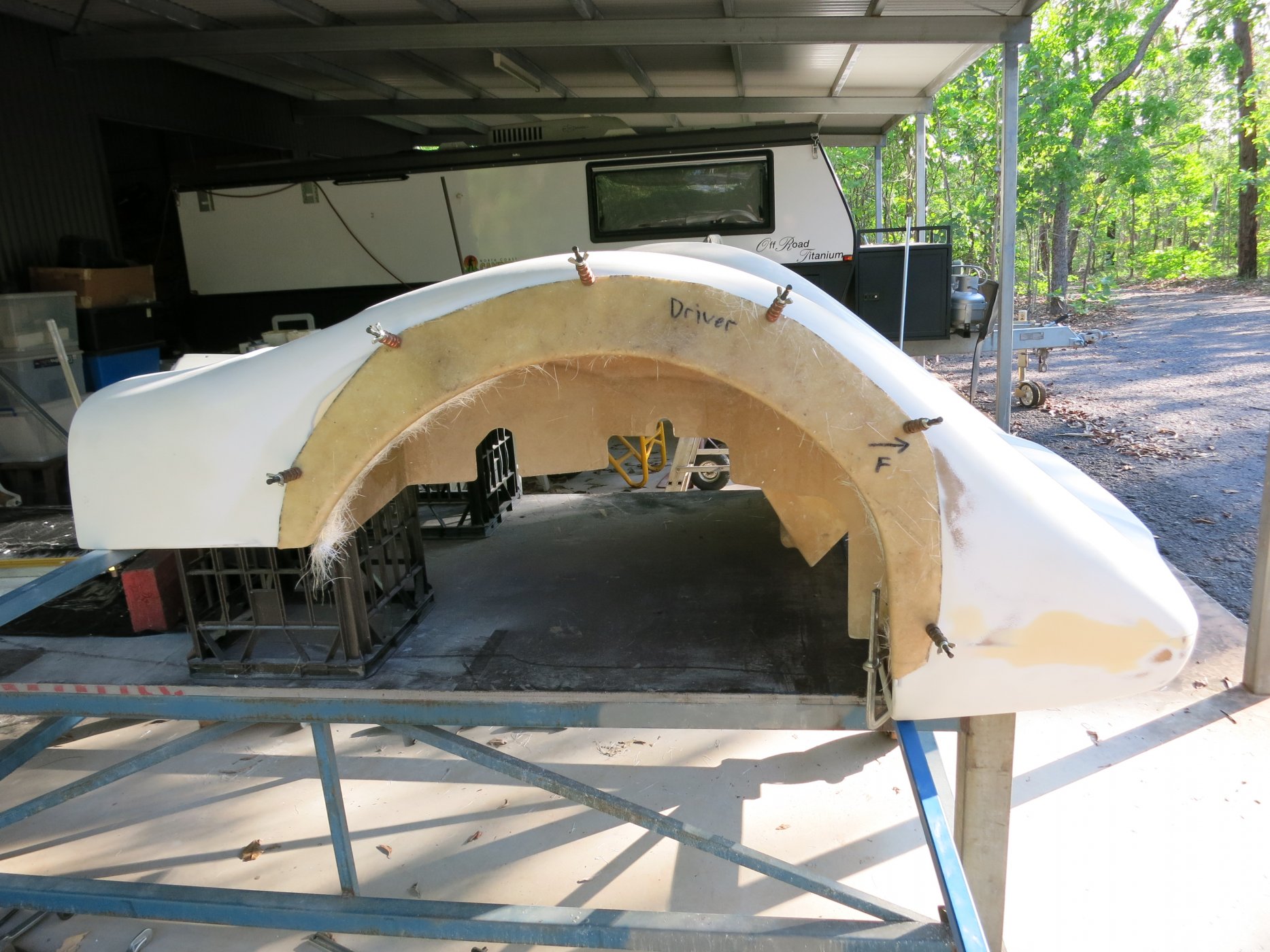

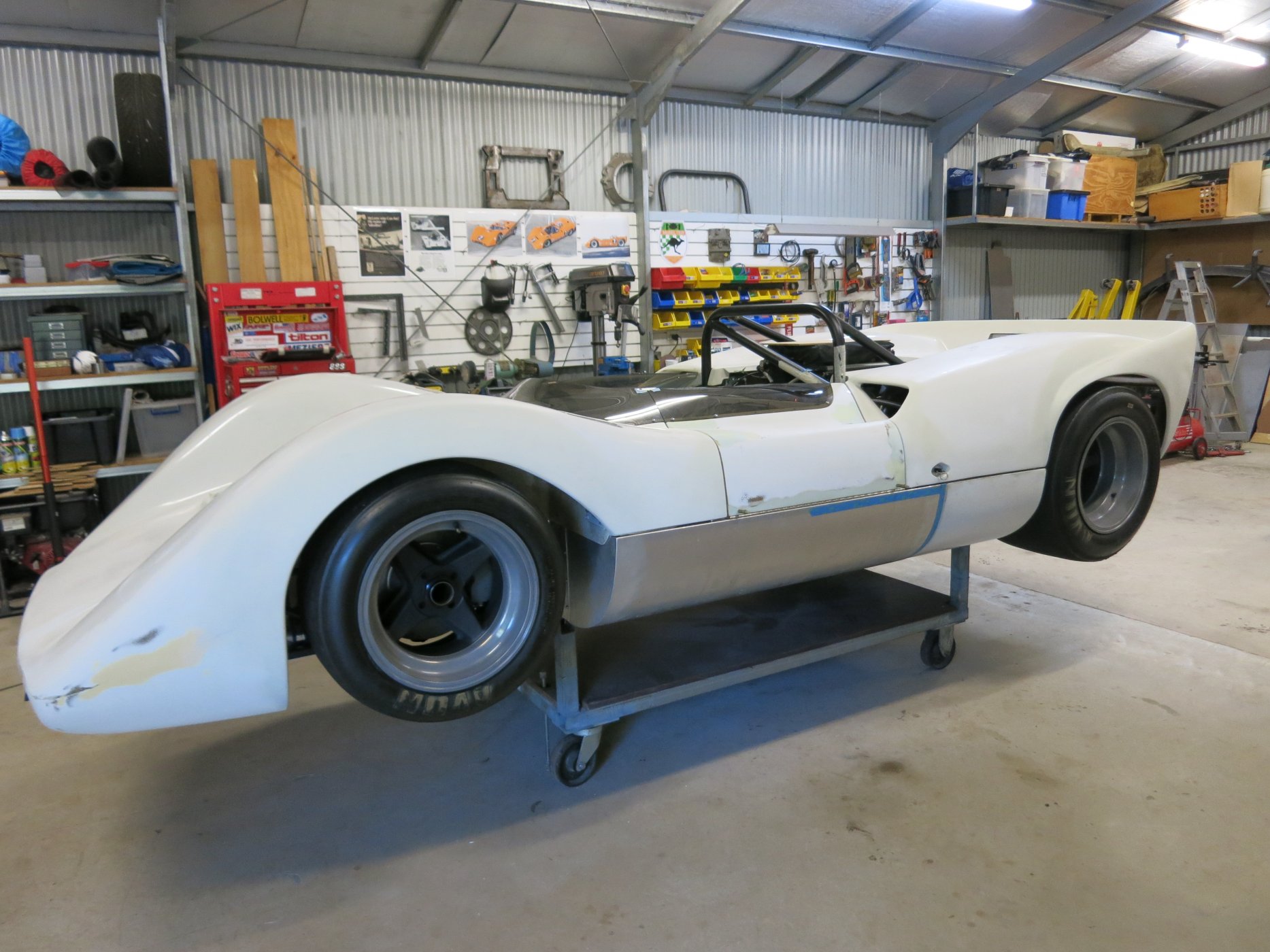

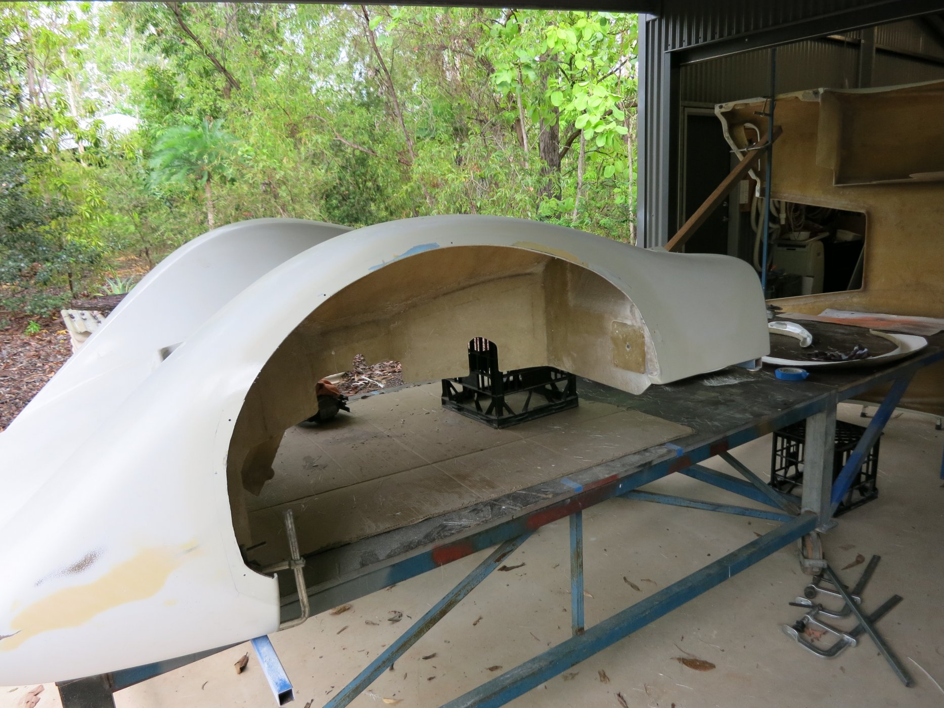

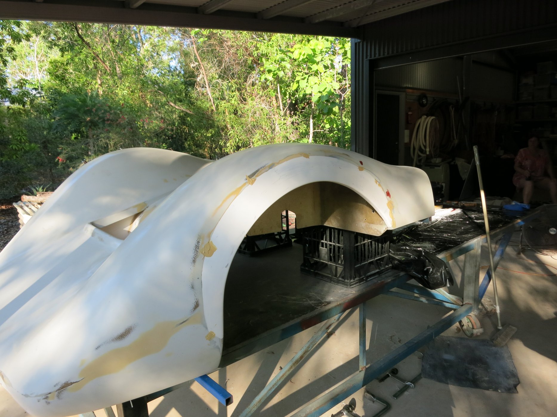

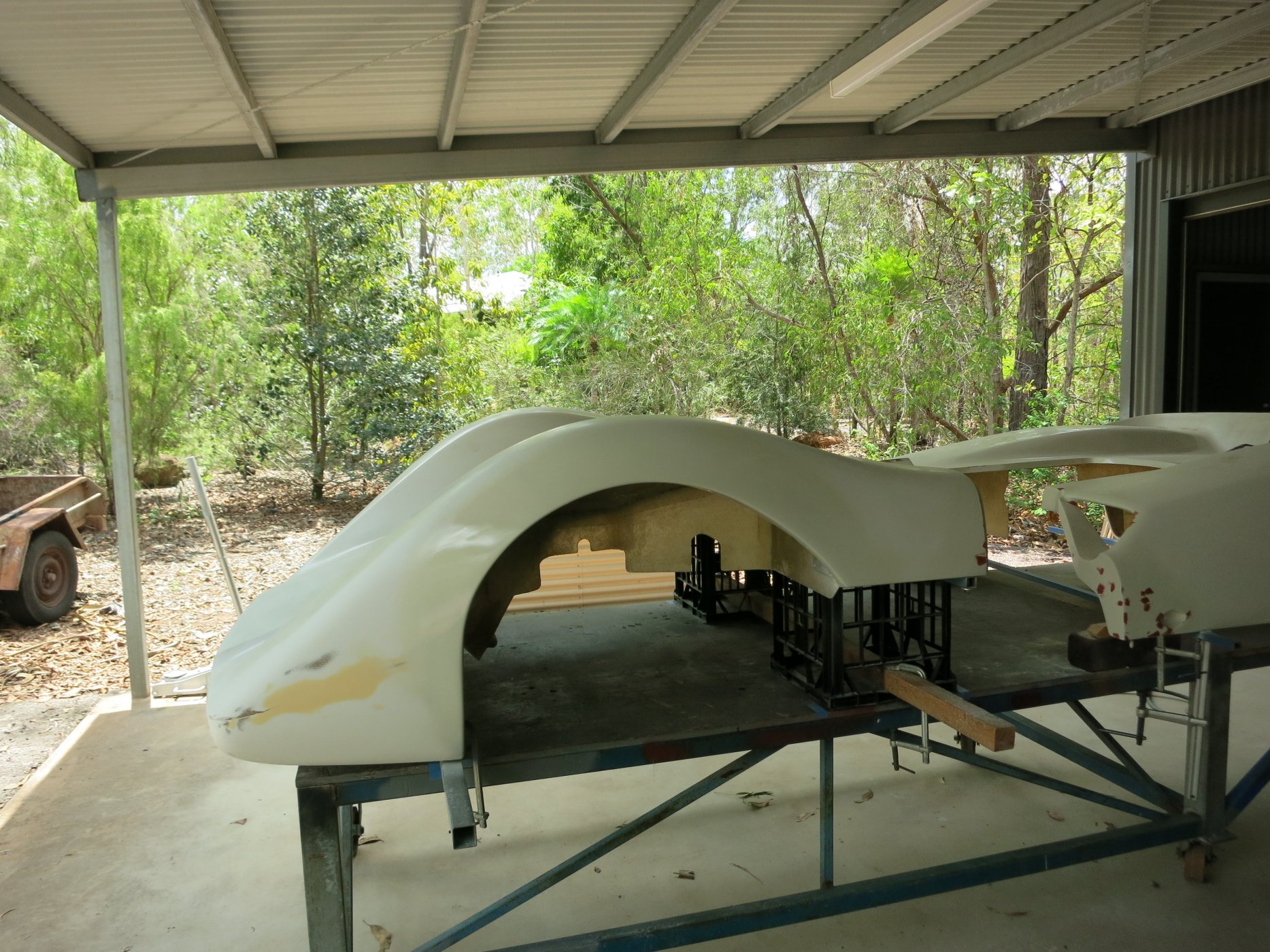

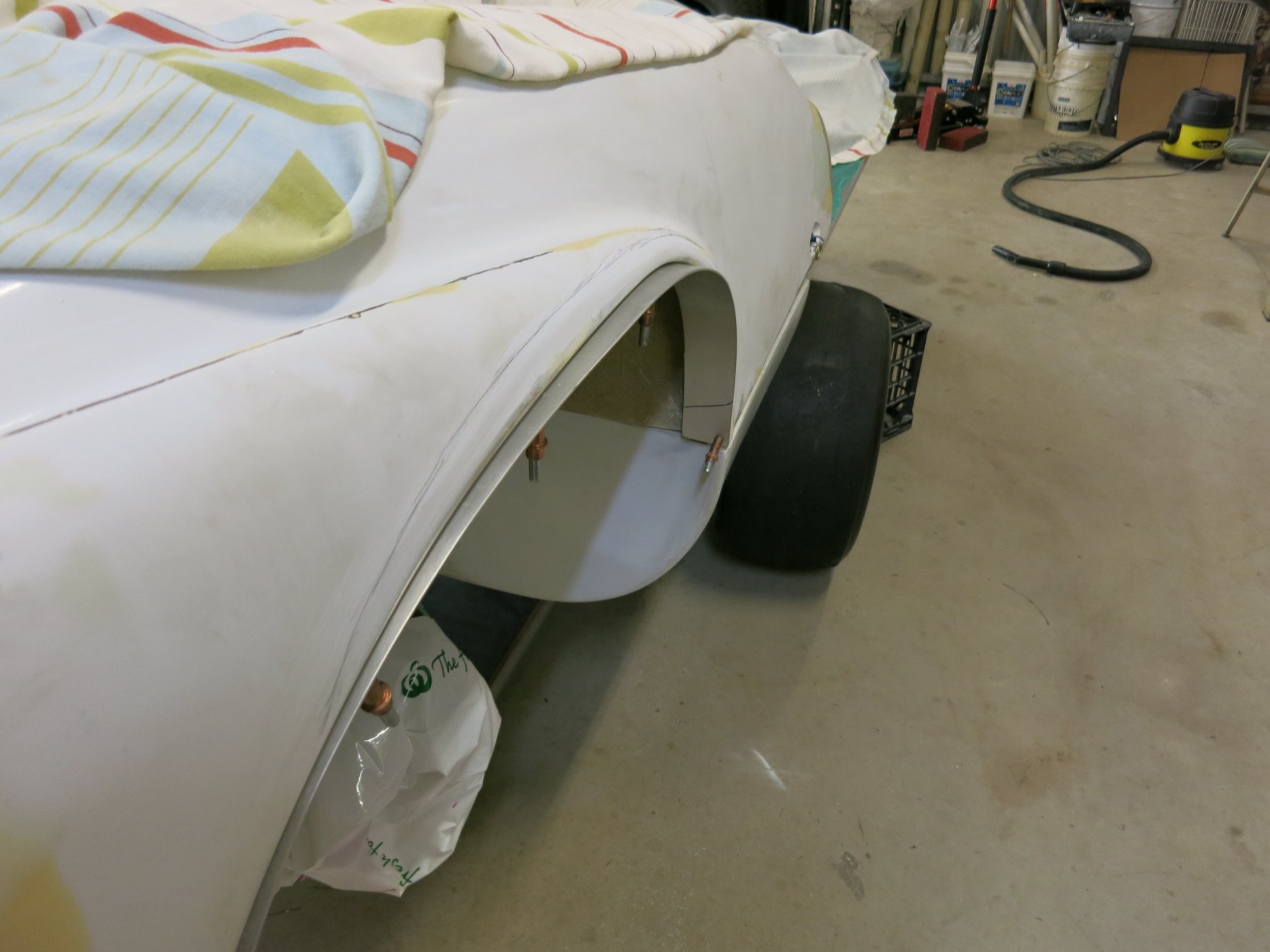

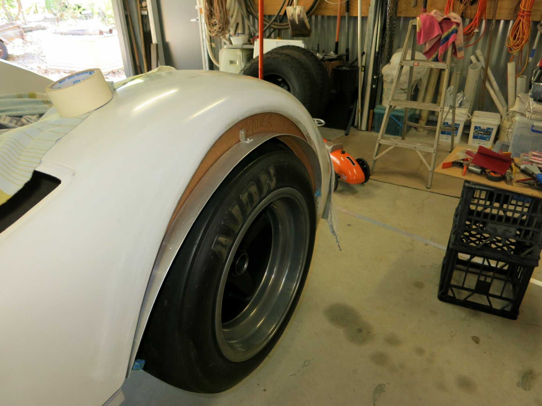

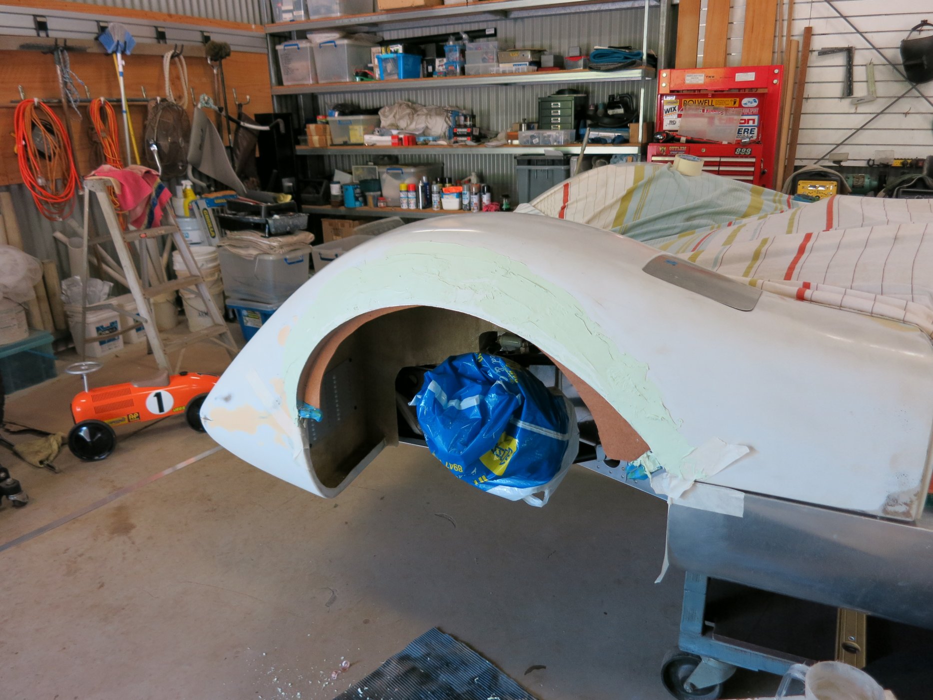

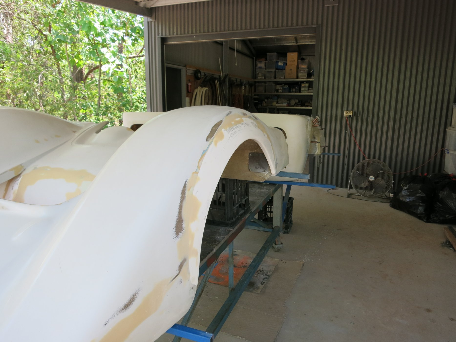

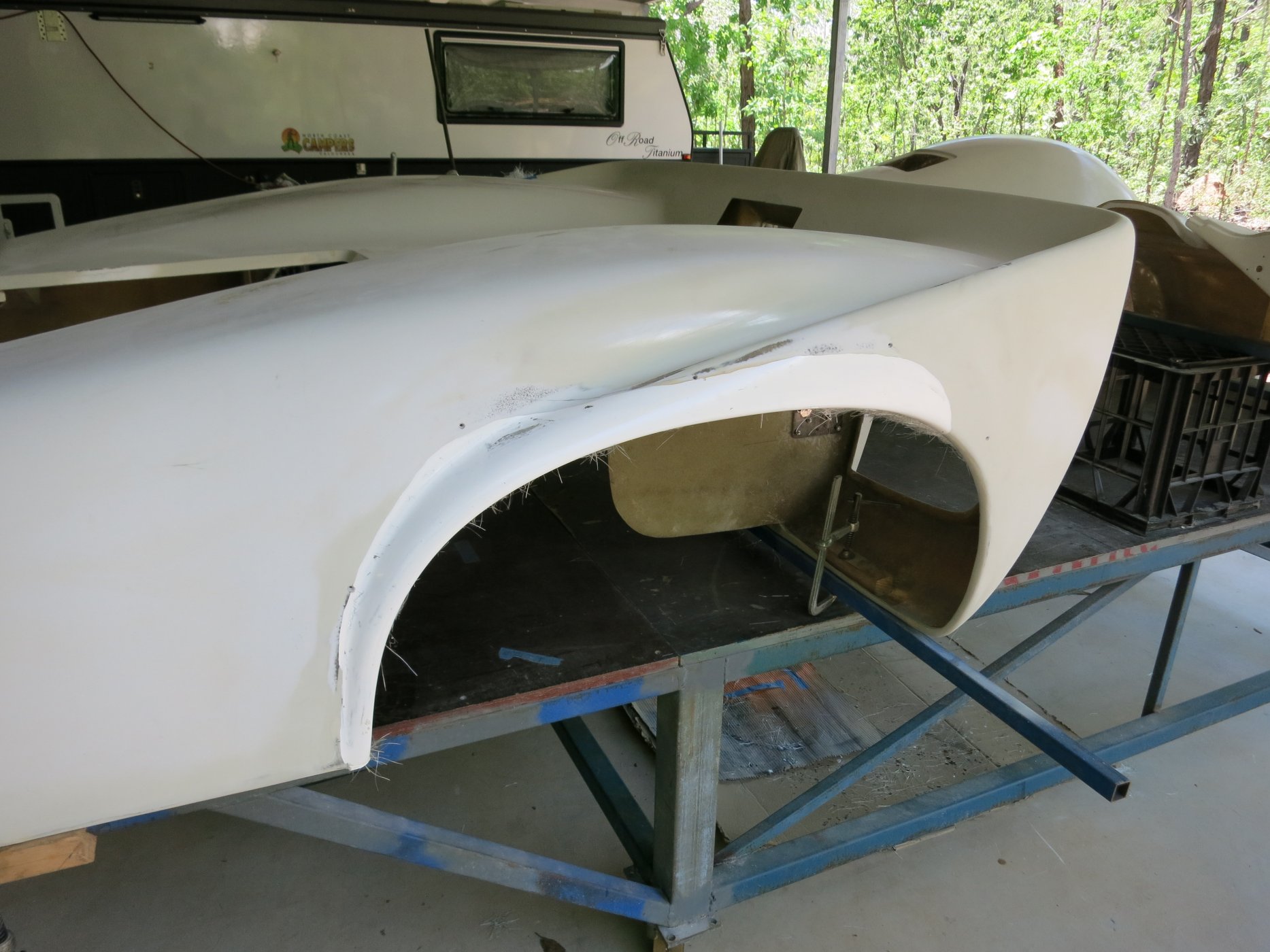

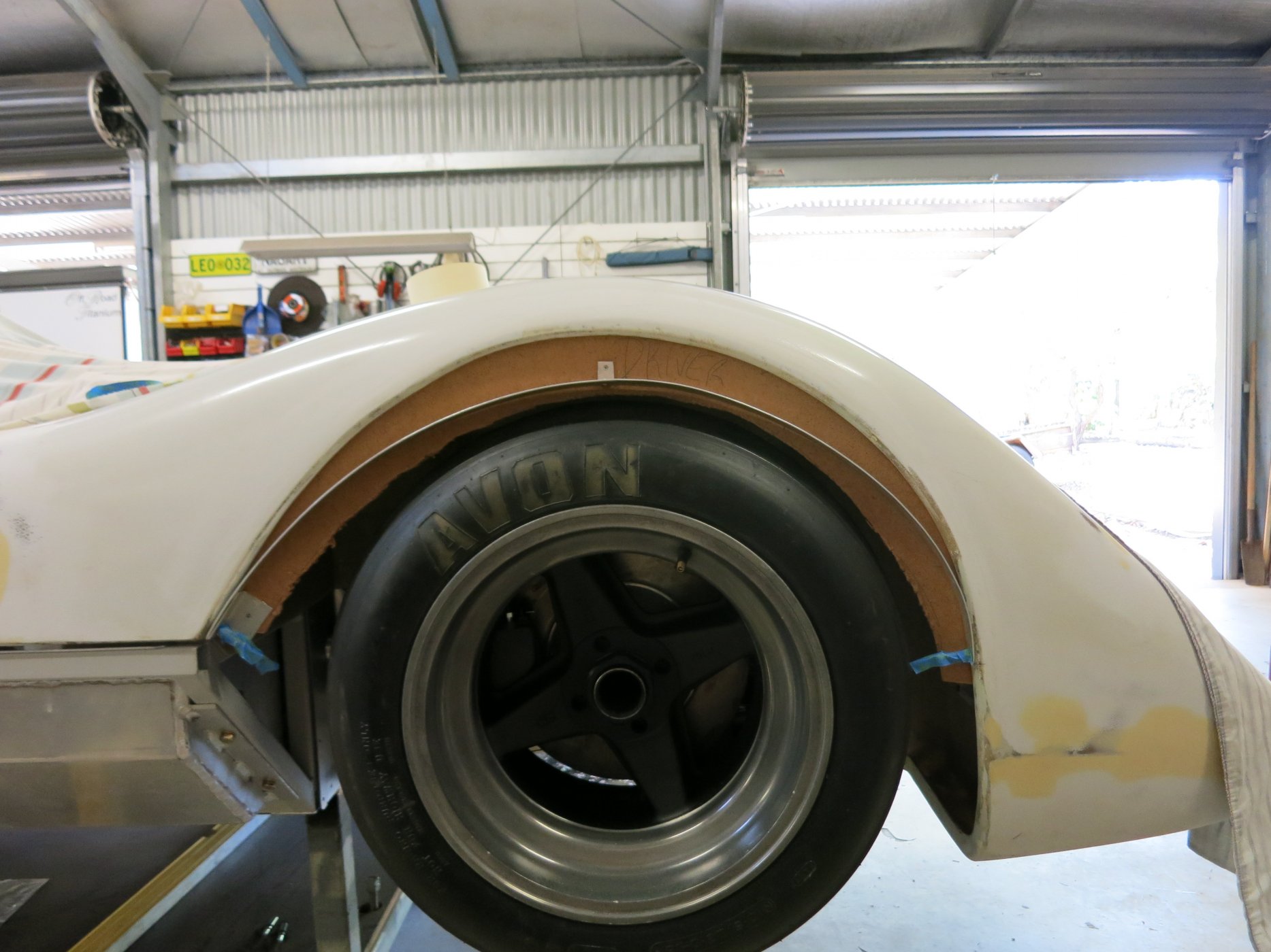

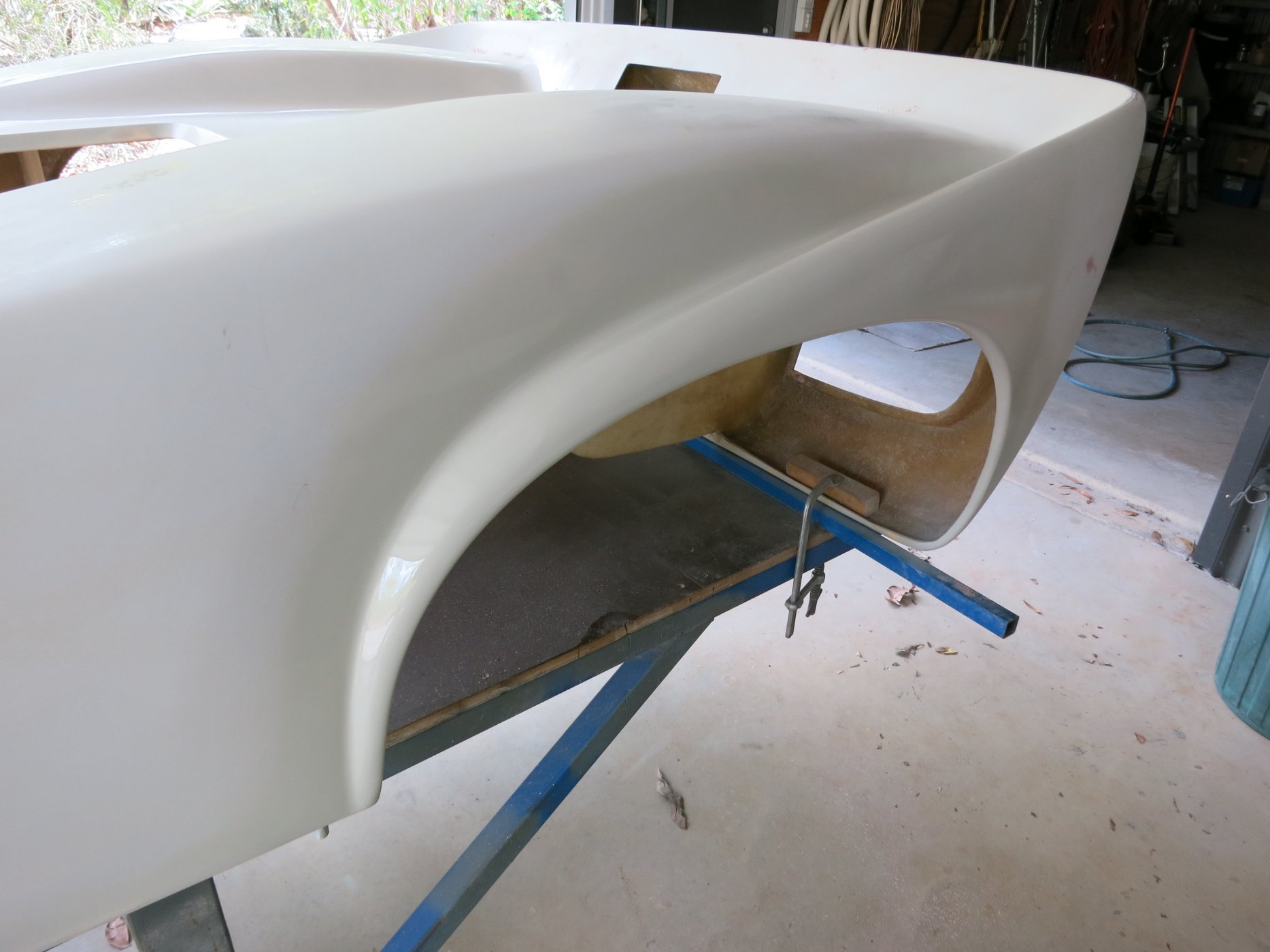

Hi all, It's been a while, but work always takes priority. I have decided to alter the body work. When you look at the original M6B body work, the front guards have a huge gap above the wheels, I checked lots of old photos and they all have it.
So, I decided to alter mine to close that gap. Also, because I am using wider rear tyres, the opening there didn't quite cover either.

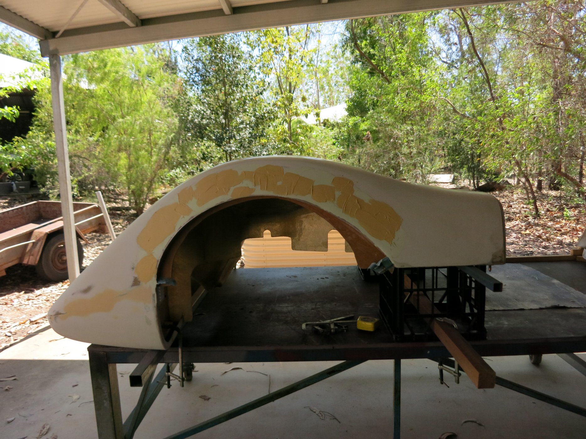

I mocked them up with bog, and took a mould off them.

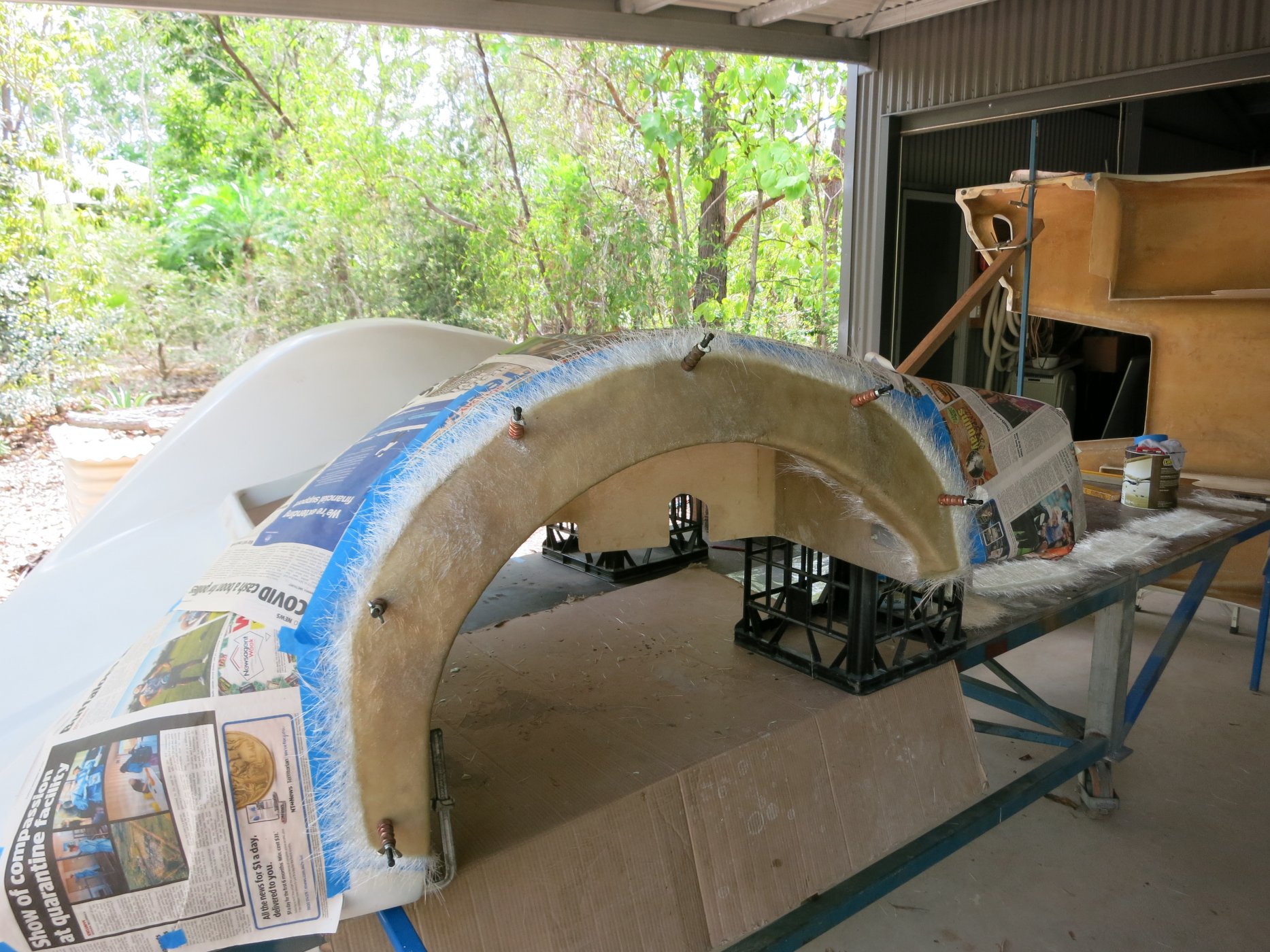

Then cut the original guards away, and glass up the new mould shape, They came out okay I think.

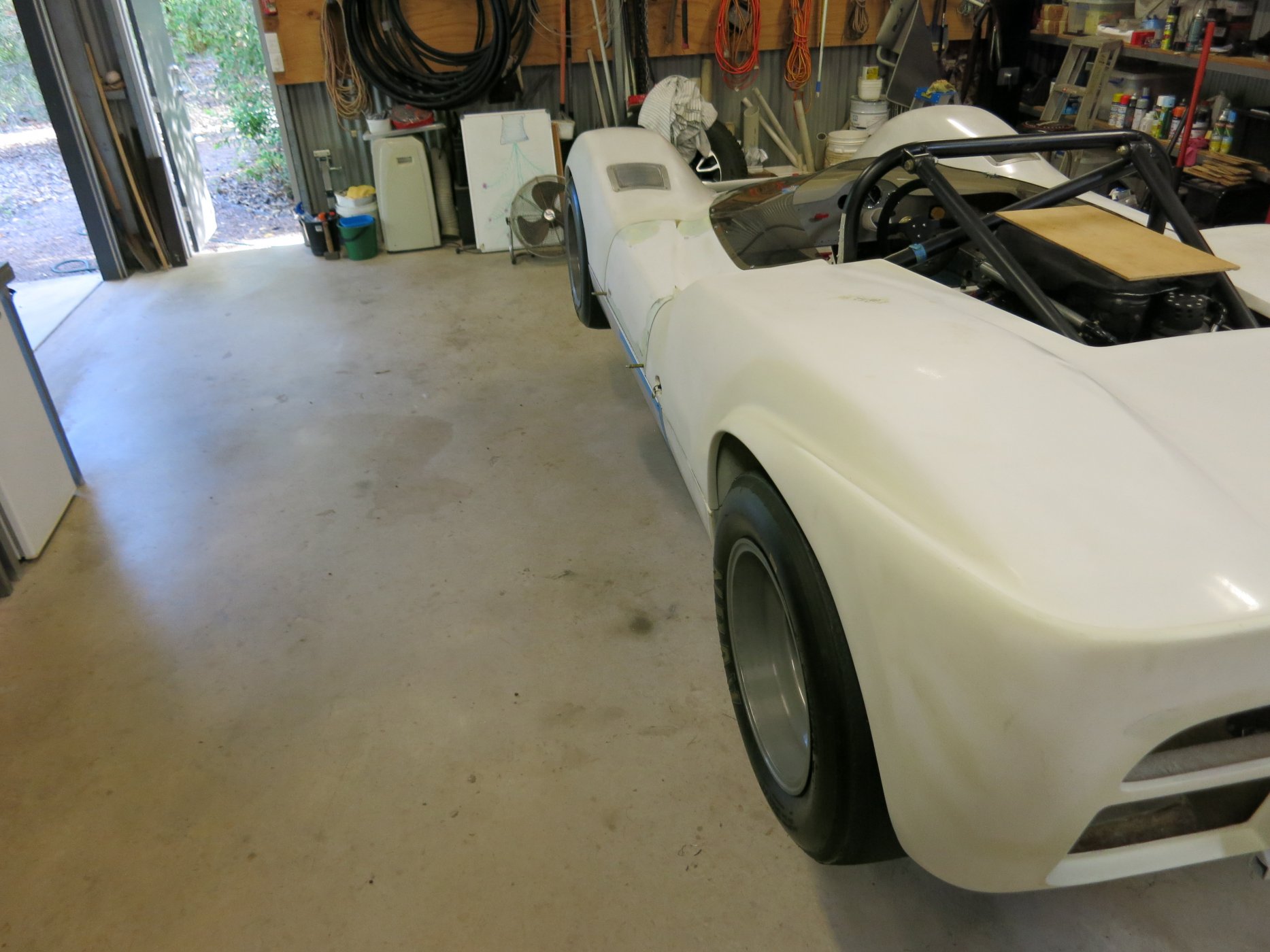

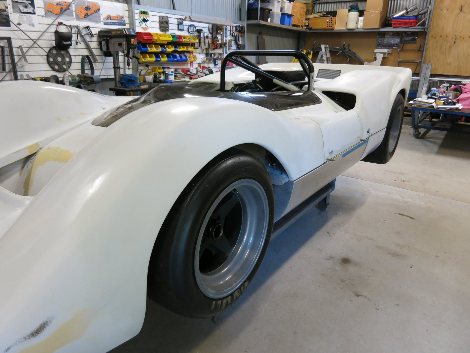

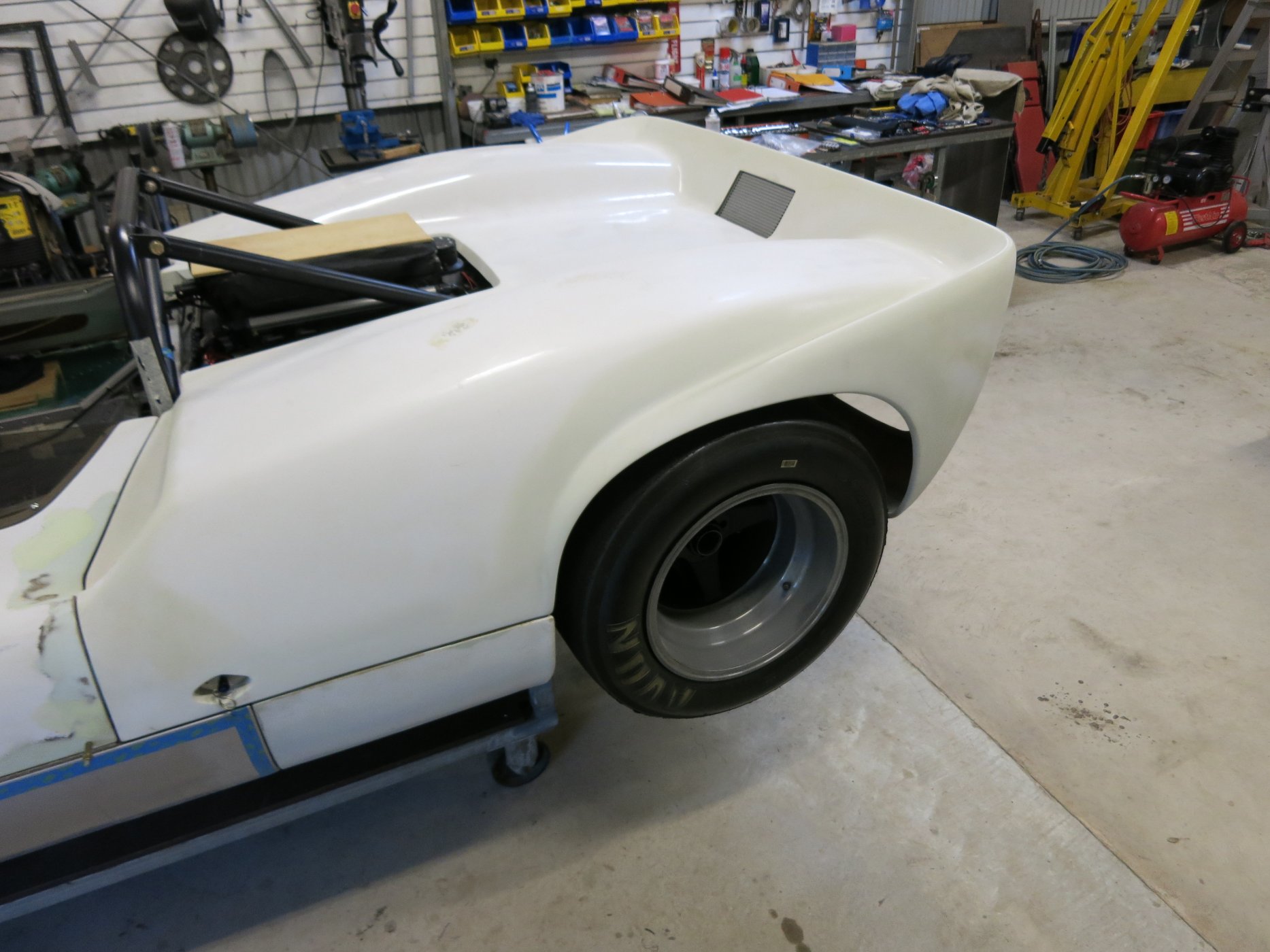

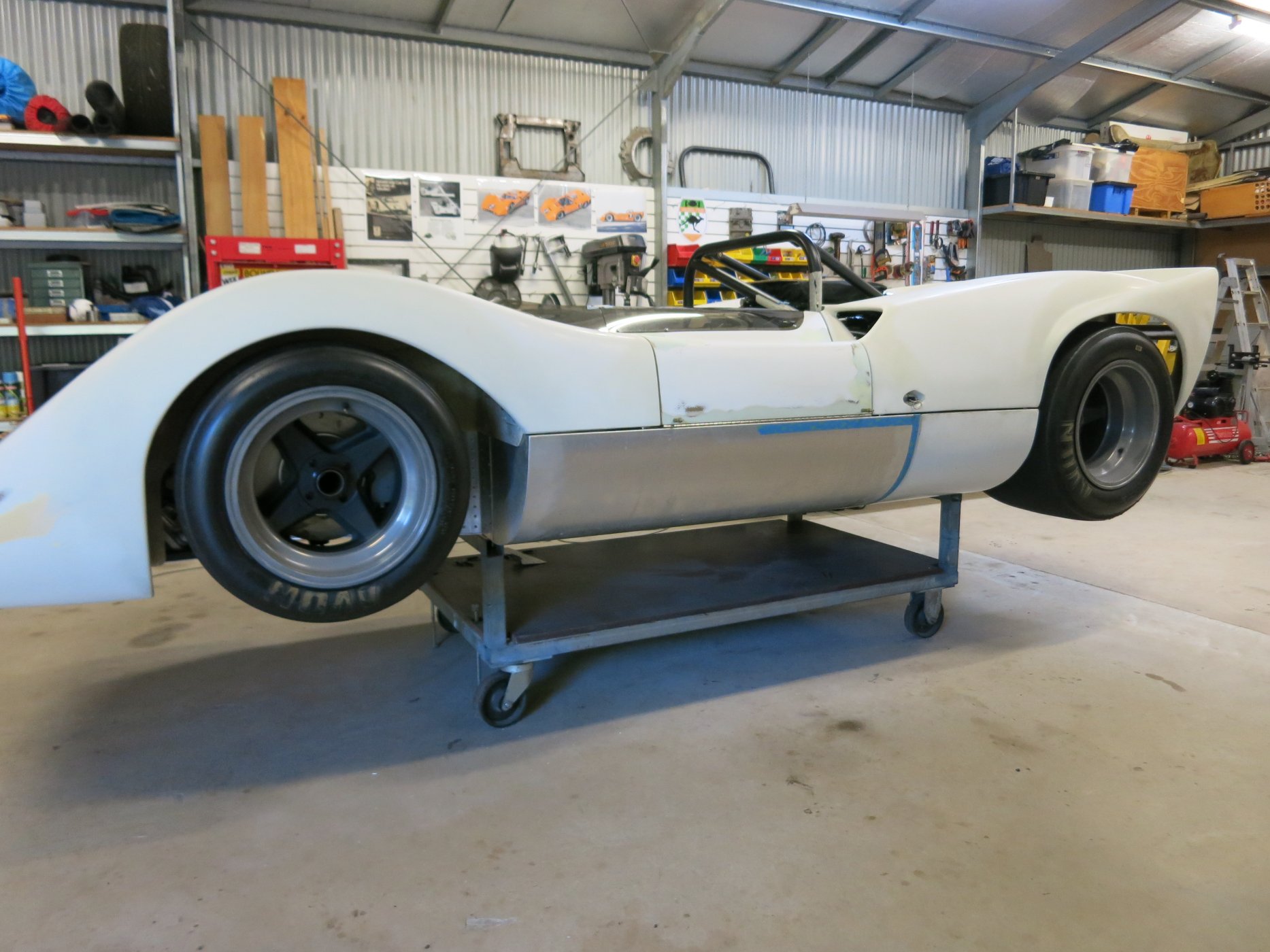

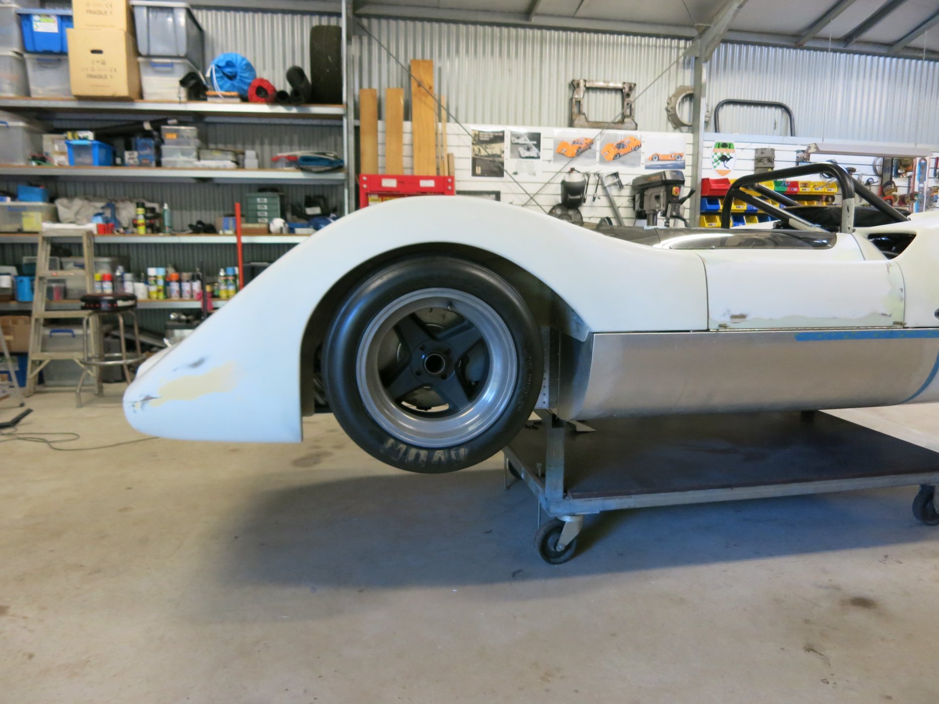

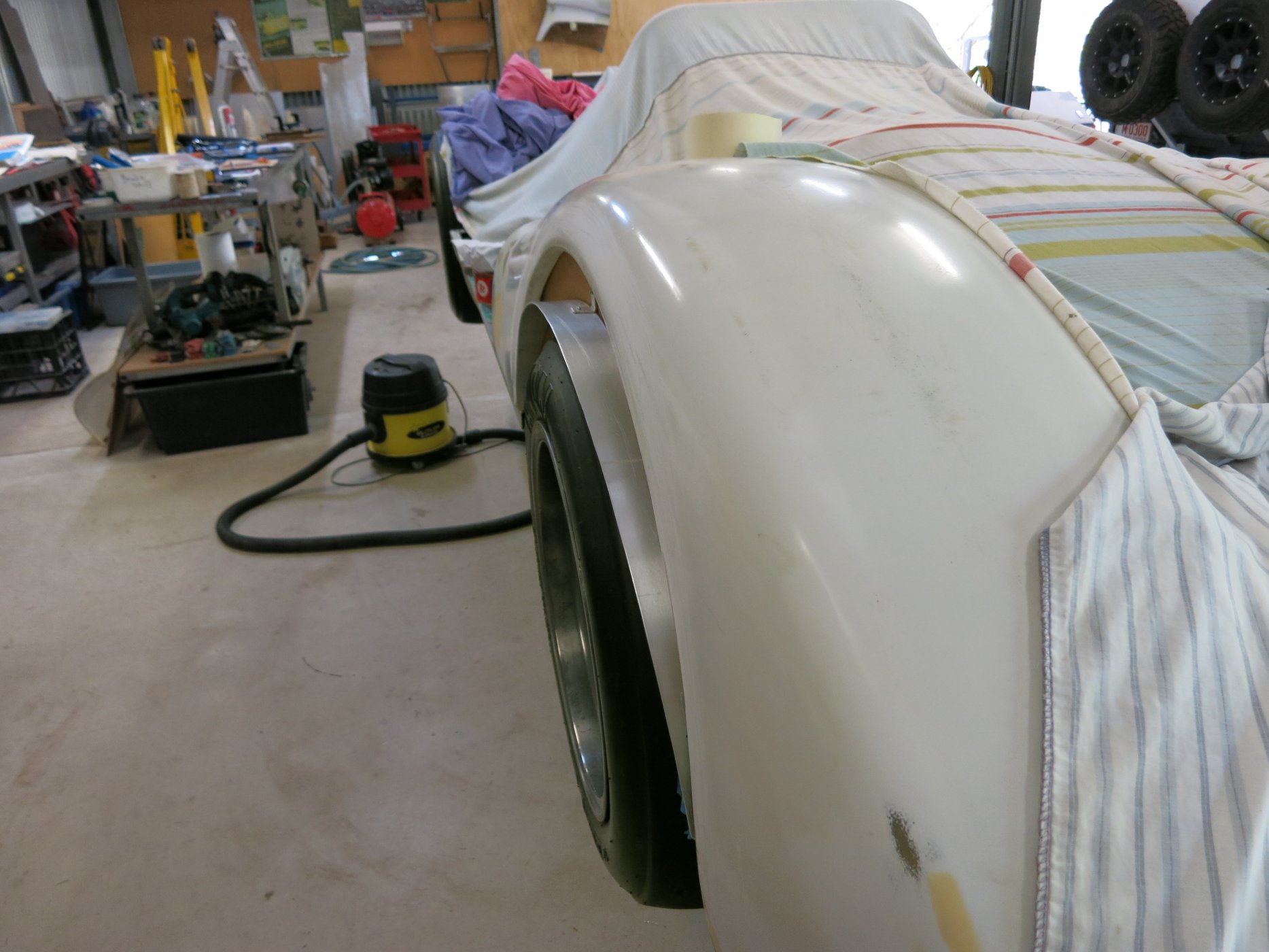

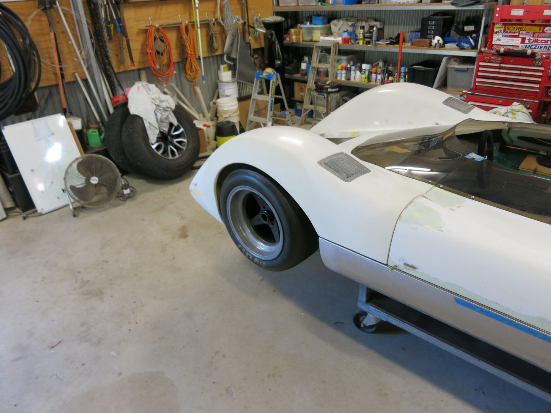

Here's the finished product. I was worried the front guards would look too bulky, But I think they look right.
