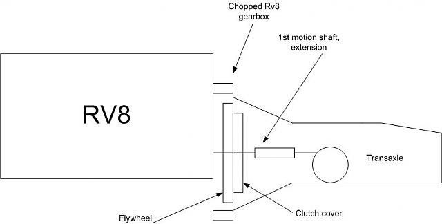

Hi all,
I have now got my pile of parts together as follows:
Rover v8 engine
Rover flywheel
Rover clutch cover & 10.5" driven plate
Various rover gearboxes to supply ali bolt pattern and 1st motion shaft.
Audi transaxle
Audi clutch cover & 240mm driven plate
The rover clutch is larger but looks like it will fit in the transaxle, the flywheel will however not so what I am proposing is:
Chop front off RV8 bellhousing to accomadate Flywheel and machine flat.
1/4 steel plate bolted across this and drilled to suit Audi bolt pattern
Recover splined centre from Audi clutch, machine RV8 1st motion shaft and make a first motion shaft extension to use RV8 clutch.
Extend standard audi clutch actuator to suit.
Can anyone see any issues with extending the 1st motion shaft by 2", I will sleeve so its and interference fit on the existing item and stays true.
Cheers Mark

Well Mark,
In the absence of anyone else stepping up to this one, here's my opinion.....
There's no reason I can see that it won't work. Two things I'd watch though.
First, will the extra 2 inches place the motor too far forward, or the driveshafts too far back? Maybe you will have to fudge both a little to make it work.
Second, welding up the input shaft should be OK so long as it is done properly by a really good guy who knows what he is doing and is used to doing these sorts of things. Of course you could do it yourself on the nothing-to-lose theory and it may well be OK. I have seen several dubious looking welded input shafts that have worked just fine!
The engineering purists here will probably disagree but IMHO it will be 100% successful if done properly.
By way of anecdote, my old TR7V8 had welded and shortened axles, no problems whatsoever, but the guy I got to do them insisted on doing the shortening as well as the welding. Always guarantees all his work and never has a failure. If he didn't like it and couldn't guarantee it he wouldn't do it.
As a further anecdote, I have several forged steel latches on some equipment that I own. They are subject to abuse and severe vibration and will break regularly. Because of the cost of new ones, I cajoled him to weld them up even though he refused to guarantee them! Over the following years none of the welded items have rebroken! This is the sort of guy you are looking for!
Hope that gives you something to go on....

Thanks for the replies, this is indeed a nothing to lose approach but it does seem to have some advantages to me.
Transaxle remains standard
RV8 clutch/spigot etc remains standard
I must admit Fred having pored over you notes on both this and Locost builders although highly impressed was put off with the sheer amount of work involved and cost.
As you have pointed out Russ, the weak point will be the spigot adaptor, I am starting off with a pretty weedy looking input shaft on the transaxle, at least the RV8 has a bit more meat. I am concerned that it will turn off like a carrot.
The rational on a 1/4" steel plate was simply that it will be thin, I was going to try multiple bolts into the RV8 housing but may try and track down a bit of thicker ali, undecided at present so I am going to stare at the first motion shaft a little more and cringe !
As for fitting length, I,m going to build a car around the engine/box so it does not matter, will probally solid mount so this will increase bell housing rigitity anyway.

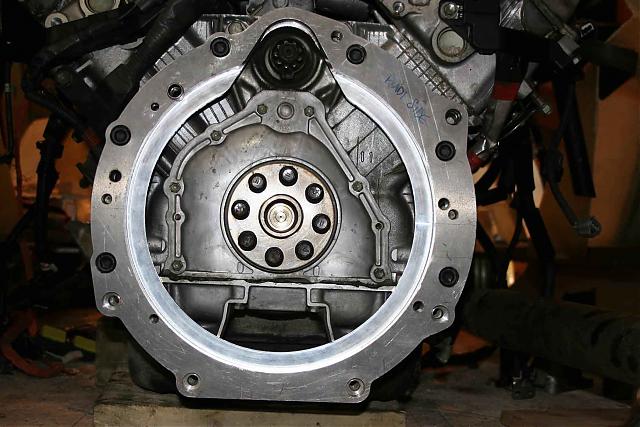

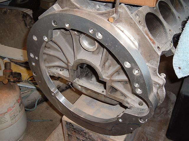

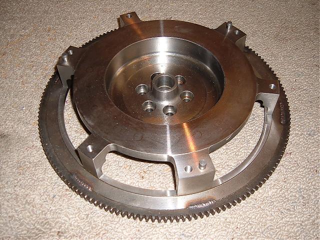

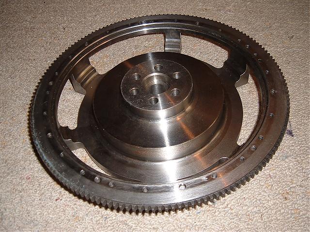

Why not try it this way, I know it cost a bit more but once the adptor ring and fly wheel are made, you are then using a standard gearbox, starter motor and a standard Rover Auto ring gear. Also by careful set up the standard Audi fork and release bearing is also utilized. If you look carefully at the adaptor ring on the dummy block and the set back of the ring gear on the fly wheel, you will notice that the fing gear runs in a recess in that adaptor. Thus the standard components make it easy for future maintenance. I have used a standard Toyota diesel high pressure plate with something like 2800psi on a performance Kevlar clutch plate. Assembly of the whole unit is straight forward and 100% accurate.

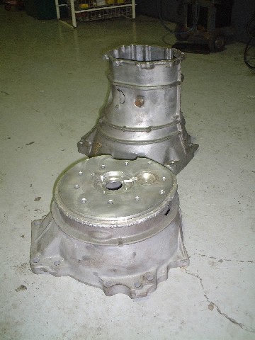

If you are planing on modifying the case this the approach I have taken so if it helps all the best.
It was an MX5 That I turbo charged and the owner kept braking gearboxs.400hp at the wheels does that.
I put an RX7 ser 6 box in but the issue was the same as you have.
I had no bell housing for the engine that we had selected but we had a case incorporating the bell housing.
The ser 6 box has a bolt of b/housing.
After a lot of measuring I cut and milled the case to suit the plate with machine recesses to accept the new box.
The trick to line it all up was I made a mounting plate with holes for the b/housing dowel pins to locate on and I bolted it down on the mill.
Using the digital read out I found centre of the front bearing hole I then drilled a hole in the mounting plate that it was attached to.
I made a bar that was the diameter of the hole in the new section going to be welded on this was bolted to the mounting plate with a dowel bolt.
This is so when I cut the case you don’t lose your datum, after the conversion plate was made it dropped straight over the bar orientated and welded.
Gave it a lick on the mill and it work fine.
I did not have to extend shafts fortunately.

Question for Russell, and hopefully not really too much drift.
Your flywheel looks a lot lighter than mine, what does it weigh?
Seems this thread may become THE internet source on Rover/Audi adaptions :D
Fred W B

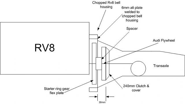

Hi Chaps, Many many thanks for the useful advise, and very useful pictures above, I,m going the Kiwi Ka/Fred W B way but without the expense.
240mm clutch on Audi flywheel, maybe get a turbo clutch as rated at 220bhp but I,m tight so will see if what I have survives !
The flywheel is rear weighted so I will have to machine off the back and rebalance; this then goes on to a spacer that will bolt to the ring gear flex plate.
Chop Rv8 bell housing and weld a plate on then drill and cut to fit Audi transaxle.
Job done…. Okay now to put it into practice. So you will have to wait a few weeks for pictures, 18 months for it to run in anger !
Regards Mark

Mark,
I like to keep things light, but I would tend to go 8mm or even 10mm for that flat ally plate. But that's just me, someone with an engineering background may confirm that 6mm is fine. I would be worried though about only 6mm of thread in the ally although you could always helicoil or similar.
Edit. Why the f/w spacer?
Hi Russ,
6mm was just off the top of my head, I will see what plate is available and select something that looks suitable.
The flywheel spacer is just to achieve the 30mm from gearbox side of the bell housing adaptor to the front of the flywheel as shown, without it the the flywheel would be at least 10mm short of the first motion shaft.
If I am lucky when I machine the back of the audi flywheel I may be able to make most of this gap up so it may be irrelevent but without a substantial plate I will not be able to tap and stud the adapator ring facing the engine so will need to clear bolt heads with the starter ring.
Regards Mark
That 30mm Flywheel Spacer is asking for trouble with a capital 'T' if the bolts go thru flywheel/spacer /flexplate, unless you are using dowels as well , even with dowels over the 30mm distance some movement could take place.
Much safer to make a one piece flywheel with the correct offsets to accept clutch then bolt / fit the ring gear to it than have the triple sandwich set up you have above.
Jac Mac
Russ Noble
Mark, I'd have to agree with Jac Mac (I just hate that!) No spacer!
This things turning into a bit of a mission. I think you should revisit chopping the Audi bellhousing. If you were to take 30mm off the front of it and weld it to your ally plate. No spacer, everything sits where it should.
If you consider doing that, then why not use a bit more Rover bellhousing and shorten the Audi further and weld it all up. Then you can use Rover f/w, clutch, and 10.5" Audi splined plate. It wouldn't matter if you could only get a 10" plate. Get your clutch man to check his plate specification catalogue.
Yea, go back to first principles.
The trick in my approach to get a thinner spacer plate was that I moved the ring gear towards the engine (12 mm in my case). You could do this using the standard rover flywheel if you machine the engine side of it where it attaches to the crank by say 4 mm and also offsetting the ring gear on the flywheel 8 mm, and welding it into place.
The only other mod is to relieve the casting webs on the back of the engine slightly.
Then do what Russ suggests to get the cases to match, at the right distance to get the gearbox input shaft to engage in the crank. If you use the rover clutch, you would have to make some plan with a spacer to get to the release bearing from the audi clutch lifting fork.
If you want to use the audi style clutch i would think you would need a custom basket, as the standard audi clutch setup need the big recess in the clutch side of the flywheel.
I dont have my detailed notes here, otherwise I could give you the exact positions I used. I can send you the proper drawing of my flywheel, if that would help? - Mail me if so.
You don't have to weld the two cases directly together, it may be easier to go cut rover bell / plate / cut Audi case, with welds each side of a thickish plate spacer - but then you have to buy the plate.
Or maybe use just as much of the rover bell as you need to clear the ring gear, and weld on an alloy plate drilled to accept the Audi trans. If you fit the plate up inside the cut off rover bell and welded the open corner you could make it look okay..

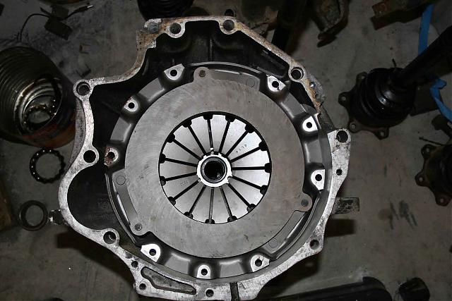

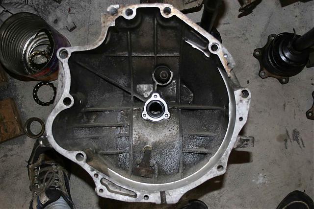

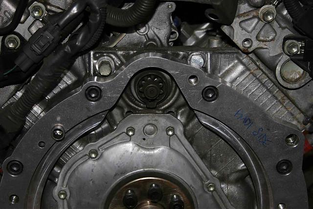

Hi Mark, Here is how i did mine it's a Audi 016 to a Lexus v8 the small adaptor was made to fit in the end of the crank, it has the bearing numbers on it if you look closely, a 3m skim was taken out of the Audi, this allowed a mazda mk4 clutch with Audi centre spline to fit, hope it helps.Adaptor is 20mm, but is cut away to allow the flywheel to sit inside, so reducing the total length.
Regards
Lambo
