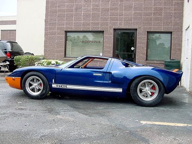

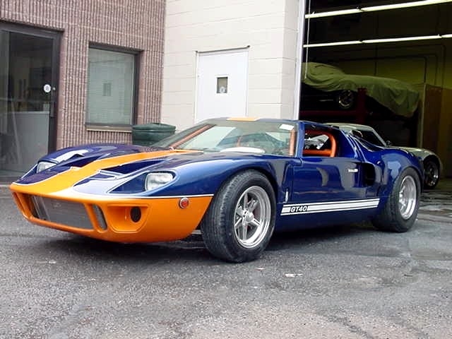

Here are a few pictures of Marks GT-40 as of this morning. Mark is away until Friaday so I thoght I would post a few pictures for him. Rich where did you get that picture of the spider section?

Big foot you should see this thing in person, the picture dont do it justice
Hot damn, that looks freaking awesome!! I love the white stripe. It really makes the orange and blue pop!! Now, something has to be done with those wheels. The need to be either all black like Ron's car, or have black centers and polished lips.

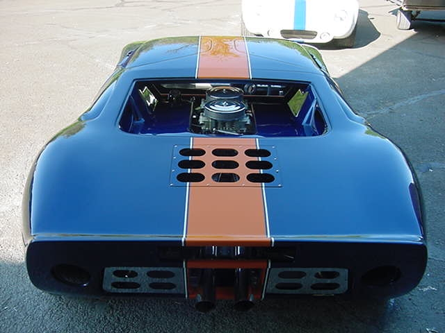

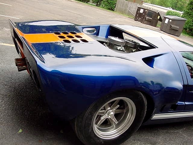

I'm just back from Dublin and have a marathon day planned for tomorrow getting ready for Carlisle. Here are a couple more pictures:
