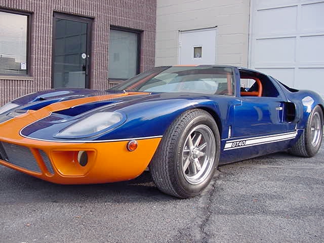

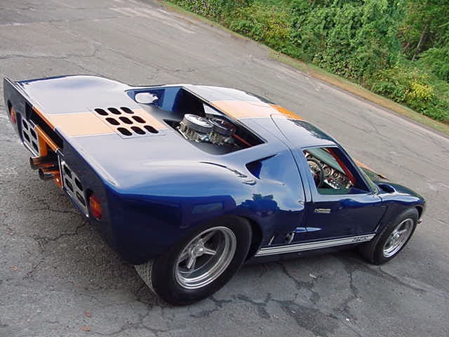

Mark I thought you might like these pictures I took of your GT-40 today. I had to move it outside to get another cobra in the paint booth and when I looked back the light was just perfect.
I'm going to miss this one when it leaves:cry:
Ron

Looks fantastic Ron. One question, what's up with the little black marks on the rear quarters behind the tires...... Oh...right...our little secret man. Just get em cleaned up before Mark comes by.;)
Lookin good....................:thumbsup:
Is this like Deja Vu all over again?
Gorgeous car... But it seems like some posts may be missing....
