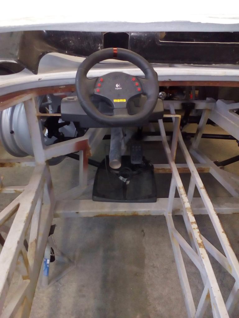

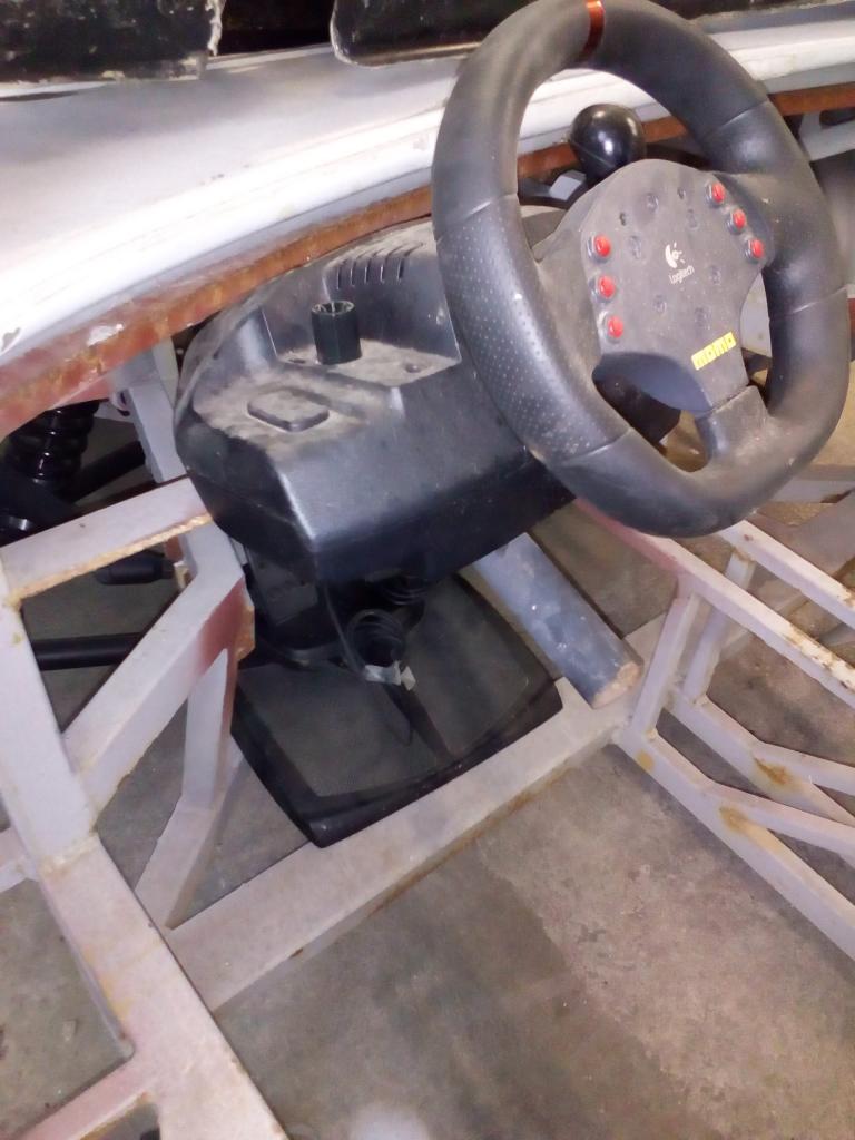

I was finishing another project lately and had college graduation so didnt have much time for the Ford. I did however install this awesome steering wheel and pedal box. Dont mind the USB cables sticking out of them. Im testing the fly-by-wire mode.

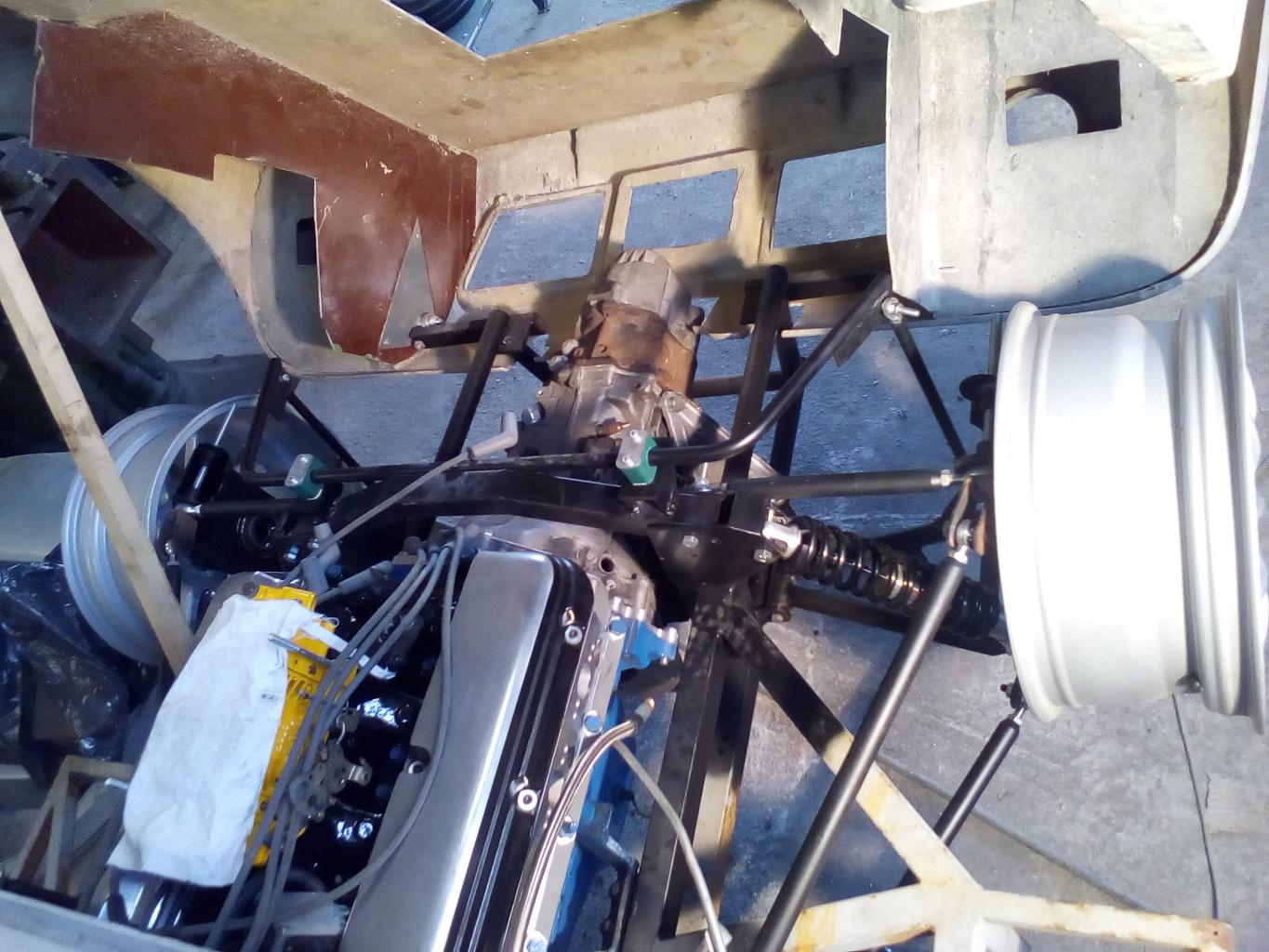

I'll start with what I did. The rear suspension is complete except for two things. I need to relocate the upper shock pickup points further down and I have to redo the clevis pins (cheers Terry). I finished with all the stainless spacers and got everything nice and level and straight and parallel.
Today I moved to the front end. After fiddling for a while with the front shock pickup points I decided to scrap that idea completely. Instead I decided to install the shocks almost horizontally close to vehicle centerline. The force from the wishbone will be transferred to the aluminium crank bell via a titanium pushrod. The crank bell will in turn operate the shock. Sort of what can be seen in F1 cars. I made a CAD model of the crank bell and it is going on stress analysis tomorrow. Apart from the lower unsprung weight benefit, which is the main reason why I decided to go this route, the shock settings will be easier to adjust because of their position. Although much less relevant than the open suspension cars, the aerodynamics behind the rim will be smoother without that lump of a coil. As an added benefit, it will look mighty sexy :)

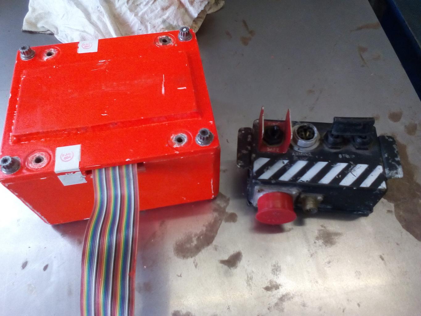

That black box is out of a Harrier. Initially I was planning to use a flight data recorder, but it is really complicated and almost impossible to read the data, especially the magnetic tape ones such as this. I will be using the case however but I'll have the cockpit voice recorder inside instead of the FDR.

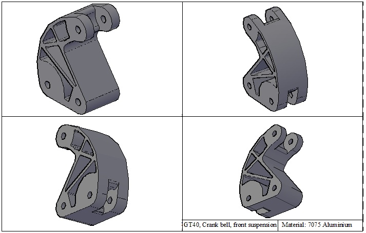

Anyways, I had my grandfather, a structural engineer, helped me out with the stress analysis. Turns out I still had some breathing room and took some more of the material off. I wasn't able to obtain 7075 aluminium in the needed dimensions so I went for 6082 T6 and made the calculations accordingly. I do have two questions though and any help would be much appreciated:
a) For analysis we used 12kN load from the pushrod and 8kN load from the shock. I remember reading somewhere that it's safe to assume 6 times the corner weight for the suspension load. This seem close enough?
b) I'm thinking about pressing brass tube inside the holes for the shock and pushrod bolts and using cylindrical roller bearing pressed into the hole where the crank bell mounts onto the chassis. Am I going the right way with this?

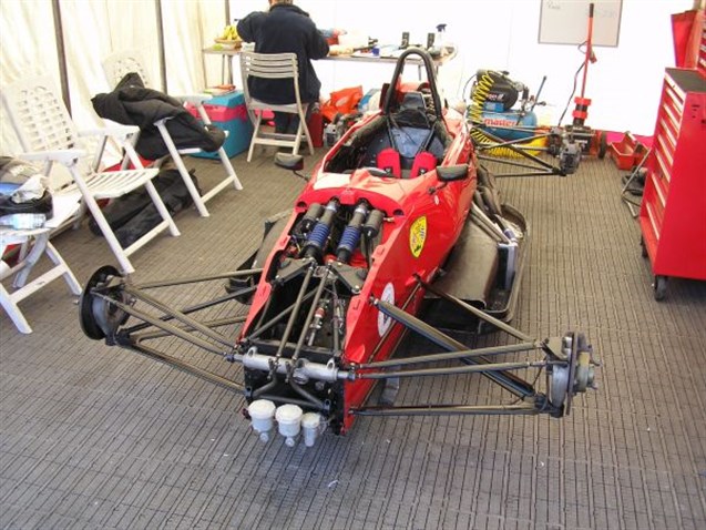

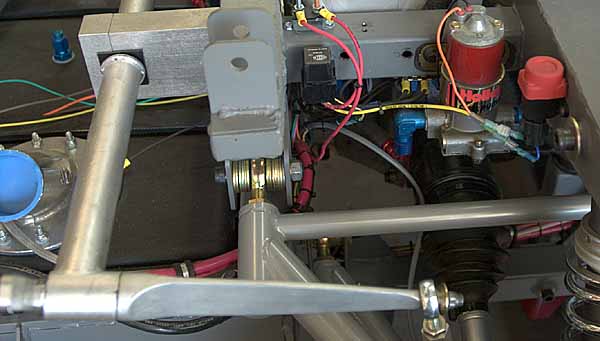

Go for it. Here is a pic of the front suspension on a Van Diemen Formula Ford race car. You can see how the bell cranks are linked to the anti roll bar. The operating rods are long on this car because of the lack of space near the pedals so the bar is at the front. You could use much shorter rods to link the bell cranks to the anti roll torsion bar.
In earlier cars the torsion bar was essentially a solid bar and rotateable blade type links were fitted into bushes in it. The other ends were then connected to the ends of the shocks. The blades could be rotated by the driver to control the anti roll stiffness. Pic attached

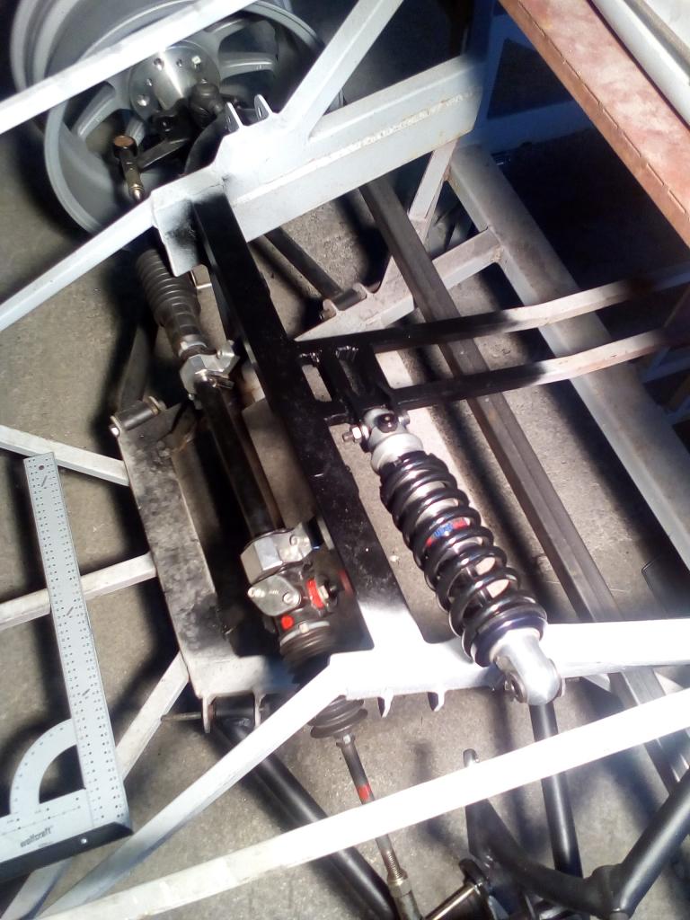

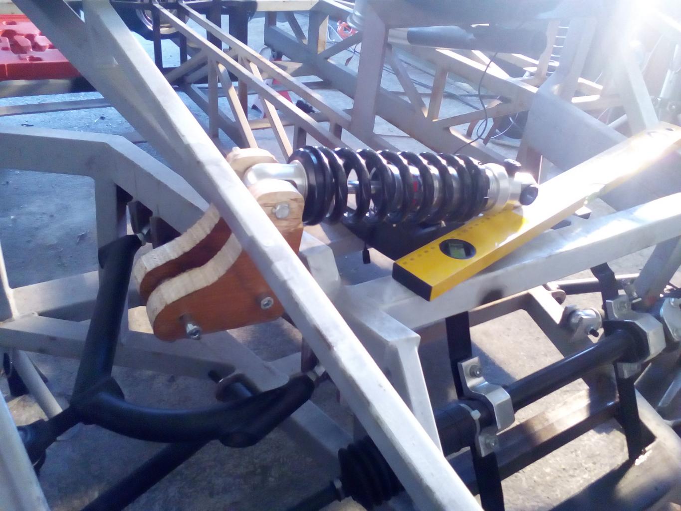

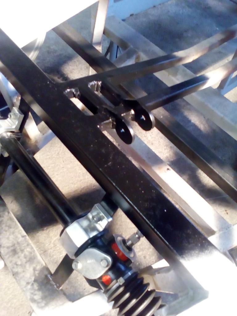

I made one set of brackets today and the lateral support for the shocks. The shocks will be tilted at some 20 degree angle. I'll measure the inclination once I install the rockers.

Will your feet, steering column and the pedals fit in there with the shock taking up that space?
I doubt my size 11 boats would fit!

It appears you understand (from previous posts) some of the loading of this kind of suspension on the framing. With that said, ensure the welds/guage of the two tubes connecting to the cross-bar are sufficient to take all the forces associated with the unsprung weight where the shocks mount. If you've still got the opportunity, I'd gusset the two 3/4" (?) square tubes to the main crossbar to ensure no issues down the road. Even though this small area of the frame has opposing forces at static ride, higher performance settings/events/dynamics may challenge this area for strength.
Hi Ian
The whole setup is actually above the foot well. The steering column also passes underneath the shocks so it's all good I think.
Terry, my thinking was that the shocks are operating in a close to horizontal plane and that I wouldn't need any additional reinforcement here other than the two crossbars I welded on there to avoid deformation caused by the roll. When you say gusset, do you mean weld plates on the top and bottom of those crossbars and the main crossbar? Or add additional tube between the two crossbars and a part of the chassis parallel to them (in the same direction as the shocks)?
