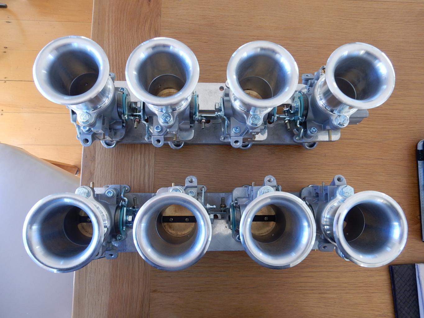

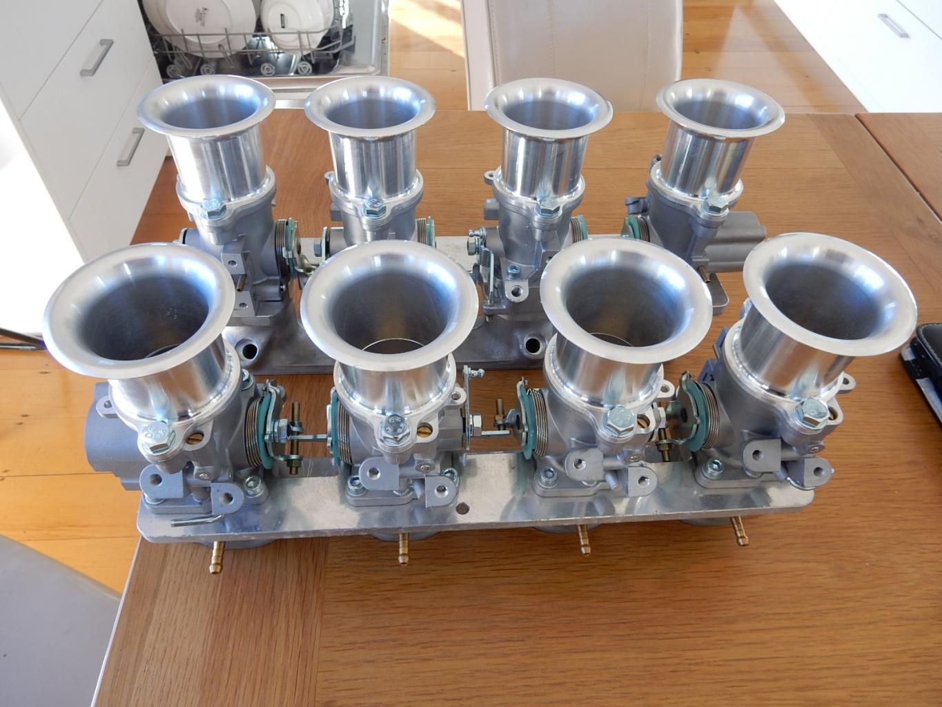

I have a confession to make;
Got carried away with `bling` some months ago and these arrived today. They will look good sitting on top...went this way because I did away with the factory stuff and computer so thought `what the heck` couple of more weeks work and they were done.
They will have to sit in their box for some months while I carry on with the rest.

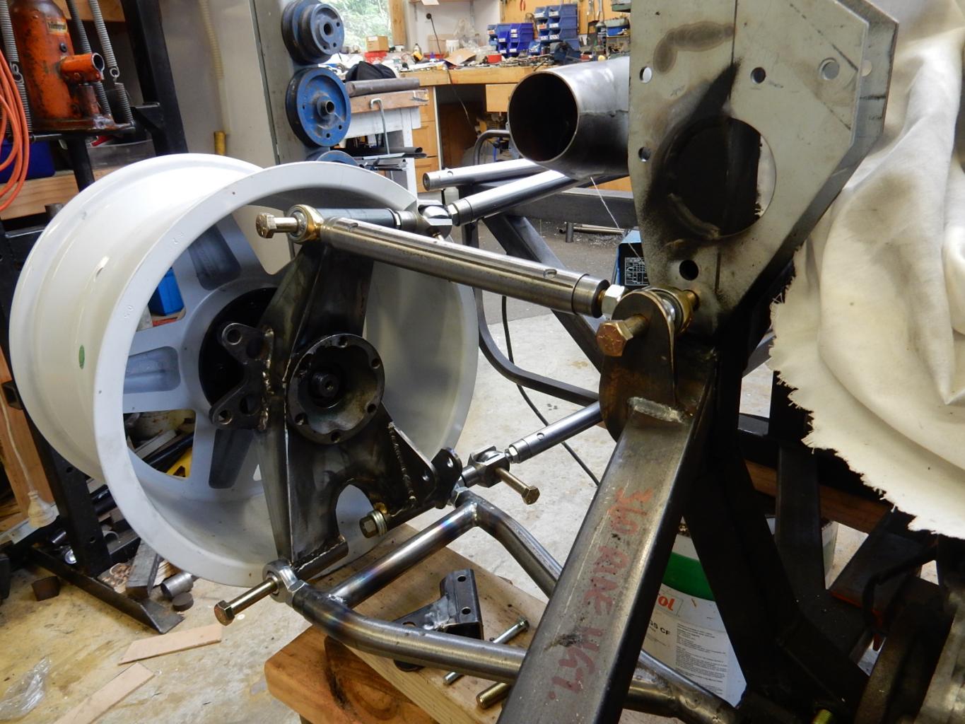

Today, all my calcs for the rear uprights were put to test when I pressed the new bearings in followed by the drive axels, all fitted like a dream..even the brake rotor hat cleared just nicely.

Looks like the dishwasher made a good job of them in that first pic Russell.

They look nice but its an unfortunate fact that that is the cheap bit. Its the computer and pump and injectors that cost the real money. That said a mate of mine put a Lexus V8 in his Land Cruiser and used a ECU that he got out of South Africa. Its the size of a cigarette packet, its self learning and was about $800NZ I can find out more info and a contact if you are interested. I have another mate who is using a "Megasquirt" on a Rover V8 but its proving to be a bit of mission.
Cheers Leon

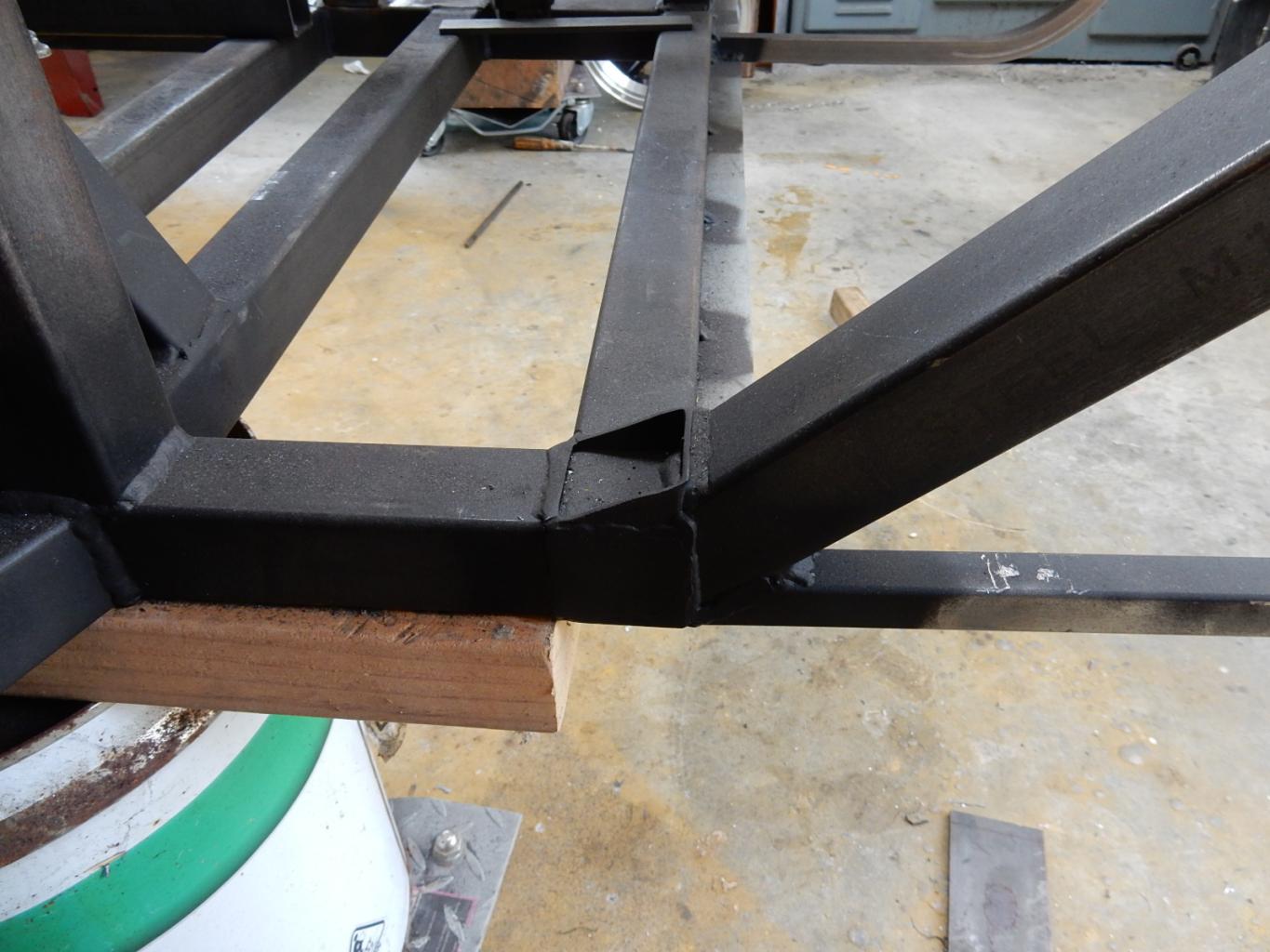

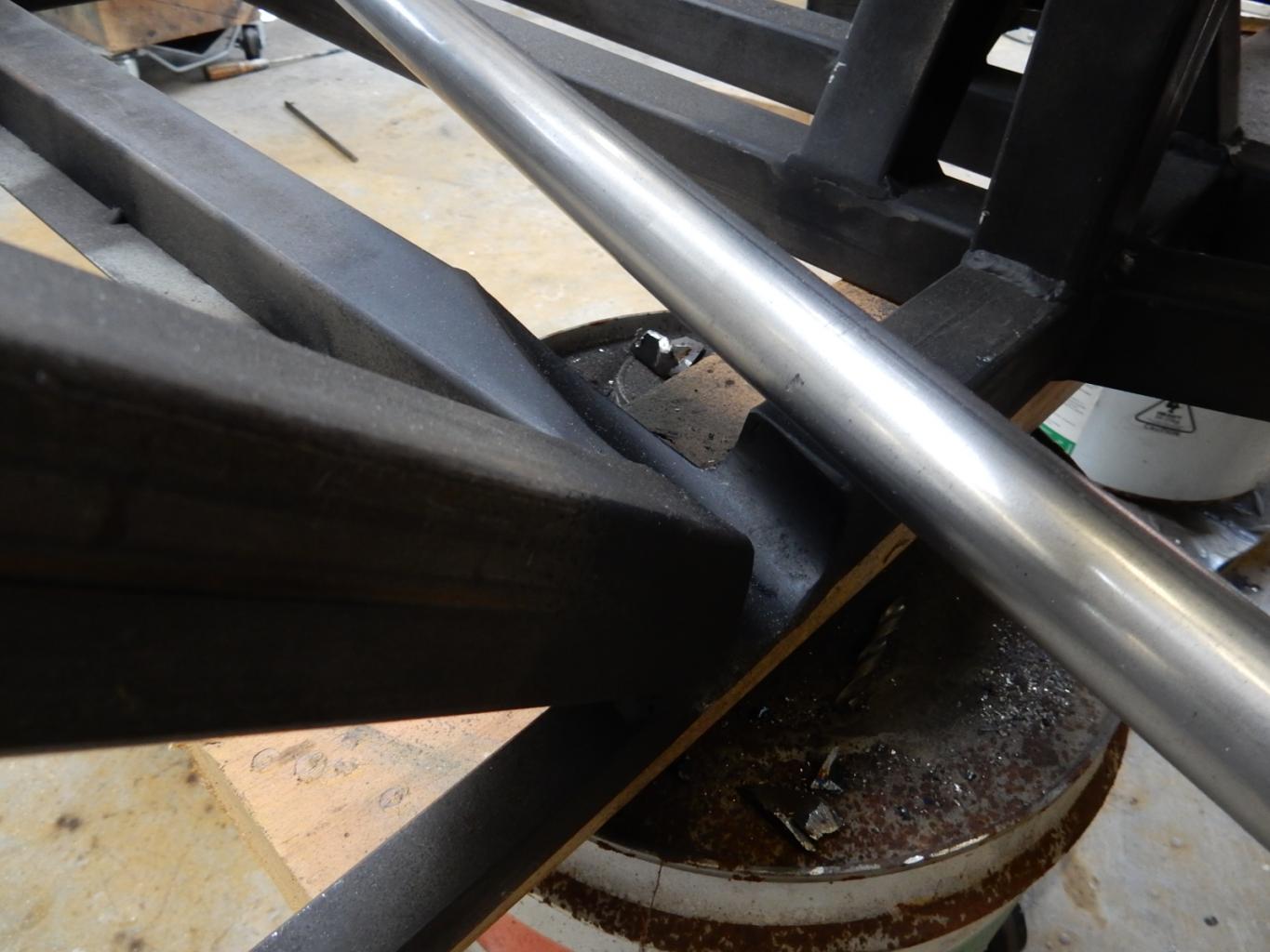

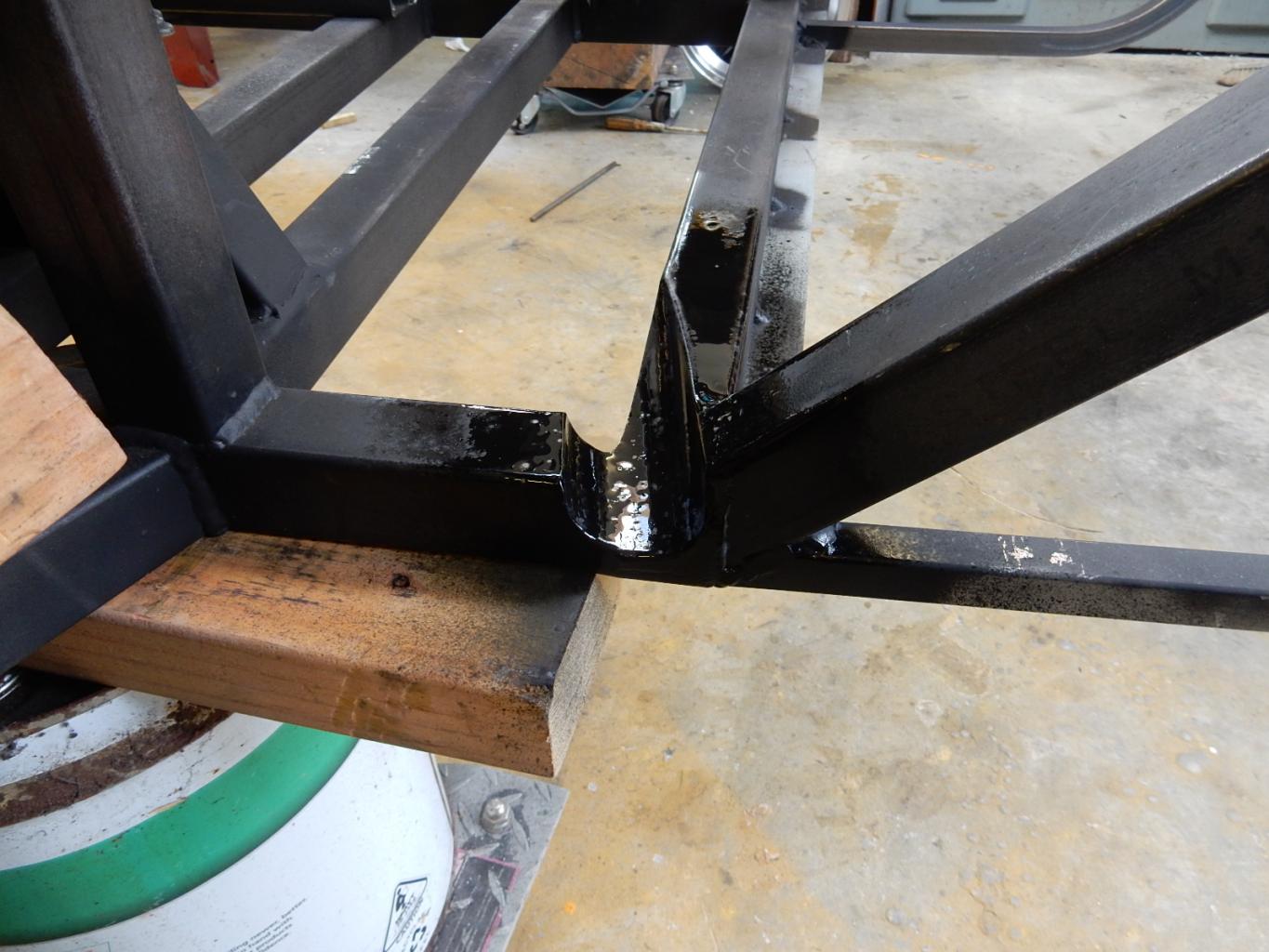

I have been setting up the rear suspension now that my uprights passed with flying colors, I think the chassis measurements that I built from were designed around very short / low uprights as the lower trailing arm fouled the bottom chassis rail. Mine are almost 300mm top to bottom giving a nice wide/deep span.
As luck would have it, it was at the junction of three chassis segments so spent some fun time line boring with a hole saw to clear a path, then lined it with some 3.5mm pipe cut to shape so as to not loose any strength. It all turned out looking quite original. I have also had to order longer wheel studs as these mags only allow the studs to protrude barely flush with the nut and that is not good enough for the road. Hopefully that`s the last of any chassis chopping that may be needed.

Hi Russell, I had to do the same with my RF GT40 because the ZF was wider than the Audi box they are designed for. It was not a structural issue at all. Your doing another great job as usual. Love following your site.
Regards, Udo.
Thanks Mike / Udo, just looking forward to putting the grinders away, very happy that there is no structural drama. Its time now to ensure that no brackets or what ever are missed out as I am looking at getting the chassis powder coated as I am not looking forward to sand blasting and painting in my shed again.

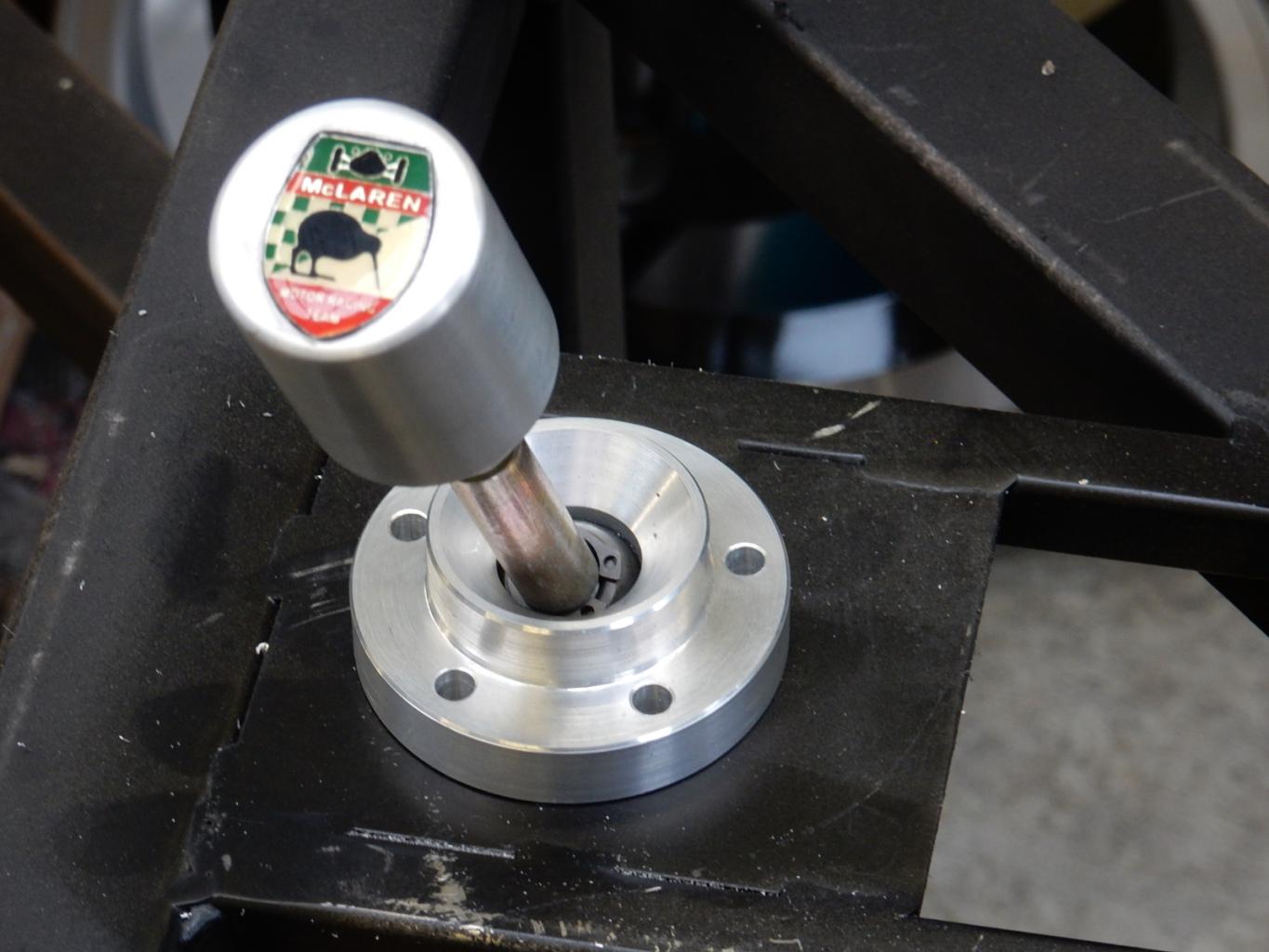

Now you have to admit, that`s a cool looking knob`.

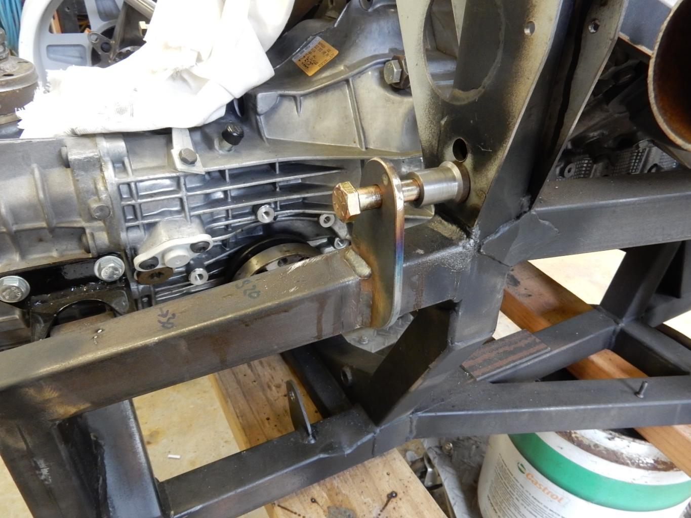

I was given some Mclaren lapel badges and I thought that with a little bit of machining and the dremmel, it would fit. I can get the gear change rod direct to the gearbox with one universal / mid bearing. Also added double shear to my rear upright inner mount whilst I wait for some bits to arrive.
