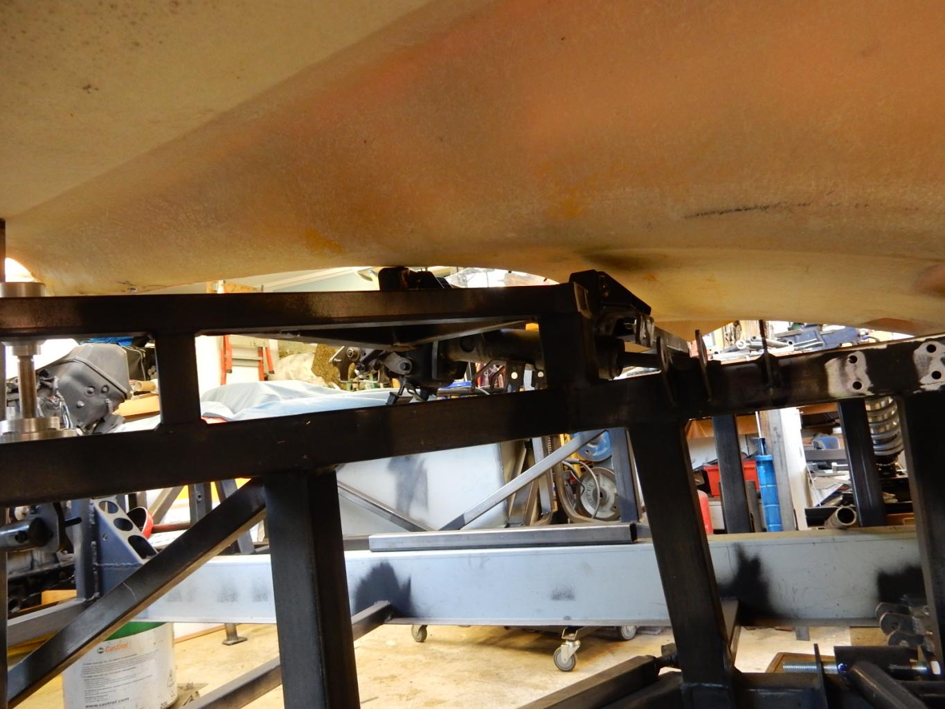

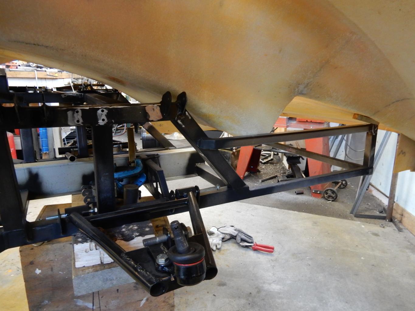

After much measuring, guess work and blind hope I chopped the front vertical of the chassis back at an angle to clear the radiator air scoop and the lower frontal area of the McLaren vs GT40. Finally got an extra set of hands around and tried the nose section from my track car on for a test fit. Microns to spare but it fits. Also took patterns for the radiator mount itself as we end up with a max of 300mm height at the back of the radiator so space is critical.

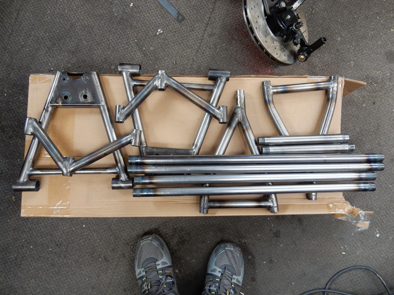

Because I hope to end up building more of these chassis, I have also recorded all my alterations so as to build without drama. Have also completed re manufacture of my front suspension so its away for crack testing. Slowly getting back on the job now that Carol has her chemo behind her as we have got a 4 month `break` before what ever transpires. Have booked a holiday in Australia and will call in and see Johns Mclaren.

Meanwhile all suspension parts are off being crack tested because its going to be road registered.

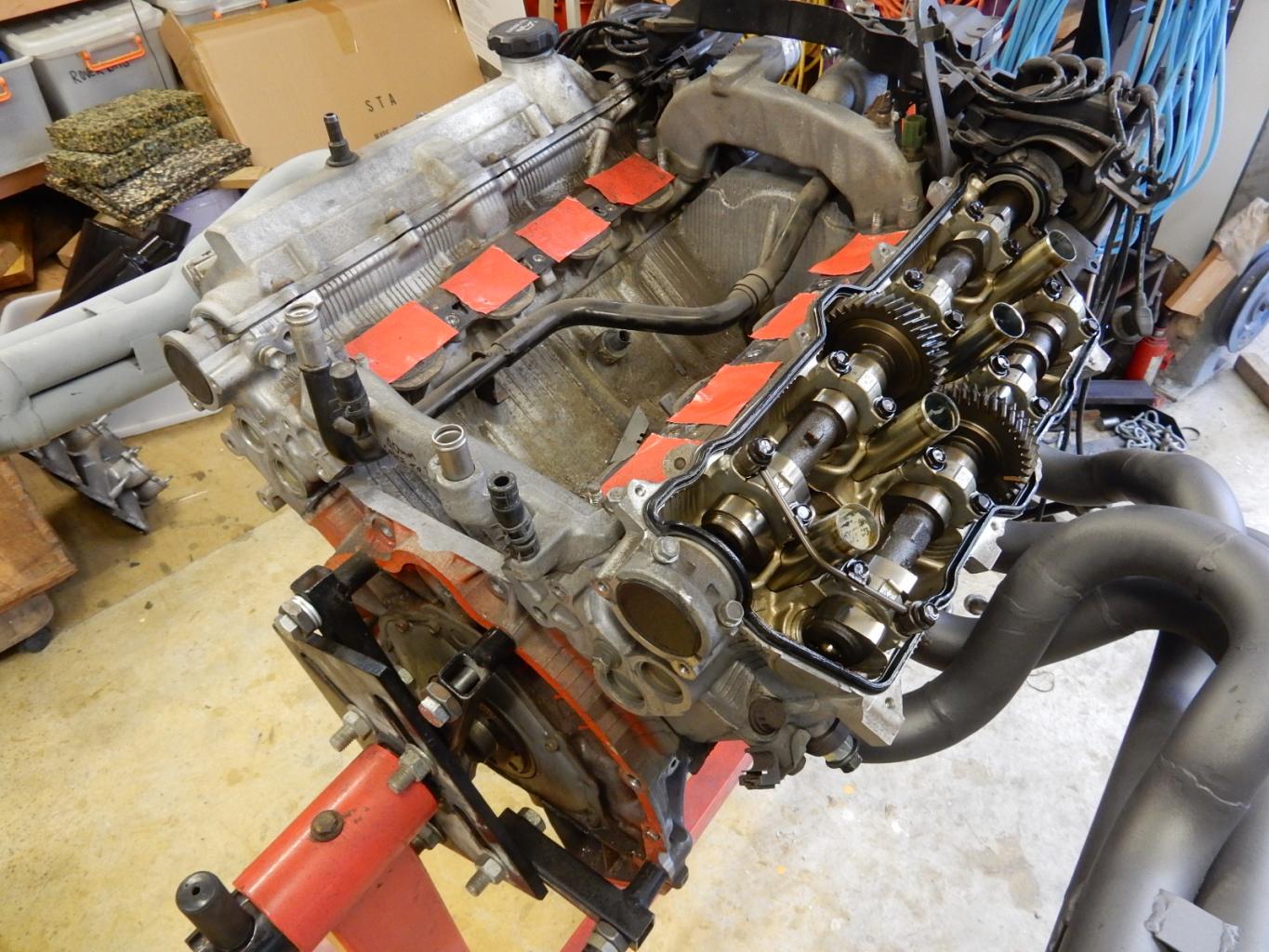

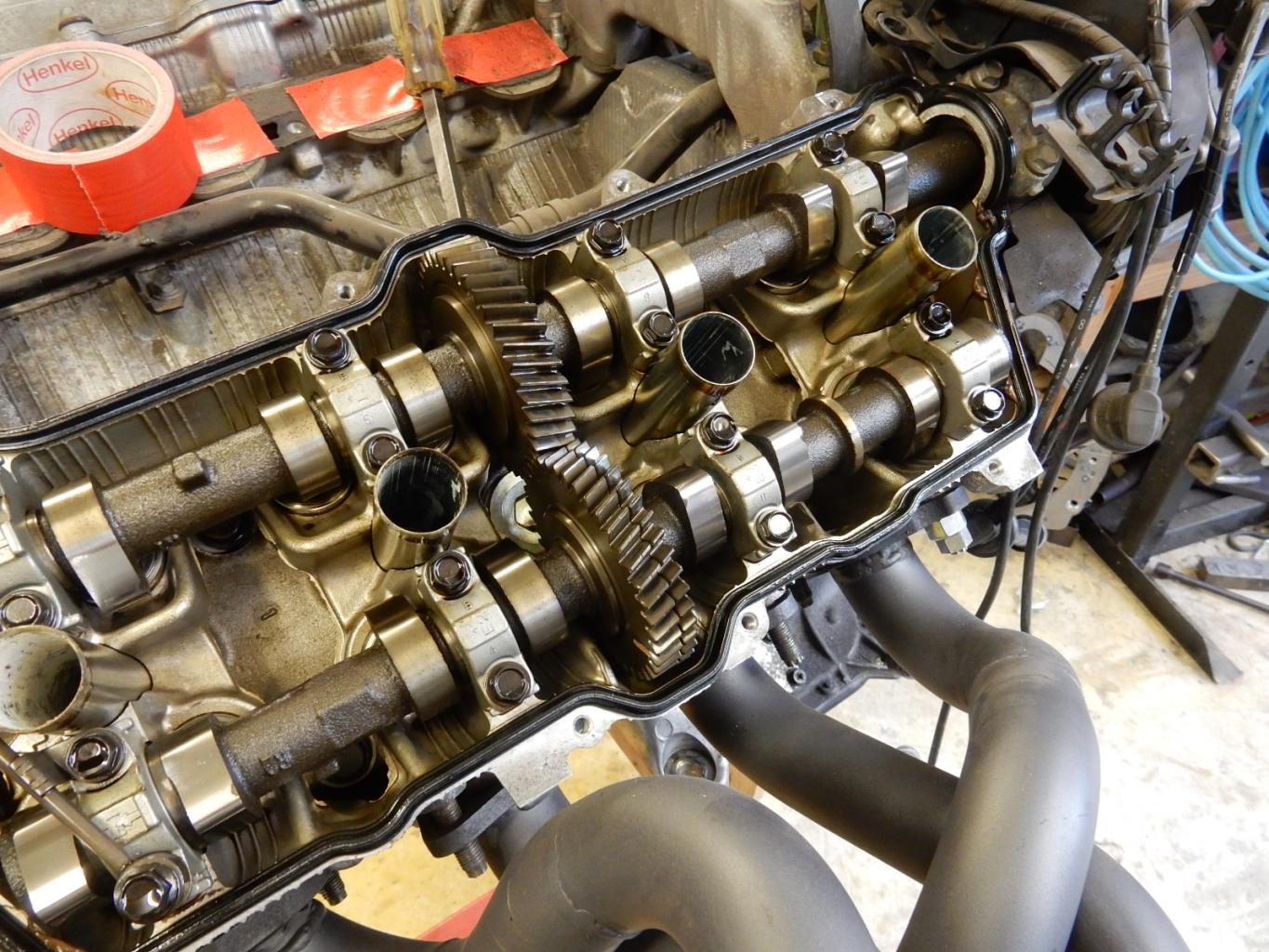

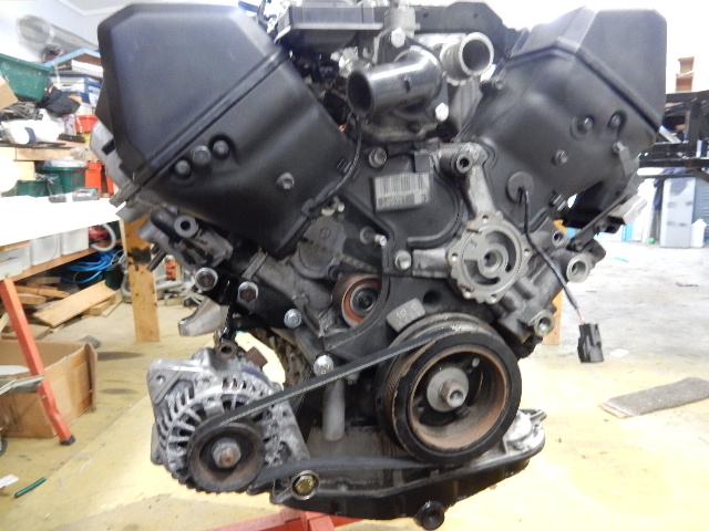

Stripped all surplus parts of the Toyota 1uz and took of the rocker cover to see what sort of condition it may be and was pleasantly surprised at how clean it was with no signs of wear on the cam lobs. Big question now is what colour to paint the rockers.

Wow, that engine looks brand new on the inside, mutch better than mine.
are you going to do any mods on the engine ?
keep up the good work
Thanks Peter,

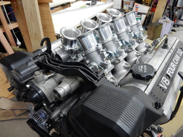

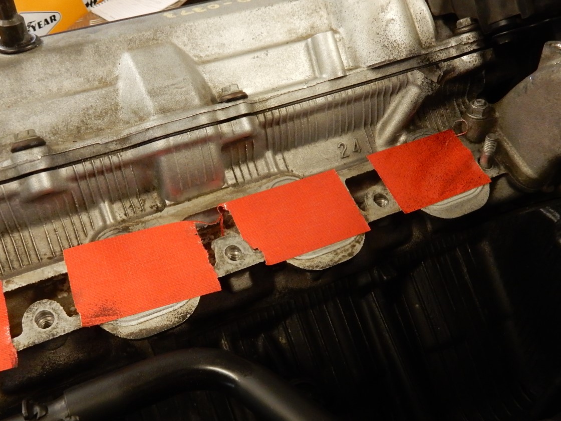

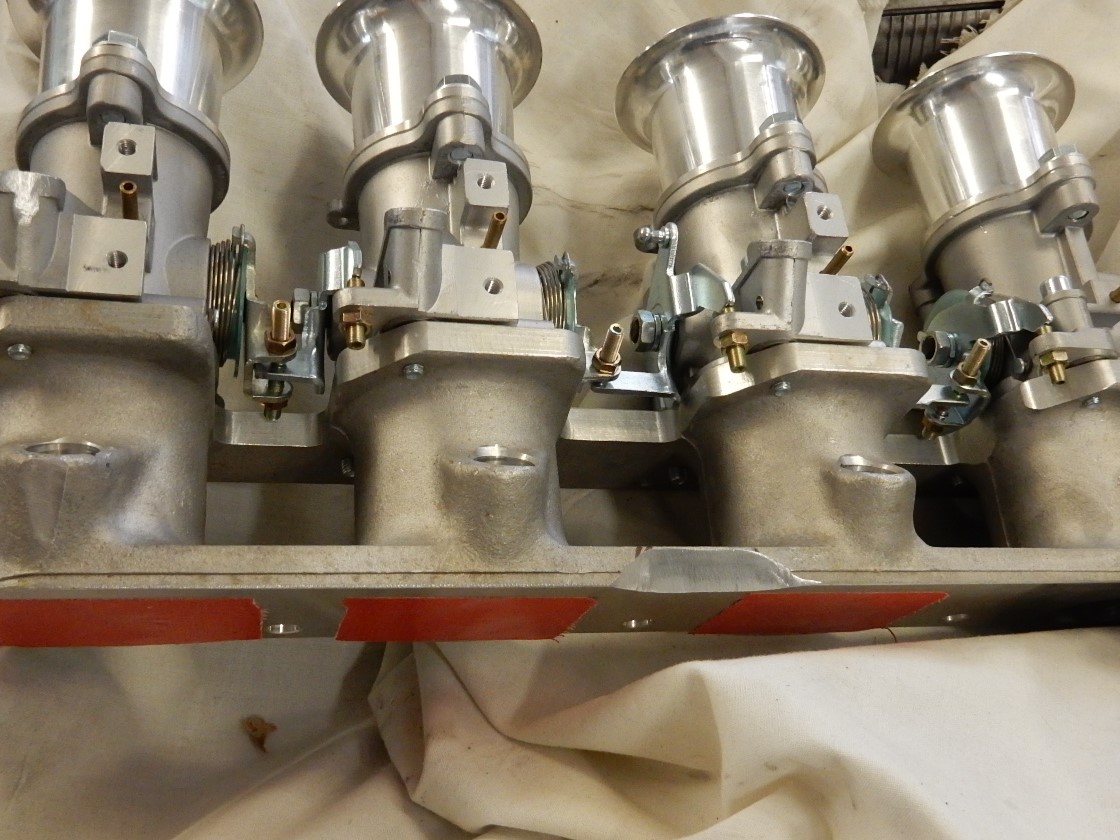

Yes the motor appears in good condition, the slight mods required to fit the OBIX throttle bodies involves a small grind in the centre and at the end where it gets very close to what looks like a gallery on the side of the head to the right of the cast #24. I plan on doing nothing other than TB`S ,extractors and a Microtech computer. We have the other car going into the `Speedshow` this weekend so its time to put a for sale sign on it.

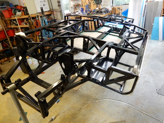

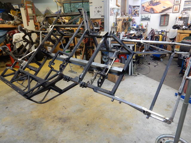

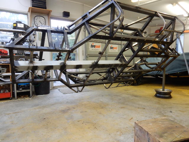

At last its finally time to come off the rotisserie, I have been around and around so many times checking what I have missed out in the way of brackets etc. I plan on getting it sand blasted and then powder coated ready for assembly.

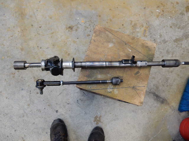

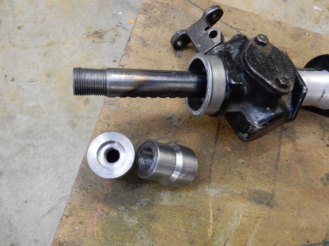

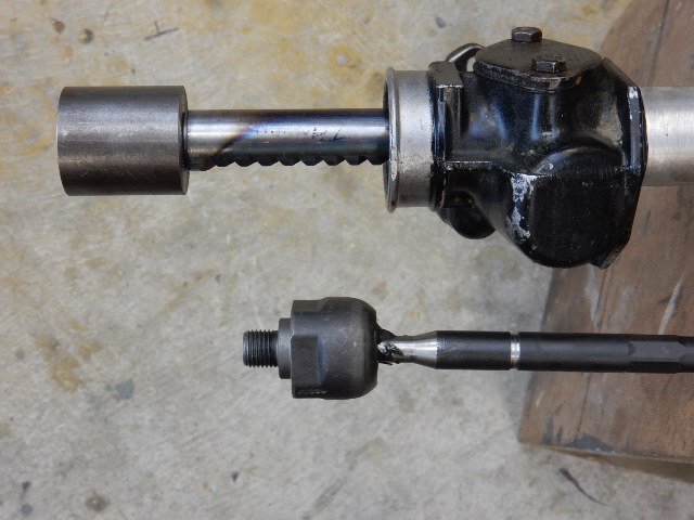

I have finally got the ends for my steering rack shortened and threaded to take the modern style of rod end, as you can see, it started out as a Mk4 Cortina rack and now is hopefully the right length. Its fully adjustable for height and for / aft.
Now its time to start assembly....nice clean work.

Looking good mate, but I tell you what it doesn't matter how many times you go over it, once its powder coated you'll find a couple you missed. with the Brabham I cheated, I completely assembled it, got everything working then In two days I stripped it to a bare chassis and got it powder coated.
cheers John
ps and yep I still missed a couple.

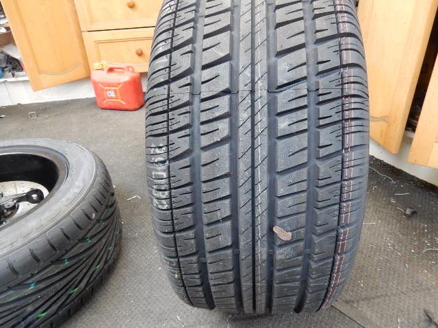

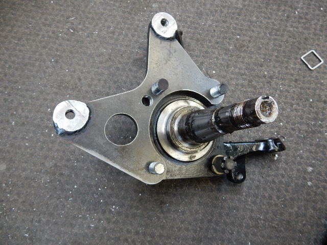

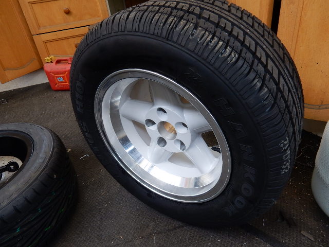

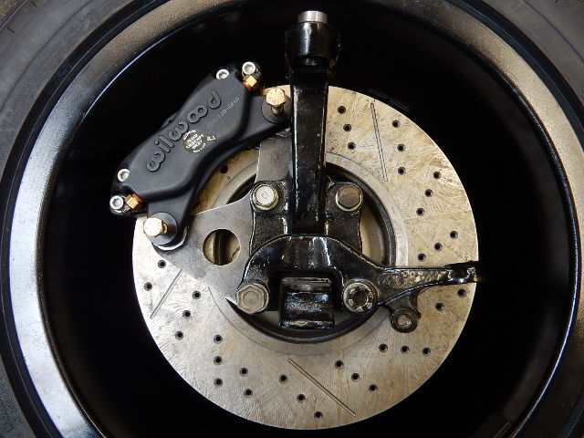

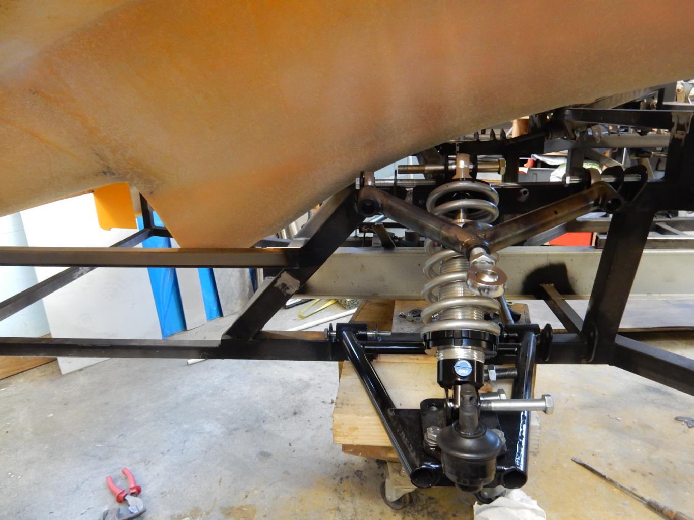

Chassis away being sand blasted and painted so its time sort out some of the bits. The front uprights are Toyota Lit Ace and I have made adapter plates for the Willwood 4 pot calipers. The 10mm plates place the calipers 2mm off set so welded some pads onto the mount area and milled them back to the correct thickness with the mill drill. We end up with 15mm clearance between the caliper and inside of rim. Also got the rear tyres mounted and now need to paint the insides black. Steering rack all assembled and painted.

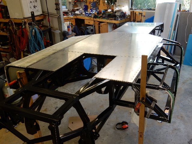

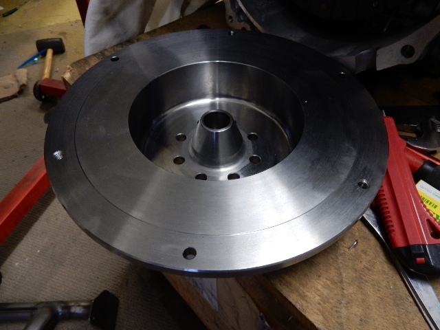

Got most of the floor on, thank goodness for the air pop riveter I bought last time. This car will have a lot more panel work to keep out road grime ect. and be finished to a higher standard. Sat the throttle bodies on the motor just for fun, also mounted the alternator and picked up the fly wheel yesterday, chose not to scallop out the outer diameter due to clearance tolerances. Its great to finally be assembling the car now after having probably our best holiday ever in Aussie recently where we caught up with John, M1.

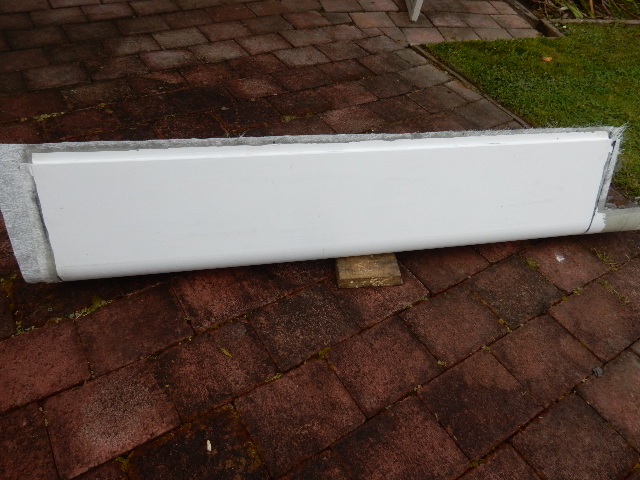

Back into that smelly stuff again..only seems like yesterday that I was moulding the last car..no disasters this time, thick gel coat with plenty of cure time before layup of the chopped strand matt.
I need to make these lower side panels because they are fixed to the car and need to be fitted after the fuel tank goes in. All my aly panels are away being cut to size, more rivets yeh.

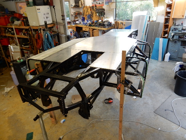

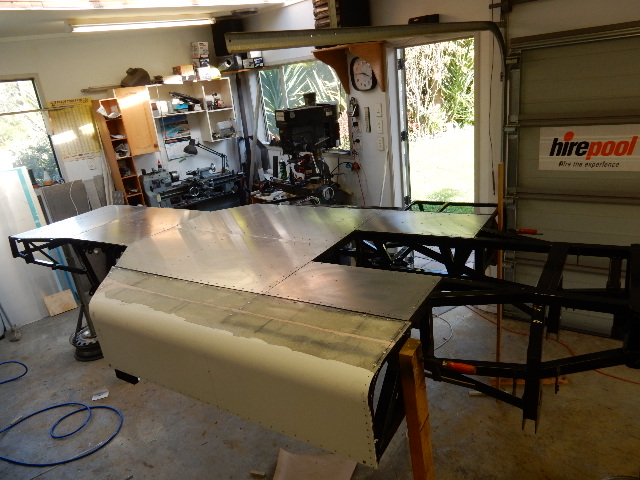

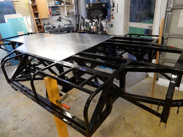

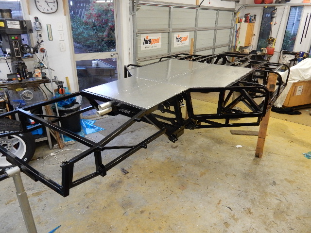

Well big day in the shed today, fitted the balance of the aly floor panels and the drivers side fibre glass body work. The left hand side needs to have the fuel tank installed tomorrow before that fibre glass body work gets fitted.
Starting to get wide now....1820mm at the doors.
