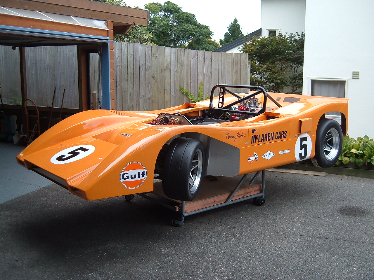

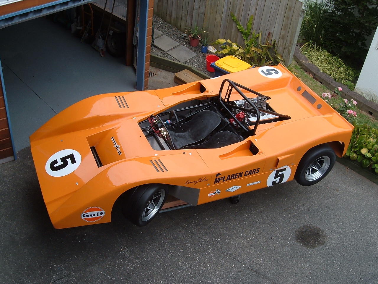

That looks just fantastic, there is just something about that colour, looks and all the decals etc that just bring back great memories. Your body work looks perfect so I can only hope to achieve somewhere near that when I do my moulds for the M8B that I have started.
All the best and I hope to see it in the flesh some day.
Very Smart, Is that EFI or carbs on it?? I hope to see it at a meeting one day and maybe even get to run with you but you will have to own it for some time yet, my progress is nowhere near your pace. Love to see some video action. Again, congrats on a great job. Cheers Leon.
Thanks Guys,
Leon, it's a Hilborn 2 7/16 unit with EFI injectors hidden in the centre. basically one of their traditional two-peice designs with a new top casting made to accept EFI hardware. Controlled by a Link G4 ecu. See here for details: Hilborn Fuel Injectors. I'd love to run with the M20 when it's done.
Terry, the guy who painted it for me is a Mopar nut, and said the colour is very similar to the early 70's colour "vitamin C" used on the Valiant Chargers in Oz and NZ.
Cheers, Andrew
I'm still hoping for a roller by the end of this year and a runner by Xmas 2015 so you never know we could get together with Russel and his M8B now that would would make a great photo and stirr up the Trust people some what. I'm sticking to mechanical 3" Enderle on my BB, would love a Lucas Metering unit but they are quite expenssive so it will be a constant flow to start with.
Love your car mate and it does give me insperation and incouragement to press on.
Cheers Leon.
