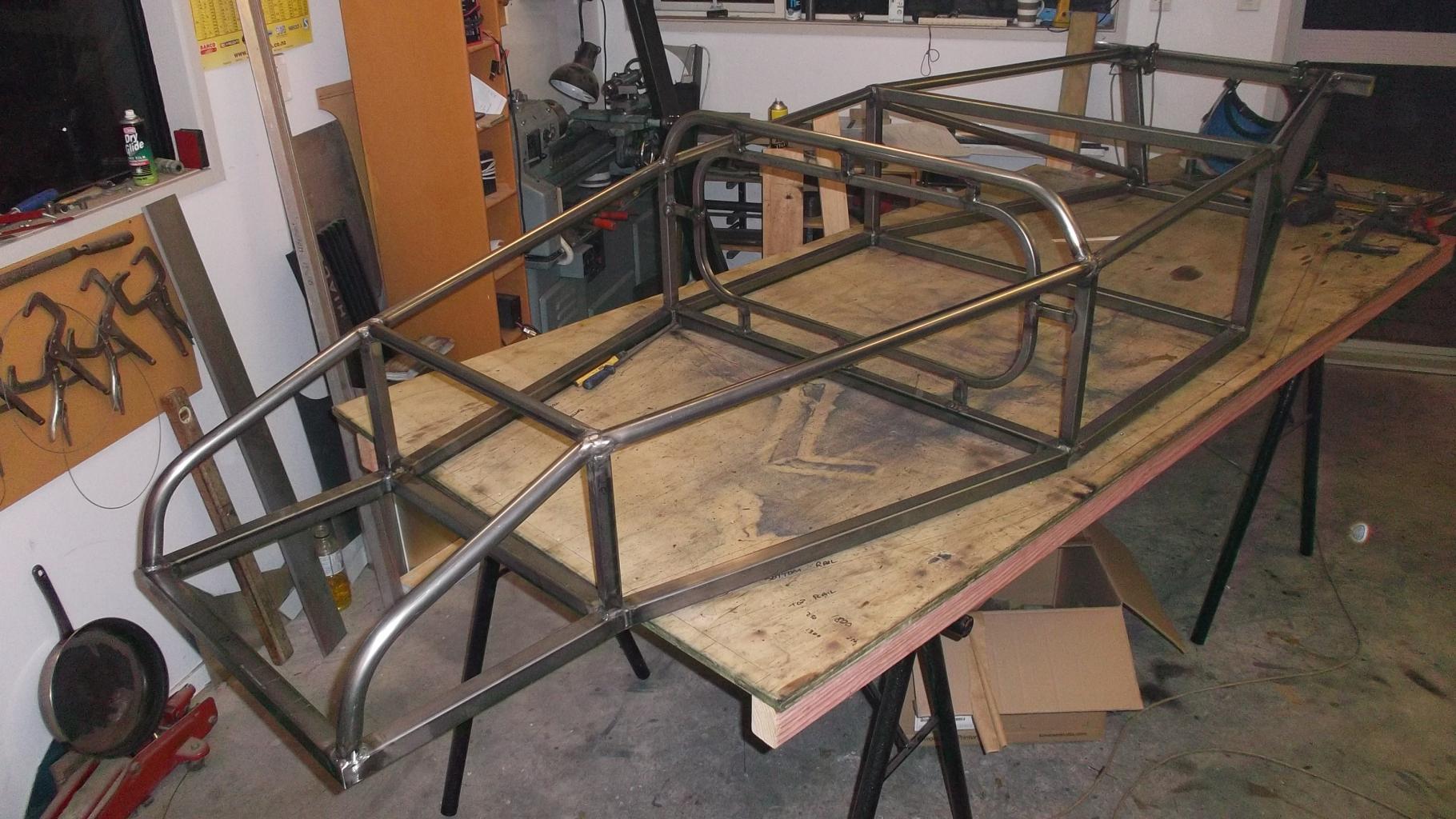

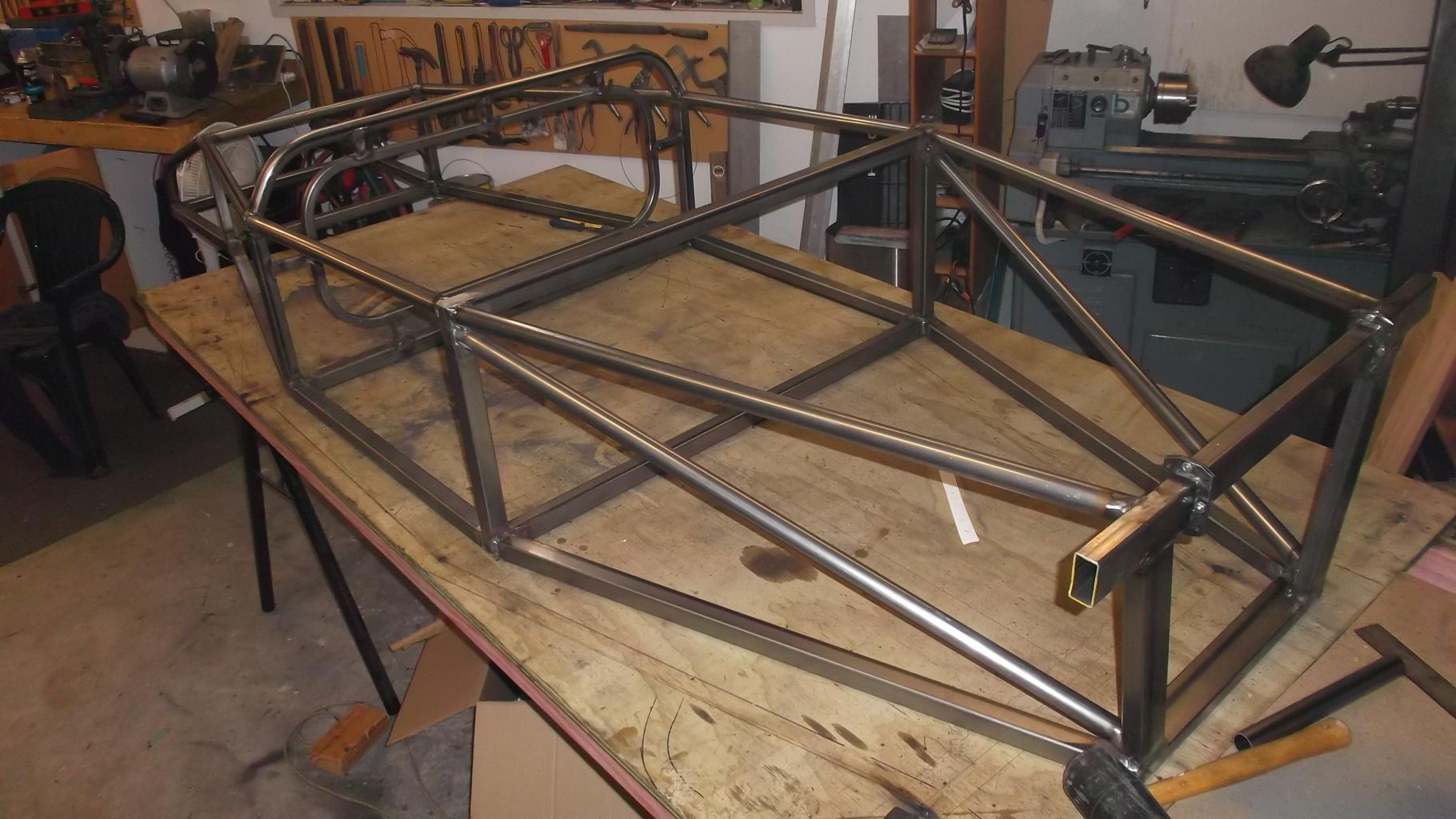

As you will see from the photos, the design is similar to my original car, just some `design` improvements....

I see you've made an inside hoop at the dash bulkhead ala Lotus 23. Will that get welded steel sheet or auminum rivered "stressed skin? What was the steering box you used on the first one? Looks rather like a Spitfire unit. Looks like you're charging right ahead on it.
Hi there Mike
Yes that's where I got the idea from because some comments on my previous car where that the cockpit was quite a large open space. I never noticed any flex issues how ever this time I have made the cockpit slightly shorter and added that bulkhead which will get skinned in aly.
The steering rack will be a modified Ford Escort rack. To make steering geometry easy, last time I built the suspension and then mounted the rack on the drivers side in the correct location for the pivot points and bump steer ect. Then proceeded to get a new rack shaft cut to the correct length. You can buy steering track rod ends in many various lengths so getting from the rack to the steering arm was also easy. Then it was a simple task to extend the Escort rack tube to accommodate the extra width. This was really a simple way around the problem because the new shaft only cost $150.00 and was right first time. I am on the hunt for a quick rack pinion before I get that shaft cut.
